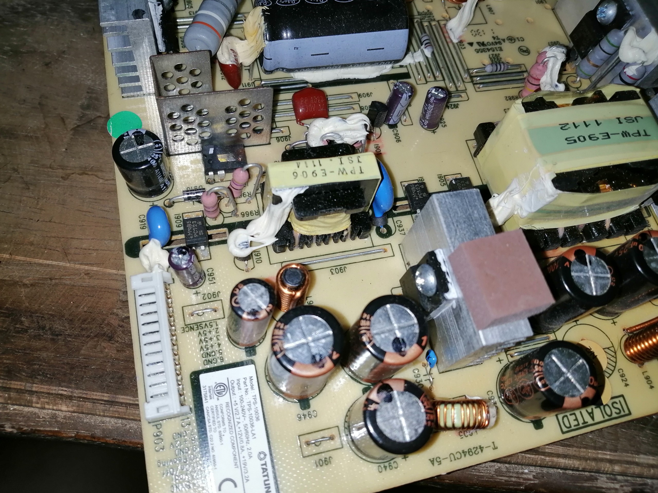

    A TNY279 only cost a dollar or 2, so just replace it and you'll see if it is indeed the cause of your failure (I also bet it is).
    Yes, it was it. All works fine after replacing of TNY279.
    Thank U gratefully. U really helped me to save ZR24w. Your story of repair was the only that I had found.

        Hi all. I just repaired my defective HP ZR24w by replacing the TNY279. Seems quite common with these displays. In my case, the TNY279 had actually exploded, ripping of the top part. Thank you for describing problem and solution so well.

            Please help,
            i my case... TNY dead and rezistor R961 same and I dont know value or type ("burn"). Thanks for reply.
              Re: Transformer for HP zr24w
              Originally posted by Paxancz
              Please help,
              Show us the pictures of YOUR whole board, and the pictures of this R961 location.
