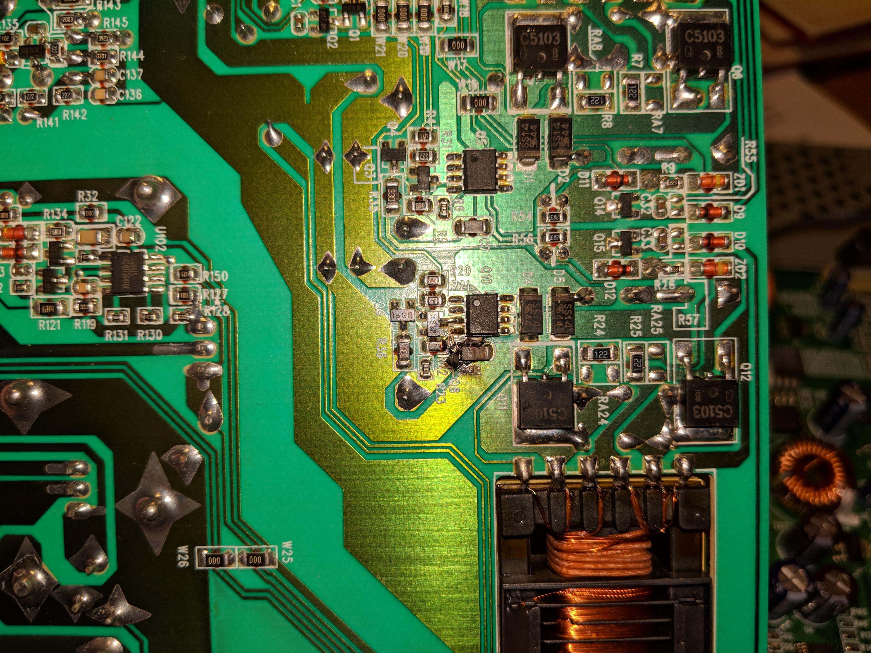

    I have a Iiyama E511S which switches on for a fraction of a second and during that time the picture looks ok. All the electrolytics on the PSU board look ok, but on the underside there are a couple of blown SMT caps (see picture). These caps are so burnt so I can't see what value they were.
    Any ideas of what value these are likely to be? If it helps, the 8 pin chip next to the caps is an APM9435 P-Channel Enhancement Mode MOSFET. I've looked for a reference circuit which uses this chip but had no luck so far.

    As I don't know much about SMT, I've been reading up and here's a bit more info.
    It looks like the caps are in a 1206 package and one side is connected to ground so maybe they're doing some decoupling? Would 0.1uF or 1uF be a reasonable value to try as a replacement?

      Yup, 0,1Uf -1uf should be sufficient, depending on the purpose the capacitor was placed there.
      But probably there is more bad then simply the MLCC`s.

          Yes, they're definitely caps. They're still recognisable as such plus they have C7 and C28 printed next to them on the PCB.
          I realise there might be other problems, but as I got this monitor for free I thought it's worth a try.

                  the blown decoupling caps near APM9435 are 1uF, maybe 50V MLCC with Y5V dielectric (I'm not sure). You may put here 1206 1uF 50V X7R

                    These caps were so burnt C7 and C28 0.1uF 50v 1206 sm check case broken the track . plus replace all electrolitics in psu if ESR measures 16V 470uF etc

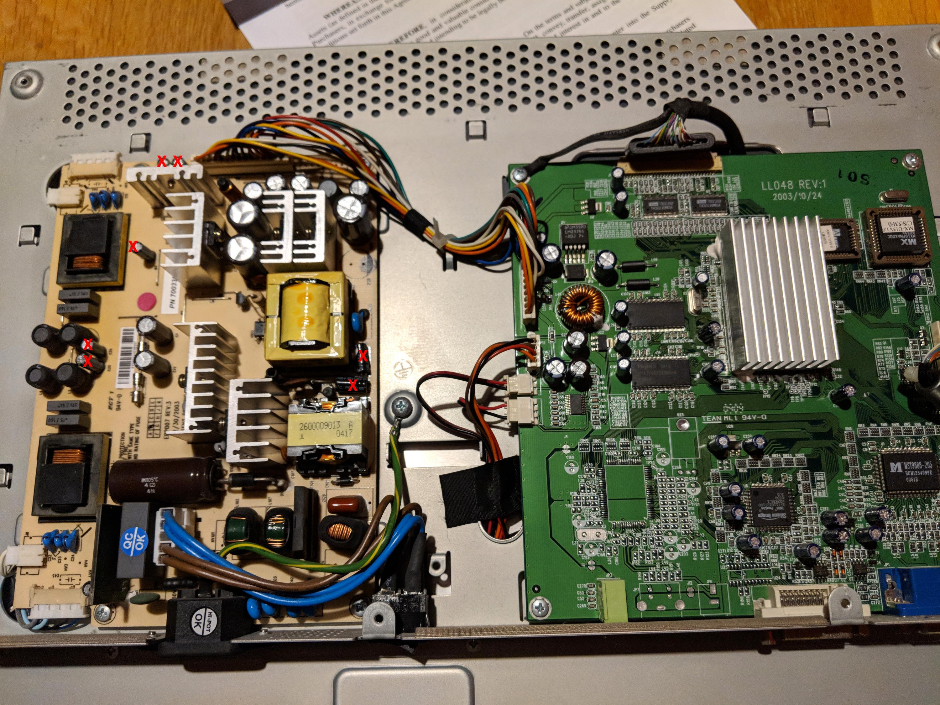

                          I have just encountered the same problem on the exhibit I run at a computer museum. I couldn't find instructions on how to disassemble the monitor, so after a bit of head scratching I worked it out.
                          I took the monitor apart, usual screws on the back and unclip the case, run a blunt knife, from the centre of each side back and forth and the two halves split, then remove the RF conductive tape, remove the bottom screw and then remove the outer shielding box.
                          This monitor has burnt up its SMD MLCC and taken a chunk of PCB with it (some more adventurous rework needed!) The problem seems to lie with the ESR of the capacitors increasing as their capacitance is decreasing (age/heat/electrolyte related). I pulled every electrolytic capacitor from the board and measured its ESR and capacitance, just to be 100% sure to avoid parallel capacitance. It seems the small value capacitors (Elite branded) suffered the most in this respect. Their ESR went from 0.05R to as much as 6R with a loss of capacitance of around 20-30%
                          This photo shows the caps that I am going to replace
                          This photo shows how only half of this board failed, the ESR value of the 47uF electrolytic was about 1/3 of the failed side.
                          This is a close-up of the burnt C29 MLCC - it shows typical overheat and arcing damage. Probably worth replacing its counterpart...
                          Of course, I don't know if this is all that is damaged, I am awaiting components to do this fix. This is the list of capacitances and ESR of the electrolytics on the board, might be of help to someone.
