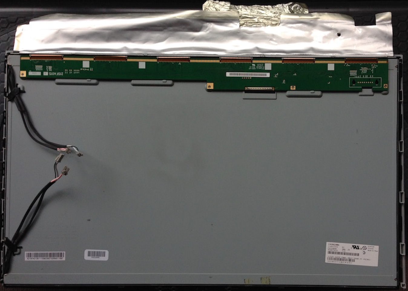

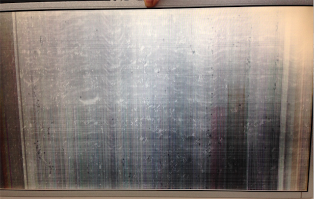

    I'm trying to repair two Viewsonic VX2260WM CFL LCD monitors, but no luck so far.
    The CFLs light up nicely, but the screen stays grey with vertical lines (see attachment).
    and the expected voltages (23V, 5V, 3.3V, 1.2V) are all in the correct locations as shown in the service manual found on the internet.
    There is 5V on VLCD on the TCON board, so all simple things look ok.
    Did any of you see this before? Any pointers welcome.

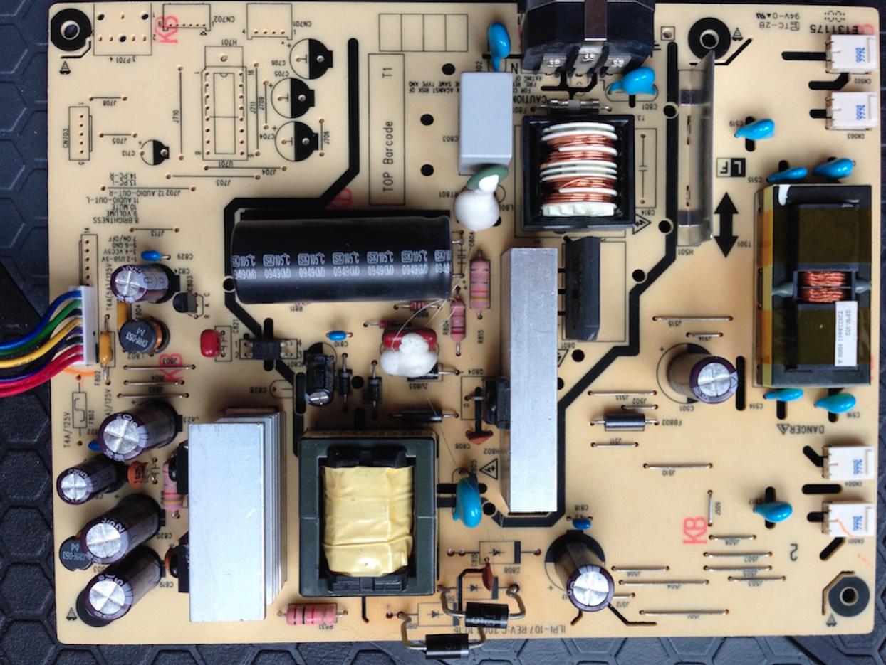

      Post some pictures of the T-con and power supply.
      I've seen this type of problem caused both by bad caps in the power supply (thought, they did appear fine on the outside) and bad voltages on the t-con.
      The T-con usually has several voltages: 3.3V/5V input, 3.3V/2.5V/1.8V for the driver controller, a boosted rail of about 10-18V, TFT "HIGH" drive 15-35V, TFT "LOW" drive -5 to -15V.
      There are usually test points on the T-con, so I will give you more details when you post pictures of it and the power supply.

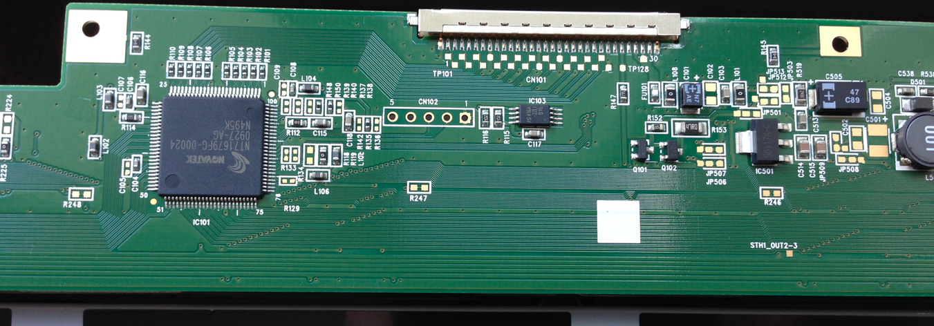

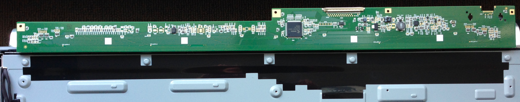

          thanks for the replies. I've uploaded some photos of the power PCB, LCD and TCON.
          thanks,
          doorzon

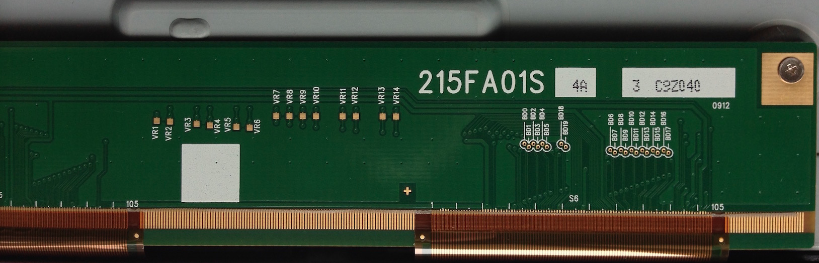

            Had a bit more time to do some measuring on the TCON board.
            Since I have two monitors with the same symptoms, I swapped the electronics with the LCDs. The other LCD shows some information from the video input and also shows the OSD, however the response of the OSD or changes to the video input take 5 to 10 seconds to display. Brightness is also way too high, but adjusting it in the OSD does not really change a lot. Adjusting the VR on the TCON can only make it more bright.
            Voltages are the same on both LCD TCONs:
            VDDG 21.0V
            VDDA 21.9V
            VEEG -7.0V
            VDDD, VDDD_P 3.3V
            OE1 1.0V
            VCOM_1 5.1V
            STV1 0V
            VDDG_FLK 17.2V
            STH_F1 0V
            XDON1 3.0V
            FD18 1.64V
            LP1 0.16V
            VR1 12.4
            VR2 11.8
            VR3 9.9
            VR4 9.3
            VR5 8.9
            VR6 8.2
            VR7 7.3
            VR8 6.3
            VR9 5.3
            VR10 4.4
            VR11 3.8
            VR12 3.2
            VR13 1.0
            VR14 0.3
            Checked the flat-cable assembly of both monitors, all pins connect end to end.
            At the moment I cannot measure the voltages on the signal board while connected to the LCD. Will solder some wires in place later to test the 5V/3,3V/1.2V when connected.
            greets,
            Doorzon

              Hi Doorzon,
              sorry for the late reply.
              Hmm... that suggests that the T-con may not be the issue. Nonetheless, I will explain some of the voltages below, because there are a few voltage readings that do seem off.
              VR1 12.4
              VR2 11.8
              VR3 9.9
              VR4 9.3
              VR5 8.9
              VR6 8.2
              VR7 7.3
              VR8 6.3
              VR9 5.3
              VR10 4.4
              VR11 3.8
              VR12 3.2
              VR13 1.0
              VR14 0.3
              Okay, they are the LCD gamma reference voltages. I think they are more or less normal.
              VDDG 21.0V
              VDDA 21.9V
              VEEG -7.0V
              VDDD, VDDD_P 3.3V
              VCOM_1 5.1V
              From these, VEEG and VDDG appear normal. But VDDA on most monitor T-cons usually refers to the main boosted rail (which is always lower than VDDG), and is typically 10-16 Volts.
              Could we see some pictures of the reverse (component) side of the T-con? That way, I should be able to confirm if VDDA on this monitor is indeed the same "VDDA" that I normally see on other LCD monitors.
              Try cleaning the ribbon cable contacts too. Believe it or not, pencil eraser works great for that. Follow up on that with some IPA (Isopropyl Alcohol).
              Lack of any of these voltages probably would cause the whole monitor to shut down, so I doubt they are the problem.
              Another suggestion I have is to change the caps on the main and stand-by 5V rails on the power supply (they are marked as "VCC-5V" and "VSB-5V" on the main connector between the PSU and logic/video board.)

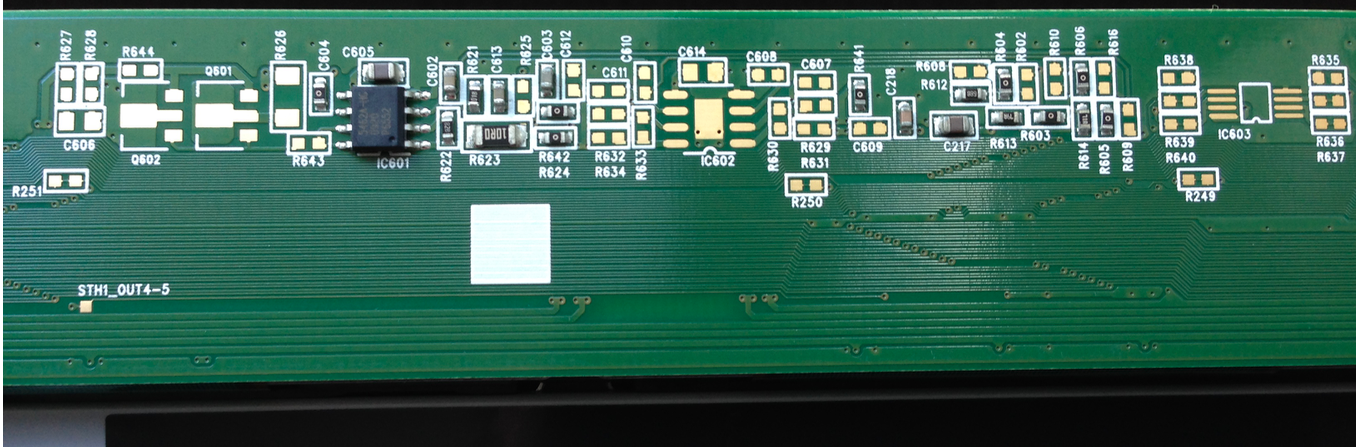

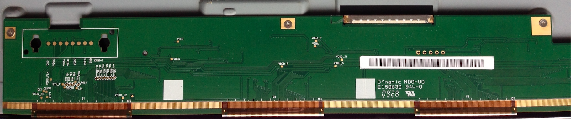

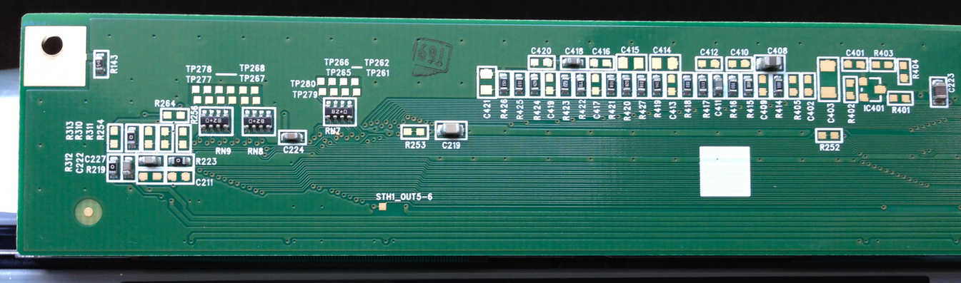

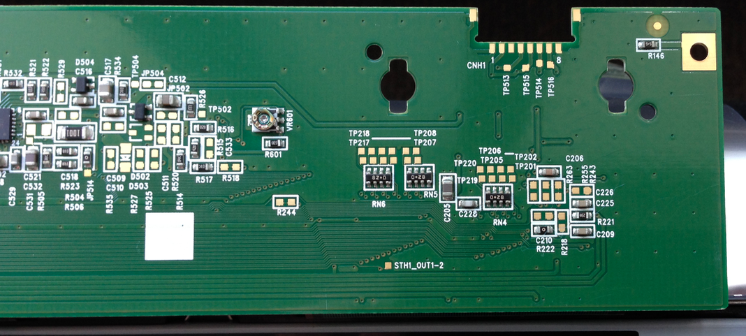

                Hi Momaka,

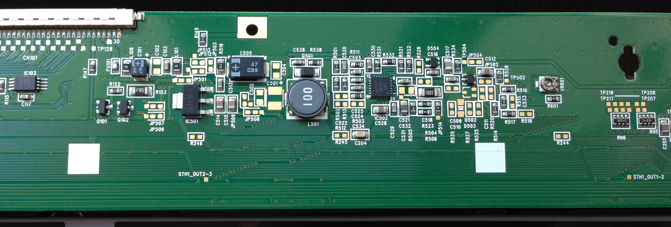

                attached the pictures of the TCON component side.
                I don't have access to my oscilloscope yet, otherwise I could look for excessive ripple on the VCC and VUSB on the power supply board. Maybe I'll just replace the caps on the board since it's little effort and cost. Only the wait time to get these shipped to New Zealand ;-). I suppose you learn to be patient when living on an island.
                The fuse on the TCON is ok.
                Will update when I have some more info.
                thanks,
                Doorzon
                  If you are talking about the ones on the power supply board - yes, that would be a good idea.
                  As for the T-con, can you check what resistance you get between test points VDDG and VDDA? Also, can you check VDDG resistance to ground and VDDA resistance to ground? Finally, can you see what resistance you get between the cathode of SMD diode D501 and test points VDDA and VDDG?
                  You can see SMD diode D501 in this picture of yours, right above the round black inductor coil with numbers "100" on top:
                  https://www.badcaps.net/forum/attach...2&d=1452146386
                  Diode D501 has "24" written on it. The cathode side is the left side (the one with the stripe on it.)

                    Between VDDG and VDDA: 33k4
                    VGGD - GND: 29k5
                    VDDA - GND: 1k8
                    D501K - VDDA: 0 R
                    D501K - VDDG: 31k4
                    Values are practically the same in both directions with my cheap DMM. Compared to 1% metal film resistors, the DMM seems reasonably accurate.
                    Diode testing D501 (in circuit) gives values 165 and 850 with my DMM.
                    Normally I'd expect one direction to be open but there are likely other components interfering with the testing.
                    So I took out D501 and tested. one way 165 and other way open, as expected from a working diode. It' back in now on the TCON.
                    The new part will be here around Tuesday, so then I'll replace all caps on the power board.
                    Could it be that one or some of the flex PCBs is making bad contact with the LCD glass conductors?
                      VGGD - GND: 29k5
                      VDDA - GND: 1k8
                      D501K - VDDA: 0 R
                      D501K - VDDG: 31k4
                      Excellent.
                      So VDDA is indeed the main boosted rail as I expected, since it does have continuity to cathode side of diode D501.
                      Now the question is why VDDA and VDDG have the same voltage? They shouldn't - at least I haven't see it like that on any other T-con. But on the other hand, you said both T-cons have the same voltages, so it could be that they are normal.

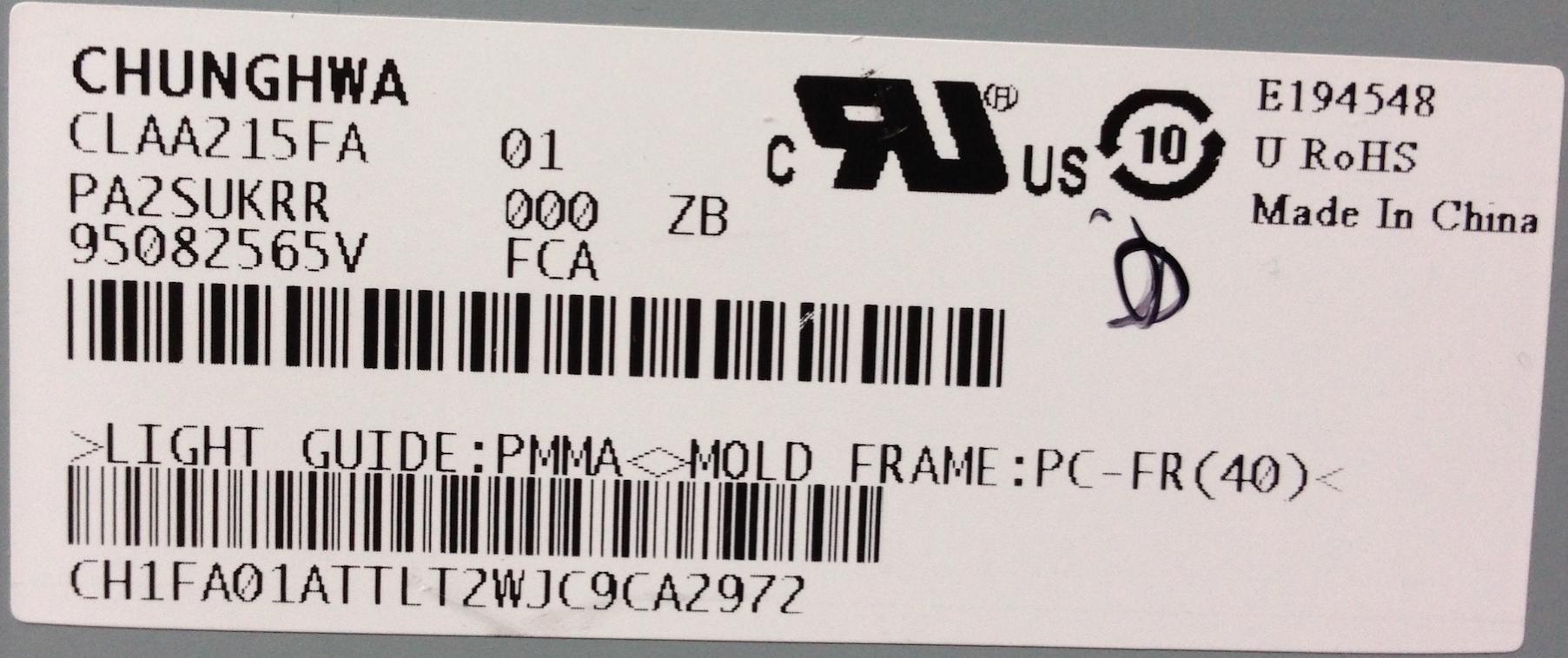

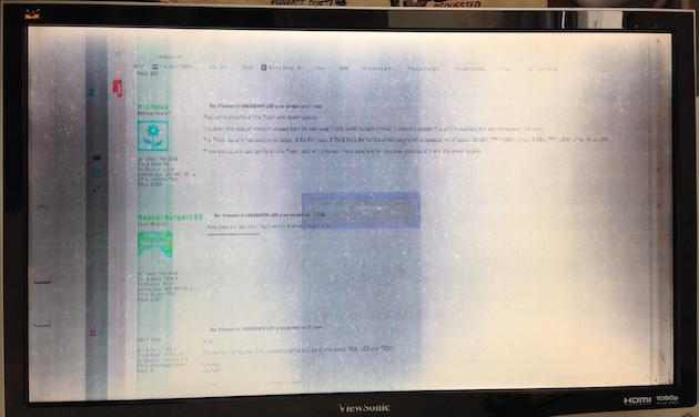

                        Hi People,
                        sorry for the late reply. It's been holidays in NZ and the site was unavailable for a while.
                        The caps have been replaced on these monitors, but no such luck fixing them. It seems that in spite of all the effort, the issue is with the LCD screen itself, as 1Supertech indicated in one of the earlier posts.
                        After taking apart the LCD itself, I've come to the conclusion that repair is not possible, but the monitors are a very nice uniform light source without the LCD glass panel in it.
                        This will be the next project to make the monitors into a variable light source driven by a simple micro-controller for making photos of small objects.
                        Thanks everyone for the effort, guess this one was impossible to fix.
