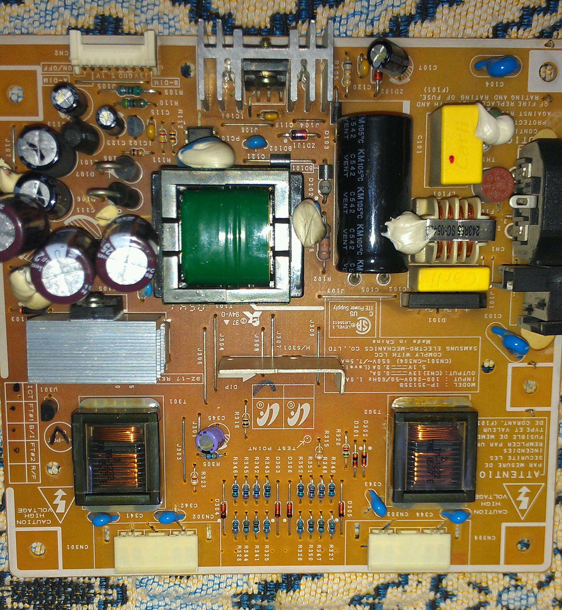

      #402
      Re: Problems with Samsung 740N monitors
      Originally posted by LuSiD
      Hey guys,
      Am i the only one that has this powerboard in my Samsung 740N?
      See the attached pictures. The caps seem fine and are labeled 'JH'. What should I do? Does anyone knows what this board is and if it has the same problems with the common ones?
      Thank you
      Anyone?
      Hey above posters. Did you reply to me or someone else?
      • Rtech
        • Jul 2010
        • 1095
        #403
        LuSID....your transformer is the same as the one we are referring to.HOWEVER you have not said what fault symptom you have ???/the other problem with your board can be caused by failure of one or more of the 4 Big black diodes.

              • selldoor
                Slow Learner
                • Dec 2010
                • 7870
                #407
                We really need pictures of your boards - both sides - the one you have posted
                tells us little of your problem and cannot be effectively enlarged.
                The 12v is less regulated than the 5v and if the lamps are not lighting the voltage would rise a little.
                Do the lamps flash at all
