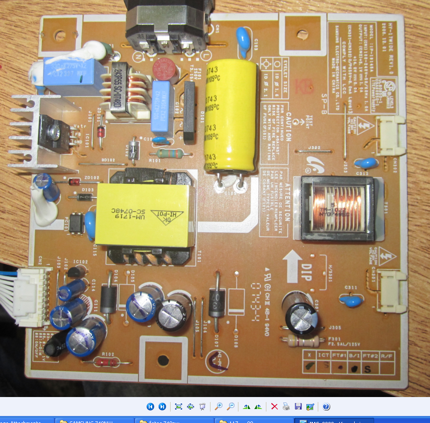

                        Samsung LCD 740nw Led flashes and no picture
                        Hello ... The problem I have with my monitor is that when connected to the grid is turned on the power button is blinking and not showing me anything on the screen even in a message that has no connection to the pc. Thanks & Regards .........
                        help
                          Re: Problems with Samsung 740N monitors
                          help
                          1. Do not post pictures inline. Use 'Manage Attachments' - below the text entry area.
                          2. Do not use pictures you found on the internet. The first one has obviously defective caps. The second shows only a fragment of the power supply.
                          PlainBill

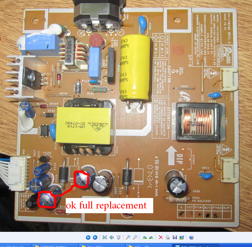

                            hello apologies
                            Some possible solutions
                            where to begin to test
                            all coils are in perfect condition
                            status as verefico (dm0465)???
                            thanks
                              hello apologies
                              thanks
                              Start by replacing all the electrolytic caps except C105? (the big yellow one). At least two of them are defective.
                              PlainBill
                                problem solved
                                capacitors were only 10v/1000 microfariados
                                thanks
