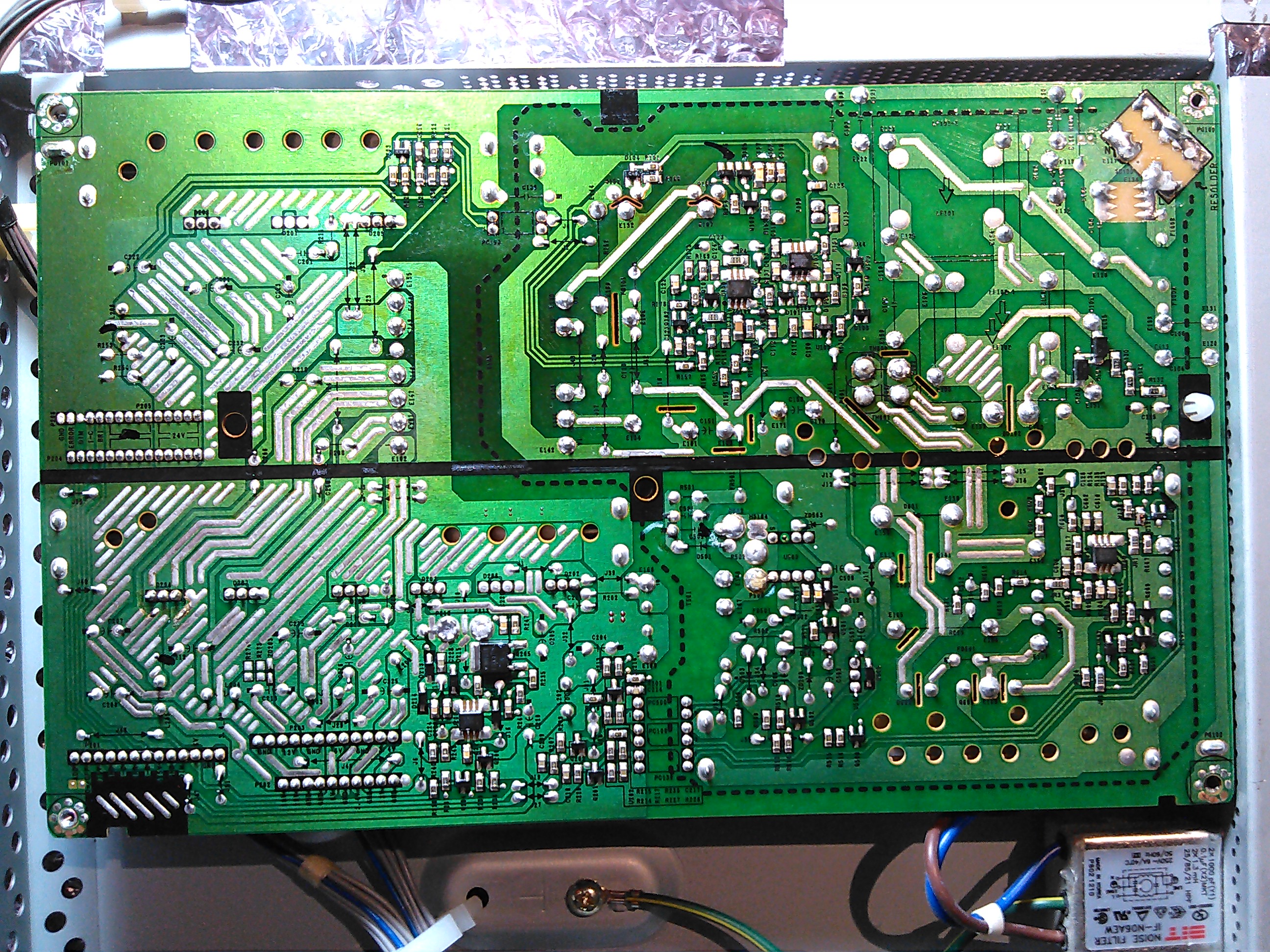

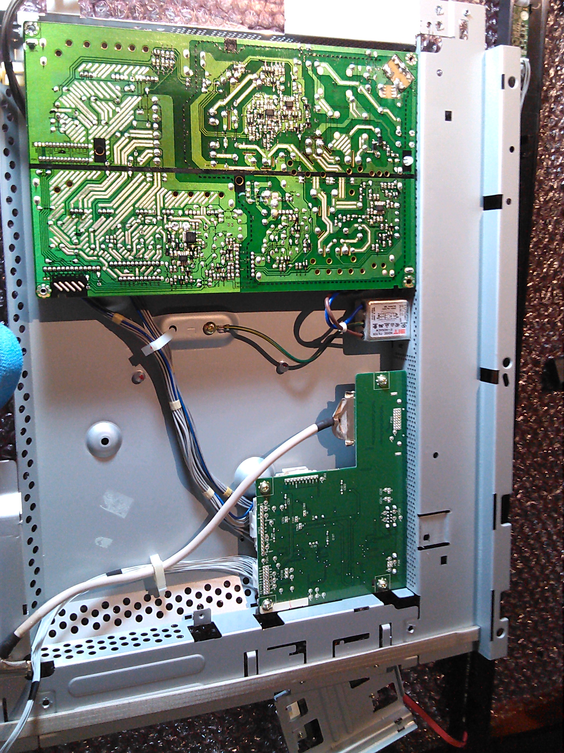

    Hi! My LG W3000h-bn switched to standby while working, and has been stuck in standby mode since, even after hard restarts. I've confirmed the computer, cables and mains are fine. The power button works but goes straight to amber standby light, the display never comes on.
    I've opened up the unit and started testing the power supply. Visual inspection reveals nothing (caps look fine). With PS disconnected from all other boards, I only get 5V on the standby 5V and "ADC", a few mV on 6V and 12V outputs, and 0V on everything else. I noted that the standby 5V seems to oscillate, but only between 5.0 and 5.2V. With the board that has the video input connectors on it (what's that called?) plugged in, and the power/menu buttons plugged into that board so I could turn it on, I get:
    ADC and ST5V: 5.07V (stable now)
    6V: 6.6V, but seems to slowly drop over time, last measure a few minutes later was at 6.2V.
    12V: 12.07V
    19V: 17.8V, also seems to drop over time.
    24V: 0V
    3.4V: 0V
    On/Off: 84mV
    I-C: 84mV
    Dim: 3.27V
    Err: 0
    I-B: 0
    Bri: 0
    Not sure what Bri, I-B, I-C, ADC are. I'm not too sure what to conclude with this. The monitor still stays in standby mode, so I'm guessing the 0's could be "normal". Is there a way to force it to turn on to test the voltages? I didn't find any "service manual" or such for this monitor.
    Pics attached. Any help greatly appreciated!

    I found my PS was the same as in this post: https://www.badcaps.net/forum/showthread.php?t=19546
    And they said to pull up the On/Off through a 1k resistor from the ST5V, which I did. Here are the voltages:

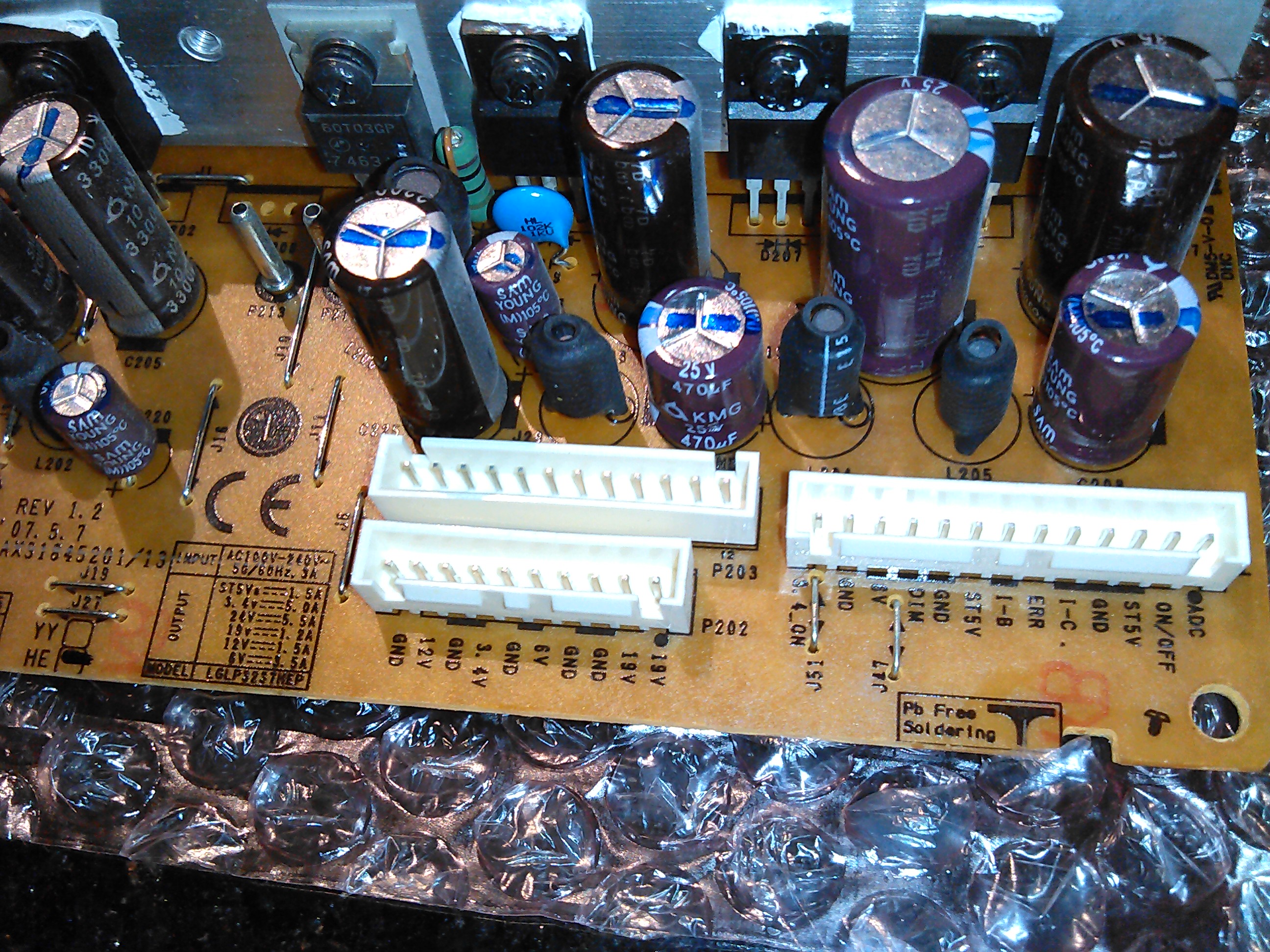

      On/Off: 2.9V: This is the receiving pin that receives the ON (BL-ON. INVR-ON) signal from the main board to turn on the Backlights inverter circuit.
      3.4V_ON also looks to be the receiving pin that receives the ON signal from the main board to turn on the switched 3.4V supply.
      What is the power supply board P/N? I cannot read it from the pictures.

        Ah good point. There are a couple:
        P/N: EAX31845201/13 rev 1.2
        HE is marked (vs YY) as is 32" EAY3305850 (vs 37" EAY3306450)
        Model: LGLP3237HEP

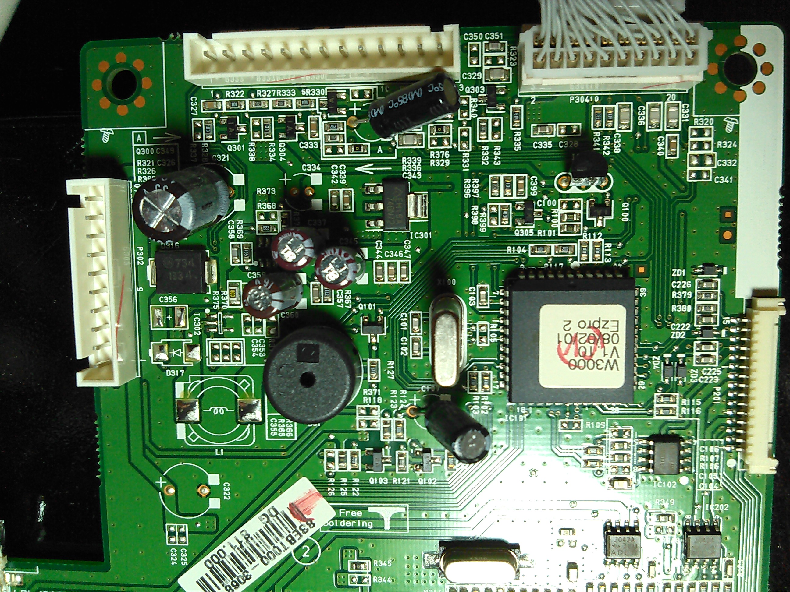

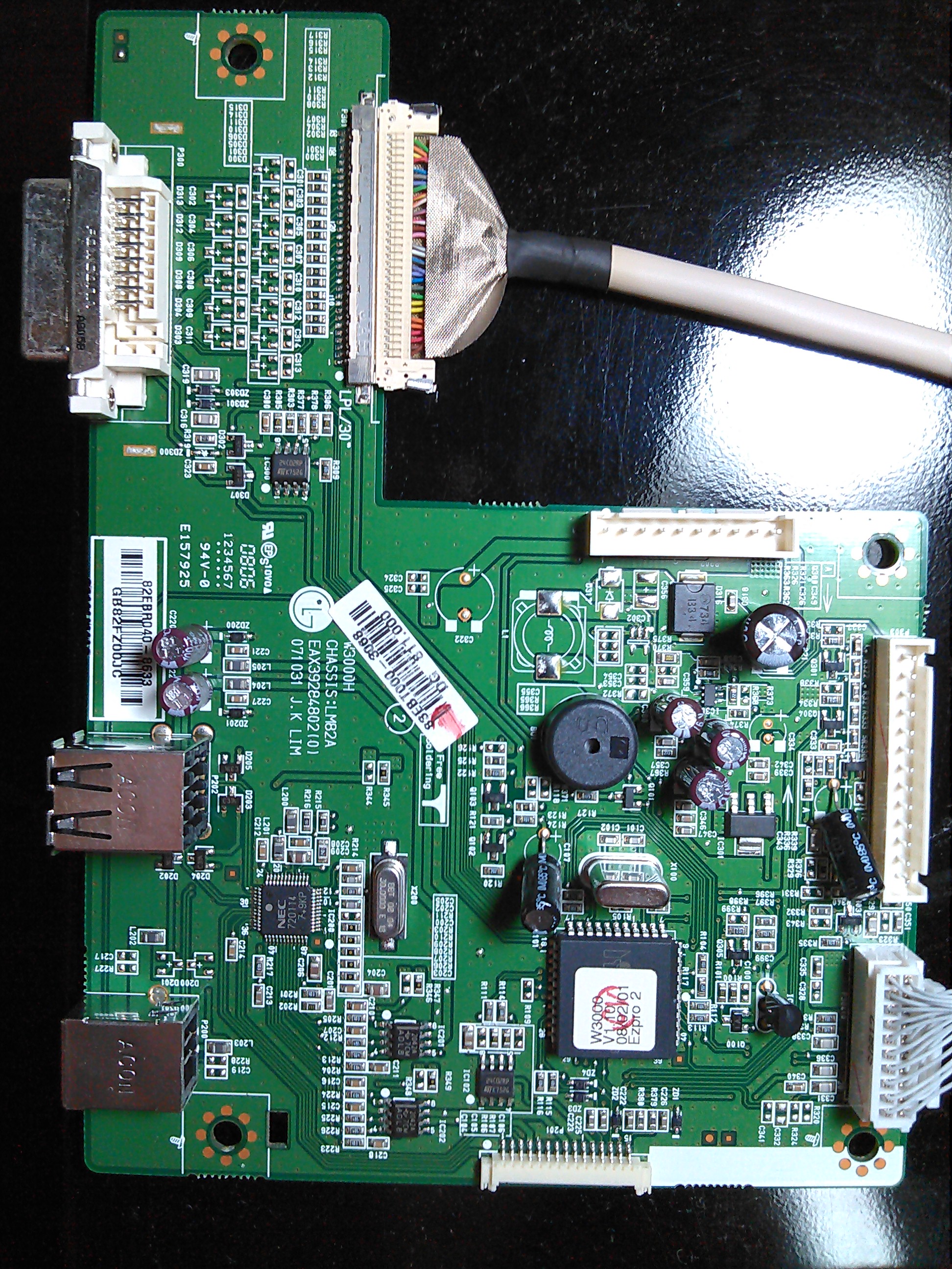

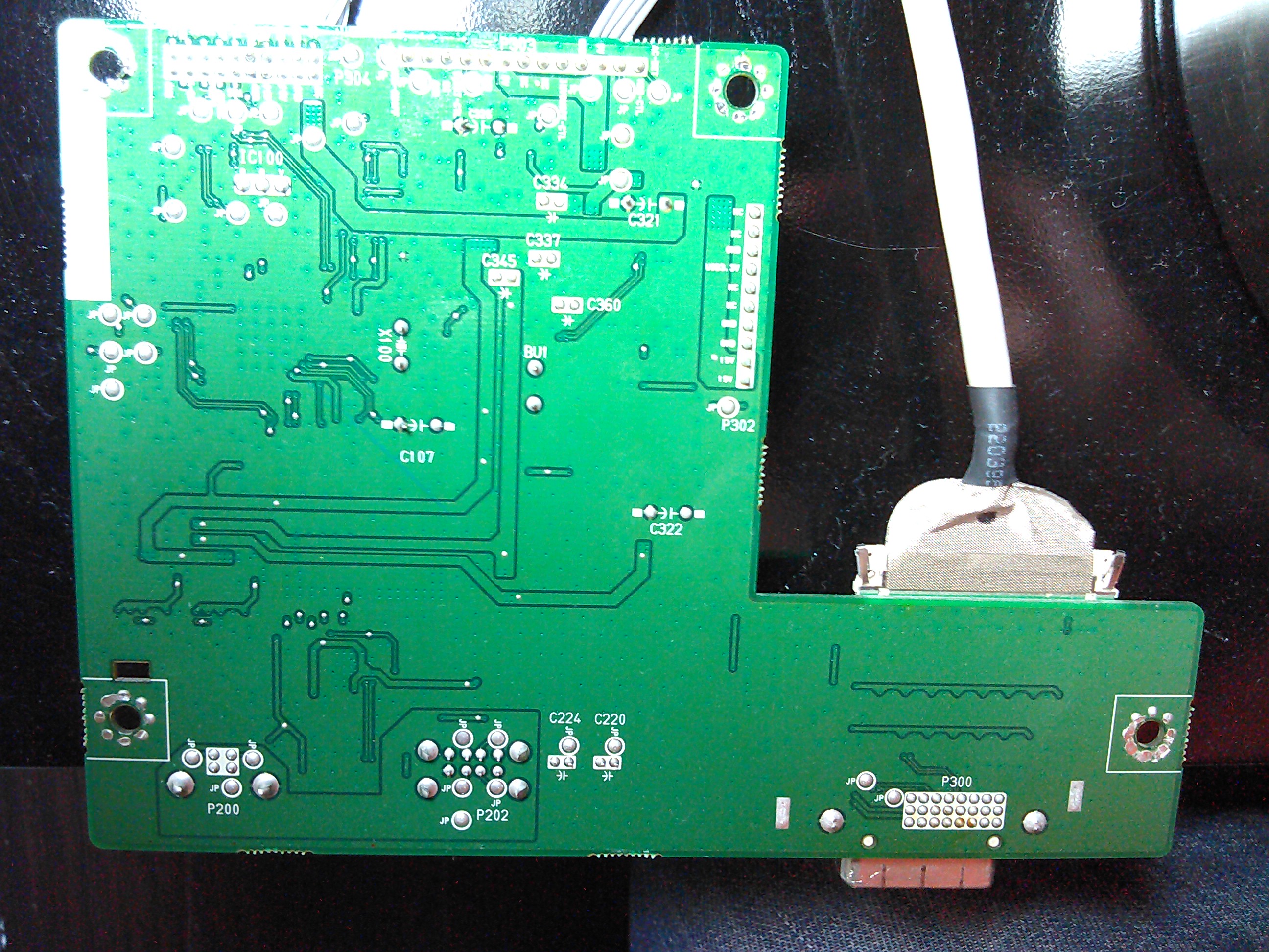

              Post some pictures of the video board here.
              • zorgkang
                • Nov 2015
                • 13
                Re: Power supply troubleshooting on LG W3000h-bn
                Indeed. Here they are.
                  master hoarder
                  • May 2008
                  • 12175
                  • Bulgaria
                  I see several small caps and at least one linear regulator there.
                  Let's start with IC301. It's that black linear regulator in a SOT-223 package. I did some searching on the numbers written on it (EH13A), and its actual part number is AZ1117H-1.8TRE1, in case anyone needs to find a datasheet.
                  It's a 1.8V linear regulator, so measure the voltage on pins 2 and 3. Let me know what you get.
                  Also, there are two more ICs that might be linear regulators. One is in a SOT23-6 (SOT363) package and is next to a small brown electrolytic capacitor C337. The other one is in a TO-92 package. Let me know if you can read any part numbers off of them.
                  Finally, check diode D316 with your multimeter on diode test mode (remove power to the monitor first, of course).
                  There is some chance that a few of those small electrolytic caps may be bad too, considering that I see two on there that are rated for 85C only.

                    Thanks momaka, finally have some time to work on this again.
                    I plugged just the main board through my DVI cable in the video card and I can confirm that the computer properly recognizes it and reads the EDID. The DVI pins for Hot Plug Detect and 5V standby from PC also seem good with ~5V on them when plugged.
                    The diode D316: IN734 B3 4 "Zener voltage regulator diode"; forward biased: 0.16V drop, reverse biased: OL. (seems ok?)
                    I didn't remove any components yet and I only have a basic multimeter, but I found most caps seemed ok when testing in resistance mode (starts low and gradually goes up to OL), except 2 that stay low, but that could be the circuit: C345 ~.9k, C326 ~3.9k. (I guess it's worth taking them out to test again?)
                    Then I measured voltages when powered by the supply board and using the power button to turn it on (it shows the standby amber light):
                    • IC301 is actually LD1117A-33H-08-TR30 low dropout positive voltage regulator. It checks out with 5V at input, 3.3V output.
                    • IC100 (the TO-92) is K1A7042AP voltage detector. I didn't exactly understand it's operation, but I measure 5V at input, 0.72V at output. (No change if I turn the monitor off, or unplug the DVI cable.) I expected the output to be close to input, but as I said not sure how it actually works. To check further.
                    • IC303 (the SOT23-6 you asked about) has markings: IANAN (or 1ANAN). Couldn't find what that is. Four pins are at 5V, two at 0.12V (so no ground).
                    • I also checked the power to the 2 EEPROM chips, Vcc = 5V on the one near the MCU and 4.55V on the one near the DVI plug. Seems ok.
