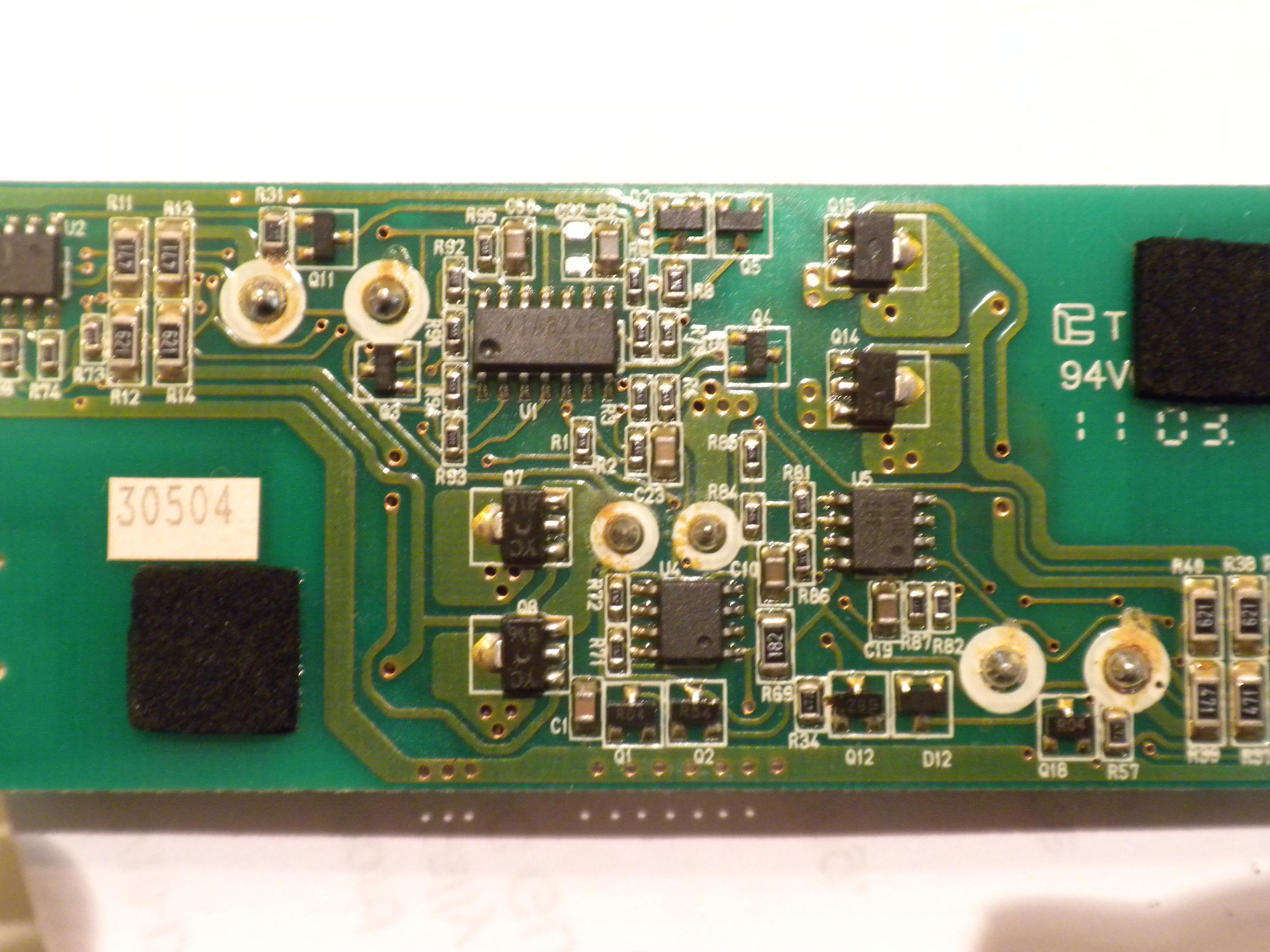

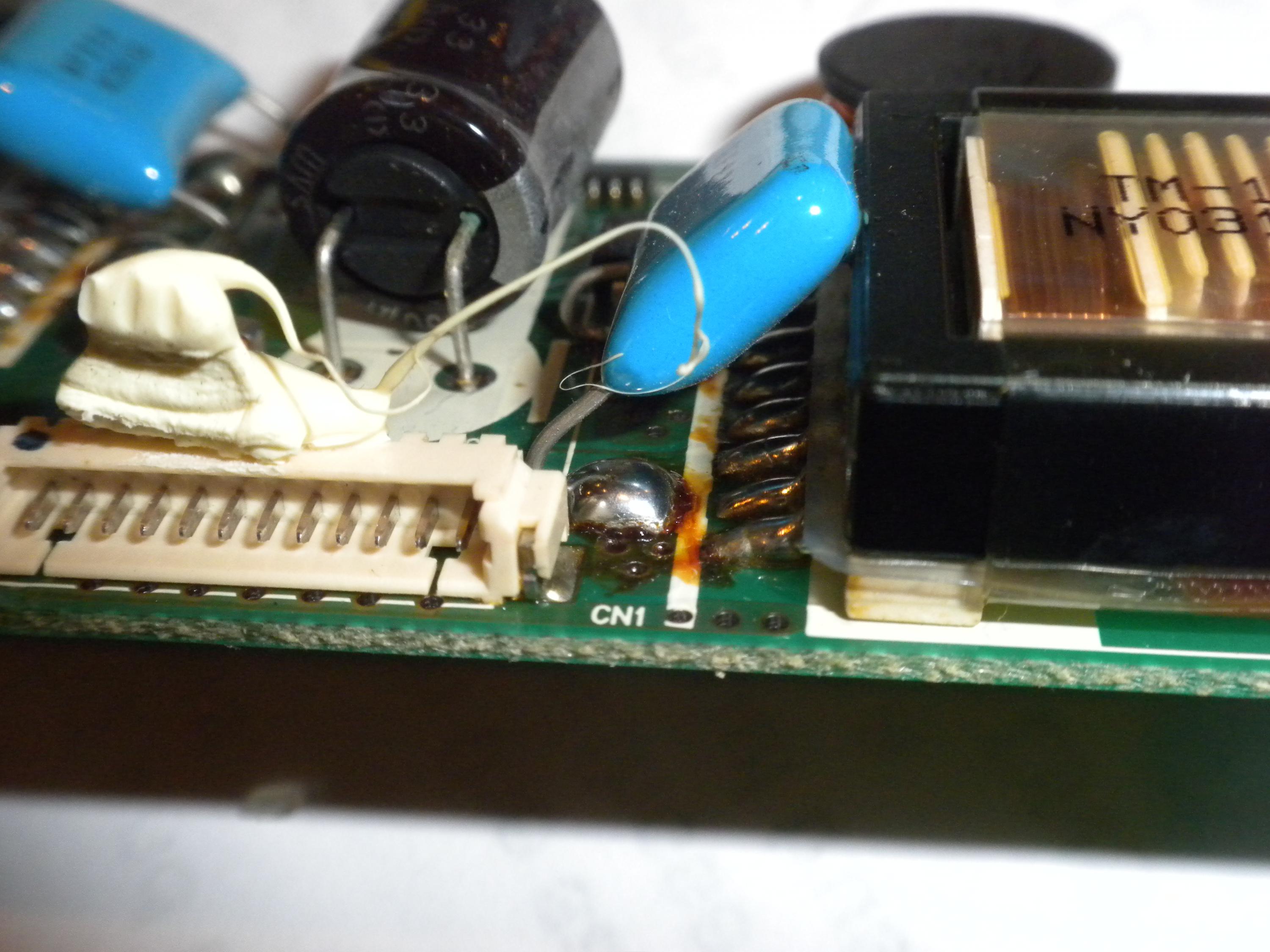

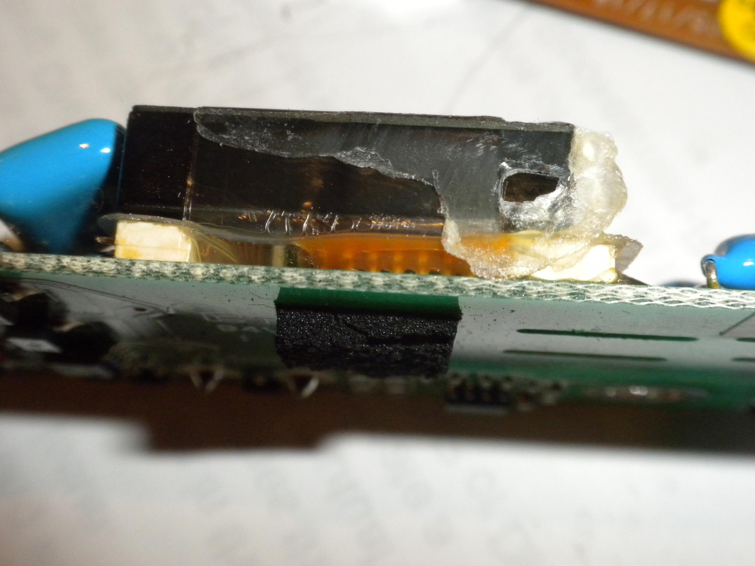

                  Re: bad Dell 1504p monitor
                  ok, well, posted too soon. Looks like the inverter board has at least 1 probable bad transformer which was hidden by a plastic film cover. Here's the pix :
                  I took a shot of the edge of the inverter board where some translucent clear crud appears to have leaked from one of the transformers. In addition, on both transformers where there are 2 blue poly caps (HF224 / HC5012A), there's some dark brown discolored material between the caps and the transformers. Probably have to replace the whole thing as I wonder if the transistors on the other side are messed up.

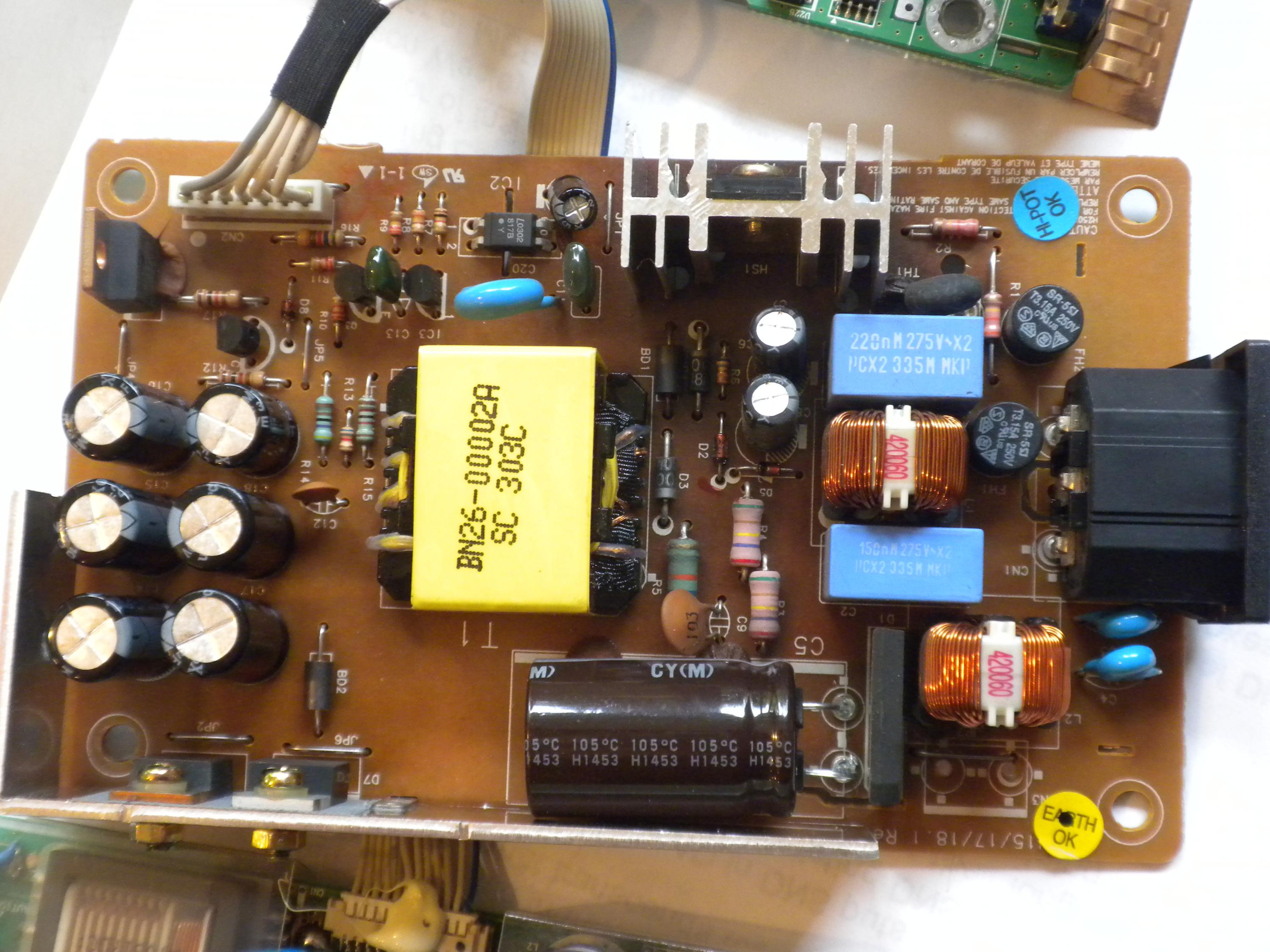

                  On the power supply board, the big brown cap in the middle is the one I replaced which shows 165v.
                  Thoughts?
                    "I took a shot of the edge of the inverter board where some translucent clear crud appears to have leaked from one of the transformers." Those are just flux.
                    What DCV do you have on the pins of the white connector CN2?
