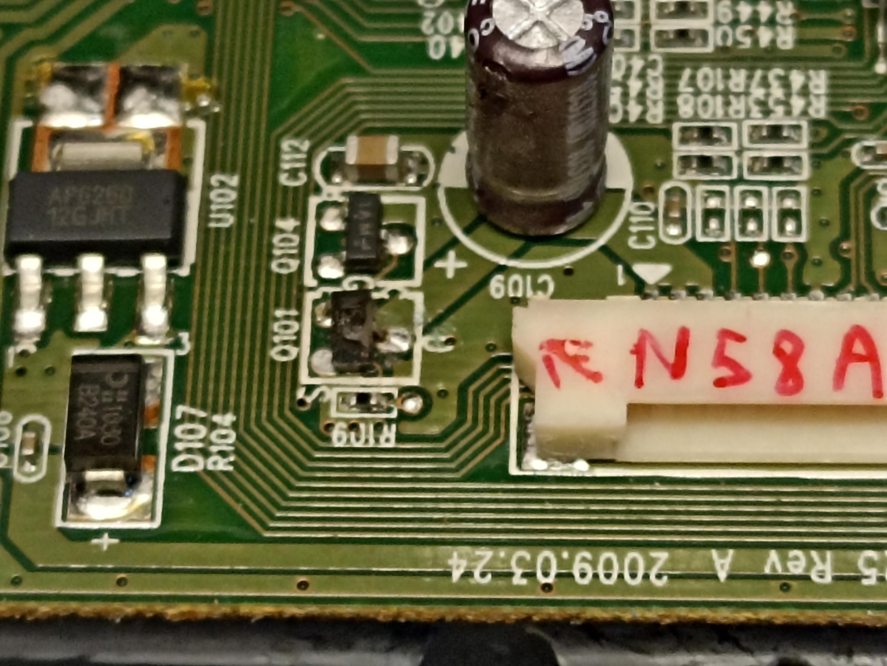

      Hello, sorry for kidnapping this thread.
      I have a problem at logic board, no supply to LCD panel, I found the smd Q101 component marked N58A shorted, anybody knows, what is this?

          #44
          Re: DELL P2210 - SMPS +5V reads ~+3.5V
          transistor, most likely mosfet, SOT23, there are markings on the board near the component G,D,S.

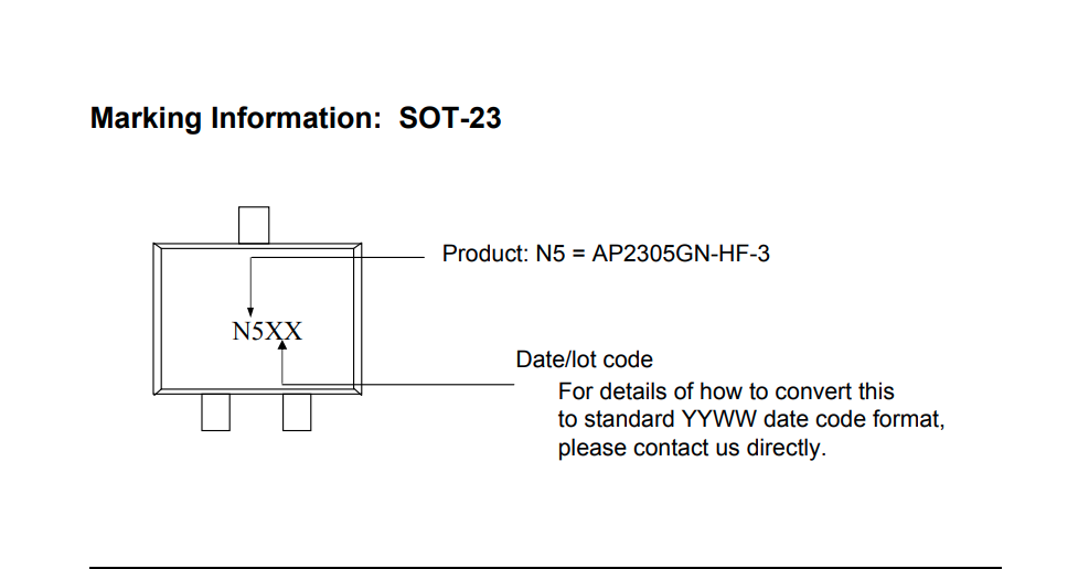

            Originally posted by torentino
            hello,
            transistor, most likely mosfet, sot23, there are markings on the board near the component g,d,s.
            ap2305gn
            • torentino
              • Feb 2014
              • 22
              • Slovenia
              #46
              Hello, Lotas,
              thank you very much, now I am on the hunt for a little bastard.
