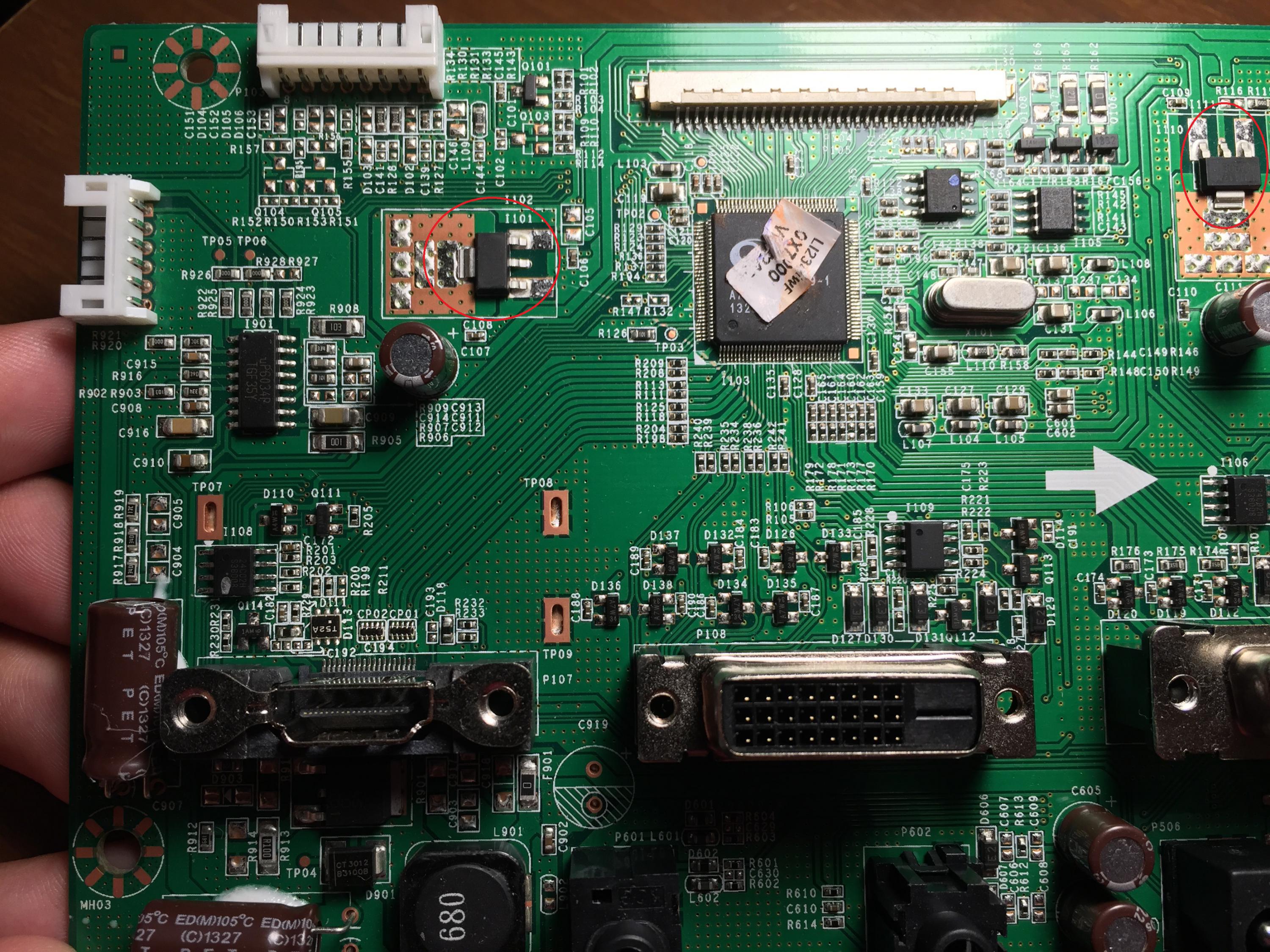

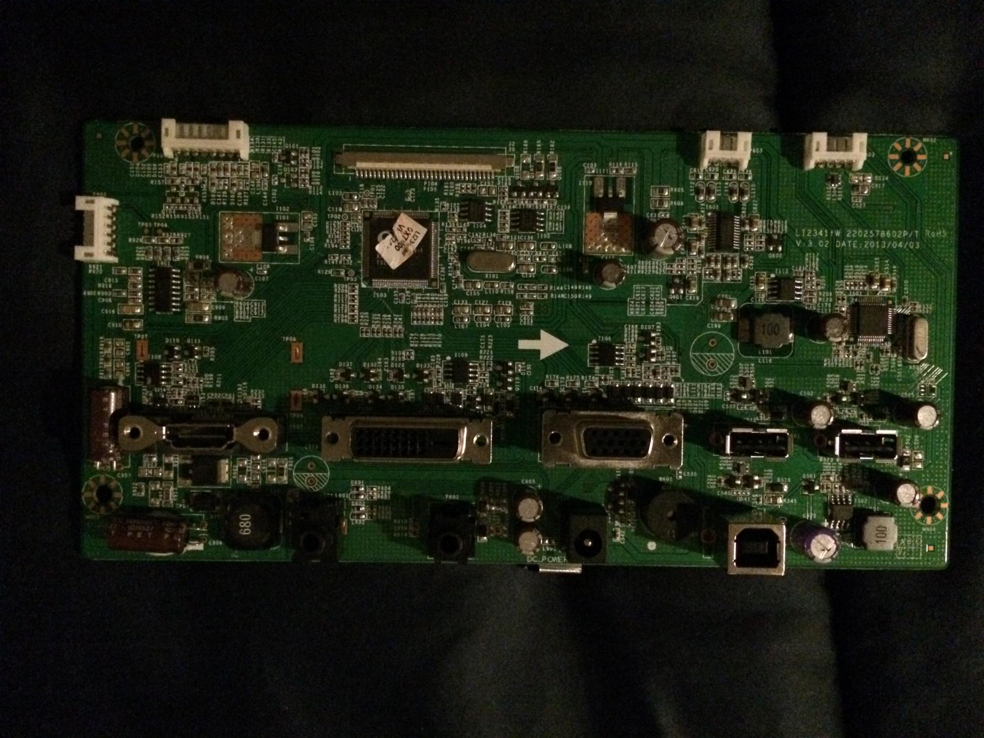

    Hello, so I bought a Lenovo li2341twf touch screen monitor about a year ago. Upon opening and first installation, it powered on for only a few seconds and then turned back off. We ordered a replacement, but lenovo never wanted the original monitor back.. so now I have this broken one laying around and I would love to be able to repair it.
    I am a bit of a noob when it comes to this, but I love to learn.
    I have torn the monitor apart, and observed what i could. All the capacitors look physically okay, no bulging, but I did notice that there are a few places on the board marked for capacitors that do not have any capacitors in place. I do not know what voltage or uF capacity should go there because... nothing was there before.
    Should I even try to install capacitors there? Where should I start / what should I do?

    If there aren't any caps present at that spot, it don't uses those caps.
    Probably that board is used in multiple screens in their assortment; probably those caps are used for circuitry your specific monitor don't use / have.
    You can open your working monitor and use that as a reference, not only to find out those caps are also not present in your working monitor but also for present voltages on certain points.
    Maybe you can lay the monitors side by side, both monitors powered up, measuring voltages at certain points and verify that voltage on the broken board.
    Maybe only some mosfet or voltage regulator has blown.
    Is the fuse still good?
    That monitor uses an external power supply, did you test it with your working monitor?

        Is that the only circuit board in the unit? How about the picture that show the whole back side so we can see how all the boards are connected together?
        I can see the main SDM fuse F901 next to C919 which is not installed.
        There may be more than one fuse on that board, so look for Fxx. F = Fuse

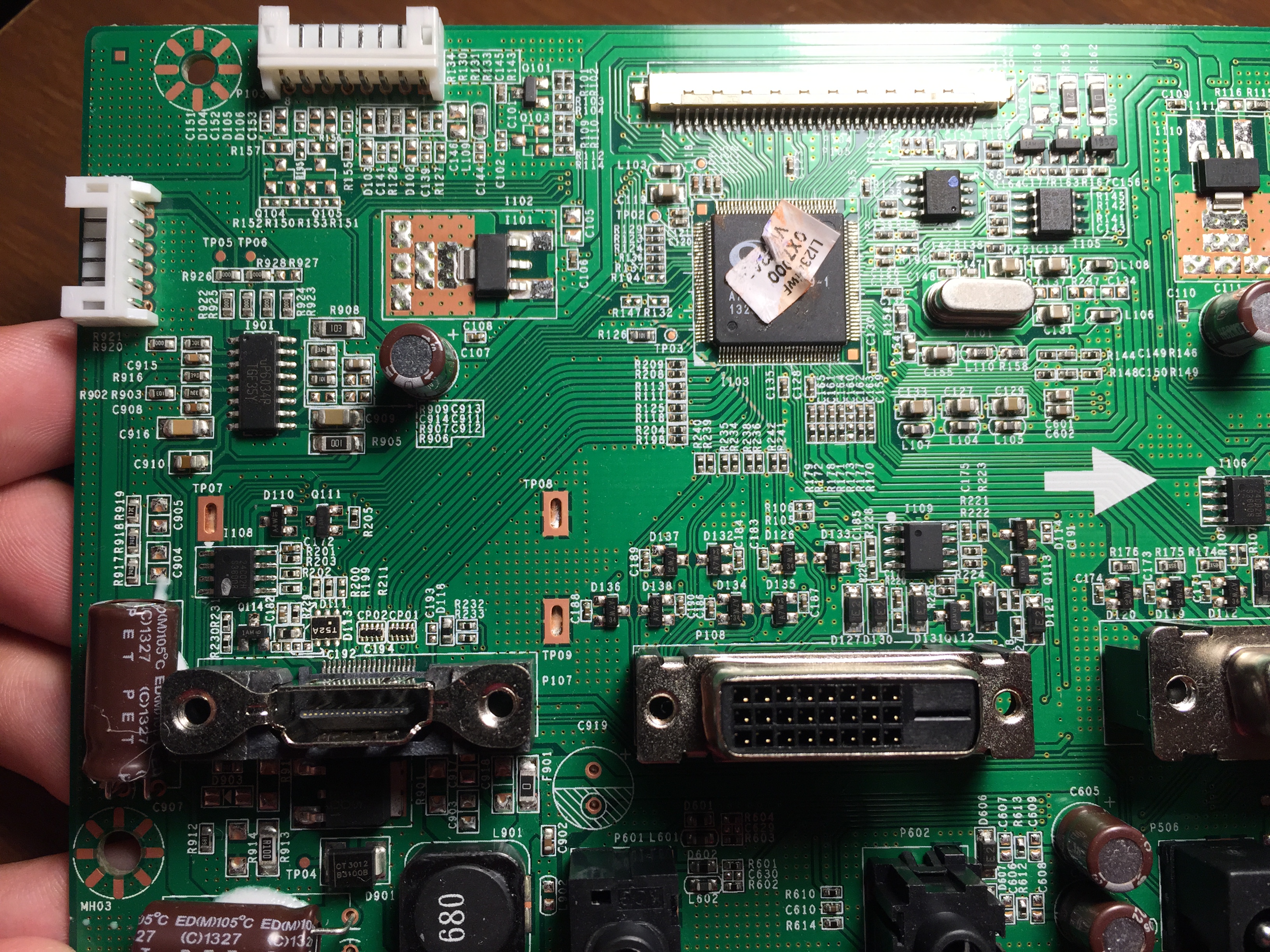

            Here are some better pictures possibly? I will try to test any fuses i find.
            How would I find a blown diode / voltage regulator?

                I believe I see two voltage regulators, the ones with '1117' on it, the parts with the center tab attached to those pink/orange colored spots.
                pin 1 is ground, pin 2 is output and pin 3 is input.
                Can you measure the voltages on pin 2 and 3 of those regulators?
                Without the schematics it's a wild guess what voltage it has to output but my guess is either 3.3v or 5v to power some IC.
                The diodes are the ones beginning with a 'D' on the board. You can measure them with the multimeter on Diode mode, the black probe on the side with the mark (most of the time a white line) and the red probe on the other; a good diode must show its forward voltage, 0.3 to 0.7v mostly. The probes reversed must show nothing or a few volts (when measuring in-circuit). Diode testing better be done out of circuit but that can be tricky when dealing with SMD diodes and you don't have the proper soldering tools to (de)solder SMD components (hot air station).

                    I've circled the two (sot-223 package) voltage regulators which I believe are LD1117AC types.
