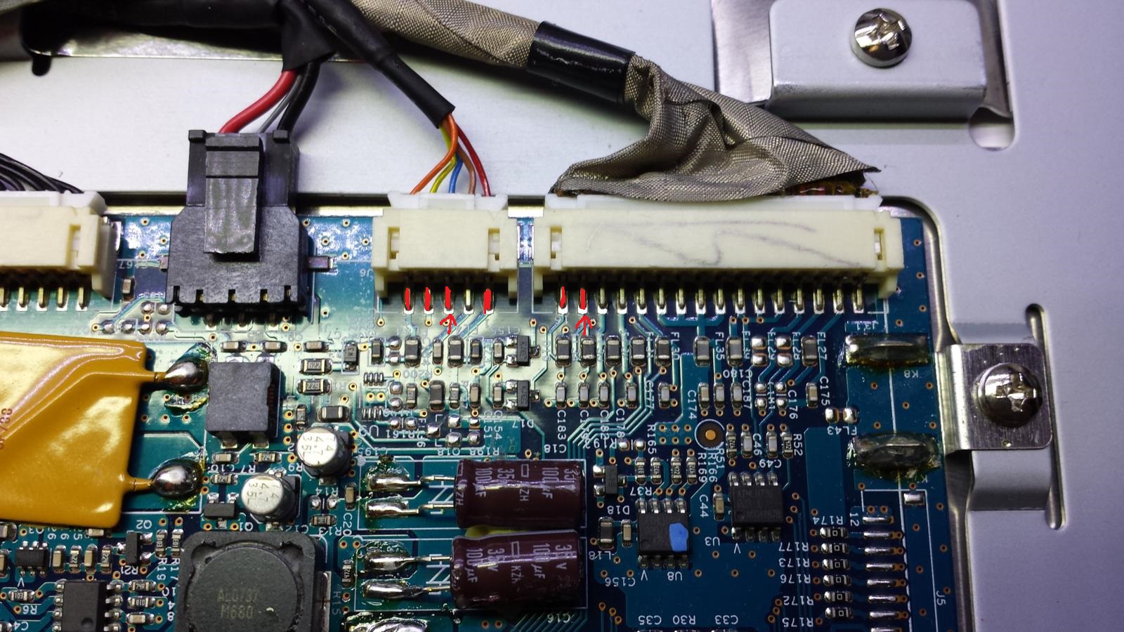

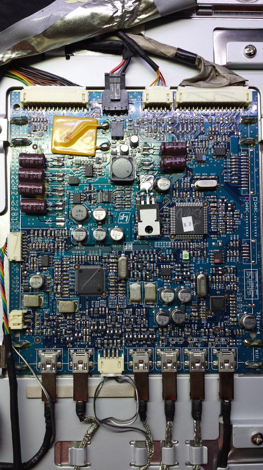

      There are multiple 8 pin IC's on the logic board so I have to check them for purpose and Vcc voltage / shorts.
      I've measured the voltages with the faulty and a working board side by side and found one fault; 2 pins on two different connectors don't have 5v on them, those connector pins are mainly coming from the DVI plug.
      A continuity test learned those two pins are originally shorted together so they get their voltage from one source. I'll check where the traces leads to, maybe it's only a diode or resistor which is shorted.
      I've taken two pictures of the board. The red marked pins must be 5v with only the DVI plug connected to a computer and the monitor detected.
      The pins with an arrow below it are those which are faulty on this board; as said above, they are connected together with a resistance of 0.2Ohm between them. They are connected to pin 22 on the DVI connector, that's the TDMS Clock shield pin. On the faulty board these two pins are connected to ground, where on the working board these two pins are NOT connected to ground... so, I have a short to ground somewhere.
      BTW: don't mind the TO-220 voltage regulator, it was there only for testing; it's already been replaced with a LM1084 dpak.

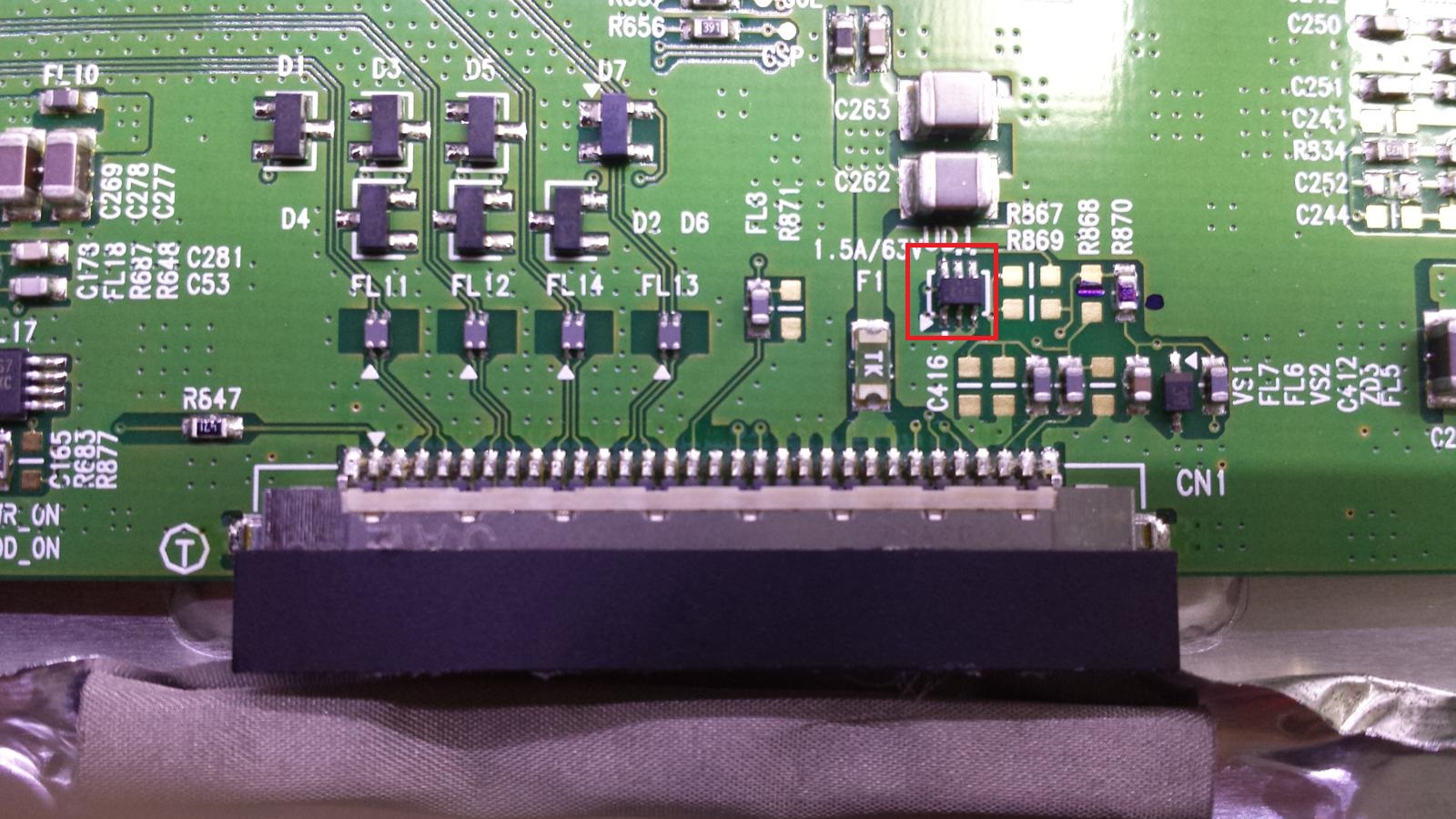

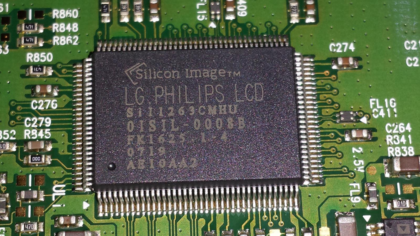

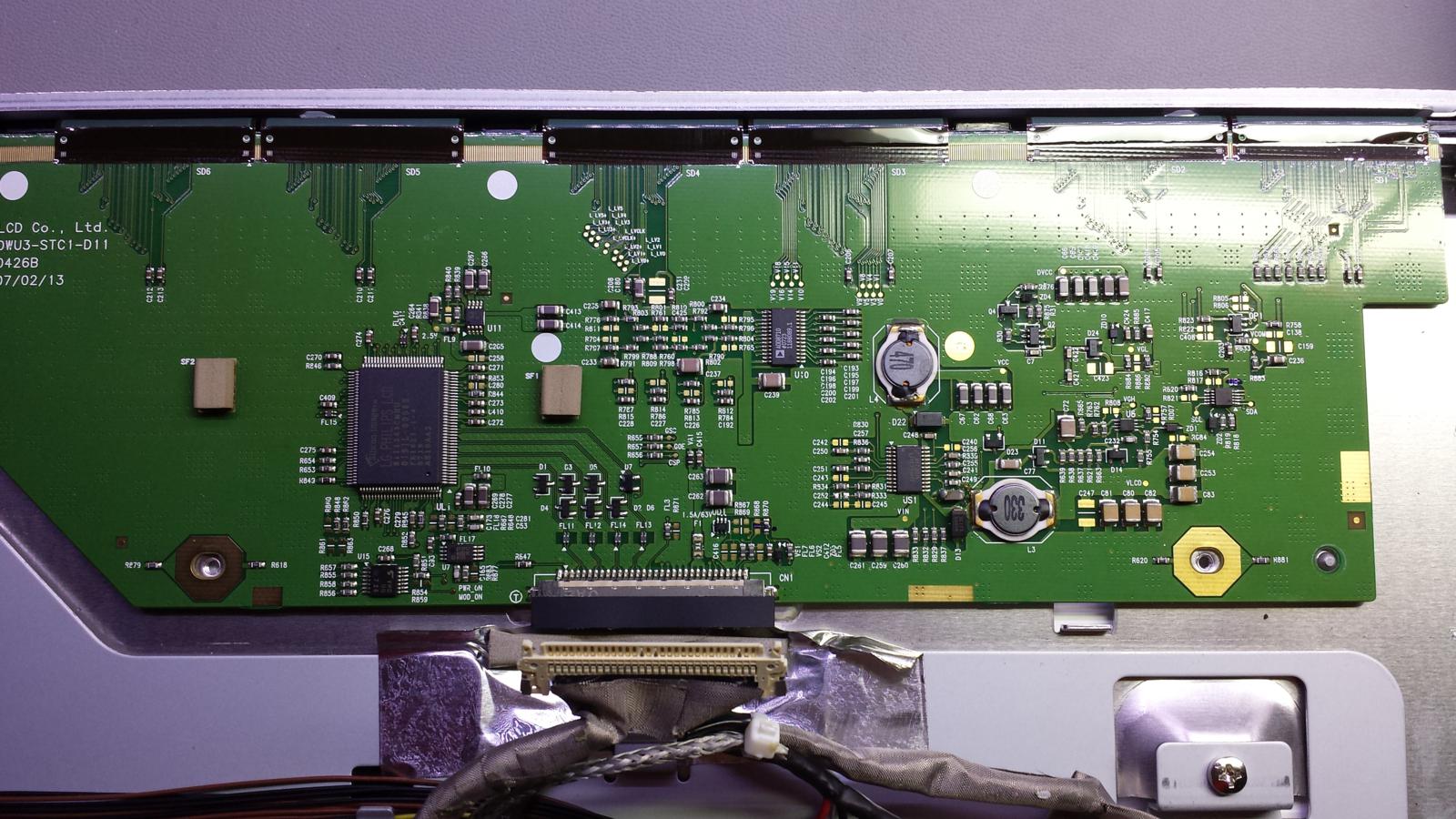

            I have isolated the problem to the Tcon board, well, it's the board directly connected to the LCD panel.
            With the interconnect cable disconnected I have still have that short on that board, where the working board does not have this short in place.
            On the second picture, the 3th pin from the right is shorted (the one which goes to that left ceramic cap).
            This is what I was afraid of, because now there is a very big change the main chip is shorted and I need another Tcon board to fix this issue.

                      Re: Apple Cinema display 23" ... detection problem
                      I found the problem with the short to ground!
                      I followed the trace where that pin 2 was going to and found it led to this little 6 pin IC (see picture). It is unreadable on the picture but it says: 'Z17B'.
                      In the SMD codebook I found nothing by that code but found an identical looking decoder/demultiplexer IC with the SMD code 'Z19'... it's the 'NC7SZ19P6X' from Fairchild.
                      I guess this '74LVC1G19' from NXP (Philips) is the same IC.
                      Vcc is pin 5 and that's also the case with the IC on the board, also pin 1 is connected to pin 23 of the DVI connector and pin 2 is the ground; these two last pins were shorted when I measured the chip out of circuit so it's blown anyway.
                      I tested with the same IC from another, working, board and the short to ground was gone. I plugged in the DVI plug and the monitor was immediately recognized by Windows. After this I powered the monitor up and I got a clear and fully functional image!
                      Thanks for all the suggestions / tips, guys!
                      I hope I am right and it's logical to have such IC in this circuit; I guess it functions as some sort of voltage comparator or something?
                      Can someone confirm this kind of IC is used for this particular circuit? (waits for voltage coming in from DVI plug and activates the main graphics chip?).
                        My above assumption (read: very wild guess) was wrong, it is not a decoder/demultiplexer IC.
                        Luckily I didn't already order it.
                        After a long search I found this AliExpress store which also did write the SMD code in the advert... because most sellers do not.
                        Also the pictured SMD chips have the print 'Z17B' so it must be the same ones I need.
                        http://nl.aliexpress.com/store/produ...048876370.html
                        It's a Schmitt-trigger, the 'NL27WZ17-D
