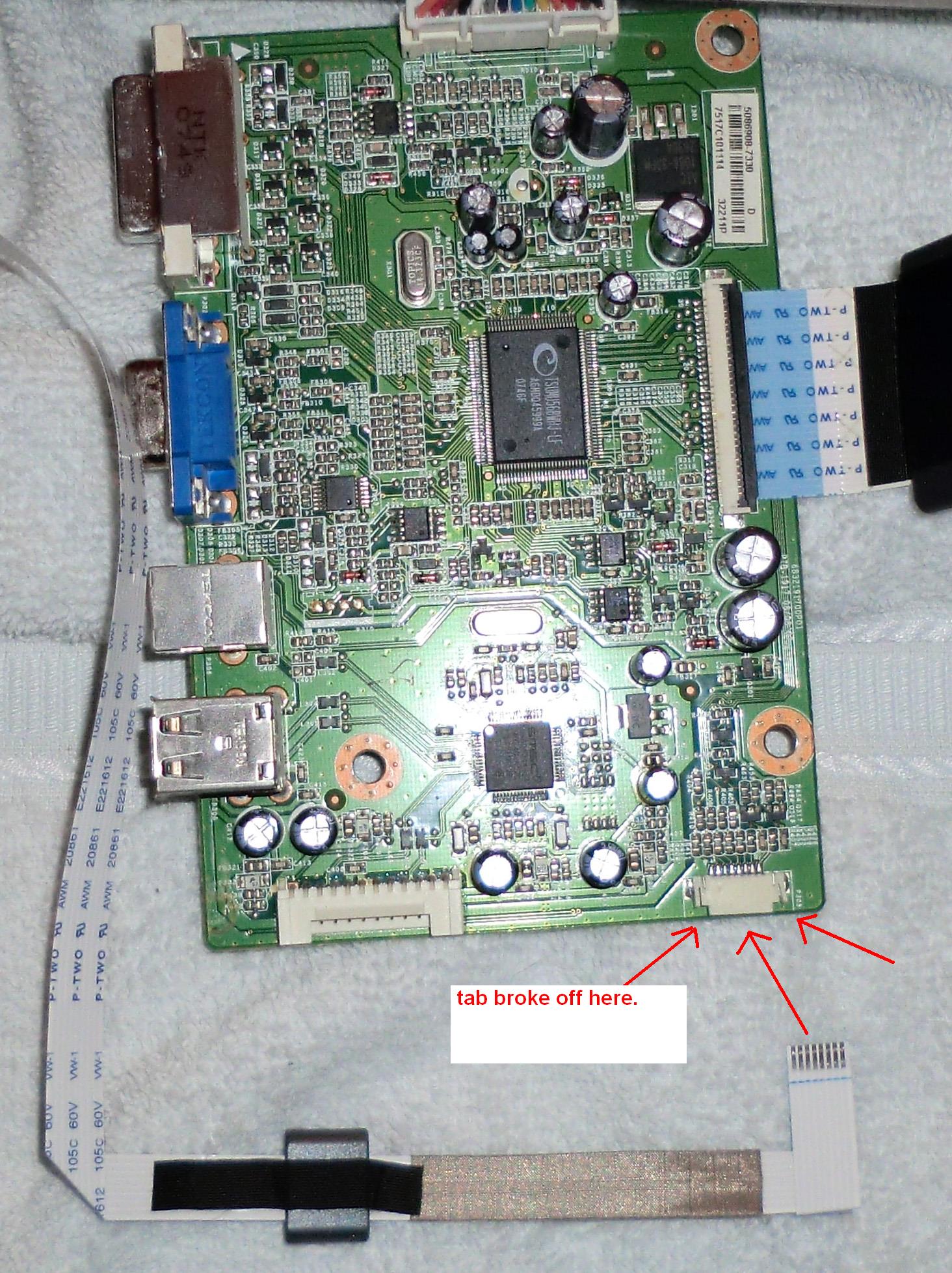

    I'm trying to repair a Dell 2208WFP LCD monitor. The backlight goes out after turning it on for a couple of seconds. I managed to disassemble it and identified some bulging capacitors on the power board.
    However, since this was my first time disassembling a LCD monitor, I accidently pulled one of the ribbon cables out too hard and broke a plastic connector tab holding it in.
    Specifically, this is the small ribbon cable that connects to the front bezel menu buttons. The connector tab I broke is colored brown, and seems to hold the ribbon cable in by only friction. Should have probably pushed instead of pulled. Anyway, no amount of glue will help, as the connector tab is small and hopelessly shattered to pieces.
    But, I think if I found a replacement, I could snap it back into its holder, and everything would be ok again. I don't suppose any stores would sell this kind of connector separately? It seems to be a common part among all types of LCD monitors, but I don't know how common.
    If I can't find it separately, then what is the smallest and cheapest part I can buy that includes it?
    btw, the connector is labeled P305 on the PCB board. The white housing is ok. Just the moveable tab part was broken.
    Forget to ask, does this connector have a name? It takes 8 leads or pins.

      Here's a picture of the ribbon, board, and connector.
      Ribbon is labelled P-TWO AWM 20861 E221612 150C 60V W-1.
      It's the white connector that this ribbon connects to that I'm interested in.
      It had some kind of plastic push/pull gate tab around it that broke off and snapped.
      Don't know what's it called or how to find a replacement.
      I also found a service manual for Dell 2208wfp, but I could not find part P305 on it.

        Picture of the broken tab that holds the ribbon in the connector.

          FFC (Flat flex cable) receptacle or socket.
          Find one with the same pin number and pin pitch (distance between the centre of each pin) and make sure it's surface mount.
          Start with this list for example: http://www.digikey.com/product-searc...=0&pageSize=25
          Need to know the pin pitch though.
          Will be difficult to replace without damaging the board if you do not have a hot air tool though. (Heat gun could work if you are VERY!! careful)
          You might be able to jam a piece of cardboard or something in the broken one instead of the clip though.

                Why not try just putting the cable in, pushing the broken locking tab in, and sticking the whole thing together with a piece of tape or a small drop of breakable glue\wax. Those cables don't typically need a whole lot of force to hold them in the connector so you could probably get away with such a repair.
                Personally I would replace it with a new connector but yeah if you don't have the right rework tools that would be hard.

                    As you have the old clip did you try sticking it together use epoxy not superglue.
                    If that is a no go then look see how thick the clip part that goes against the
                    ribbon is and find something the same thickness - credit card?
                    If its thinner than it looks then on the side of the ribbon without contacts build it up with layers of insulation tape to the thickness insert it then as has been said -tape the whole thing in position or add dabs of removable glue/sealant
                      Re: Dell 2208WFP backlight issue
                      I've cut bits of plastic to use as a shim when these type of clips have broken. Thin packaging type used it blister packs. I have also tried taping the cable down, but it was holding the cable away from the pins and wasn't making contact. I needed to put a bit of thin foam tape in fron of the connector to raise the tape up before taping down.

                                      Well, I finished my work and put everything back together. My backlight is now on and working great.
                                      I think I will leave it on for a couple hours to see if it holds or not.
                                      If anyone has the same Dell monitor, this is what I ordered from Digikey:
                                      P12413-ND
                                      This is a Panasonic 330uF 35V aluminum capacitor, FM series.
                                      Bad caps on the board:
                                      C127 = CapXon 330uF 35V, replacement: P12413-ND
                                      C128 = CapXon 330uF 35V, replacement: P12413-ND
                                      C815 = CapXon 330uF 35V, replacement: P12413-ND
