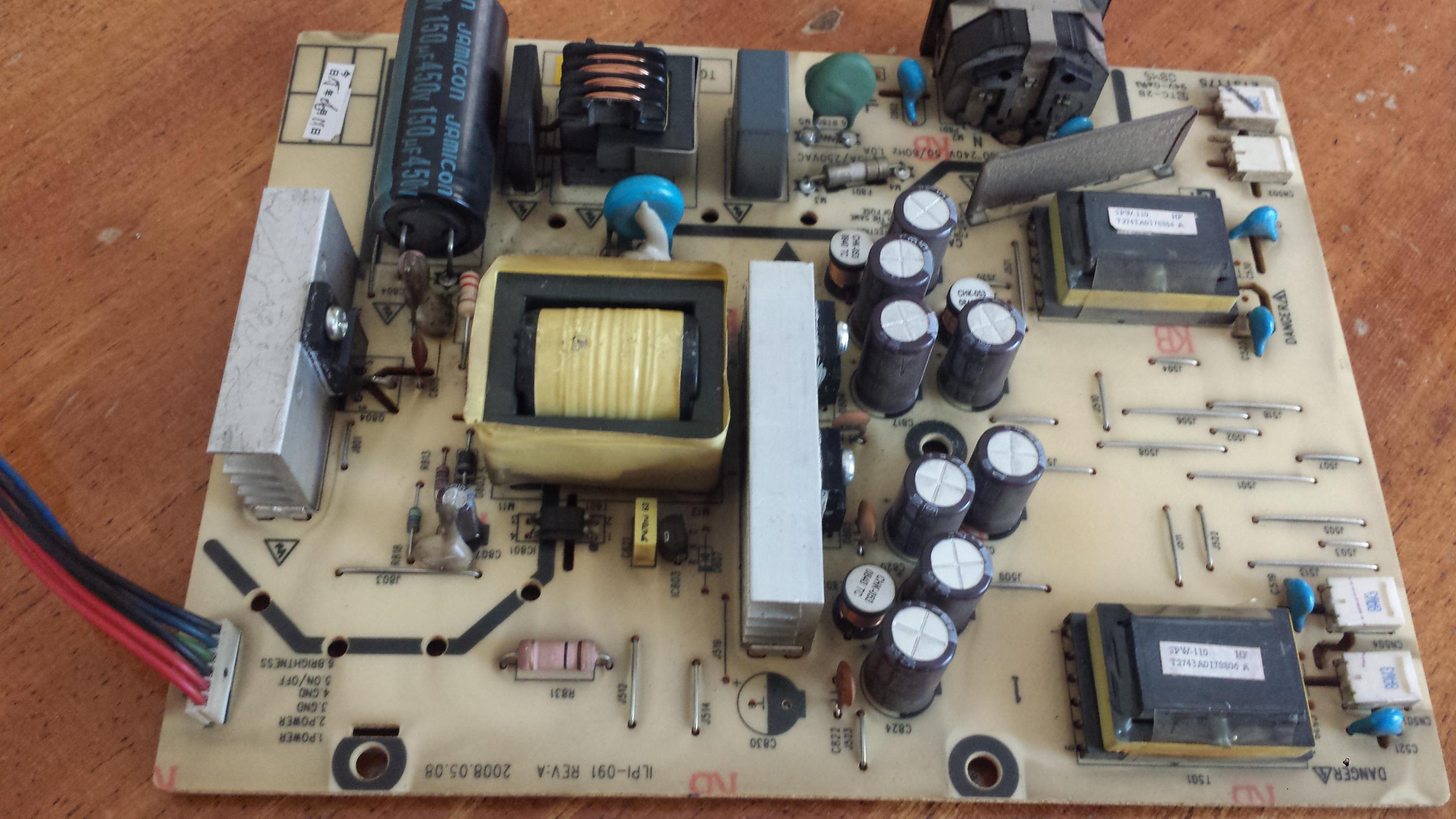

    Hello all and sorry for my english.
    I found an lg w2234s monitor without power board and i bought one from ebay. He said tha was 100% tested working but the monitor doesn't work. I dont have the 12V and 5V to the output connector. I tested alla diodes on board and are good as the electrolytic capacitors are good. Can anyone help me? What could i look?
    Also on the big electrolytic capacitor(150μF/450V) i have only 20V. I think that is no good..
    I could take and clear pictures if necessary..
    Thans in advance!

          Also i found this mosfet on the board
          but the service manual says that Q804 mosfet is this
          I'll post and two pics from board and service manual link

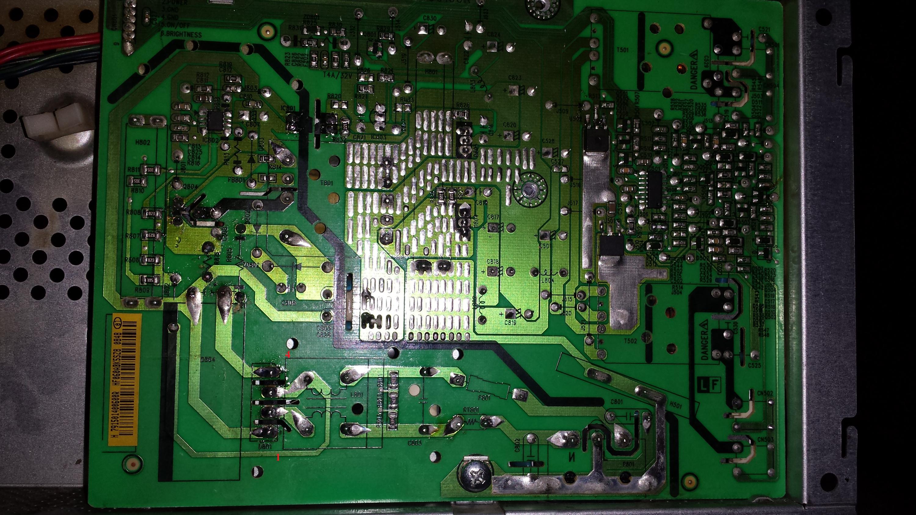

                two pics of the board

                                    The picture of the bottom side of the board is cut off and cannot see the pins of the connector that goes to the main board.

                                      As i said to the post #5 i found FQPF8N60C mosfet instead AP2761I-A as service manual.(i bought the biard from ebay) i'm in work now when i'll go home i'll test the mosfet, the transformer on the secondary and i'll measure the DC of c807 as budm says..
                                      also i'll take a better picture of bottom side.
                                      To the connector with two red wires i dont have any voltage. I tested with main board connected and not already. Should i have ~12V on power pins(red wires) and 5V(pin on/off), right??
                                        Re: lg 2234s no power at all
                                        Ah, sorry, forgot about that mosfet being another one.
                                        Maybe the board was already repaired once, hence the other mosfet type.
                                        I would now surely test it because maybe it failed again.
