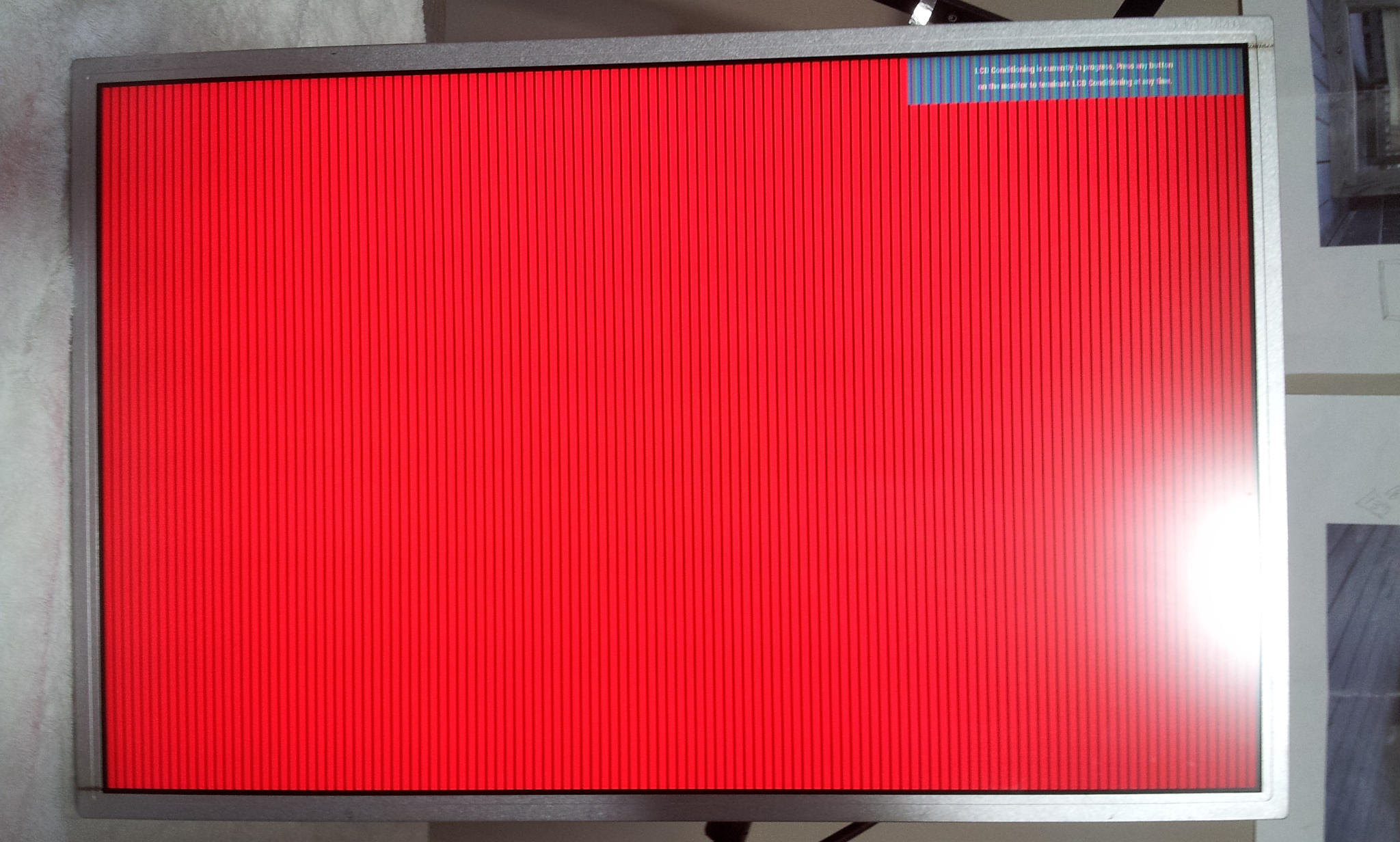

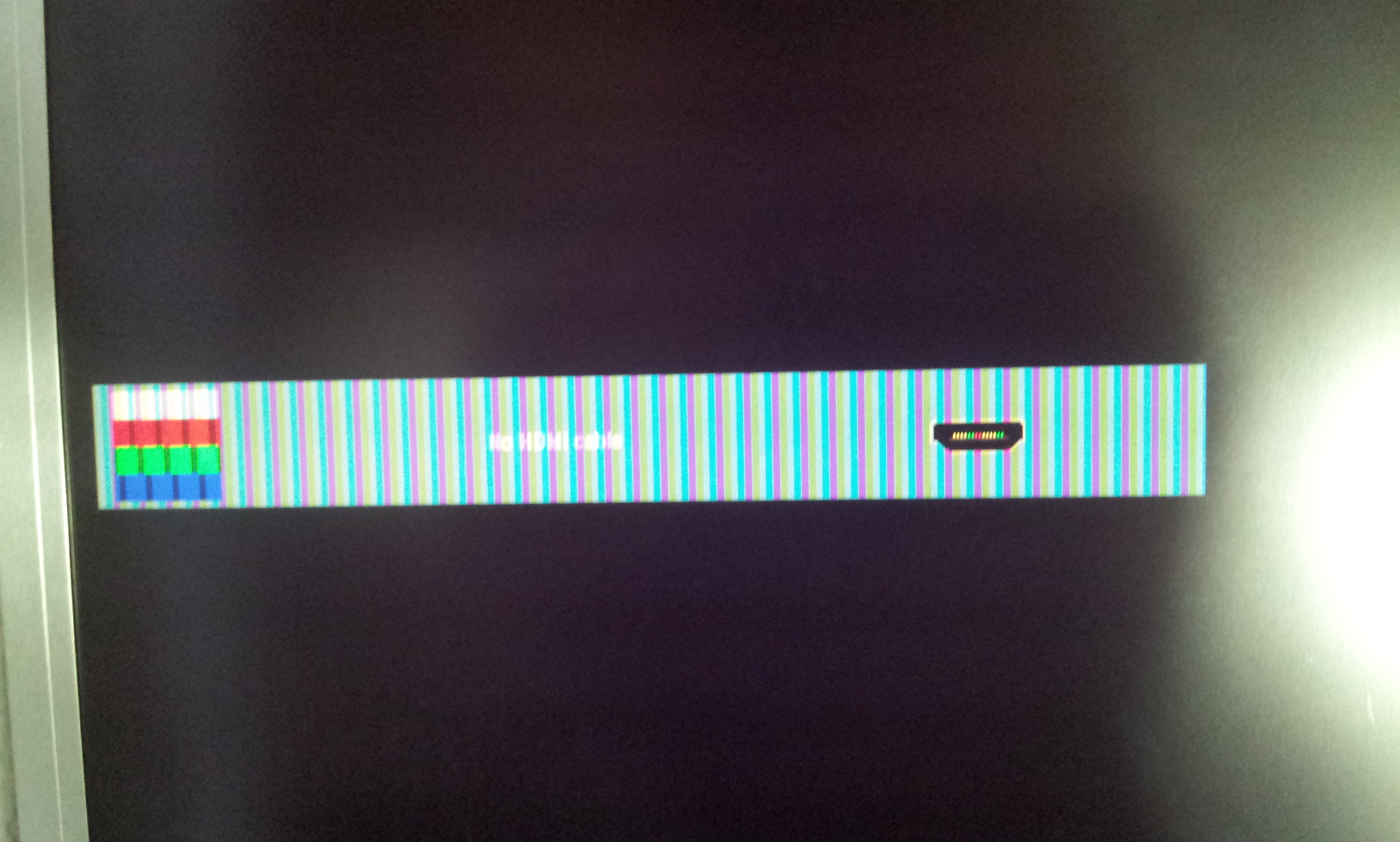

    Hi All,
    First off - I'm thinking that the problem is the TCON board based on other posts from all the clever individuals I've read here on Badcaps (https://www.badcaps.net/forum/showth...=Dell+2408wfpb,
    but I'm open to other suggestions

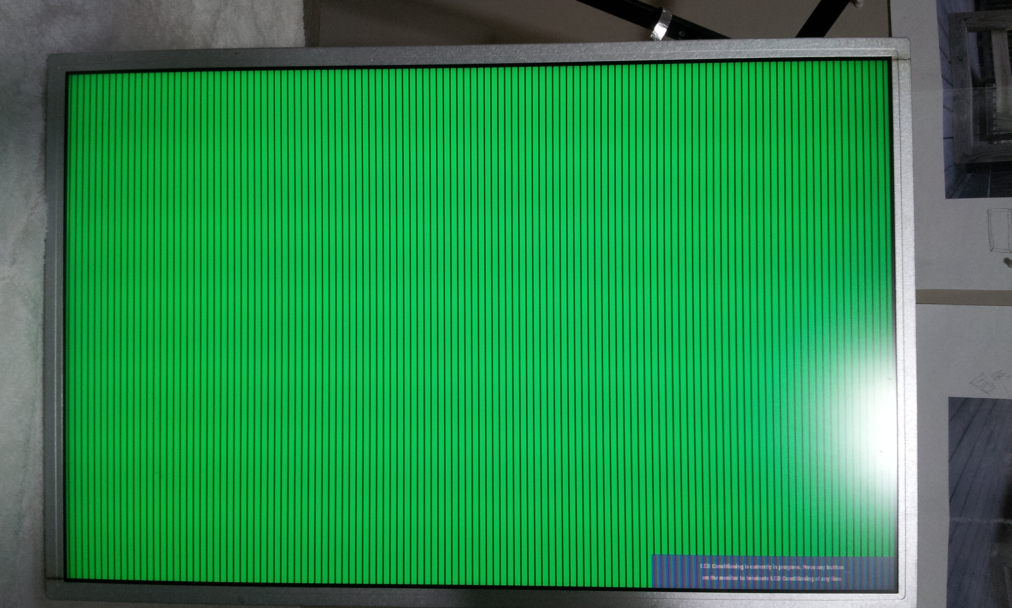

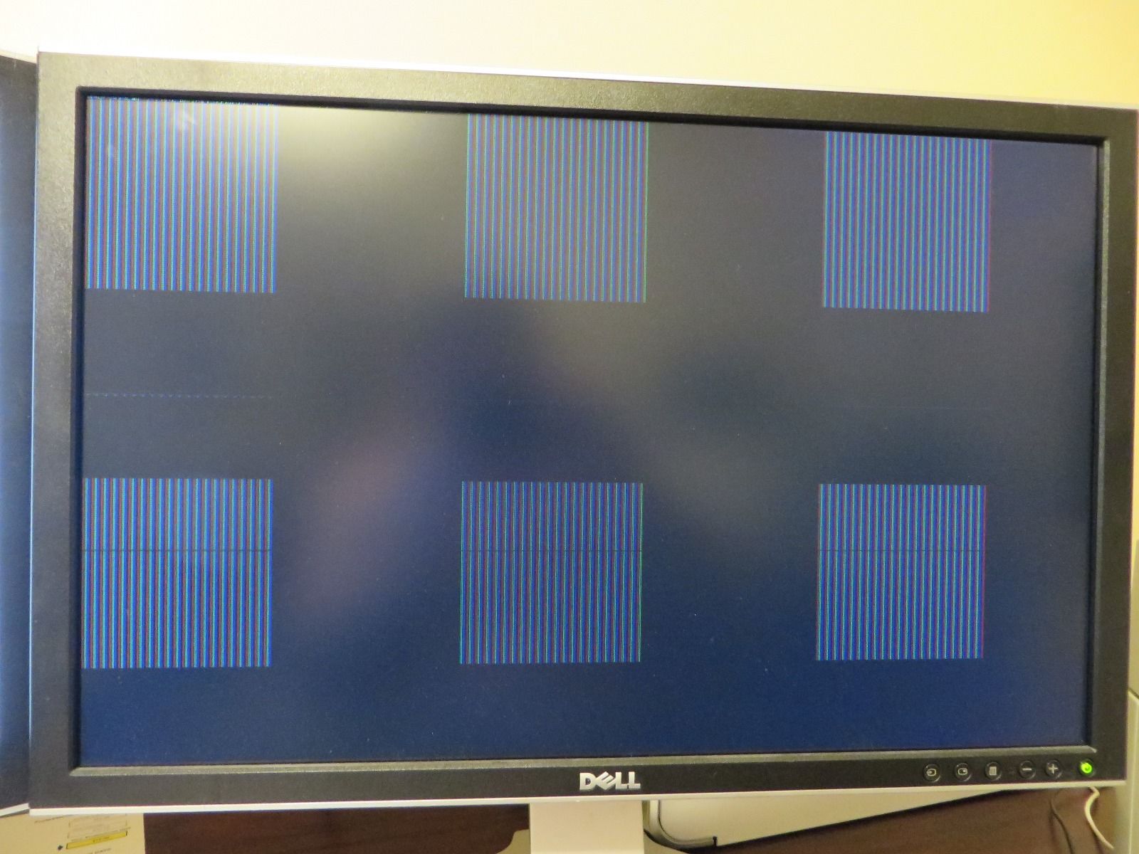

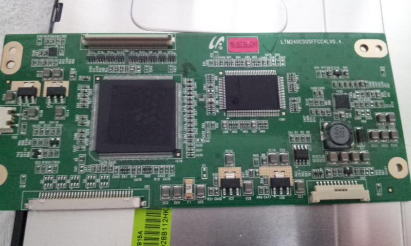

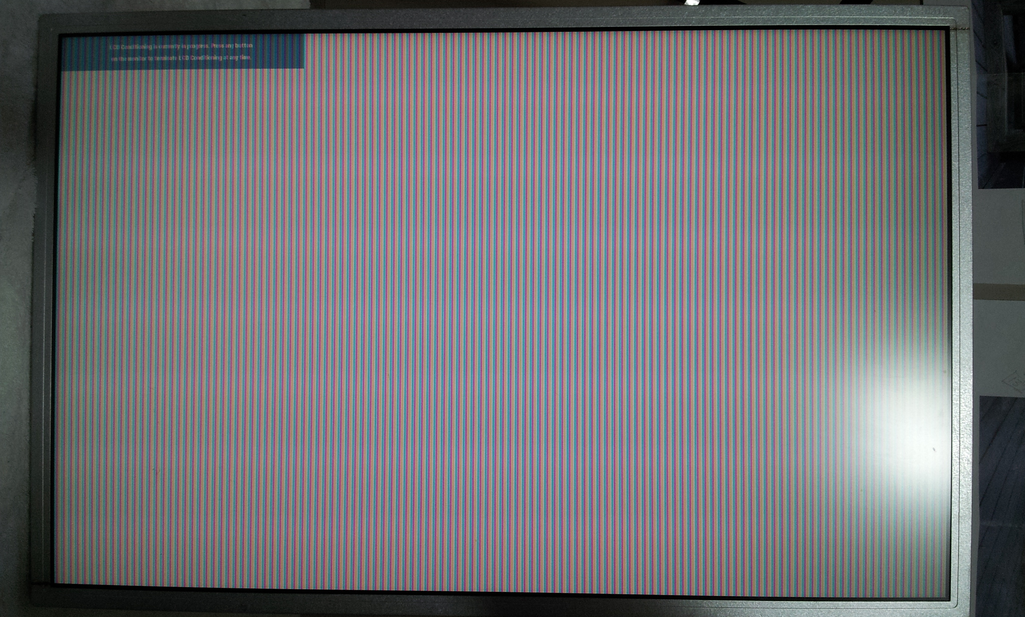

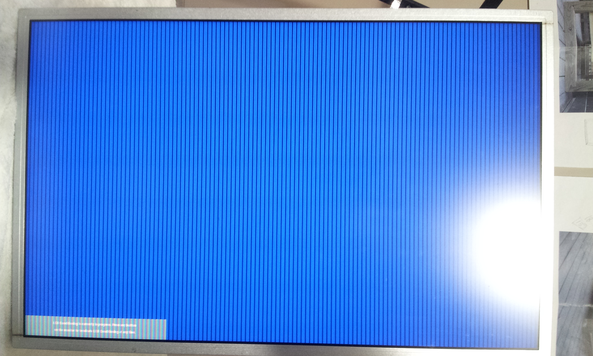

    First pic is not mine, but its the same as what I see, except mine is much dimmer and I cant take a good picture of it. Rest are mine. Displaying Red Green Blue and White test patterns I see a repeatable pattern, vertical lines of R G B are missing, resulting in Cyan, Magenta, and Yellow on the White pattern. This happens after being on for 1 min. Everything works fine at first startup then looks like the pics
    Real question is: I see people have had problems ordering from AliExpress. Has anyone had a good experience from a particular vendor that would sell this board ? (ltm240cs05ffcc4lv0.4.)
    this is a few that come up... any suggestions are appreciated.
    Also I live in Canada, which is a problem ordering from american vendors sometimes because of the CRAZY shipping rates, I guess due to customs fees etc. Not sure how China vendors can offer free shipping since the US is so much closer.

    Re: Who do you trust on Ali Express? (Dell 2408WFPb TCON)
    Not a particular seller, but i've been ordering from Aliexpress for a few years. Never really had any issues and the couple of times either a part was the wrong one, or quantity off, i have either had a discount or the correct part sent.
    The Chinese government subsides their postage, hence the cheap rates.
