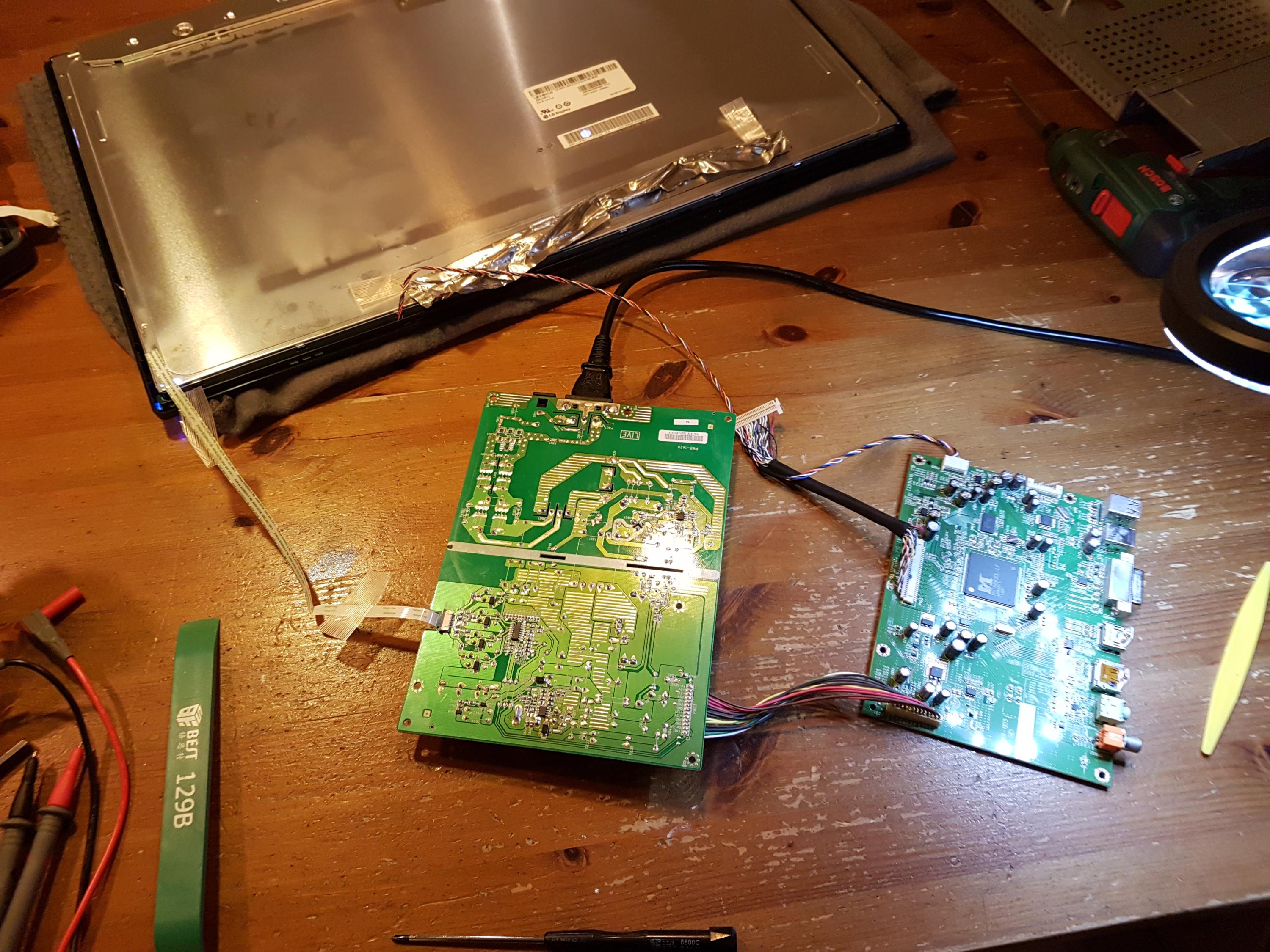

    The type number of the LED driver chip is OZ9907GN. I also have the problems mentioned above with this monitor type. I read perfect values on the power supply (5V/12V) and the monitor works perfect when I disconnect the flex cable to the LED backlight first. The blue power light is up and running and after 10 seconds, the monitor goes into standby mode and the yellow light turns on. I read 75V on one of the pins of the flex cable wires and the BLON signal cable reads 3.3V. When I connect the flex cable, the monitor doesn't turn on, the power light is off, BLON=0V.
    I suspect a faulty LED backlight strip, or maybe something is wrong with the IC. It's a pity that nobody fixed this problem yet...

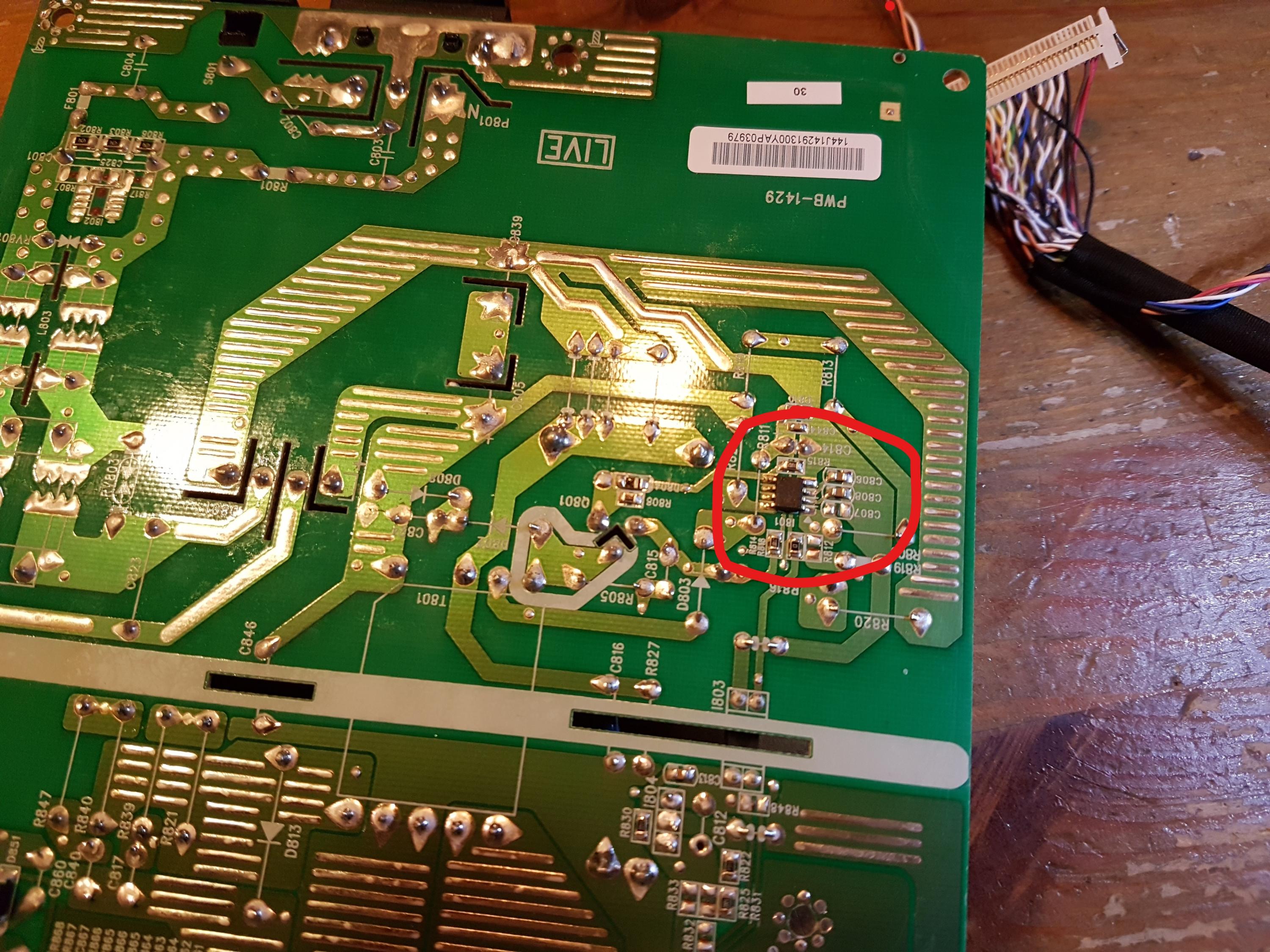

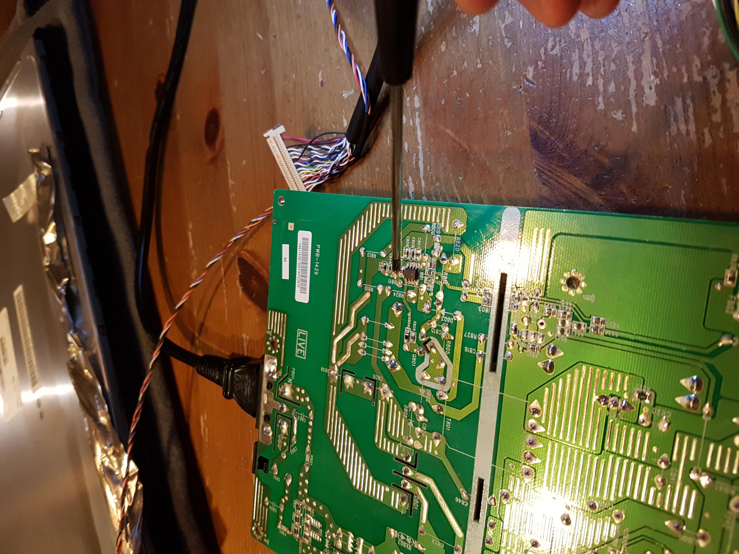

      Re: HP ZR2440w backlight cutting out
      I did some additional investigation of the power supply and it seems like that the LED driver IC and the LED strips in the panel are OK. I found something really weird in the primary part of the power supply. When I connect all boards and cables and I switch on the monitor, it stays dead. Ok, here is the trick. When I HOVER my screwdriver over the PWM IC (OZ531GN), the monitor and the LED backlight turn on. It looks like there is some capacitive "sensing" that activates the IC and the rest of the circuit. I will try to measure the circuit with my oscilliscope later this week.

        Ginko - you have a very similar problem and circuit to the one i am trying to diagnose. From your pics I can see the ZR2440W is like a cutdown version of the 2740 that I have. Probably they've used the same controller ICs.
        Please try altering the brightness on the front panel control and see if it becomes stable at high brightness. I wasn't clear from the above if you tried swapping the LCD panel (i.e. including the backlights) from one of your good monitors into the bad monitor. That way you can tell if it is the LEDs or not. From what you described i guess this is not your problem. I have had one of these with one the LEDs strips open circuit and it causes the monitor to shutoff completely.

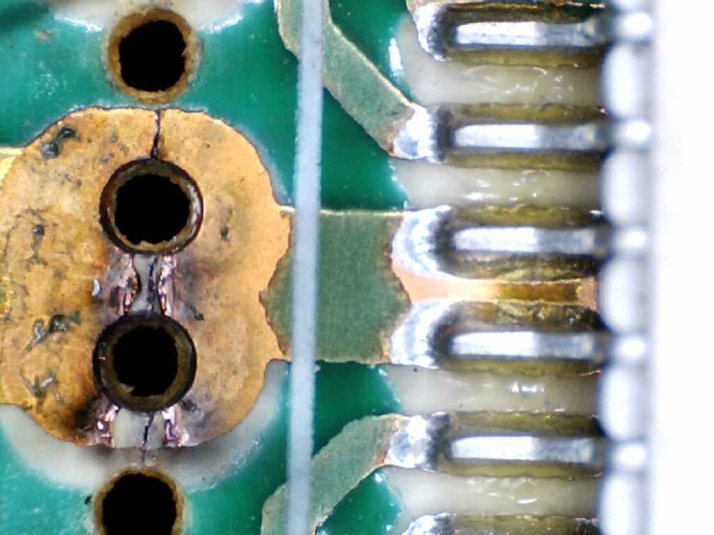

          Hi, had the same monitor with very dark backlight, mine problem was with cracked pcb copper on the pads near the backlight flex connector on the power supply. As seen on some photoes, they are tinned one some boards, but mine were not. Just soldered them and backlight works)
          Hope this helps somebody)

              Hi i have the same monitor, but my problem is with HDMI slot doesnt working,
              sometime work, sometime no, but for you case i was solvedone the problem was on trip lines near the backlight flex on motherboard conector after resolder the trips from fuse-to-backlight connector the problem was solved for backlight.
