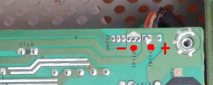

      Re: No 5V on inverter board of Dell 2007FPb
      budm, many thanks for the quick response. I believe the PICO fuse is OK, as it measures 0.3 ohms across. (The PICO fuse is FP801, yellow resistor-looking part near the edge of board, yes?). The primary DCV is ~19.5V (I think it's supposed to be 19V nominally, by design).
      I'm beginning to suspect that the 5V is supposed to be supplied from the USB board to the inverter board, but its not making it out of the USB board for some reason. (Makes sense logically). I've identified three signals (TP716, TP714, TP713) that originate at the USB board and terminate at the inverter board (they're simply routed via visible copper traces from the USB connector to the inverter connector on the original Power Supply board. Since I'm not using the original Power Supply board, I've temporarily hand-wired these Test Point connections between the USB board and inverter board. I'm 99.9% sure the connections are wired correctly).
      I just went back and measured each of the above Test Points and noticed that there is 3.3V on one of the pins, and the other two are at 0V. Maybe those other two pins are supposed to be 5V and ground? I will have to see if I can find a path from the 5V rail on the USB board to one of those connector pins. Maybe there's an open resistor or something in the path. Having a schematic sure would help. :-) Do you know anything about the USB board circuit that may be of help? Sure would be appreciated.
          The pins on the inverter connector measure:
          1,2,3 = 19V
          4,5,6 = Ground
          7 = 0V
          8 = 3.3V
          9 = 0V
          I started to trace pins 7,8,9 on the inverter board and you seem to be correct about the 5V being generated on the inverter board. I only have a partial schematic sketched out (and it ain't pretty yet), but its starting to look like the 5V is generated off of the 19V input, as you said. I almost have enough traced out to determine how the 5V is generated, so I will post that portion of the schematic when I get it cleaned up. Might be helpful to others.
