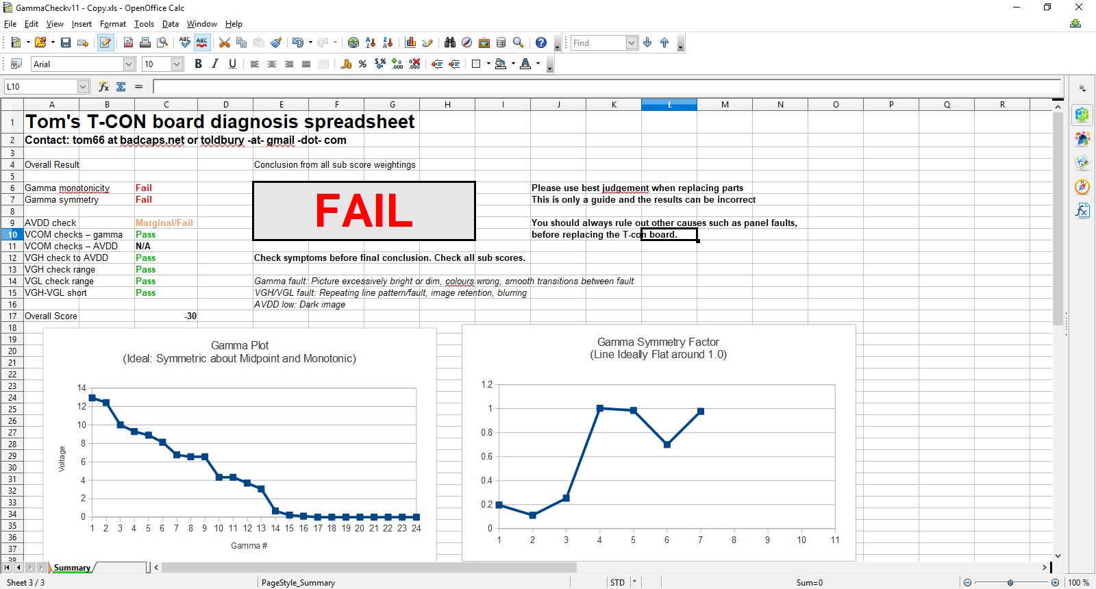

    Oh, that's a nice spreadsheet - thanks for the pointer. It indicates the tcon board is bad, but to check the panel first before replacing the tcon board. I'll search around the forum for how to do that.

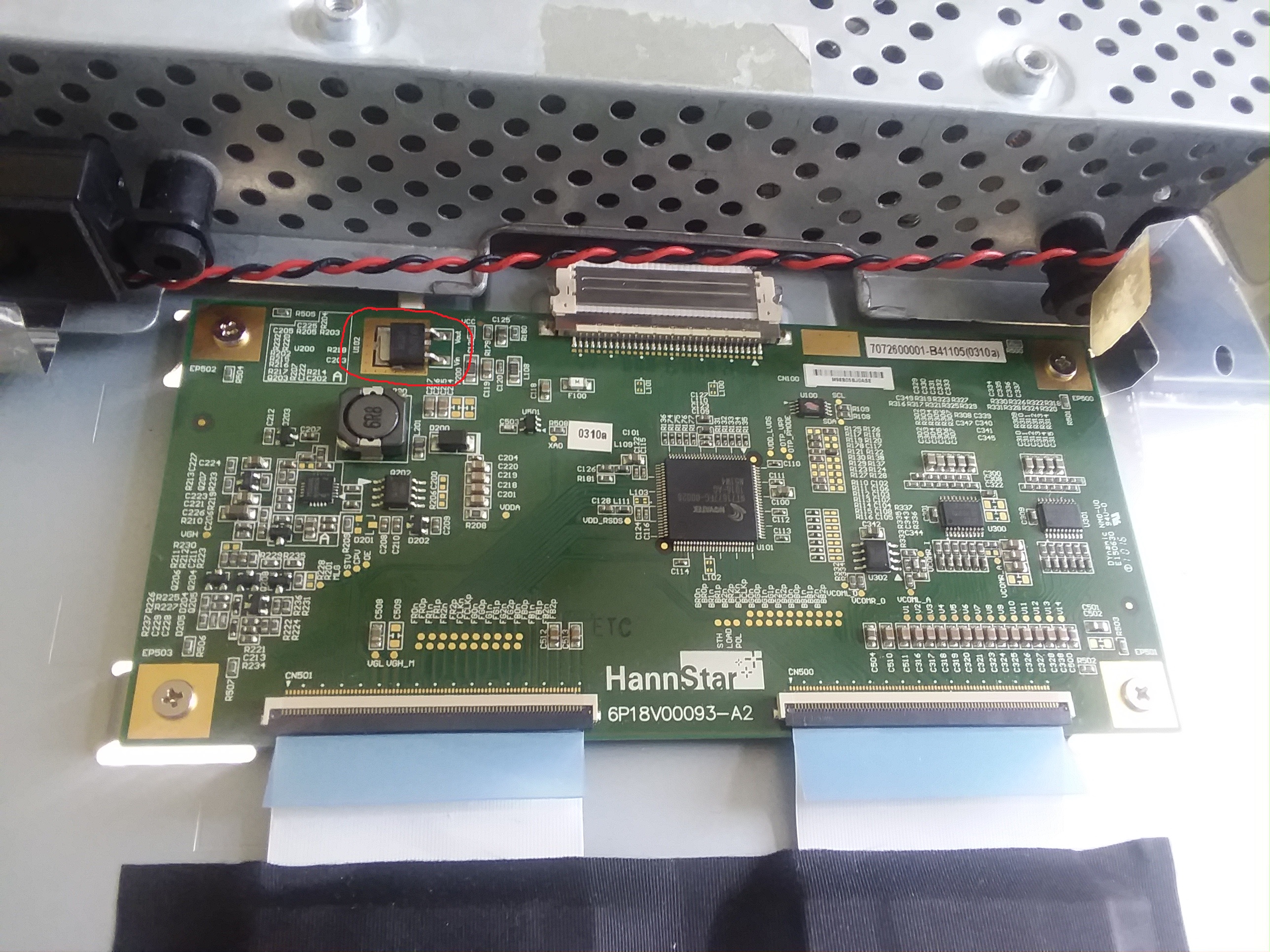

      Well, I'm not sure how to test the panel itself - I jiggled all the ribbon cables to the driver boards with no effect. Looks like there is no availability for this tcon board, so I'll need to attempt to diagnose and repair the one I have. The u102 transistor (circled in red) measures 7.3k Ohms middle to right leg, and 100 Ohms middle to left leg.
        Good find.
        But left leg is the input, so 100 Ohms is not necessarily a problem.
        That said, see what voltage is coming to the left leg of U102 (with respect to ground) and what voltage it is outputting on its right leg (again, with respect to ground).
        Also, could you please tell us what part number is written on U102?
          Re: HANNS G HZ281 White Screen
          That is Voltage regulator IC, not transistor. See what Voltage you have on Vin and Vout pin.
              U102 is a 960T45. Left leg is 4.96V, right leg is 3.24V
                U300 and U301 are both BUF 07704, which Mouser says is a LCD Gamma Buffer.
                960T45 is 3.3V regulator, it is OK. https://cdn.badcaps-static.com/pdfs/...2741533542.pdf

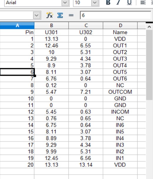

                      Below and attached (the formatting is messed up here in the post) are the voltage readings from the BUF07704 chips. The OUT side seems to correlate pretty well with the IN side.
                        https://www.badcaps.net/forum/attach...3&d=1536778904
                        Look at INCOM and OUTCOM of U302: U301 INCOM is 5.45V, OUTCOM is 5.47CV, but U302 INCOM is 0.63V and the OUTCOM is 7.21V
                        Look at pin 1 of U301 and 302: 0V on U302?
                          #32
                          Oh, I messed up pin 1 on U302 (VDD) - it's actually 13.13V, so ok there.
                          I see what you are saying on INCOM/OUTCOM on U302. I just double checked:
                          12 INCOM: .64 steady
                          9 OUTCOM: climbs from 1-3 volts up to 6-7 volts everytime I probe it (climbs for about 30 seconds)
                          Are you suspecting U302?
                            Yes, I expect U302 to behave the same as U301, it is buffer after all.
