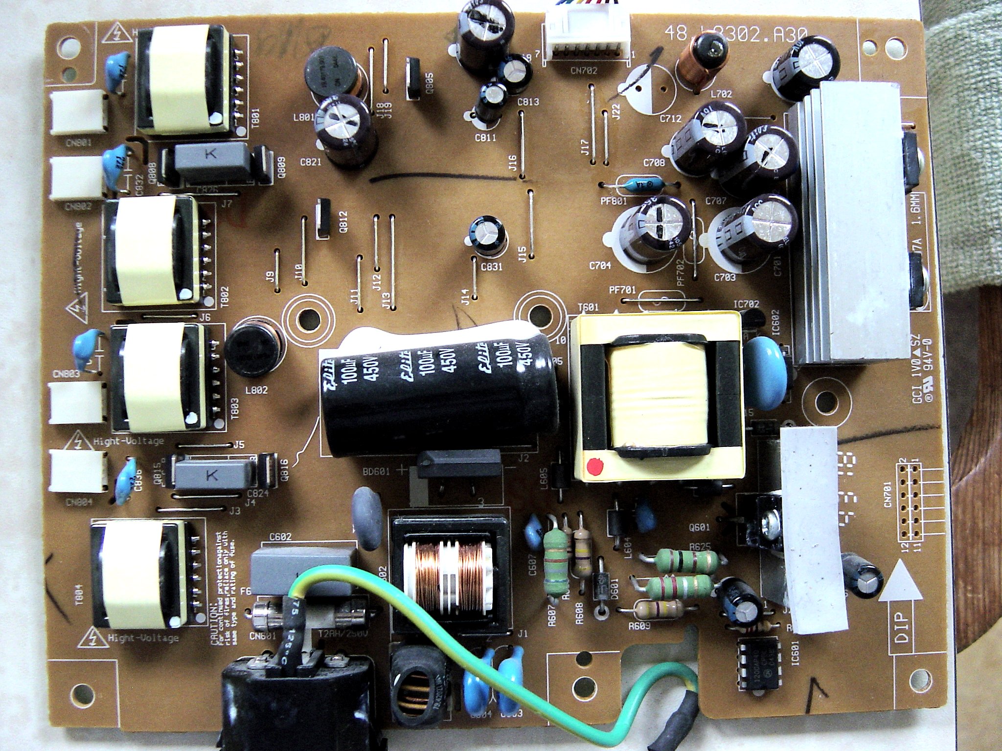

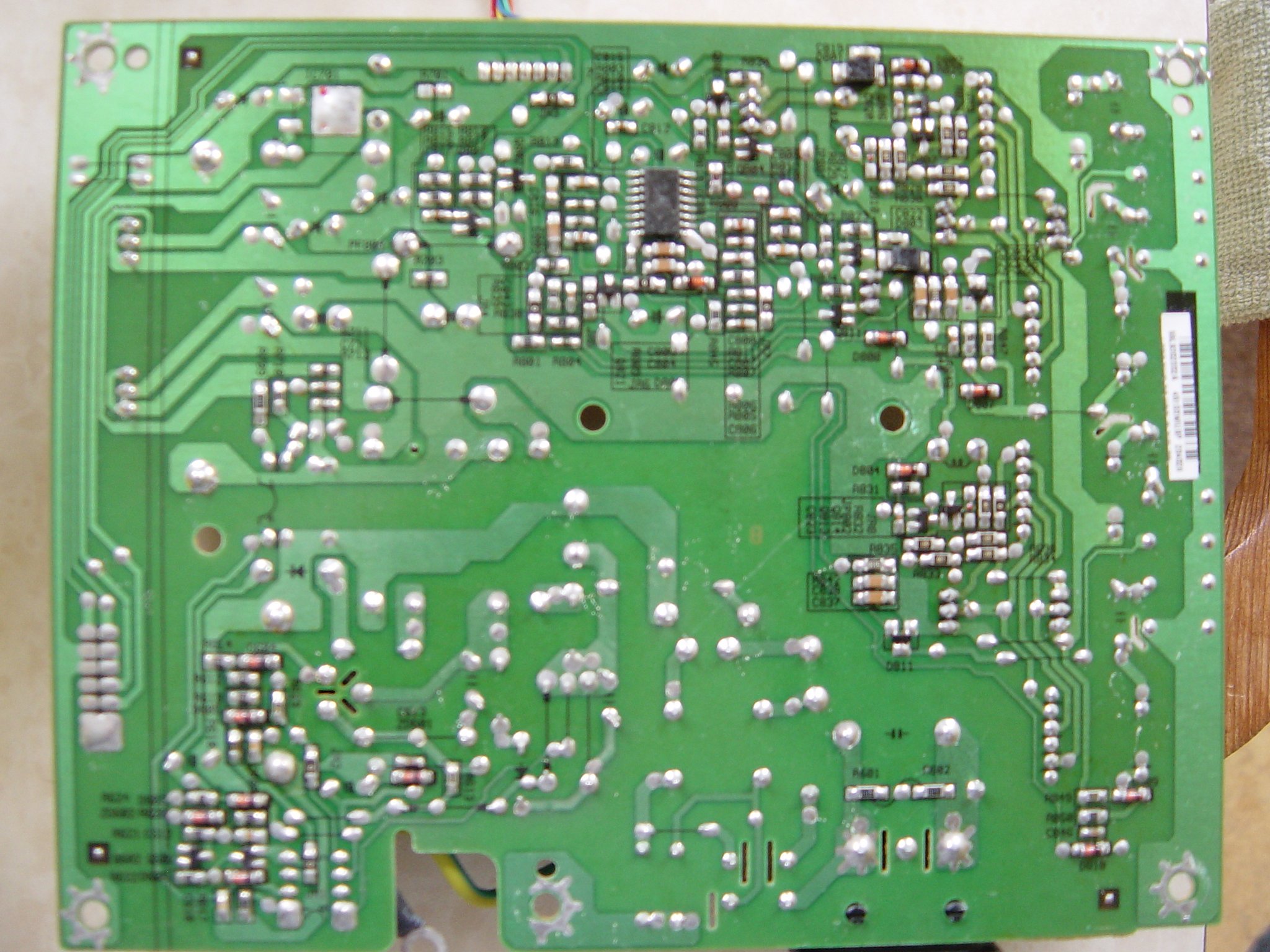

                                  I just joined this forum, and have read through numerous posts to try and fix my Q7T3 Benq monitor.
                                  I have been getting the "2 seconds to black" problem. Although, at first, after switching the monitor off and on a number of times, it would work OK.
                                  There's nothing immediately apparent on the board itself. So, I tested the following, but replaced them anyway...
                                  1) the 3A picofuse
                                  2) the 4 2SC5707 transistors
                                  3) the 2 FU9024N fets
                                  ... but no difference.
                                  I have just retouched the solder on the inverters, and still no change... at first, anyway. After switching the monitor on and off a few times, I now get the Benq logo flashing every second or so.
                                  So, any ideas where I go from here, please?
                                  I also read that the octocoupler might need resoldering. Is this IC602 on my board? [48-L8302-A30].
                                  I'm fairly new to a lot of this stuff, so thanks for any help.
                                    Re: Fix for Benq FP737s 17" (Q7T3)
                                    Re touching may not be enough - You need to get some leaded solder to mix with the old solder then remove it -or most of it then resolder with new solder.
                                      IC602 probably is - re solder it anyway wont do any harm 4 legs? cant see it on pic.
                                      You should aso resolder those gray box caps with a k on between the 5707s and also the blue ceramic caps - and the inverter transformers and main transformer in fact if your good at soldering solder as much as you can be bothered with.
