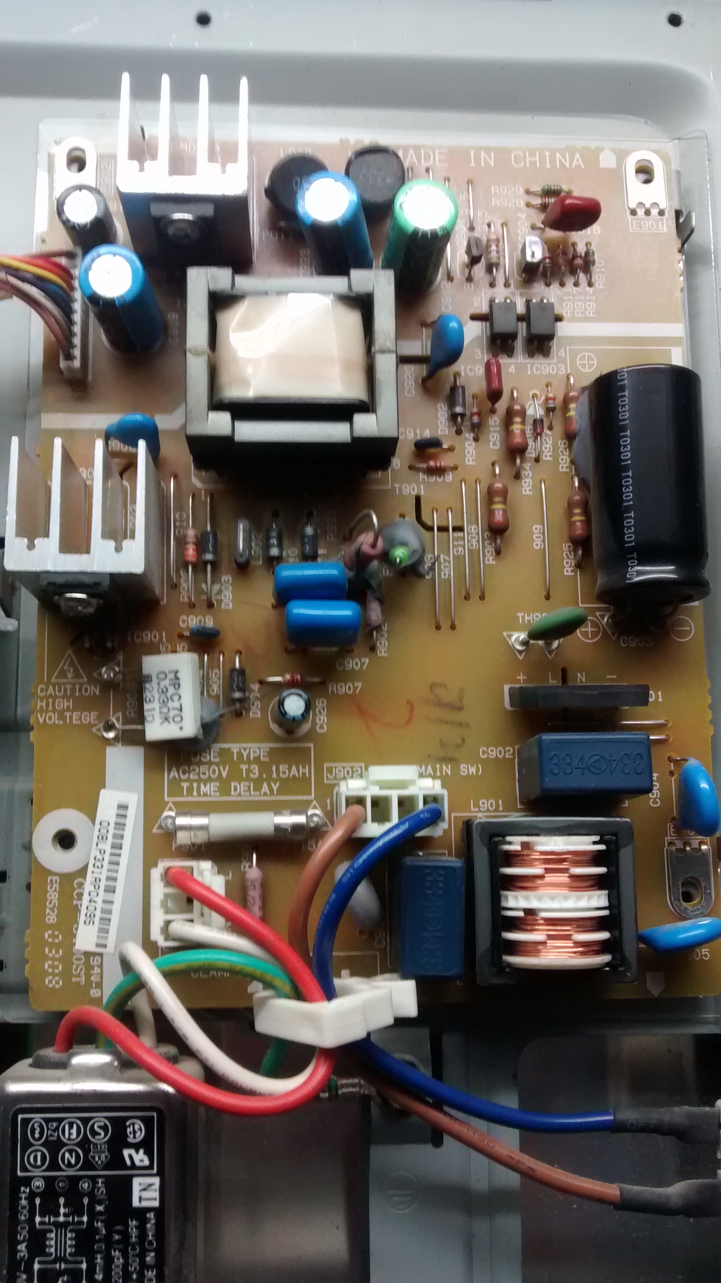

    Hello
    I have a nec 1860nx lcd monitor which doesn't power on.
    I measured fuses, jack they are ok.I measure the cables that go from power board to vga board and I don't have power.
    I can't find schematics for this monitor either.
    I am attaching pictures(I took a picture of the back of the power board only because I think somewhere there is the problem)

    Hi - can you test the voltage on the BIG cap.
    Meter on vDC600 should be around 350vdc so take care.
    Also can you post a full picture of that black box mains in- have not seen one
    in a monitor before.

      I have 40v in big capacitor.
      What part exactly are you reffering? I don't understand what do you mean. Can you show it to me in a picture?

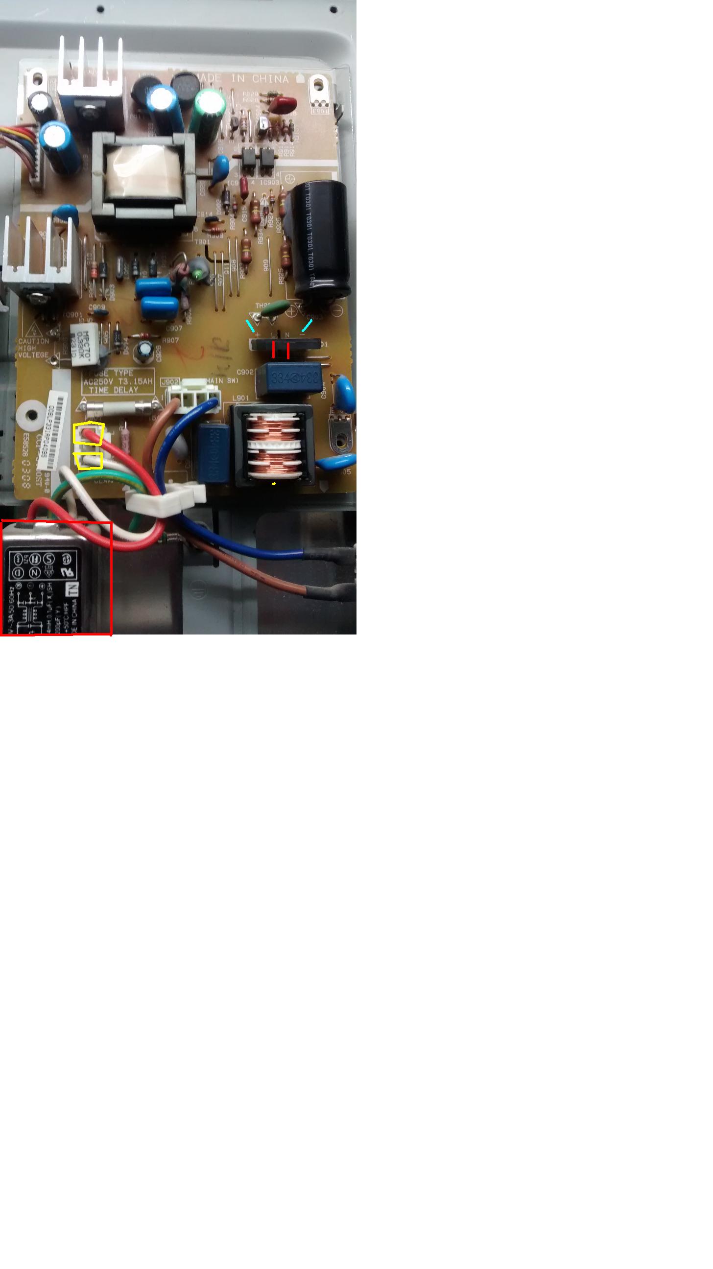

        Re: Nec 1860nx no power
        In and out most of today.
        Pic attached
        Also test the the voltage on the red and white wires marked with yellow box.
        I think it should be mains voltage ac.

          this black box its where the ac cable goes and those 2 yellow cables are the main voltage 220V.
          I saw that you put in one component pink and green lines. Shpuld I check those too and if yes how will I measure them? Its just voltage there?

            Ok so is the voltage on the red and white wires 220vAC
            and the blue and brown ? just the on off switch?

                OK well in that case, the red and green marks are on the bridge rectifier so next
                test is on the RED center pins - Meter on 600vAC - it should be your mains voltage. Then change your meter to 600vDC and test the two GREEN outer pins. should be mains voltage x1.41

                  voltage in red pins is 220V-230V , voltage in green pins is ~310V

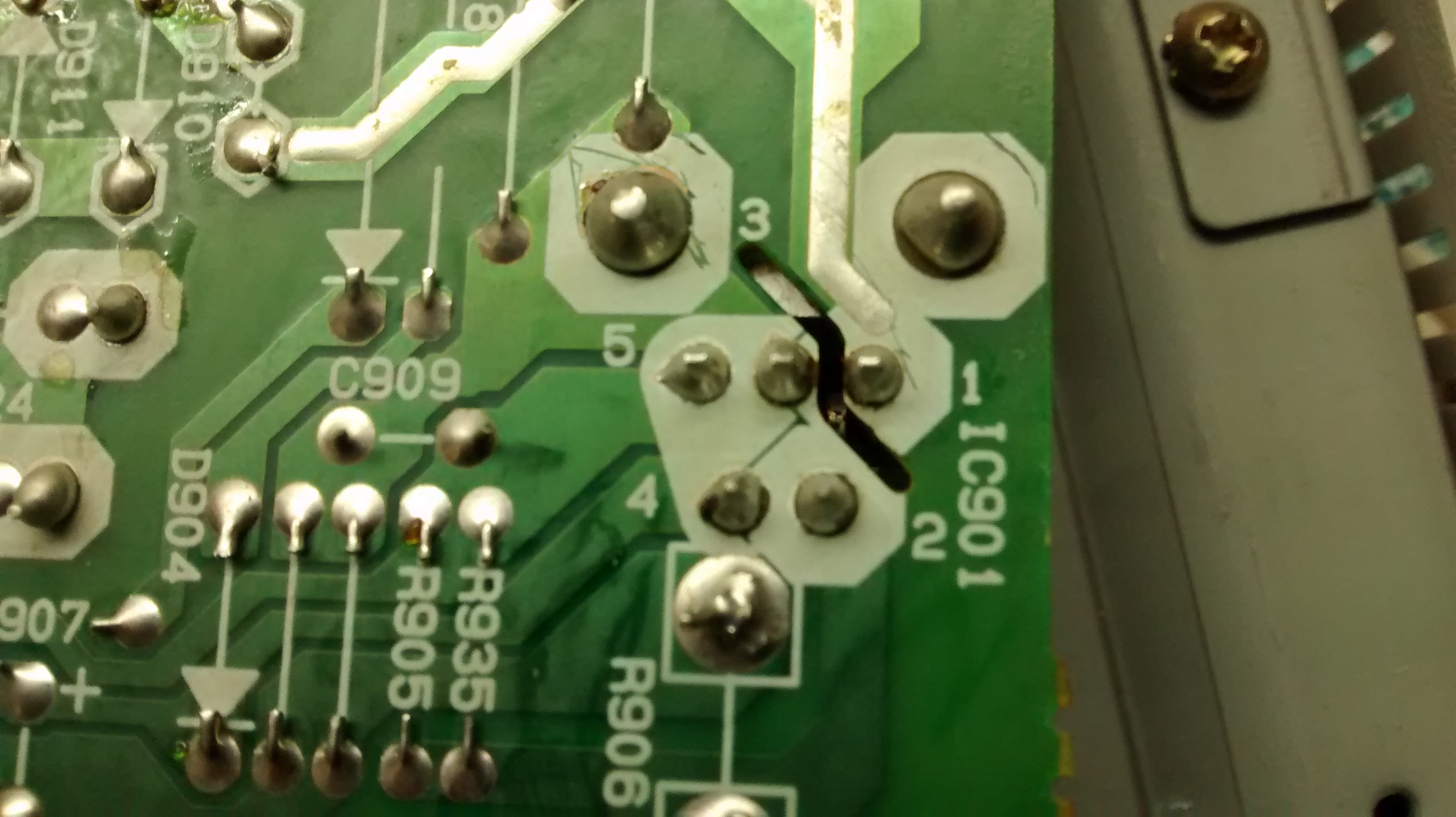

                    ok hehehe hadnt noticed the damage to the board at the bottom of the picture
                    I will have another look at that.

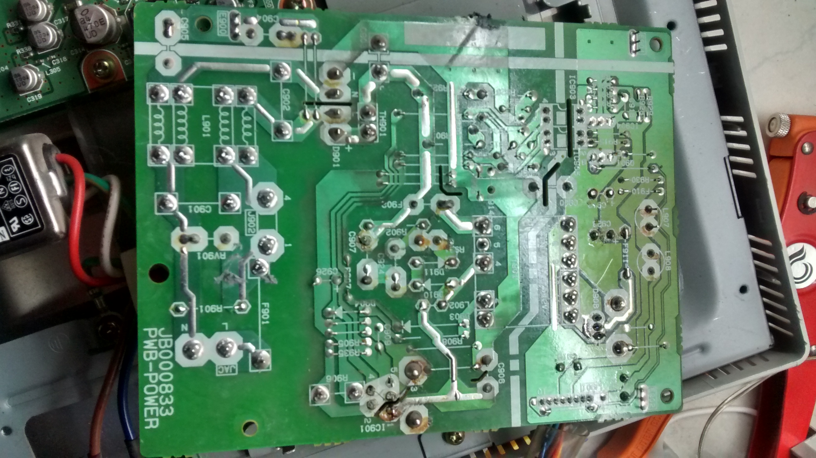

                      Also on the back of the board there is a label F902 on the top of the board is it the bright green component mainly under a blob of grey glue?

                            F902 is a fuse- You dont test in diode mode ?? Please test in ohms mode, it is probably ok but I need to be sure. - Should read the same as touching the probes together on the meter in ohms mode.
                            680 vDC PLEASE always say if AC or DC.
                            That is most unlikely the cap is rated for 400vdc or 450vdc which is the maximum voltage it can take. I am pretty sure 680vDC would have blown it up. Check the battery in you meter?
                            As to it working - well looks like there are quite a lot of bad solder joints and
                            possibly a broken trace near IC 901. Maybe they just momentarily re connected.
                            Is C909 burnt (looks black on top) Can you post close up of the
                            top and bottom of the IC 901 area. Can you read the part number on IC901.
                            Is there a crack in board/ break in the trace between pin1 and 2/3.
                            If you hold it up to a very bright light it might help.

                              Those are not bad solder joints. Its just flux in one pin and the crack you see it's not a crack its just the board it has a line there.
                              I am attaching a new closeup photo with flux cleaned

                                Wow cant believe it , mind I am now viewing this on a better screen and even the old pic looks a bit better.
                                So now what to do - keep it on test switching on and off now and again to see what happens?
