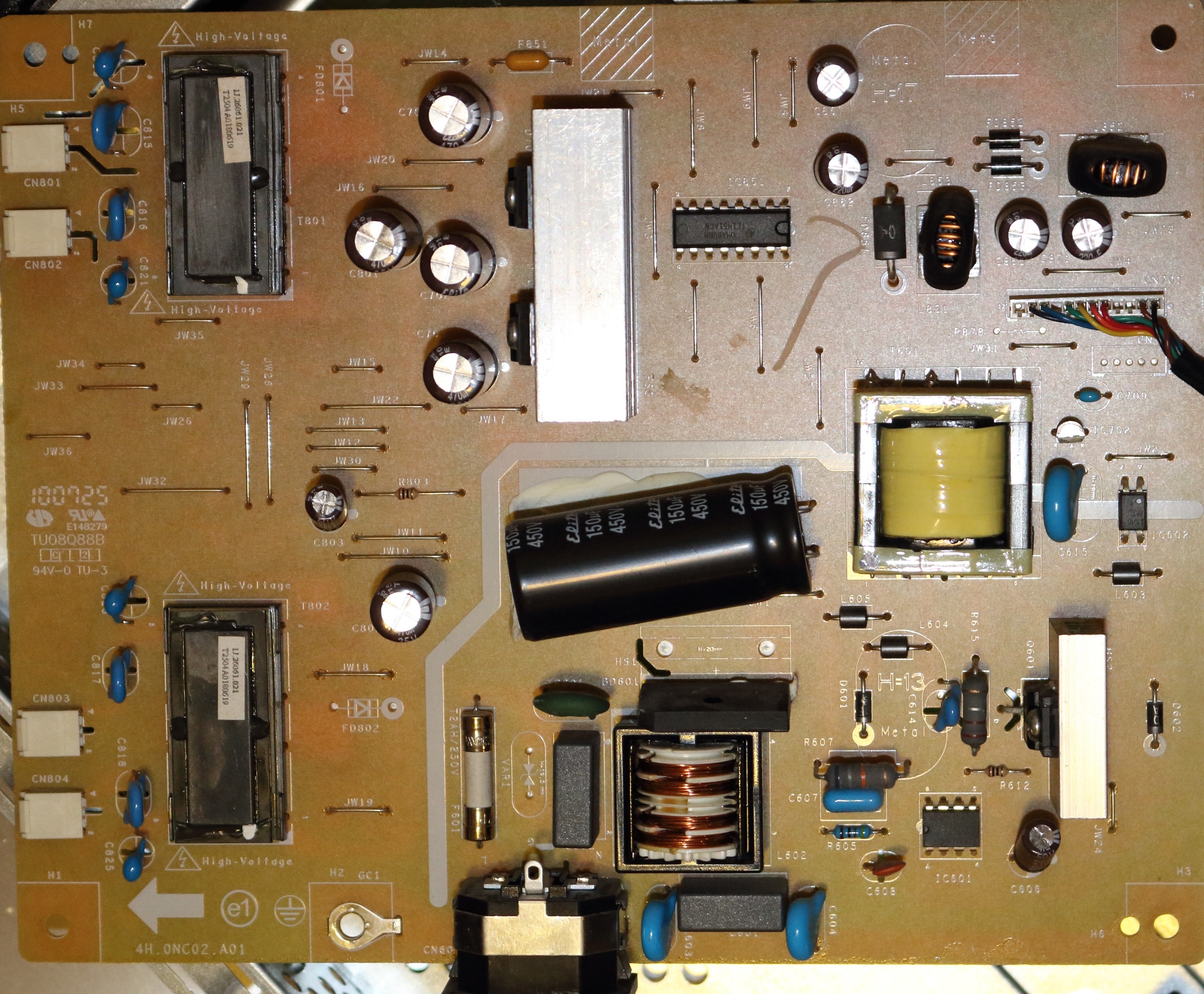

    So the monitor I have had for about 3 years started flickering yesterday, and today just randomly turned off video.
    The following is happening:
    -- The monitor is still recognized by my computer
    -- The monitor is not sleeping, the green light remains on
    -- The screen is completely black, I can not see anything on it even if I use a flashlight
    -- I tried turning down the brightness to see if it stays on, but I haven't been able to get into the brightness menu for long enough to do this
    -- If I cycle power, the desktop image comes on again for 2s then goes black. I can seemingly do this forever. Anyway it doesn't really help.

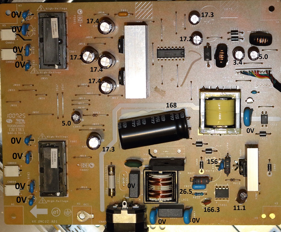

    So! I took it apart, and measured the voltages across most (I tried all, but I missed some) capacitors. I don't see any bulging, I don't really see anything out of norm physically. I'm attaching the images. Some just raw ones, and then ones with the voltage values on them. I'm particularly interested in knowing why those blue ones measure 0V...? I guess?
    I would appreciate some ideas! I can buy a new one, but if I could fix this one, that would be really nice. I know how to solder and stuff.

    Those blue caps are high voltage ballast caps, do not try to measure the voltage on those point, it around 2000V, it will ruin your meter.

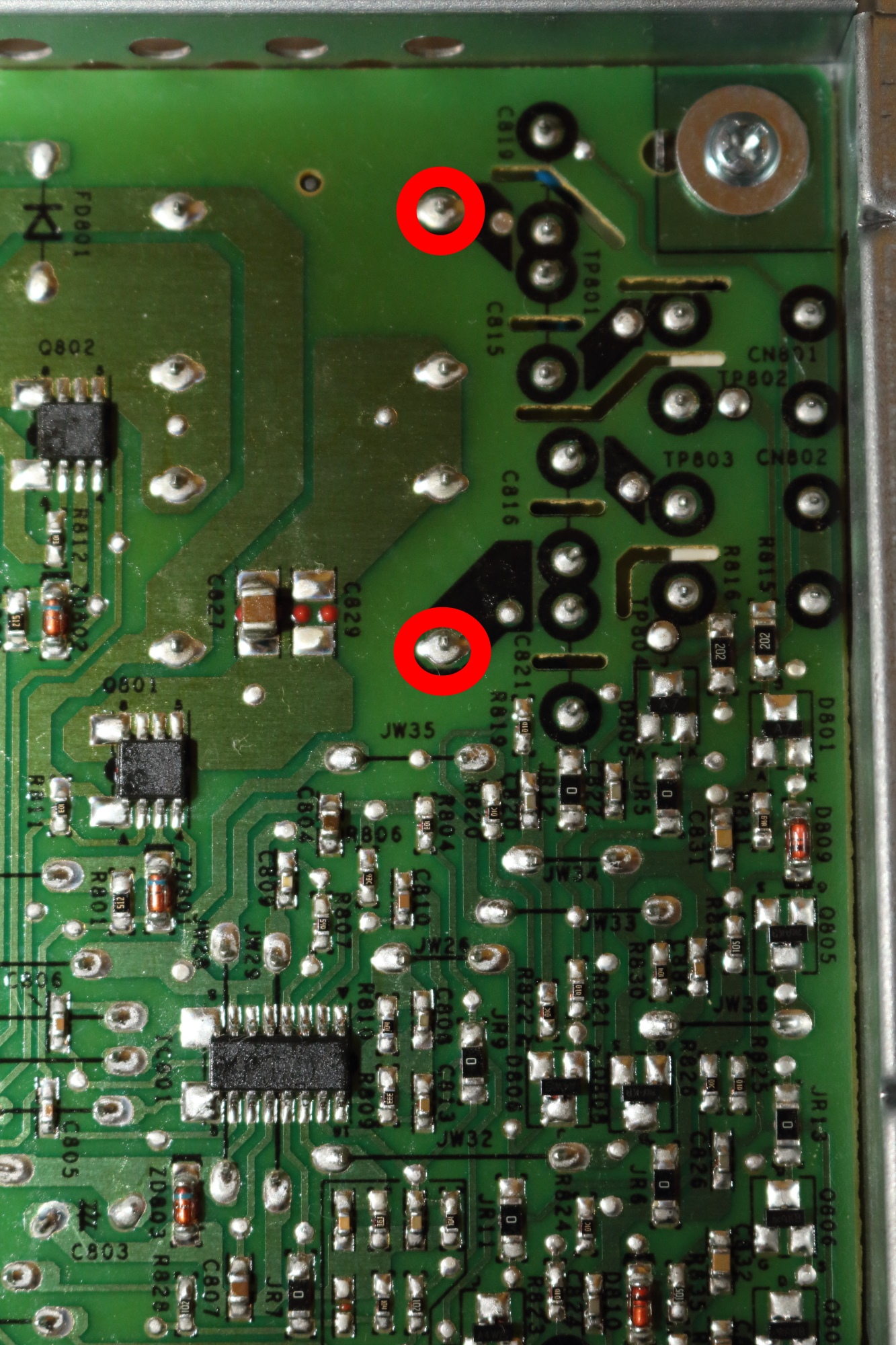

    Can we get good clear closed up pictures of the bottom side of the board where the two inverter transformers are (they are next to the blue caps), we need to measure the resistance of the high voltage windings of those two inverter transformers.

      Oh woops The meter seems ok anyway. I would have thought 2000V would have read OL on the meter?
      Here are some pictures, I hope they're what you're looking for (those gray boxes on the left side, right?).
      Sorry I don't know why I'm having so much trouble getting the top one better. Let me know if it needs to be clearer, and I'll redo it. I tried a few times, but this is the best I could do.

                  Check the resistance reading between those two points in the pictures, set the meter to 2K scale.
                  You should have two test lamps that will make it easier to narrow down the problem.
                  https://www.badcaps.net/forum/showth...er+testing+cfl
                  You also need to check those 4 power MOSFETs (8-pin SMD), but lets verify if the transformers are OK or not first.

                          Ok, measured those points!
                          If I reference your images:
                          For transformer #1 the value is ~2000 ohms.
                          For transformer #2 the value is OL on that particular setting (20kohm).
                          Edit: While I had everything out, I also got to the CCFLs and checked those out. All 4 seem to be working.
                            Re: BENQ2420 LCD turns off after 2 seconds
                            # 2 is bad. I would remove it and look at the pins to see if you can see broken wire.
