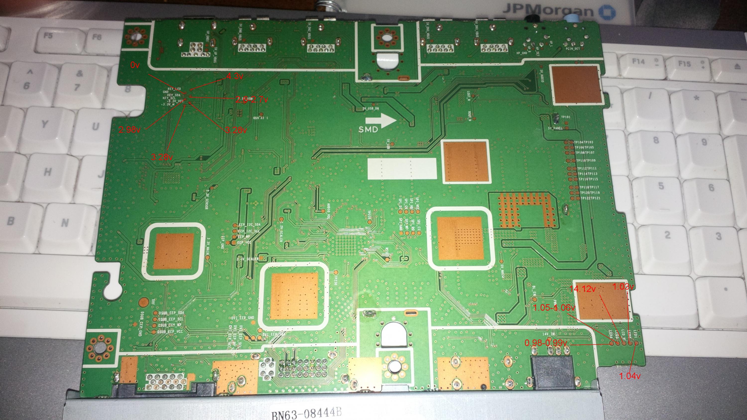

    Reduce the size of your pictures to less than 3mb jpg and you can post them using manage attachments. You need to post one of the Led driver board if there is one and also report the voltages on the socket with the black and 1 blue wire with respect to ground. Find and test any voltage regulators.
    See 2 seconds to black guide sticky at top of this forum ( mainly for ccfl backlights but has lots of useful tests start at post19)

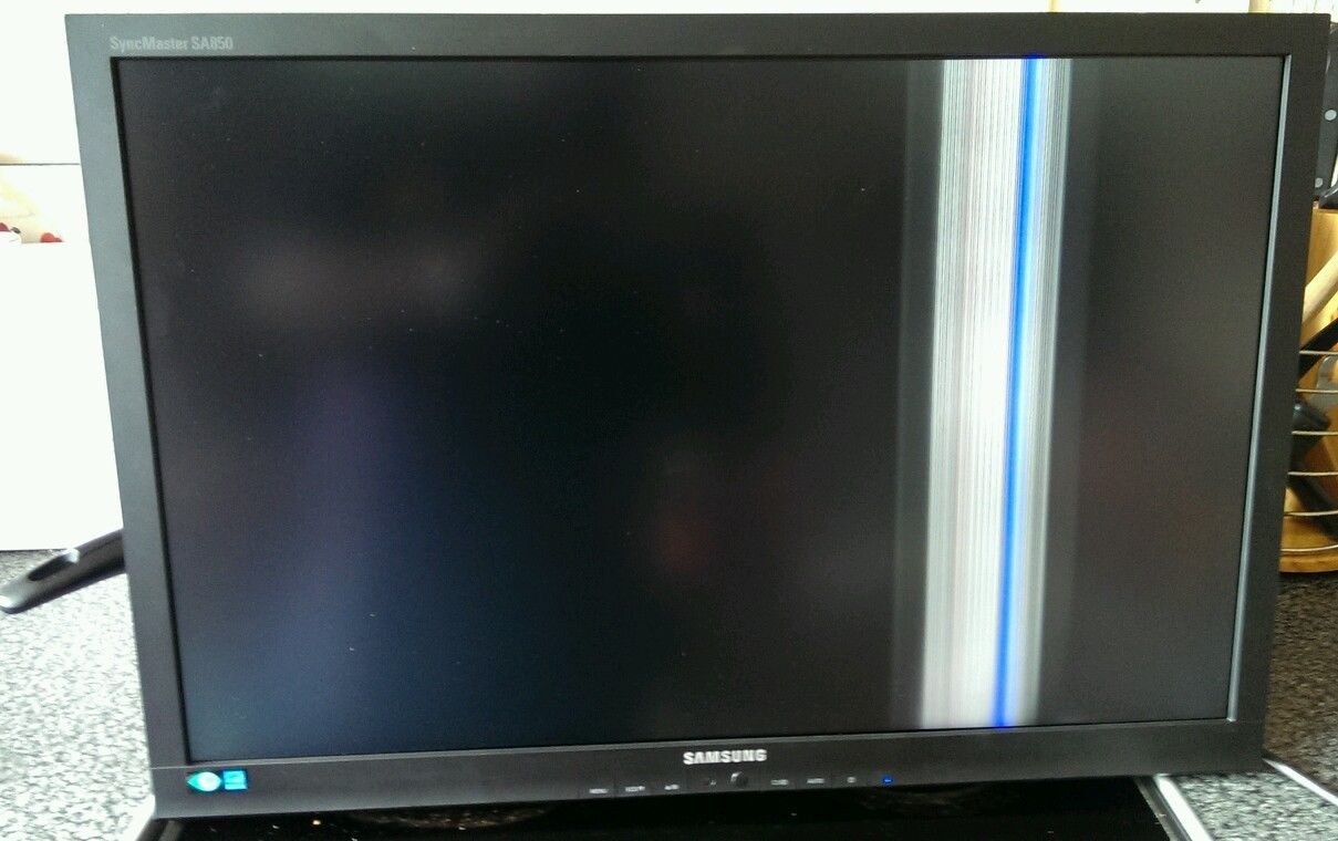

        Re: Samsung SA850 screen flashing/lines/not switching on
        Heheheh - I have enough problem machines of my own !!- need to see the picture of the lines down the screen - I suspect it is going to be a bad panel so probably a waste of time trying to fix the rest.
          heres a pic of the lines mate and the voltages too.
            " Car repair man intake of breath" Fsfsssssssssshs.
            Doesnt look good - does it always appear in the same place?
            There will be a cable goes to the panel from the main - LVDS
            If that is removable try removing cleaning and replacing.

              Fortunately no its not in the same place, cleaned contacts no luck, I've got a video i'm uploading now. It flashes a few times first then comes on and I can see the lines moving across the screen.

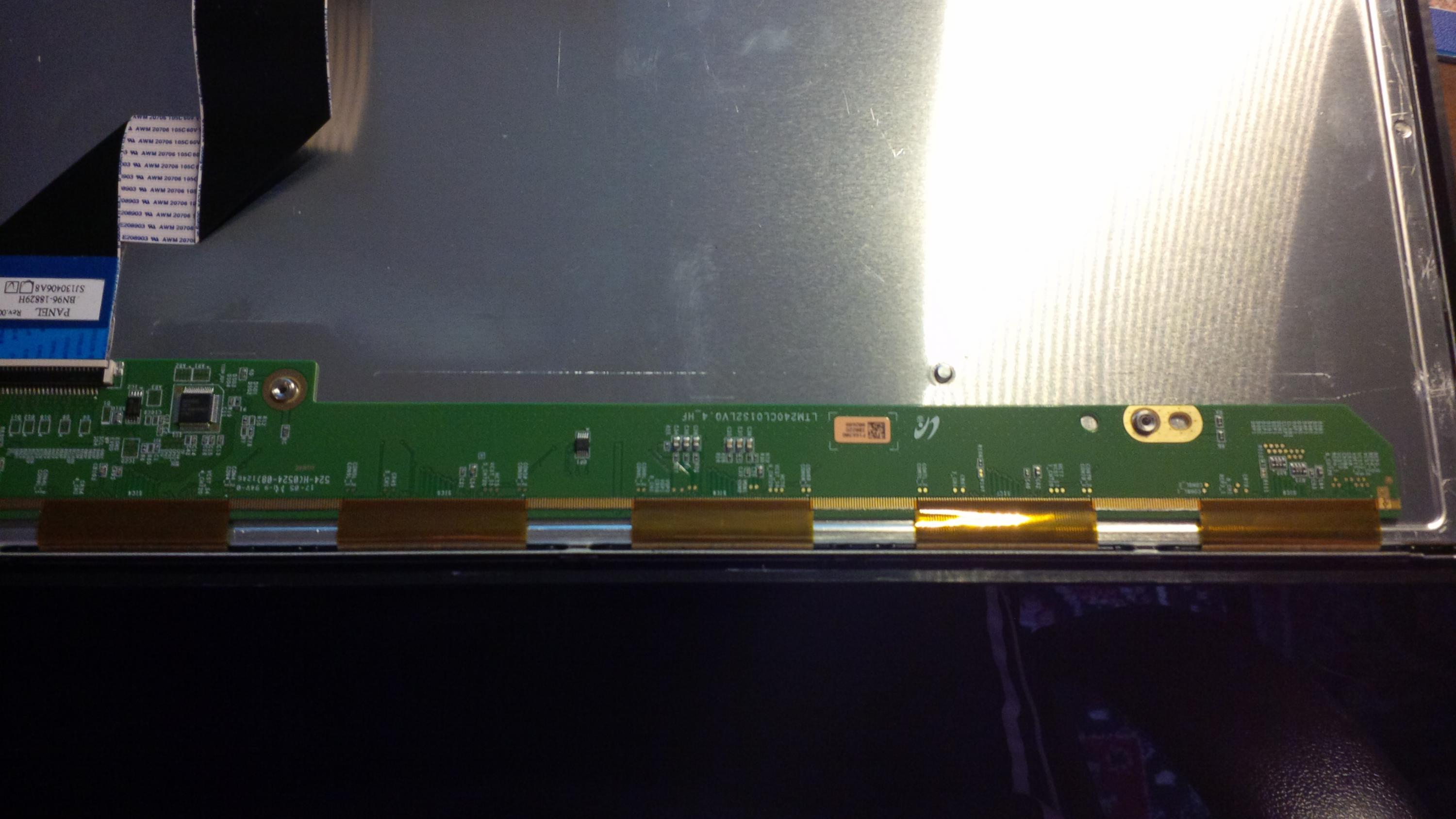

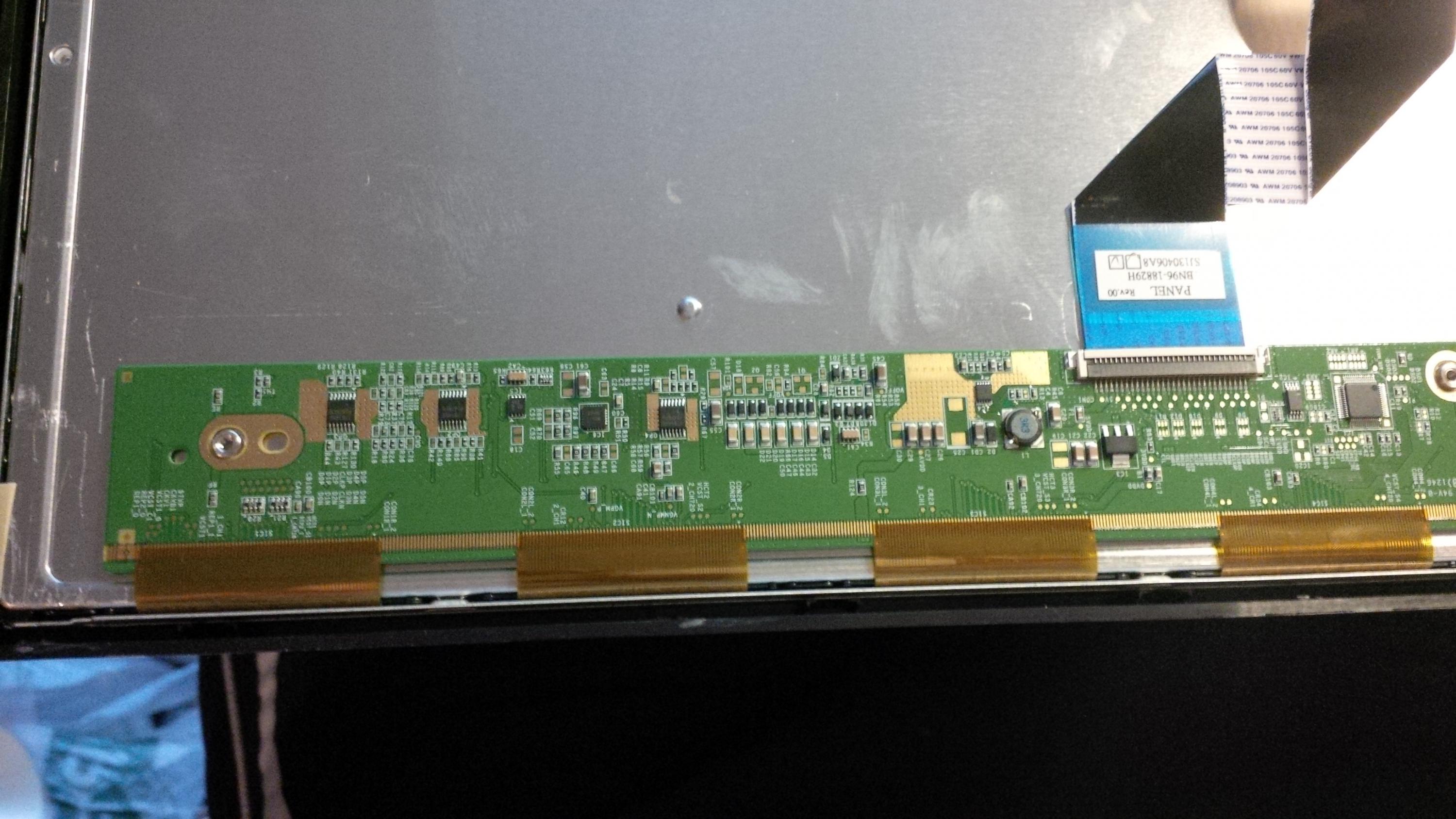

                    perhaps a picture of the tcon? panel board might yield some clues.
                      See attached, I also have images that are taken closer so you can make out more detail (>2 of course)

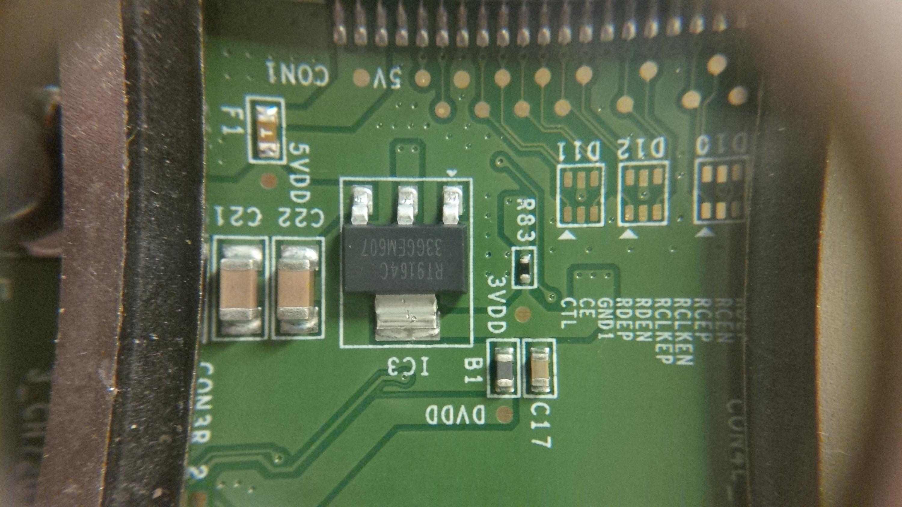

                          Ok - well at least the fuse is working
                          There is a voltage regulator on there, near the fuse - U??? perhaps test that if its supply ing an off voltage perhaps other items are overworking (heating) to compensate.
                          I thought I found something about the 17814HS but got distracted and lost it.
                          Perhaps a picture of it and the other you mention?
                          That mini hotair blower seems to be a medical gadget - I posted a link in the other thread.
                            Yeah - I thought I saw something about the 17814HS on the polish forums, but nothing concrete.
                            Where is the voltage regulator? Is it the black component below the ribbon connector on the left? And looks like like this but a bit has no screw hole? http://m2.uxcell.com/photo_new/20110...x0169_ux_c.jpg.
                            Ok so reading from left to right (and upside down as in the picture above), the voltages are
                            4.58 ==== 3.287 ==== -1.7
                            And the big tab is 3.287v
                            Be easier if I just brought it to you?
                              Yes I think you have the right one - IC3 - what is the part number on it?
                              I have never heard of one having a negative voltage? or is it just 1.7
                              Ok see picture now it is one of these
                              http://www.richtek.com/download.jsp?...RTOTE2NEMtMDND
                              So output is correct. 3.3v
