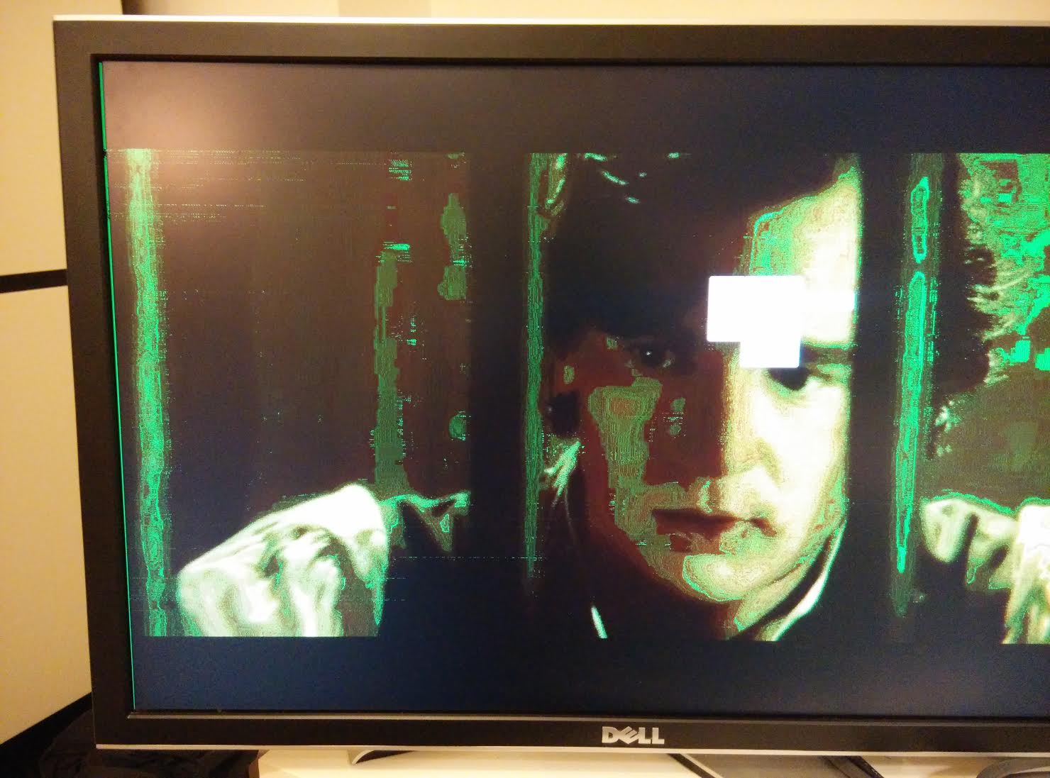

    I have a problem with a dell 3007 wtp just wondered if its fixable...I've checked cable is dual link and tested pc with another 30" monitor all is ok...
    The monitor runs the colour cycle test ok but images are disstorted when connected to pc.
    Thanks for any help

      Sorry about the triple post, new to forums, did add two attachments but not showing sorry..
      added attachments now..

        try with a different monitor cable, and maybe try another monitor or tv on the pc to check the videocard.

          Hi, thanks for the reply i have two monitors one 3008 wtp and the 3007 wtp
          the 3008 works perfect so must be the monitor...

              Re: Dell 3007 wtp
              Managed to fix this, I changed the capacitors in the power supply. I bought a kit from ebay containing rubicon capacitors. It was'nt to difficult if you take your time. the hardest part was desoldering caps, but that got easier after a few attempts
              I did'nt really expect it to work as symptoms were different to others and really thought it looked like a control board issue
