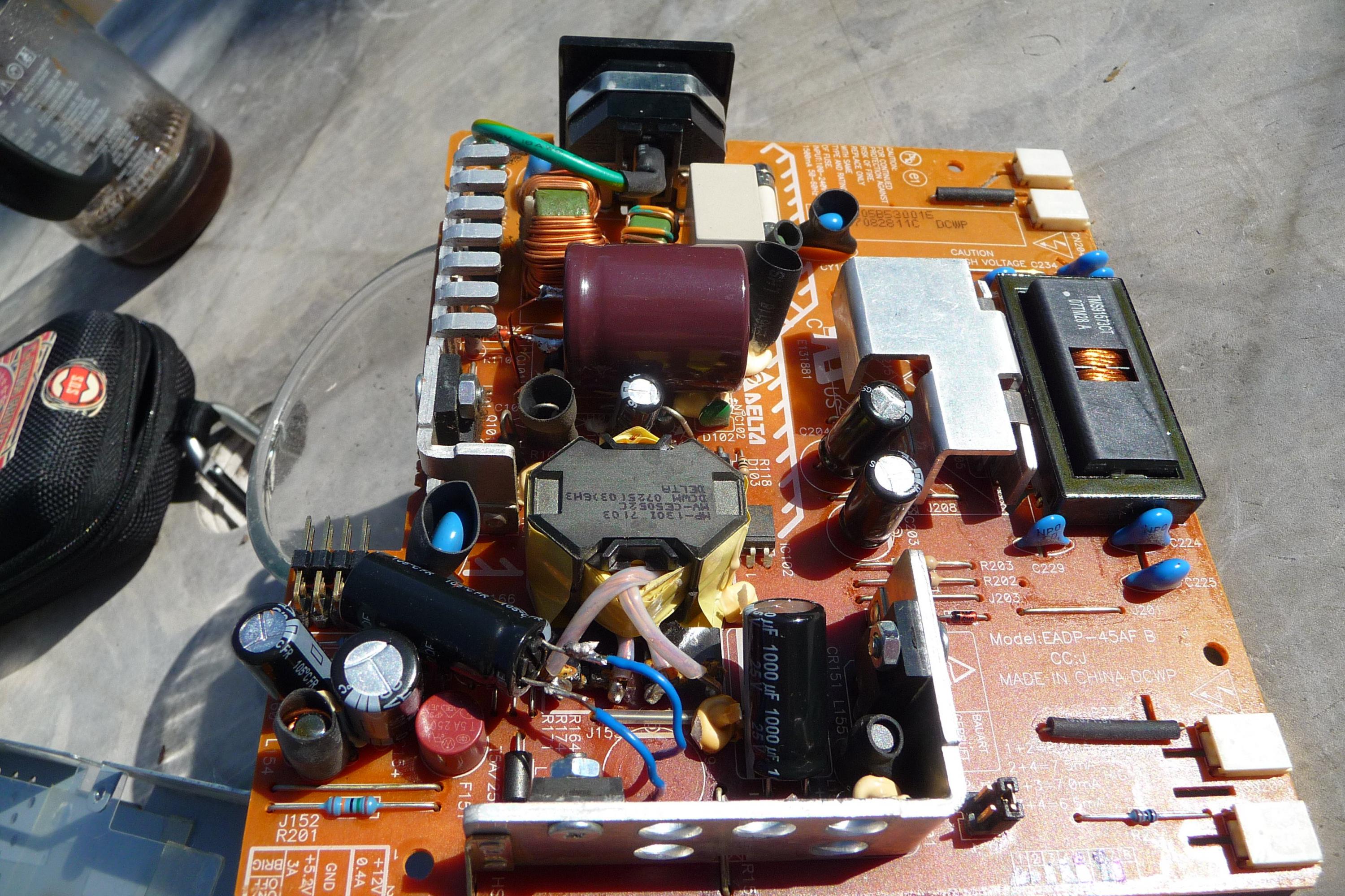

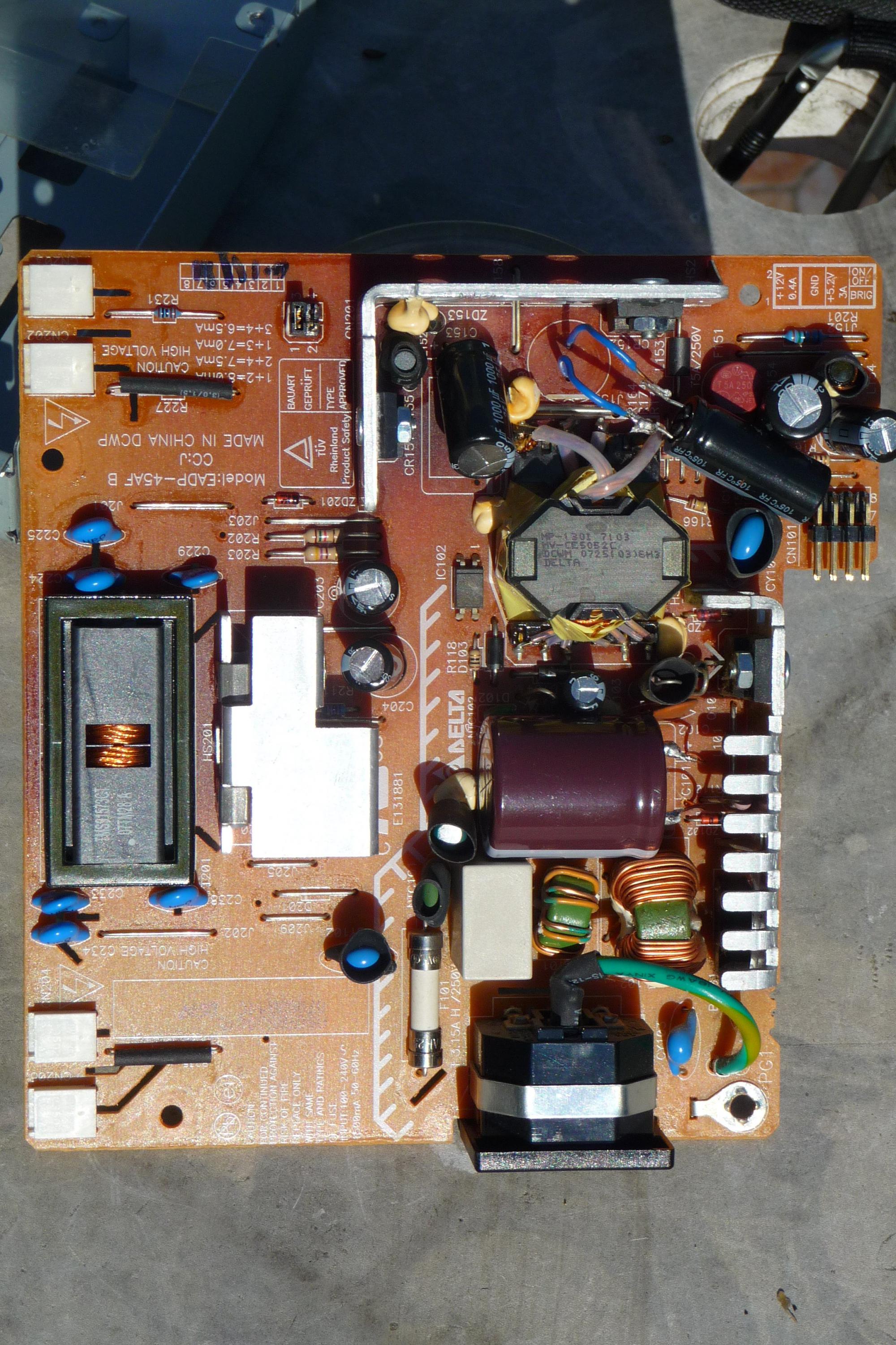

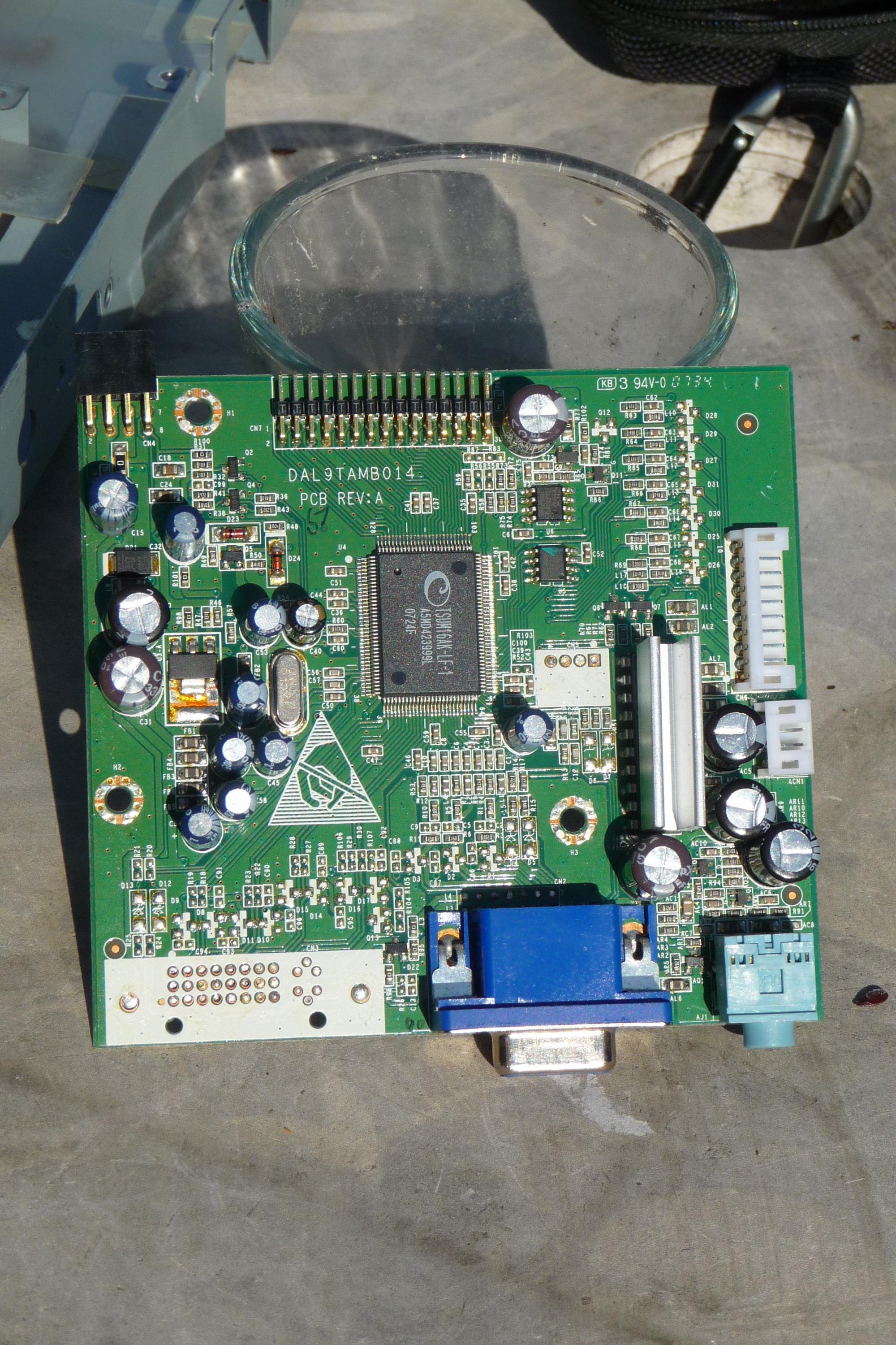

    Hey, I have the same display than in this thread:
    The display works OK (picture is there, just flickers a little bit), but there is disturbing buzzing/noise which gets louder with increasing display brightness + there is a little bit strange smell at the back cooling slits.
    I think it comes from the bigger board.

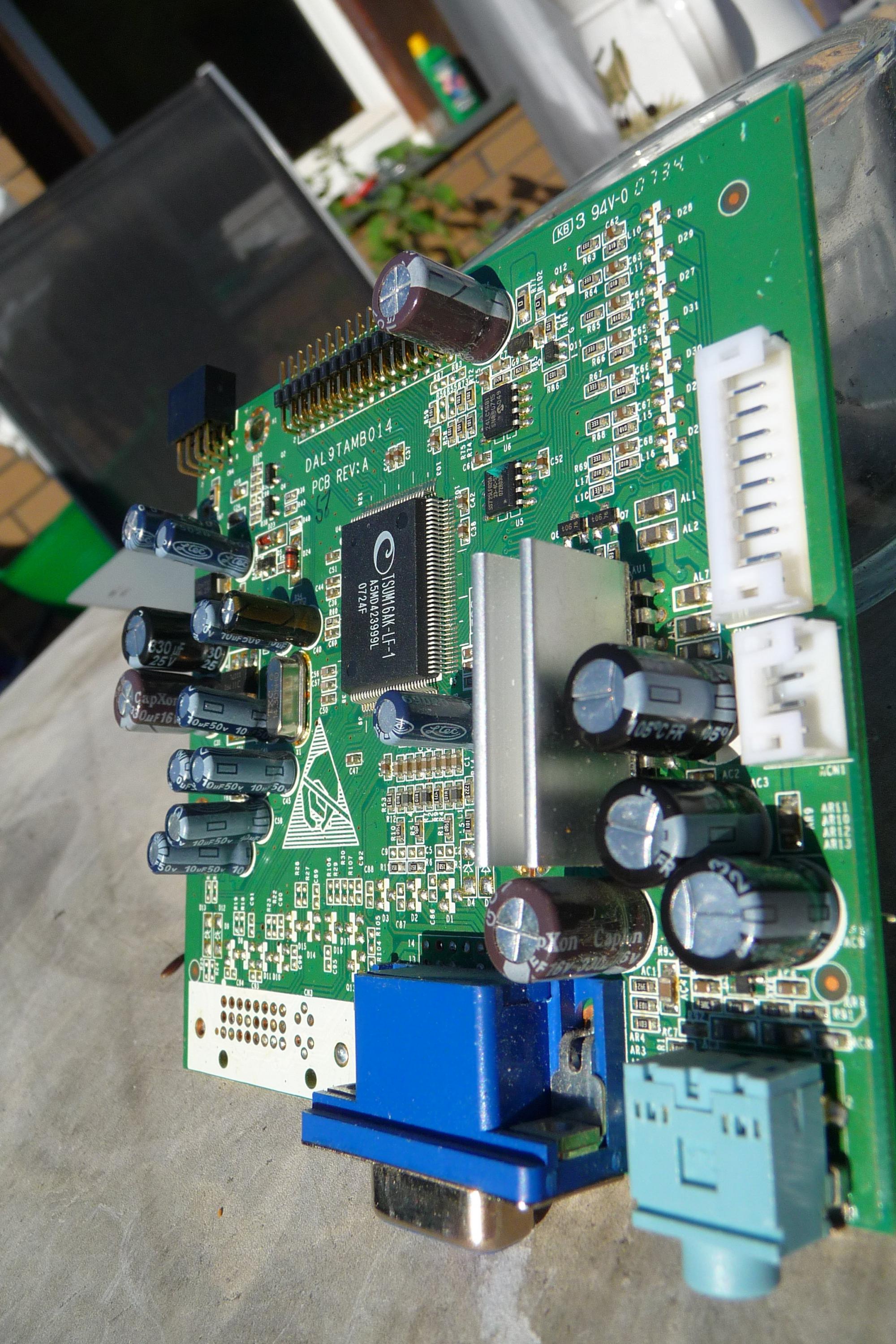

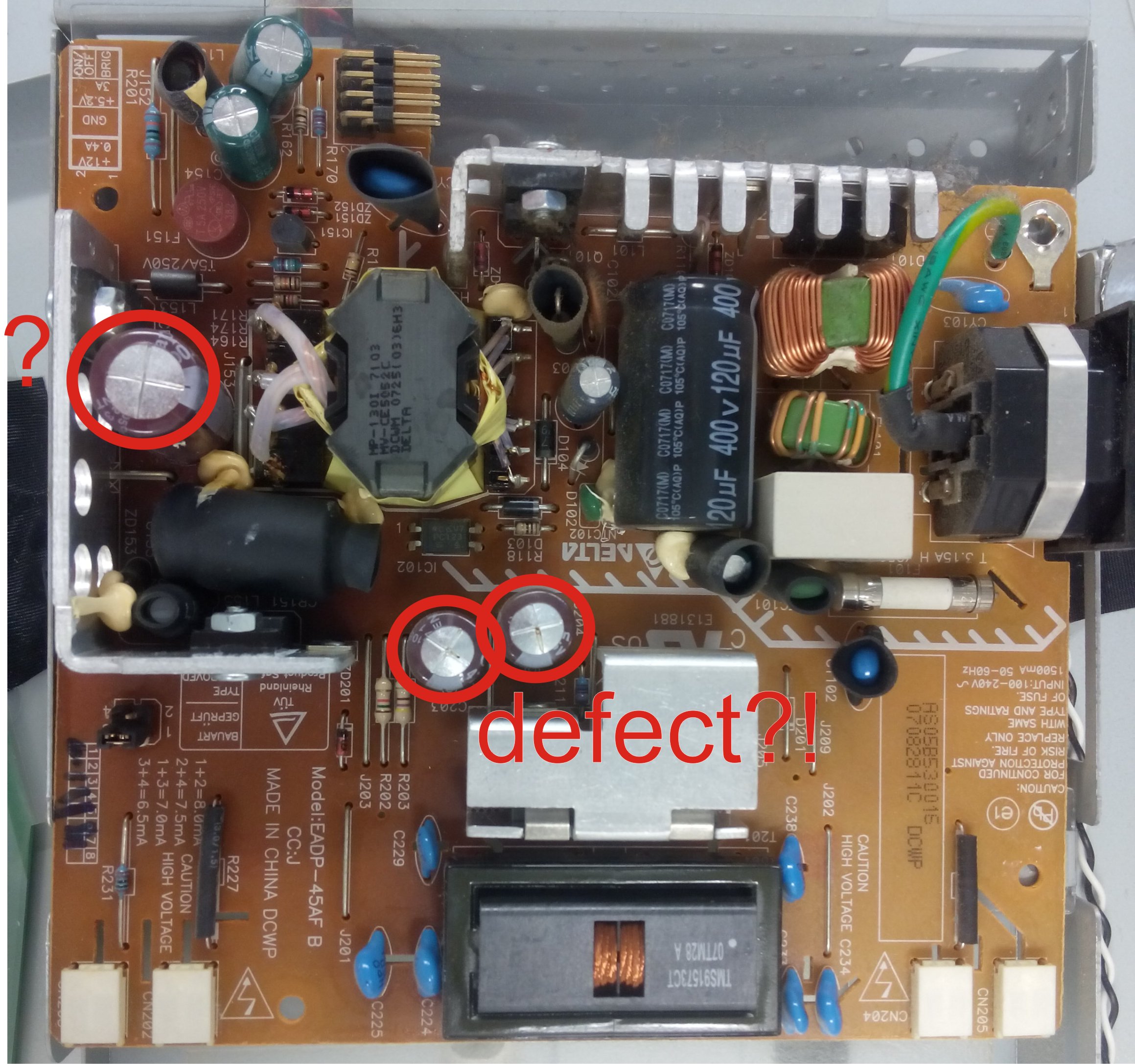

    I already teared down and made pics and think that I identified at least 2 bad caps.
    Shall I just replace them - or do you think their failure are caused by another thing?

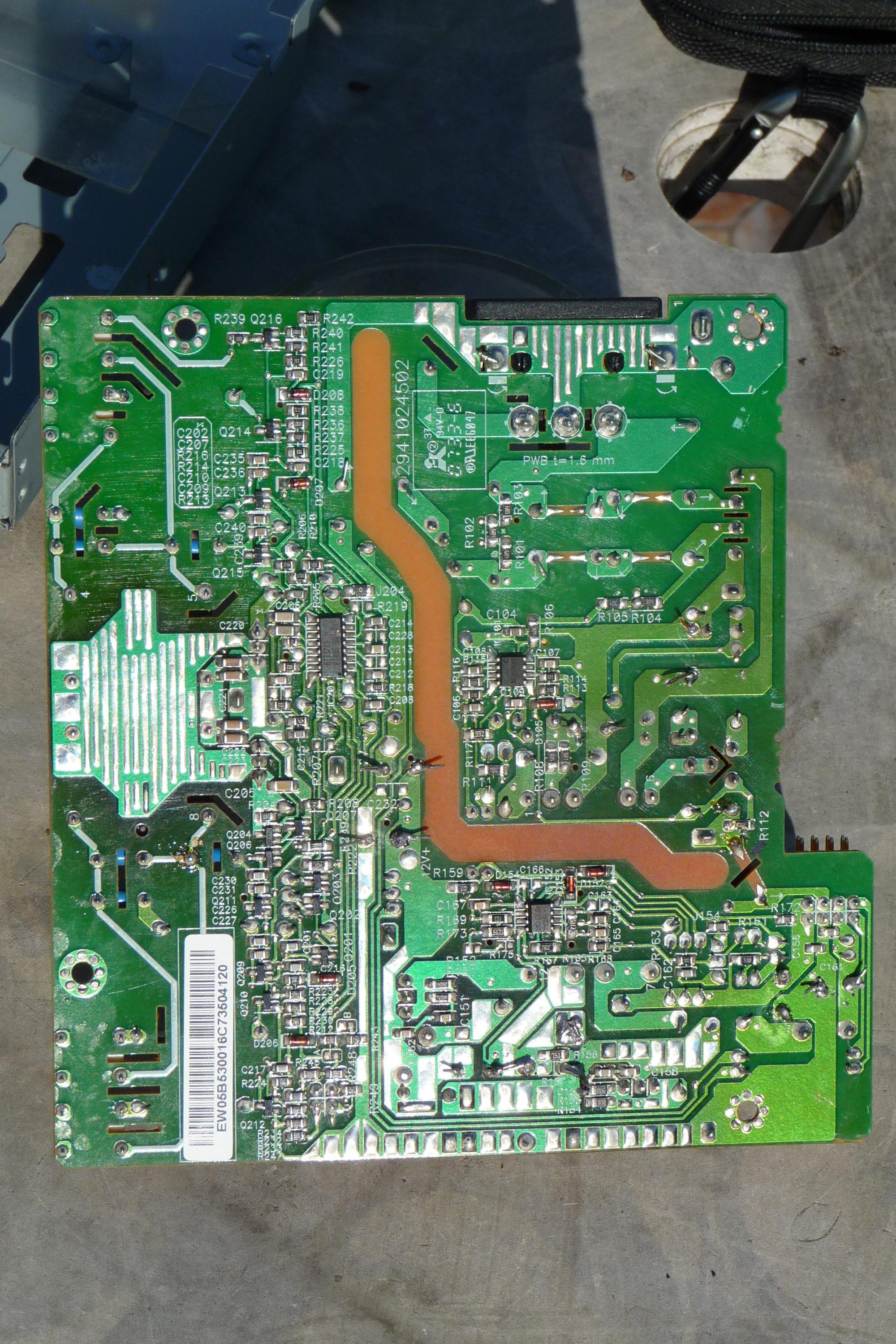

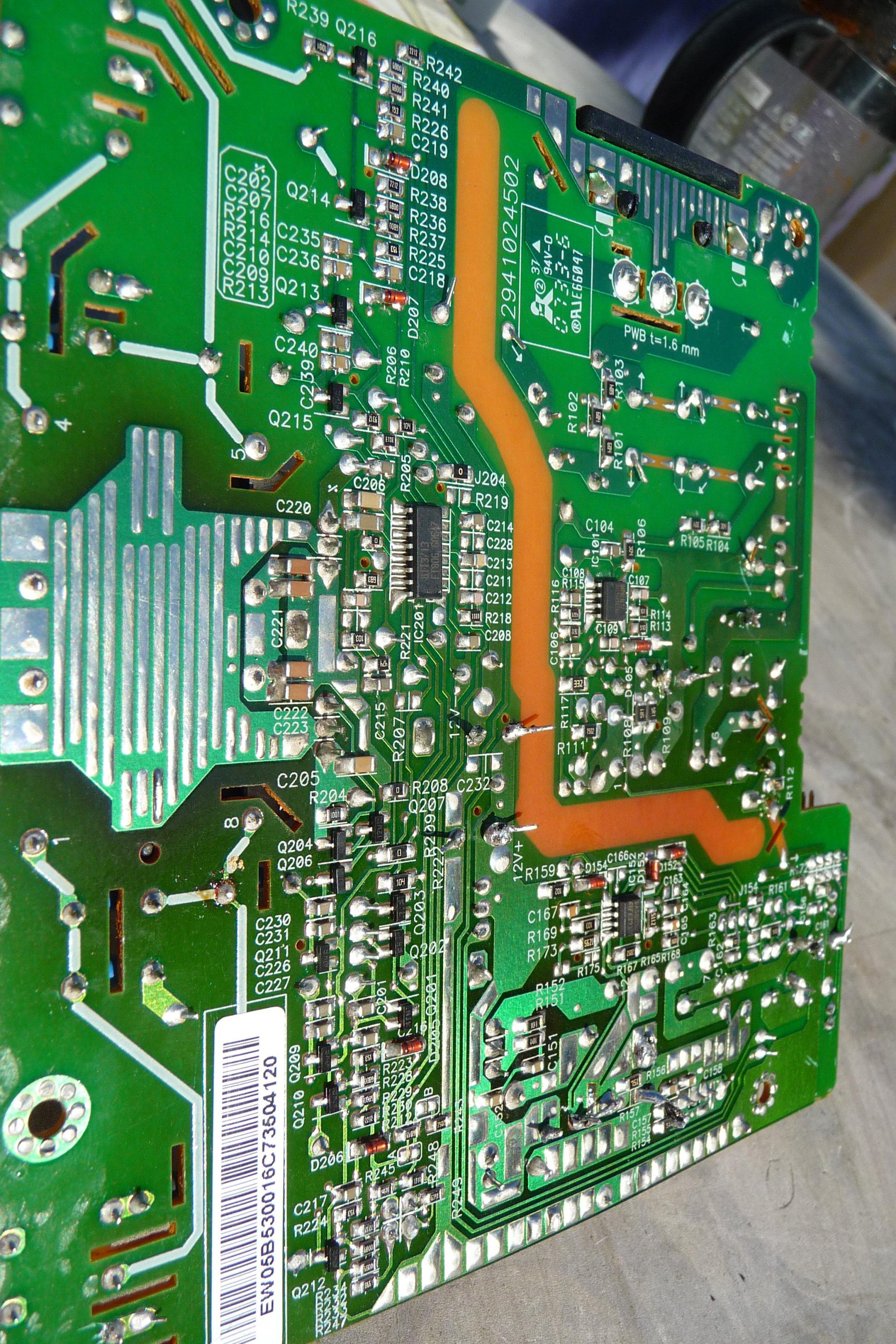

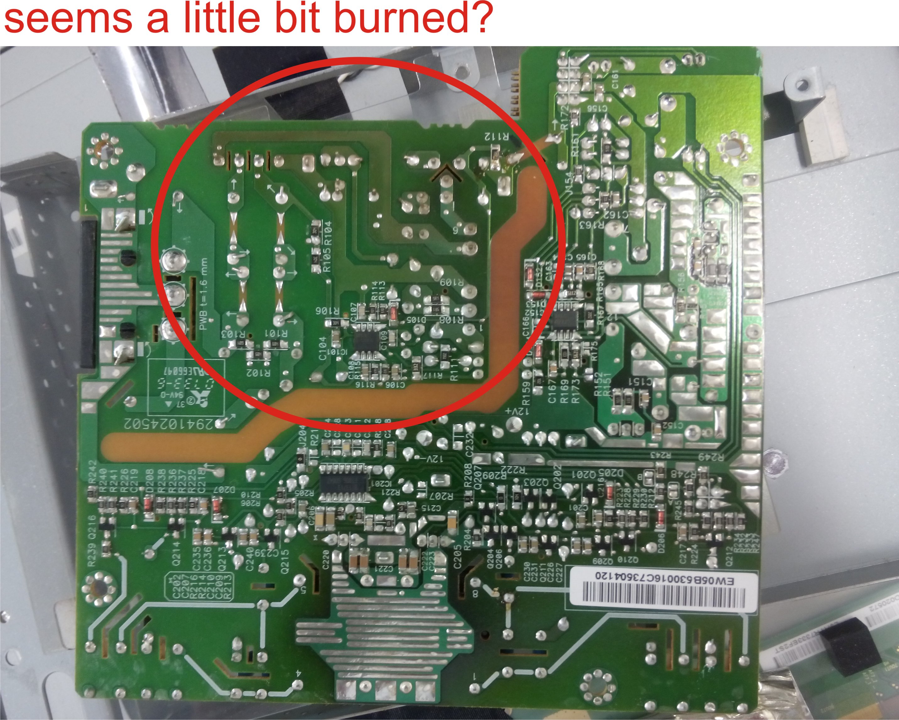

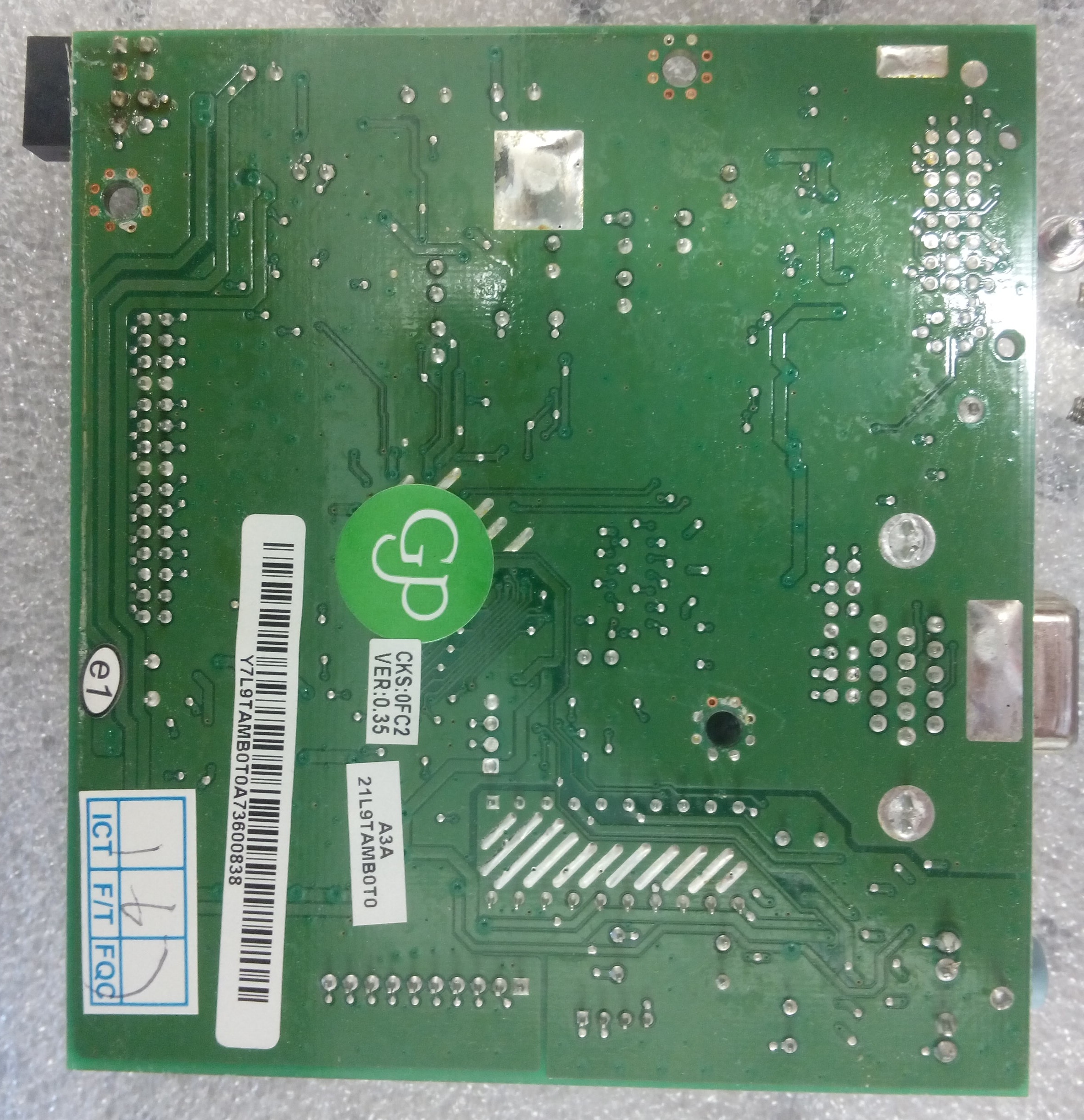

    Furthermore I noticed on the backside of the bigger board an area wich looks a little bit like burned (slightly darker/browner).
    Any hints what I should check before replacing the 2 caps (marked red in the pic)?
    Do you need better quality pics?
    Cheers, Robert

    Yes those are defective on the power supply, and your should also change the 3 greenish ones. I personally would also change the large black one too.

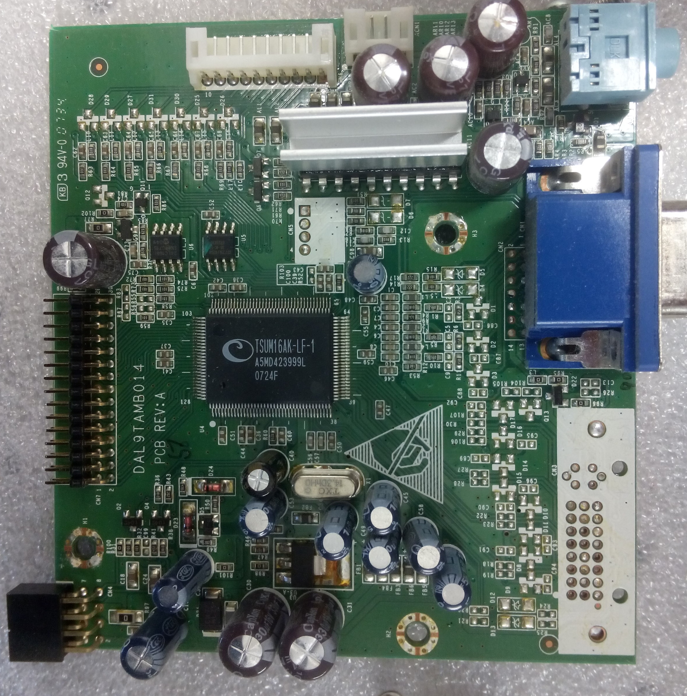

    On the other board , you also have a bunch of them that are bad and that should be changed.
    the dark area is from heat caused by the diodes on the one heatsink. They probably should have made the heatsink larger , but they did not , so some of the heat stayed at the board.

      small board:

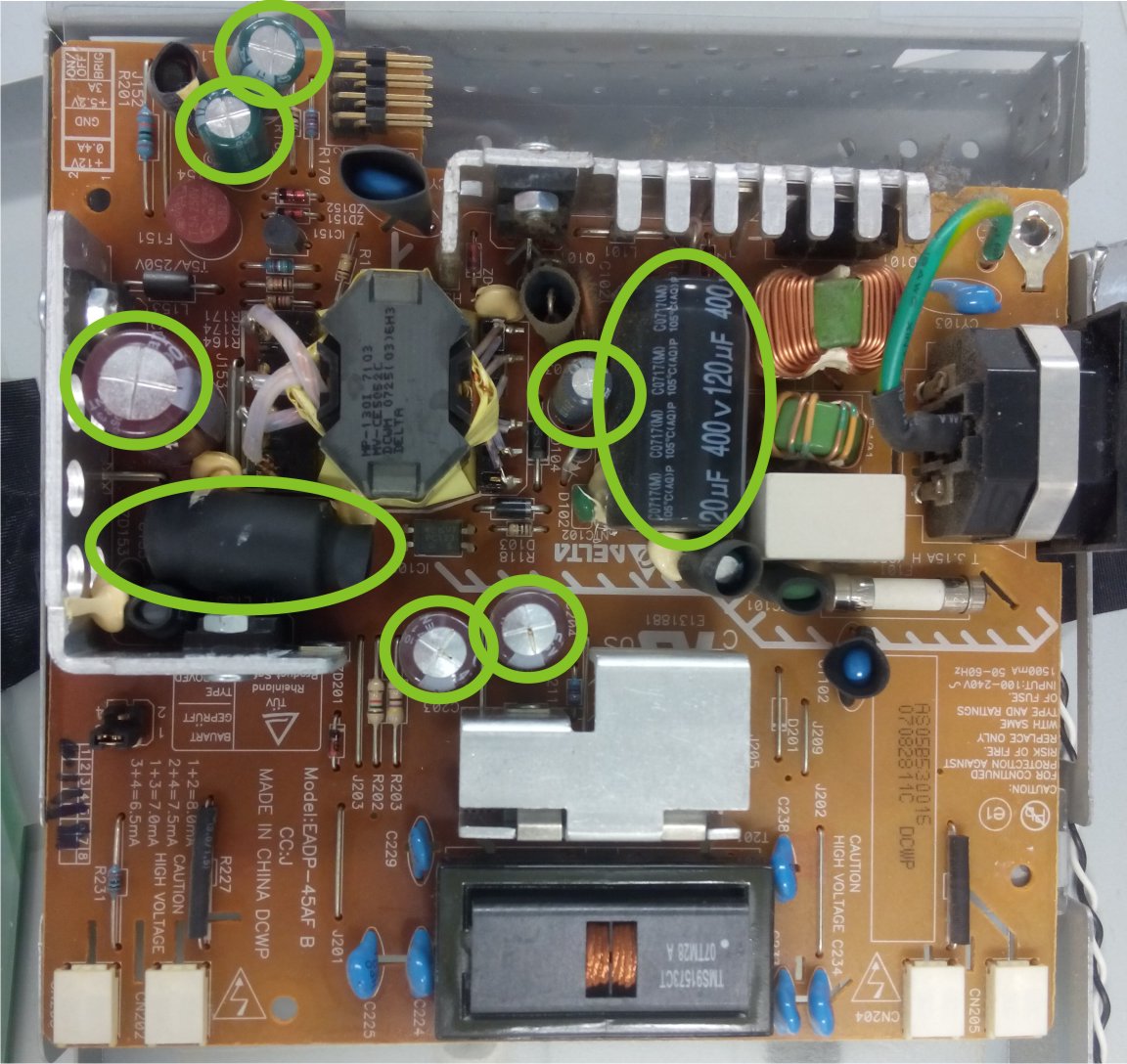

      - Can I replace the bunch of defected of the small board (330uF/16V) with 330µ for 25V (because of lack at my favorite online shop)?
      power supply:
      - Why you would also change the big black (120uF/400V) although it looks not demaged?
      - Why the 3 greenish (2x[220uF/25V], 1x[47uF/50V])?
      - I identified also a demaged with the black heat shrink tube at the left middle (directly under the question mark in pic2) (1000uF/25V) and will change it
      Any further advice before I trying if the display works better after replacing bad caps?

        330 x25 should be okay and I would change all the purplish/brown ones on that video board. These are CapXon brand and they are garbage !!
        If you feel lucky and don't want to change those other ones while it is apart , That is up to you, but since the others failed, that means the others might be going soon, so if you want to take it apart another time when these go just to save a few dollars right now, ok.

          You will need to replace the capacitors with LOW ESR capacitors of same capacity. The voltage can go higher. You can't use any capacitor with that capacitance, it has to be low esr.
          You won't find "low esr" capacitors in shops, because this "low esr" term is relative. Get the manufacturer and series then look in datasheets online and if it says "low impedance" they should probably be OK.
          Replace the Capxon capacitors on the board with the vga and audio connector.
          If you're cheap and you don't use the audio on the monitor, you may get away with not replacing those 4 capacitors by the audio jack, as all those four are used by the audio amplifier and the speakers.
          If you don't replace them, you may eventually damage the built in speakers unless you mute the sound from the OSD menu.
          It's his personal preference. I wouldn't replace it. They're a bit harder to buy and they're expensive, so my advice would be not to bother with it.
          Those capacitors have an important role in how the power supply starts and works, in general. If you look at the board, you can see that it's much darker in that area, where the transformer is.
          The board got darker because it overheated, a lot. As the capacitors went bad, the power supply started to not work so well and due to this behavior, everything heated on the board. You just can't tell how much heat that small capacitor near the transformer absorbed through its leads and since it's so small it doesn't have a vent on top to be swollen and become visible to you that it's bad. As that capacitor is used each time you turn on or off the monitor (and I think even when it goes in stand by), it's quite important and you should replace it.
          It doesn't have to be rated for 50v, you can probably use a 35v or a 63v or even a 100v rated capacitor there, they just used 50v because anything rated for less voltage isn't cheaper in general, and because the larger size of the capacitor makes it more resilient to heat and other things.
          The other two greenish capacitors (2 x 220uF) ... the board is not looking good close to them but even so.. i would probably think a bit before replacing them. I'd test them with an ESR meter before replacing.
          As you don't seem to have an ESR meter, it's probably safer to just replace them, as long as you buy stuff and use the soldering iron.

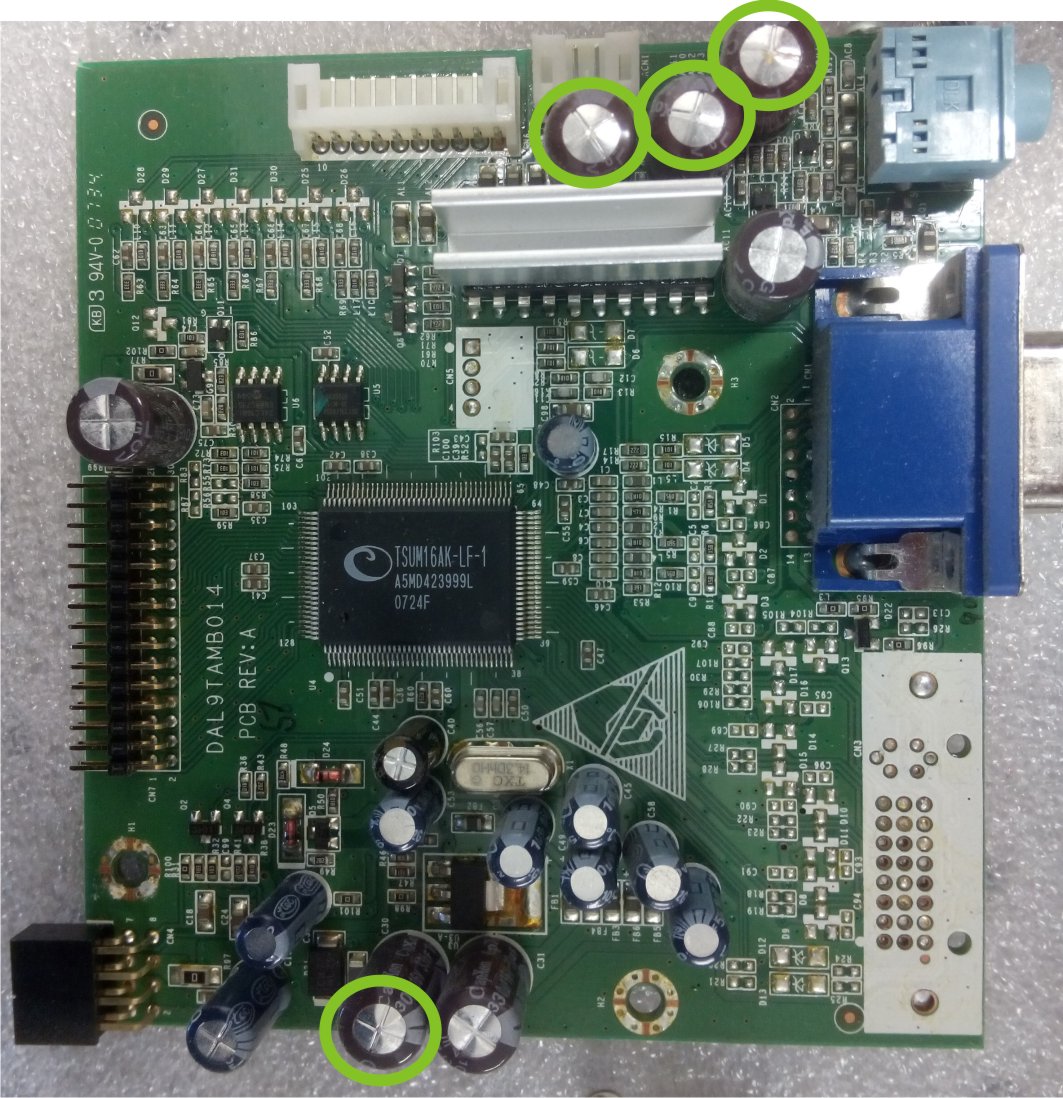

                  I have got the replace caps and took the soldering tool.
                  Now I replaced all caps which I marked in green.
                  (If I find three more of the 330uF tmrw, I will change also the three missing at the VGA board - otherwise it stays like this.)
                  Before I try to switch the display on again after re-mount:
                  Shall I check anything else??

                    Pls upload pics of the boards of the new situation after the cap replacement.
                    And yes, those 3 leftovers (Capxon GL i think?) on VGA board need also replacement if you want to do it right.

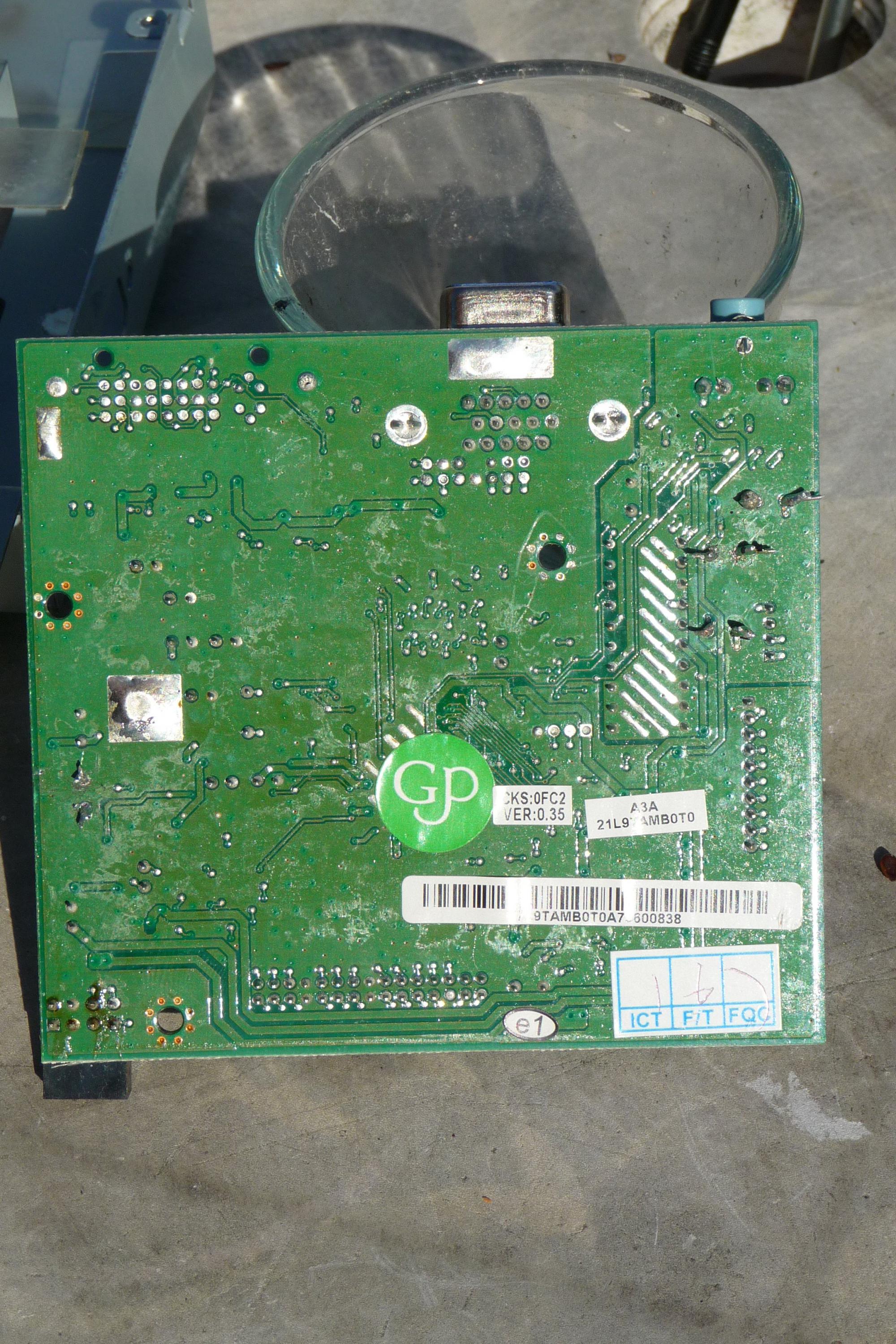

                      If you want input, it would help to see the board after the install from both sides
                      don't be shy, we won't critique your soldering unless a spot looks like potential trouble

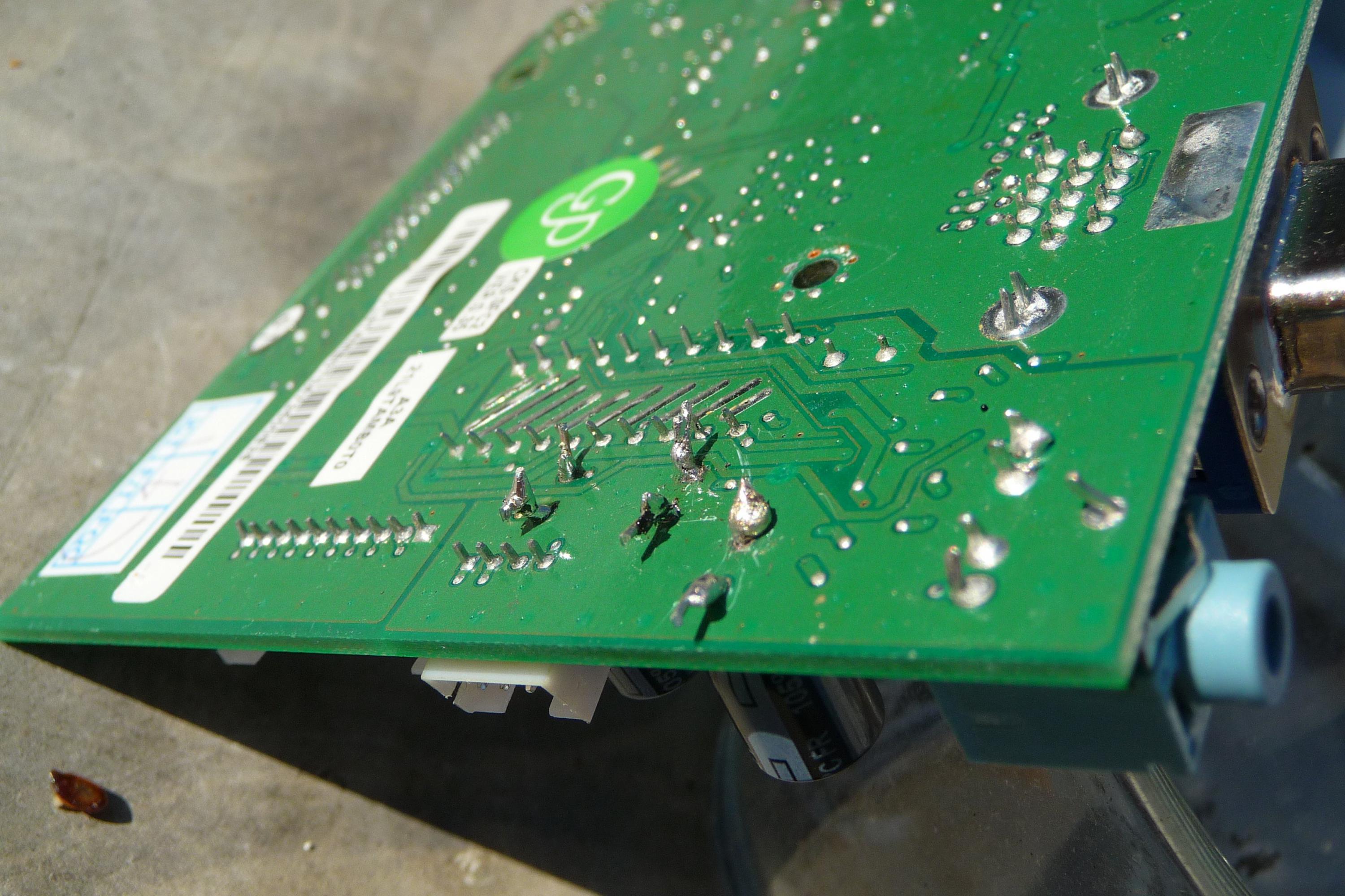

                        No, not shy. But perfect is just another word for my amateurish results ;-)
                        At some places I had to try quite long, but finally I think I could fix all contacts properly (at least mechanically all are fixed!).
                        The snap-in I made with some wire, as well as the 2200uF because it was taller than the defected one.
                        What do you think?

                          well, I am going to recommend some fine tuning.
                          did you use separate flux or just flux core solder ?
                          If you used just flux core solder, there is usually not enough flux in there to get solder to flow nice.
                          If you used separate flux, maybe your iron was not strong enough.
                          Some could use reflowing of the solder which would mean add flux to what you did and reheat them so the solder flows together better.
                          If you iron isn't hot enough, preheat the board as hot as you can with a hairdryer. that can help.
                          On the main board is where my concern is since some of the solder pads there are really small rivets and the other trace is right next to it.
                          if you look at a cap that you did not do, you will see what I mean.
                          Those cap pins should be straight up and the solder shouldn't go out past the trace.
                          you should trim the length of the extra leads a bit shorter because they may get to close to the metal frame of the monitor.
                          If you had installed the one capacitor straight up, I know it was taller than the original, but would it still have fit inside the unit without touching metal ?

                            - The tall cap wouldn't fit without touching metal or not making the fixing screws fitting at all
                            - leads cannot connect metal because of a separate plastic cover in the monitor (but will look how I can shorten)
                            - I did use additional flux (but maybe it is not the newest ;-) )
                            - I will reheat with some more flux and will see if I can improve it
                            - I think I did not touch any neighboring rivets - so it is just cosmetical?
                            Then - if you don't have any more serious concerns - I can give it a try?

                              I did not see much flux residue, so It didn't look like extra flux was used. I guess you cleaned it well.
                              plastic shield works to a point but a sharp rubbing pin can eventually wear through and arc
                              just recheck those few things and fire it up

                                  I did change the last three remaining Caps (330uF) at the VGA-Board and now tested it for two complete days:
                                  It works now like a charme, without any flickering or buzzing as it did before.
                                  So I would say repair acomplished successful thanks to your help, 10 EUR of spare parts and 3-4 hours work.
