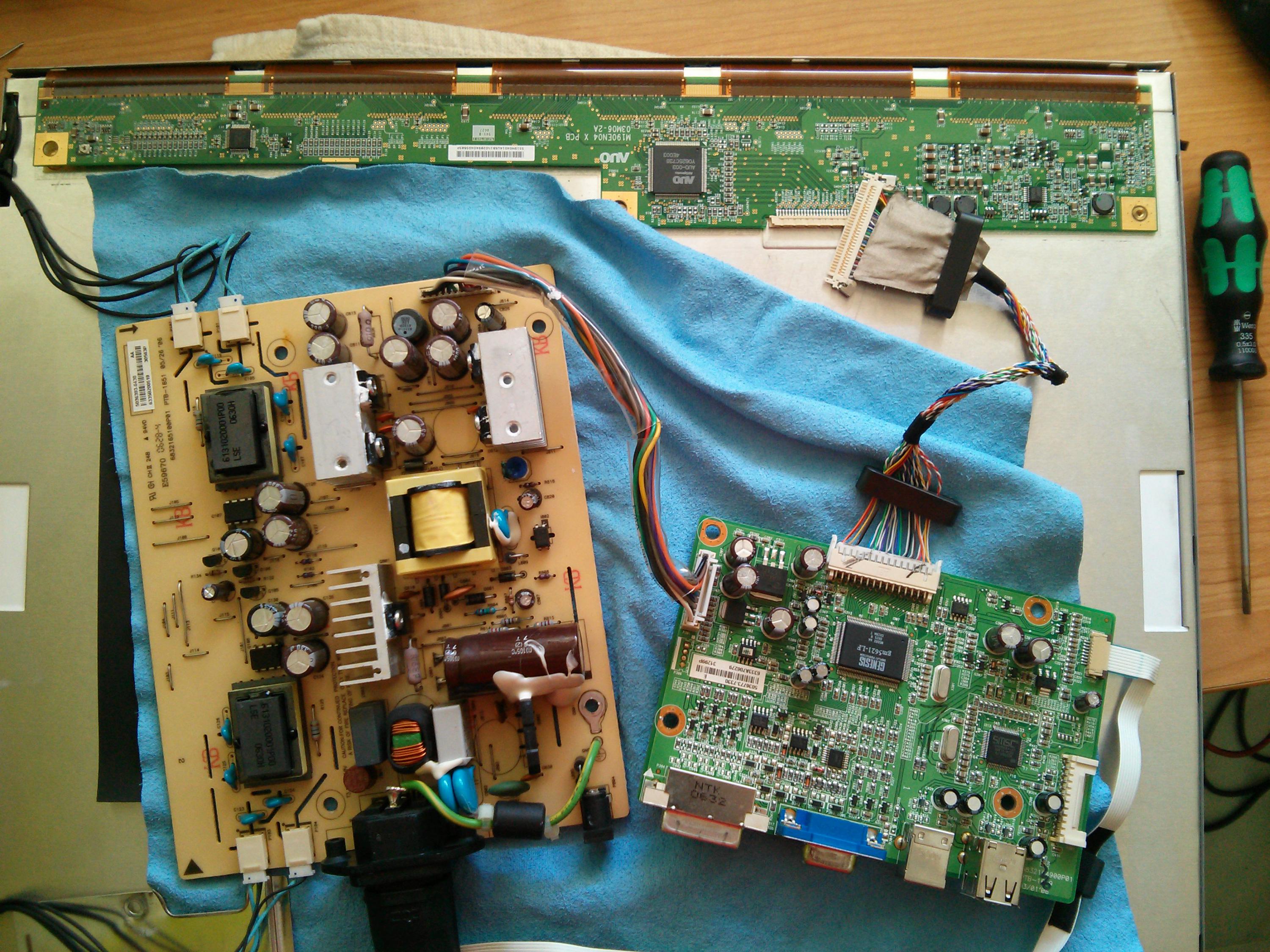

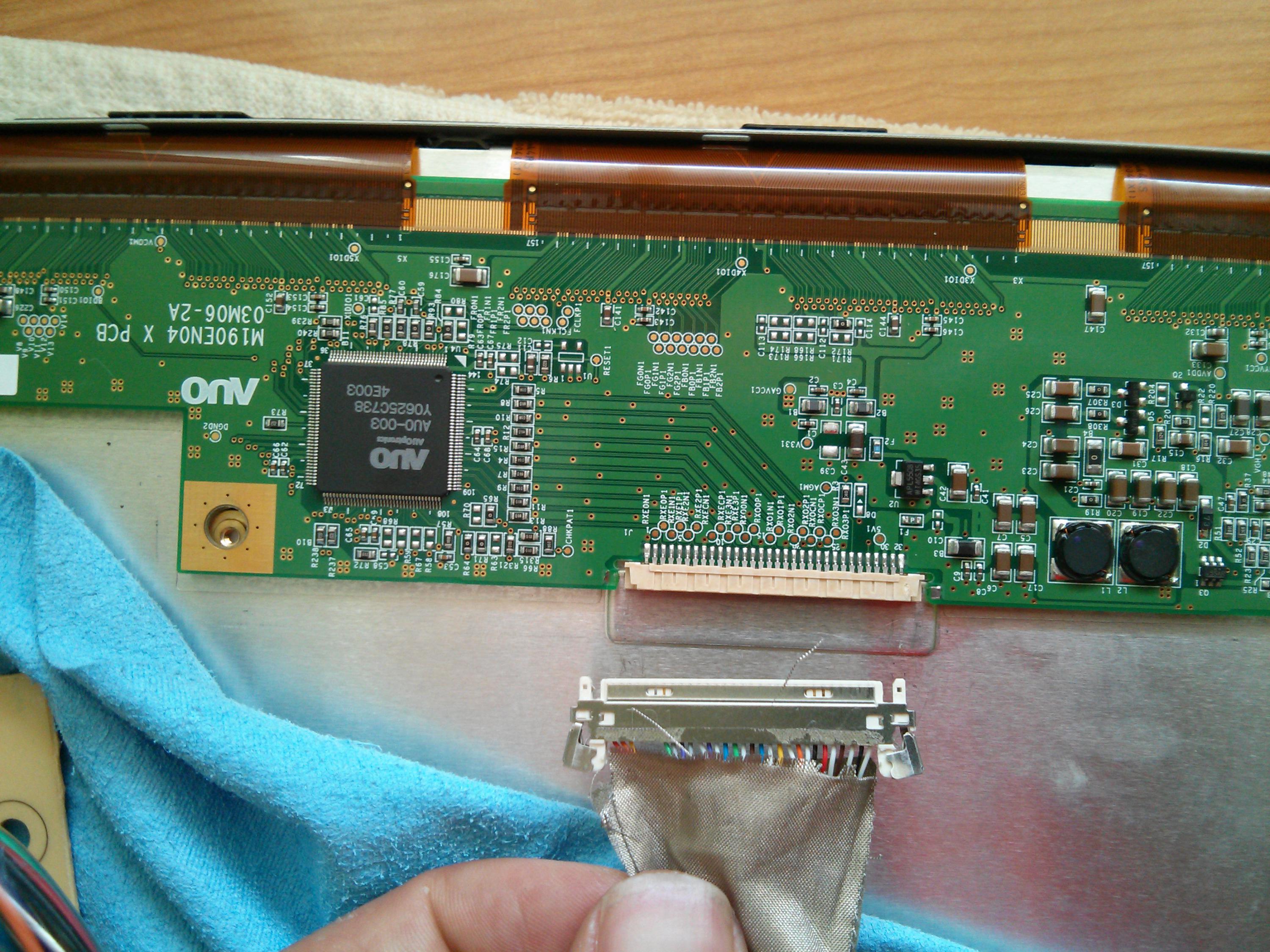

Problem with LCD Panel board
    replied
    Re: Problem with LCD Panel board
    if it drops to zero there is a short.
    if a fet shorts out and it shorts one of the main pins (S or D) to the gate pin, it often damages whatever is controlling it.
    Leave a comment:
  • mokie
    started a topic Problem with LCD Panel board
    Problem with LCD Panel board
    Hello, I have a problem with a Dell 1907FPt monitor. I've already changed a couple of mosfet (AOP605) that were shorted.
    But the problem now is when I plug the lcd panel conector, you can hear a sound from the psu like a little short circuit and the led in the front is blinking with no backlight and no image on the monitor.
    If I unplug this board, the sound disappears and the led stays on.
    This board is a M190EN04 board. There's some information on the internet about this. A pdf is also in the attachments.
    I've checked voltage on power pins (+5v) and they actually drops to cero when I plug the board, so I'm looking for a blown fuse or something like that on the board.
    Thanks in advance.
    Last edited by mokie; 05-03-2014, 09:34 AM.
  • m1ch43lzm
    by m1ch43lzm
    05-12-2025, 08:37 PM
  • advant
    by advant
    02-03-2020, 12:25 AM
  • lostone
    Looking for help with a Viewsonic VP230mb where the backlight comes on only momentarily
    by lostone
    Hello, I came here after finding some similar questions asked on other monitors and hope someone here can help me get an ancient Viewsonic VP230mp (23" 4:3 LCD) back to working condition.
    First a little background, I have a background in computer and electrical engineering, and I'm smart enough to know I know nothing about LCD displays and how they work. For this topic I'm as green as they come.
    When the display is turned on the viewsonic logo displays in the uppper left for 2 seconds then the screen goes black, the power LED is green (on) and when a computer is connected...
    05-19-2024, 11:40 AM
  • stylishconsultant
    un60j620dafxza - Samsung No Display Problem
    by stylishconsultant
    Hi All,
    Need help.
    I have a samsung un60j620dafxza led tv. When I plug it in it has no display, no sounds, and no standby lights.
    So I opened the tv and disconnected the power to the mainboard and the backlight powered up. This according to many people says that this is a mainboard
    problem. I checked the voltage coming from the stb and I read 1.3 volts on pins 1,3,5 and 7 which are low volts instead of 13 volts which i think the lcd panel
    might be drawing too much power from the power supply that it prevents the right voltage going to the mainboard....
    09-04-2024, 03:26 AM
  • perzyk23
    Lenovo T580 - LCD Panel problem - error 0288
    by perzyk23
    Good morning,
    I have a problem with Lenovo T580, which after error code 0288 suggests a problem with the display. I checked the display and it works on another laptop. I replaced the display cable with a new one. I programmed another BIOS (downloaded from this forum) and I still have the problem of a dead display - there is an image via HDMI, and the system does not detect the built-in LCD at all. The problem appears to be hardware. What can I check to confirm or disprove this? I found many threads on the Internet related to this problem 0288, but without specific solutions. Please advise....
    10-25-2024, 12:42 AM
