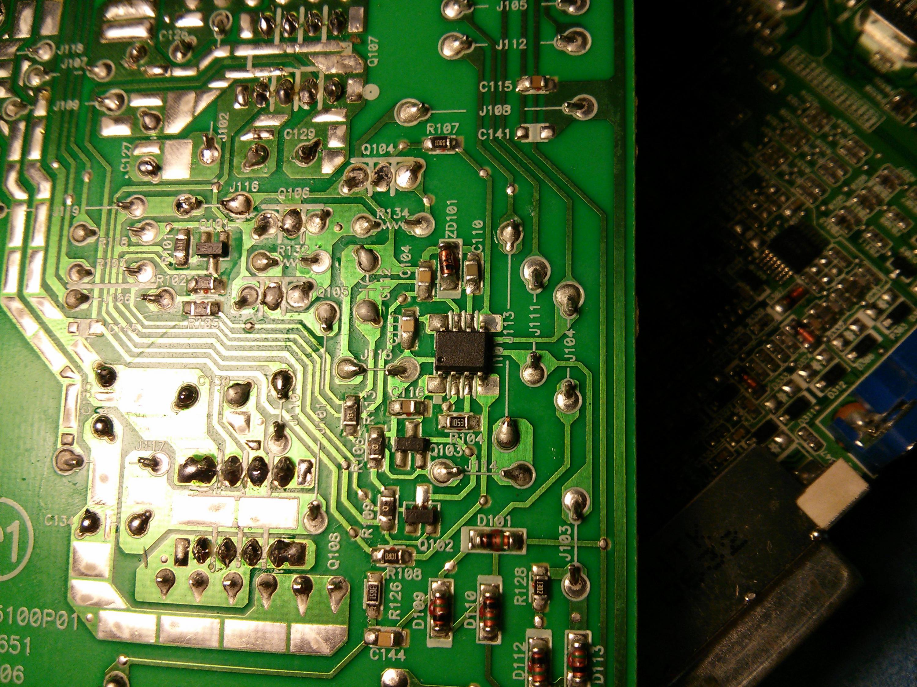

    Hello, I have a problem with a Dell 1907FPt monitor. I've already changed a couple of mosfet (AOP605) that were shorted.
    But the problem now is when I plug the lcd panel conector, you can hear a sound from the psu like a little short circuit and the led in the front is blinking with no backlight and no image on the monitor.
    If I unplug this board, the sound disappears and the led stays on.
    This board is a M190EN04 board. There's some information on the internet about this. A pdf is also in the attachments.
    I've checked voltage on power pins (+5v) and they actually drops to cero when I plug the board, so I'm looking for a blown fuse or something like that on the board.
    Thanks in advance.

    if it drops to zero there is a short.
    if a fet shorts out and it shorts one of the main pins (S or D) to the gate pin, it often damages whatever is controlling it.

      oh god, I'm stupid. Rookie error. The conector was REVERSE!.
      Now I have the monitor working but without backlight. I've checked both mosfet of the inversor and they are ok (AOP605).
      I've checked the lamps with an external inverter and they are fine

          Check for dc voltage at the first corner pin of the P605 to make sure power is getting to them. Not sure if these are fused on this board since I can't see the bottom.
          The pin you will be checking will probably be connected to one of the capacitors that is right next to them.
          voltage may be 12-18 volts based on other boards I have seen.
          if voltage is not there, check for a surface mount fuse under the board
          If voltage is there, then you may have cooked the controller chip that is on the other side of the board. that chip,I think ? is an 8 pin
          good bottom side picture of this area might help

            Re: Problem with LCD Panel board
            look at the picture.
            On the bottom, there is an IC with 8 pins. It's a OZ9936GN
              Looks like power is getting there and that no fuse was involved
              That OZ9936GGN should be what sends power to the two P605
              It probably sends around 5 volts to one pin to turn the P605 on
              does the 5 volts show up and stay on ?
              go you get 14.3 on both P605 drains ?
              do the backlights flash at all ?? (leave the wide 30 pin plug that goes to the actual lcd panel disconnected when looking for a flash)
                - I don't understand well the first question, but when I turn on the monitor there isnt't any signal on the gate pin of any mosfet
                - Yes, I get 14.36 volts on both drains (and both mosfets, each mosfet has 2 drains)
                - The flashlight doesn't flash at all (with or without the 30 pin plug)
                Probably it will be that OZ9936GN. I think this is a good deal http://www.ebay.es/itm/2X-OZ9936GN-O...-/360619504921
                The problem will be the soldering though.
                      OK, Your first post said shorted
                      It still might be an OZ controller chip issue
                      check pin 6 for around 5 volts in (7 is max per the datasheets)
                      then see if pin one gets voltage when you power it on (might be around 3 volts) should be between 2 and 4
                      then check 4 and 5 which should be the two pins that drive the P205
                      pin 7 is the dimming voltage and would depend on what the dim was set at so it may be between 0 and 3ish.
                      based on your picture with the pin 1 and the dot at the bottom left
                      pins should be as follows
                      8 7 6 5
                      1 2 3 4
                        This is what I get. I guess that the OZ is cooked
                              I've replaced the OZ9936 and I have the same problem, no backlight at all
                                      can you post a picture of the new installed chip
                                      just for giggles, use an ohmmeter and check pin 3 to make sure it has a good ground
                                        Here are photos of the new OZ9936 replaced. I did the best I could. Yes, pin 3 is connected to ground
                                        In summary, I have checked:
                                        - Secondary of both inverter transfomers. Around 460 ohms.
                                        - I have desoldered all capacitors and their capacity is ok (maybe they have high ESR?)
                                        - I have checked what I think are two fuses for the inverter zone. They are located near the OZ9936 and they are ok.
                                        - I have replaced the two main mosfets for the inverter zone which were opened. They were P609 and I replaced them with both P605.
                                        - I have resoldered all the connections in the high voltage zone.
                                        - Of course I have checked both lamps with an external inverter and they are ok.
                                        I don't know what more to do.
