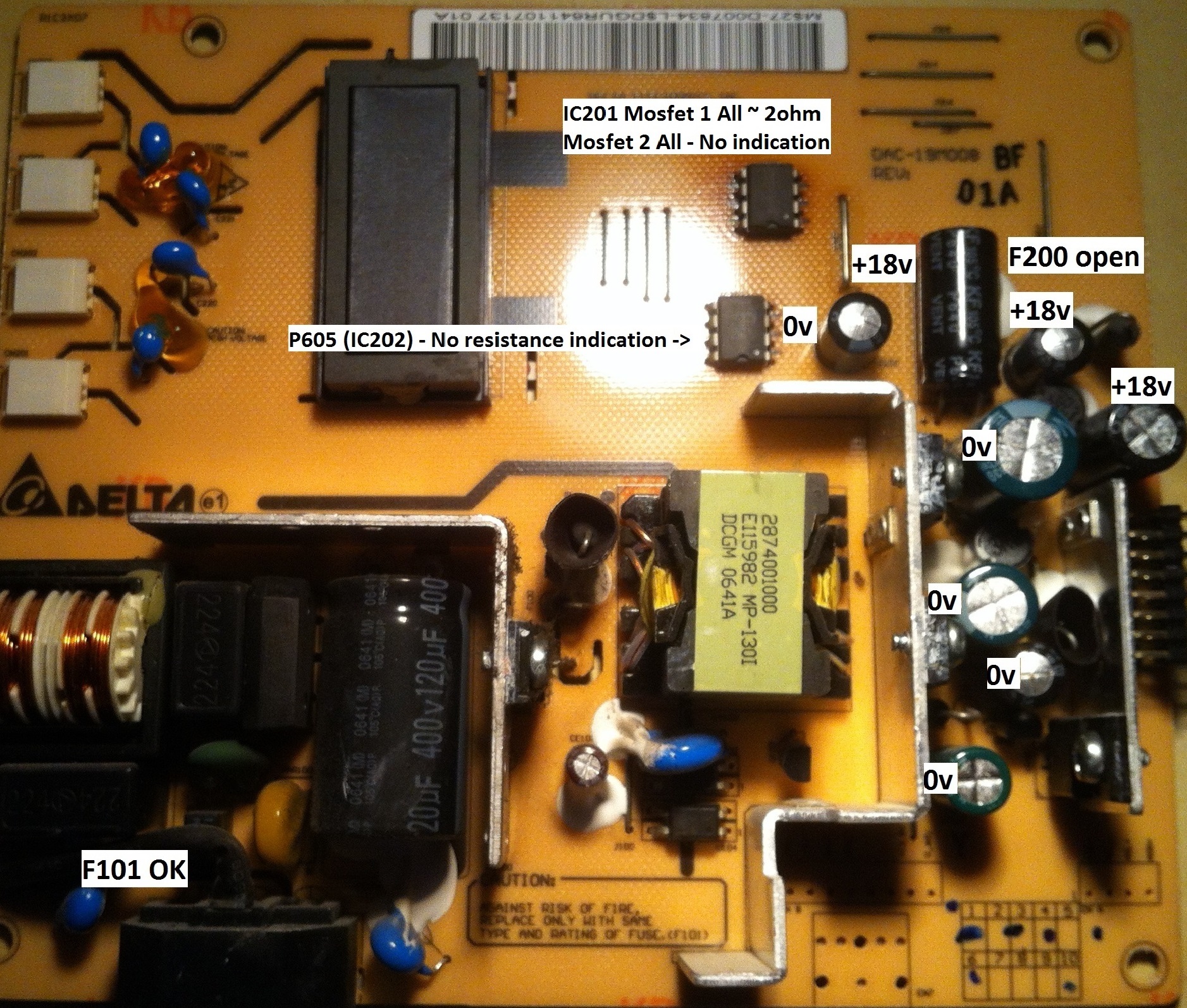

    The monitor is a ACER 1916w. The first thing I checked was if the LCD was still functional, this mostly because I was thinking to make this screen into a diy projector,
    but I realized that the panel is to big and also I could use a secondary screen and 19' would be perfect. So using a flashlight I can see that the LCD panel is still Ok, and shows the graphic it is suppose.
    So I decided to open the monitor up and see if there was some loose cable to the back light or some easy fix like that. But no go.
    What I did after this was to google it, which lead me here. And after reading all I could in you forums I will now post yet another ”help my dac-19m008 is busted” (BF Rev-1A).
    In the picture ””DAC-19M00B-BF-01A-TOP”” you will see the different values I got when I checked the voltage on the caps (just after unplugging power) I also checked the fuses and the mosfets.
    And if I understand what I read here on the forum, the problem seems to be the first AOP605 mosfet on IC201,
    it's the only mosfet giving me a low resistance response (~1-2 ohm using my multimeter set to 200ohm)
    The other 3 is not giving me any value on the multimeter, and as I understand when the mosfet malfunctions it's common that it shorts and gives a low resistance reading.
    (All the images are also attached in this post)

    My conclusion after this is that mosfet 1 on IC201 should be dead right?
    The F200 fuse is also blown, but this I understand is quite common with mosfet malfunction (or maybe the other way around?)
    What makes me a bit confused though is what I should do with the caps, are they busted,
    or do I get these readings because the blown F200 fuse and the faulty mosfet, or should I just go ahead and replace them all just for the sake of it?

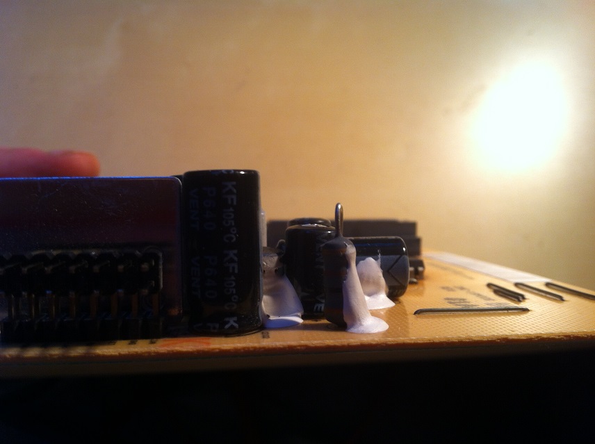

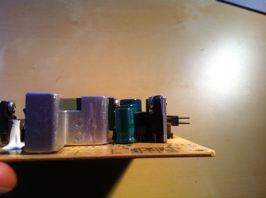

    I've also attached 2 pictures of the caps in profile, and they look pretty ok, but then again I'm a rookie in this subject
    Please let me know if there is something else I should check, or if there is something I've done completely backwards

    • 31077
    Re: Bad DAC-19M00B PSU, would appreciate some pro-tips
    you have it working other than the lights.
    so you have 2 options.
    1: remove the fets, controller chip, ce101 & c200 and fit an led kit for about $20
    2: replace ic's201,202 and caps c200 and ce101 with panasonic FR series and hope the transformer & tubes are good.
    it's 50/50 unfortunatly.
    personally i'd get the led kit every time now they are so cheap.

          well i looked at the manual now,
          those caps i mentioned look like the tops are domed - can you confirm that?
          as for the fets,
          desolder them & meter them again.
          the problem with metering transistors or fets that connect to a transformer is you can tell if the meter is seeing the fet or the transformer.
          and the upper chip has a lot of heat marks around it

            Your caps are shots. especially the 3 220x25.
            the 2 100x25 tend to go too
            That is probably why your are getting 18 volts instead of 14-15v
            and it may be why the f200 fuse is out
            And it's also the reason you P605s overheated. I have seen them get hotter than that and still work
            change the caps and fuse and give it a shot

              The C200 And CE 101 is indeed domed (as well as ce109)
              You point of metering things in line made sense, so I also desoldered the mosfets and checked them, the IC201 (the one with the burns around it) Still tests the same. But the other one (IC202) gave me some difference.
              IC201 AOP605 (results with 200Ohm, also tested 200k without success)
              S1-G1 2 Ohm
              S1-D1 0,5 Ohm
              G1-D1 2 Ohm
              S2-G2 ---
              S2-D2 ---
              D2-G2 ---
              IC202 AOP605 (200k)
              S1-G1 ---
              S1-D1 ---
              G1-D1 ---
              S2-G2 ---
              S2-D2 40-68 k?-ohm
              D2-G2 ---
              I have no idea why the results we're so inconsistent, maybe my multimeter needs a new battery or maybe there is some proper explanation for it?

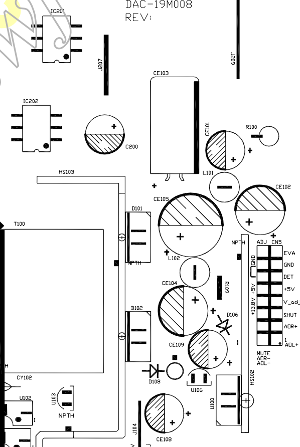

                            Thanks for the schematic, i don't knew there was schematics for a single board! It's an interesting one, i will try to understand what the second opto does (don't mind if you don't know whats an opto)...

                              Its curious how the swollen caps C200 Ce101 CE109 have the same size, are in different branchs of circuit and it is not relative to proxmity to heatsinks, maybe the smaller ones due to size dries easier and get higher esr maybe because it's heat is generated outside by diodes and not inside...
