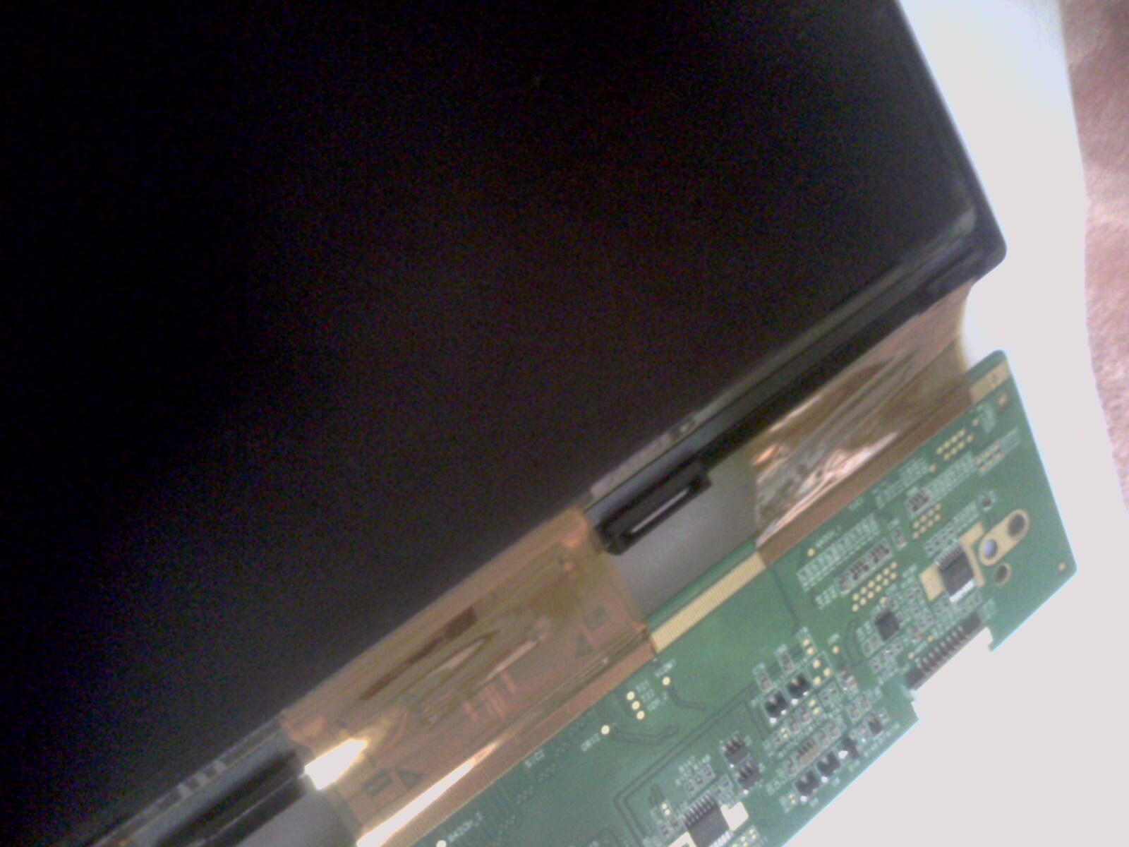

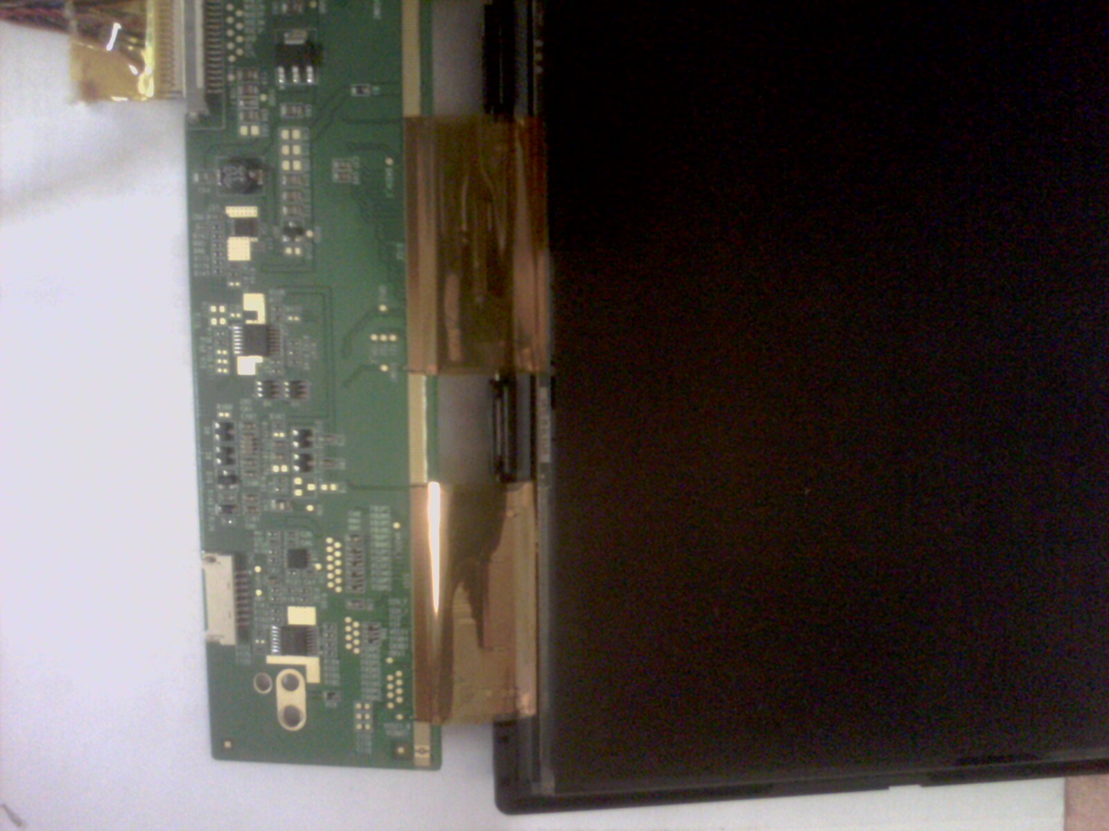

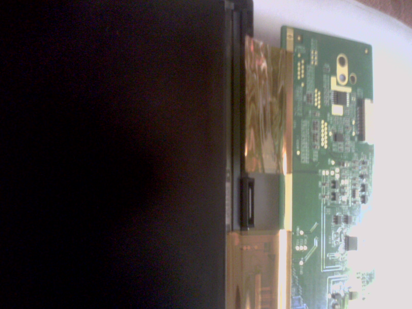

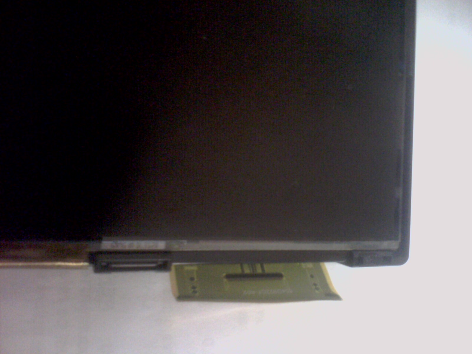

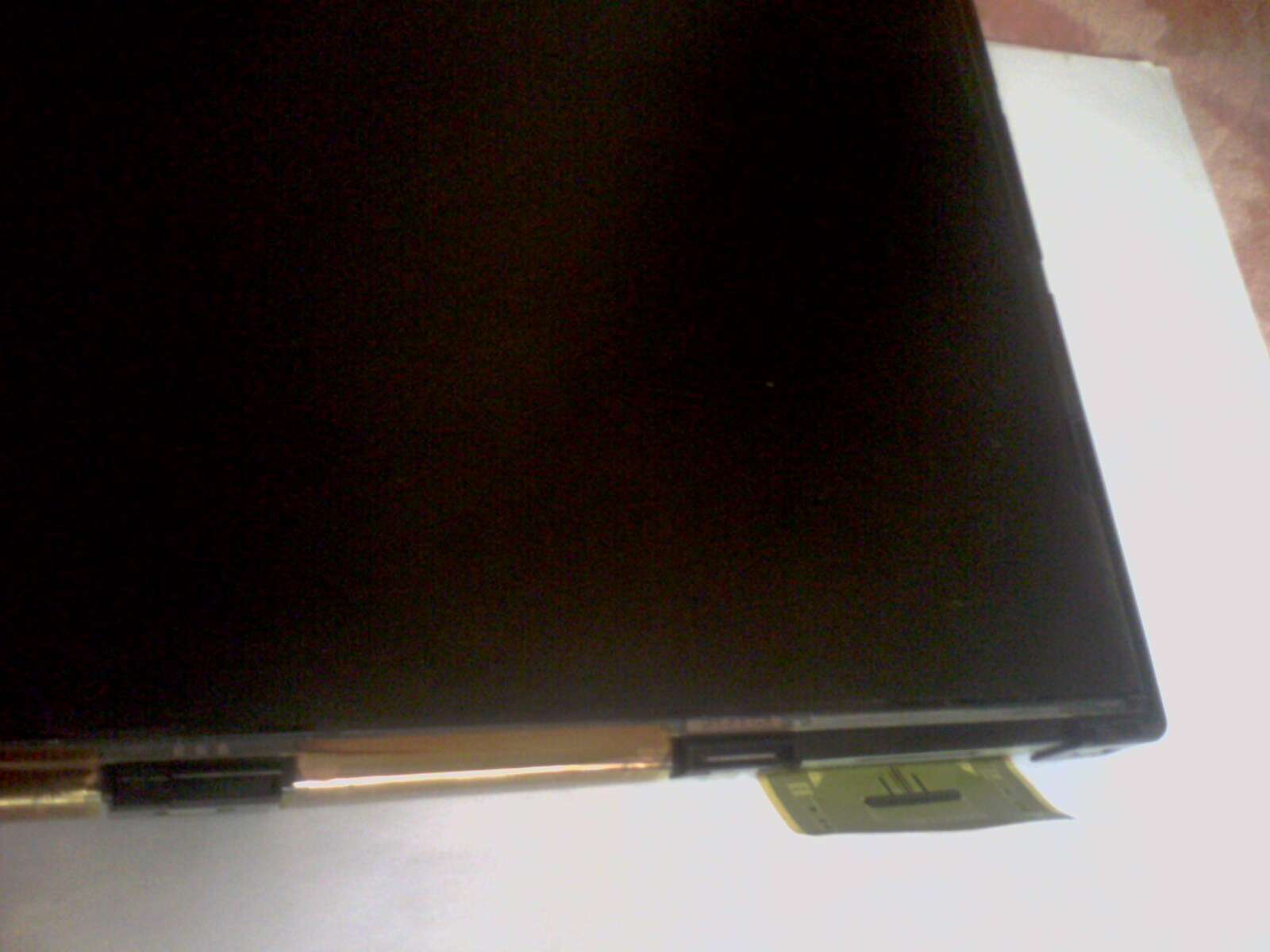

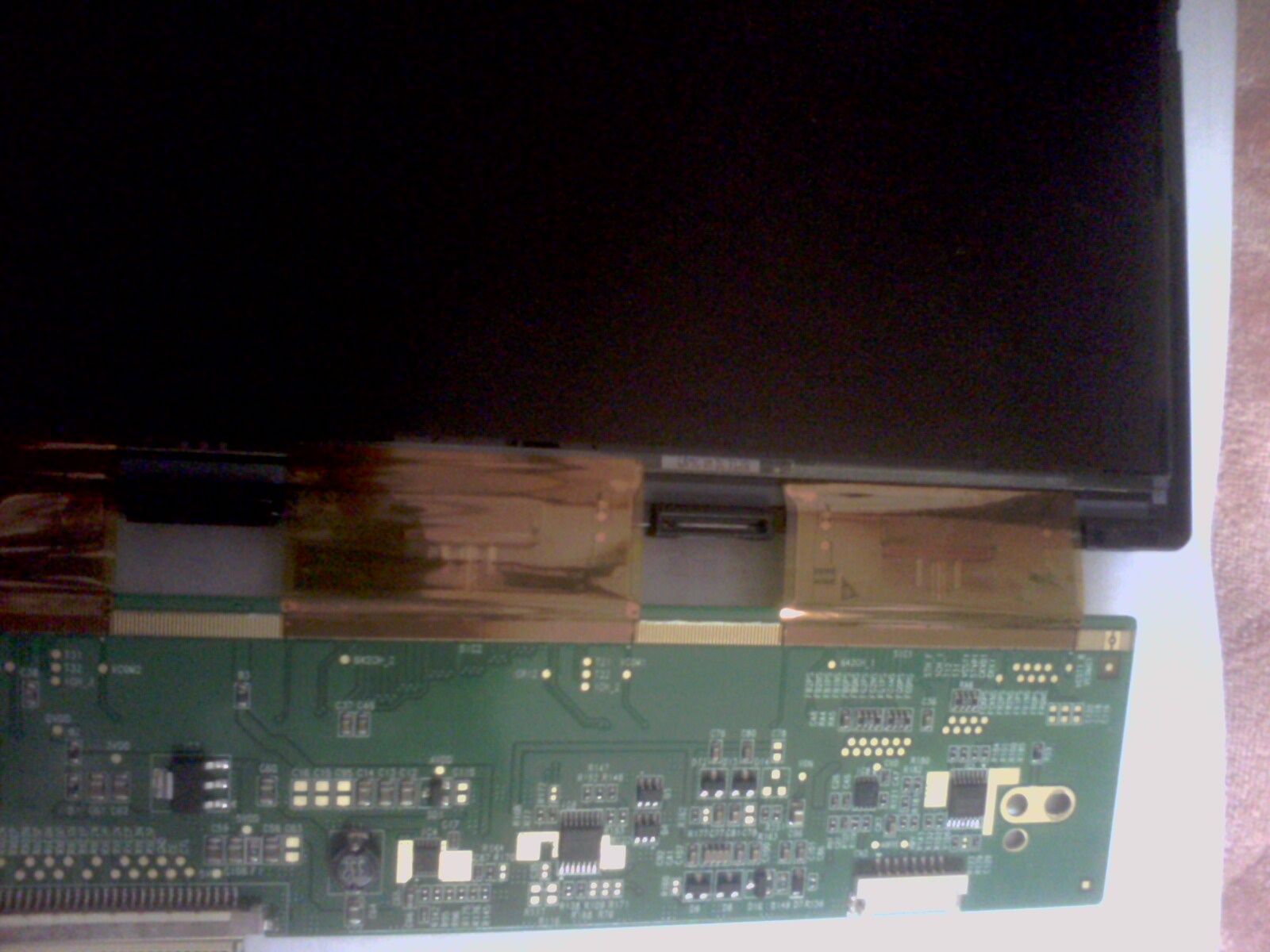

    Hey Folks,
    Attached are sample shots of one of my LCD screen with a disconnection of the data cable between the logic board and the LCD screen.
    The connections came off (kind of peel-off on both side) on the LCD side, causing that section of the LCD screen to be dead.
    Does any know of ways or tool or material or process involved to fix such issue.
    It seems like a specialised type of soldering, electrical glue, conductive substance is used?
    Regards

    I've done some repair of these before. The way I've done it was by rubbing a regular soldering iron on top of wax paper on top of the ribbon on the board. This keeps the direct heat from melting the plastic of the ribbon.
    Its worth a try.

      Thanks man,
      I'll give it a shot, although this is on the monitor side.
