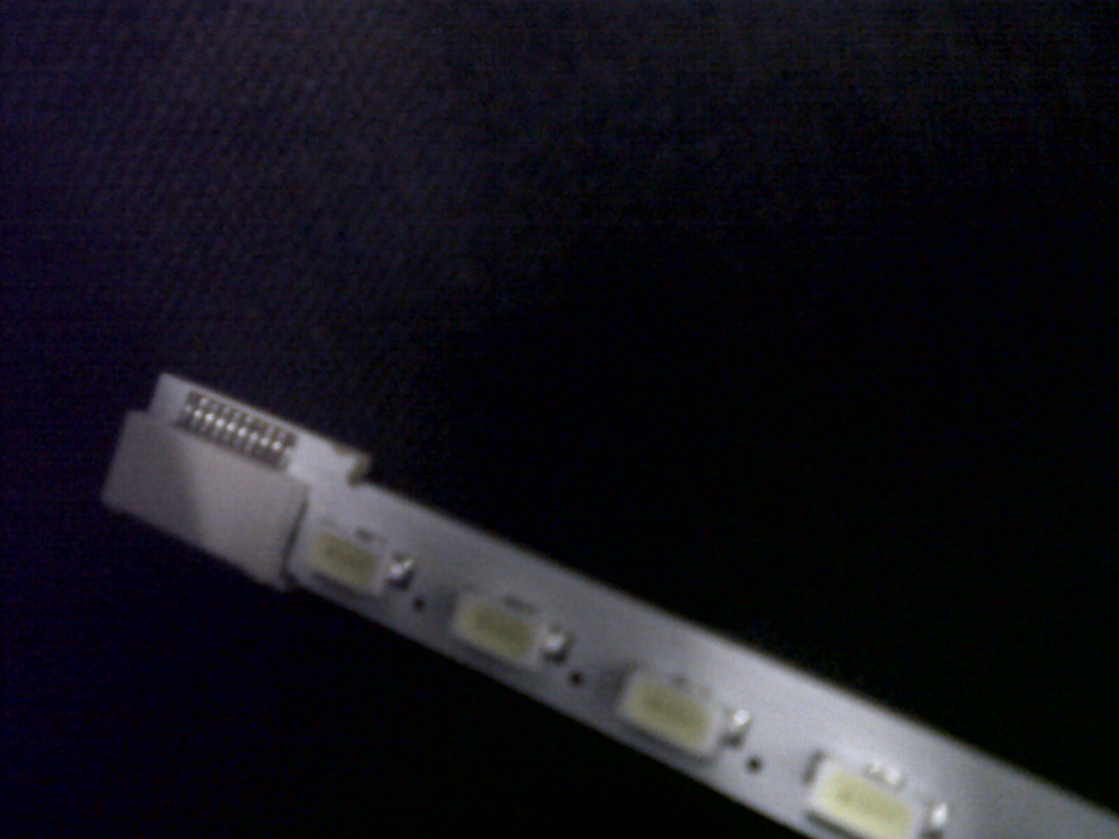

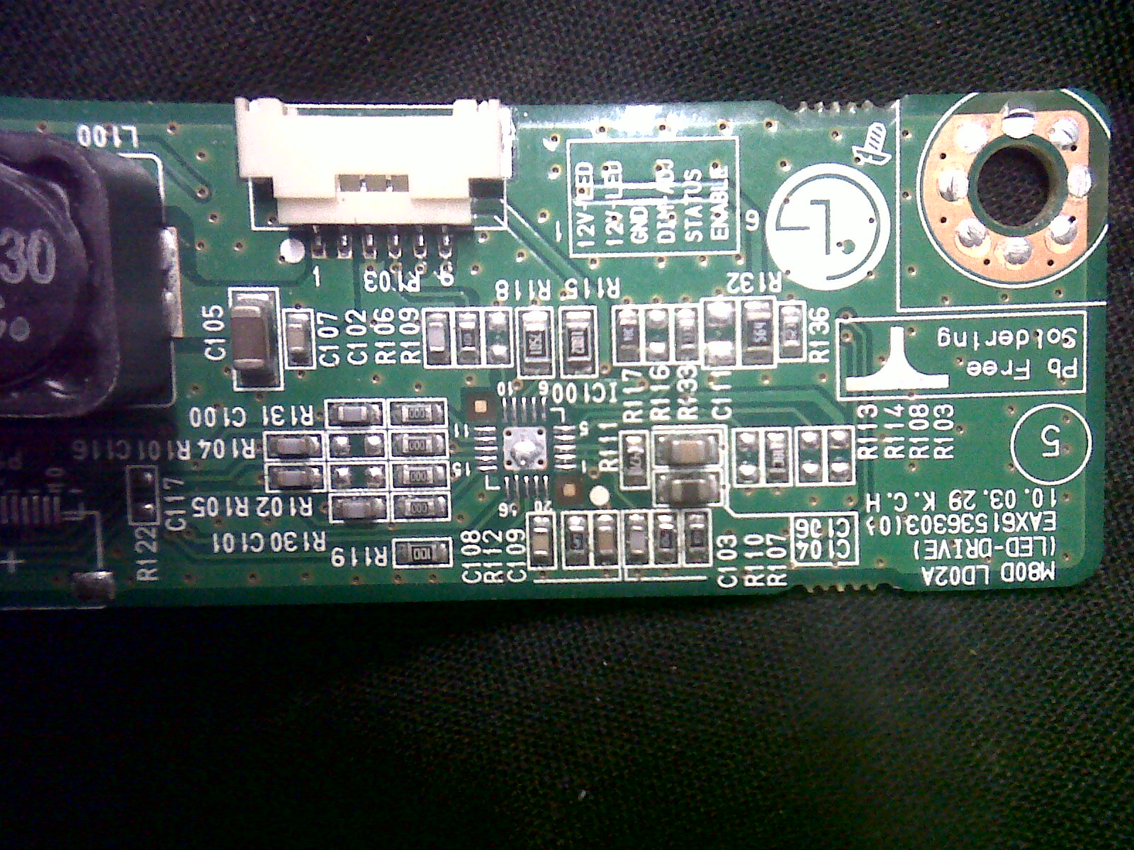

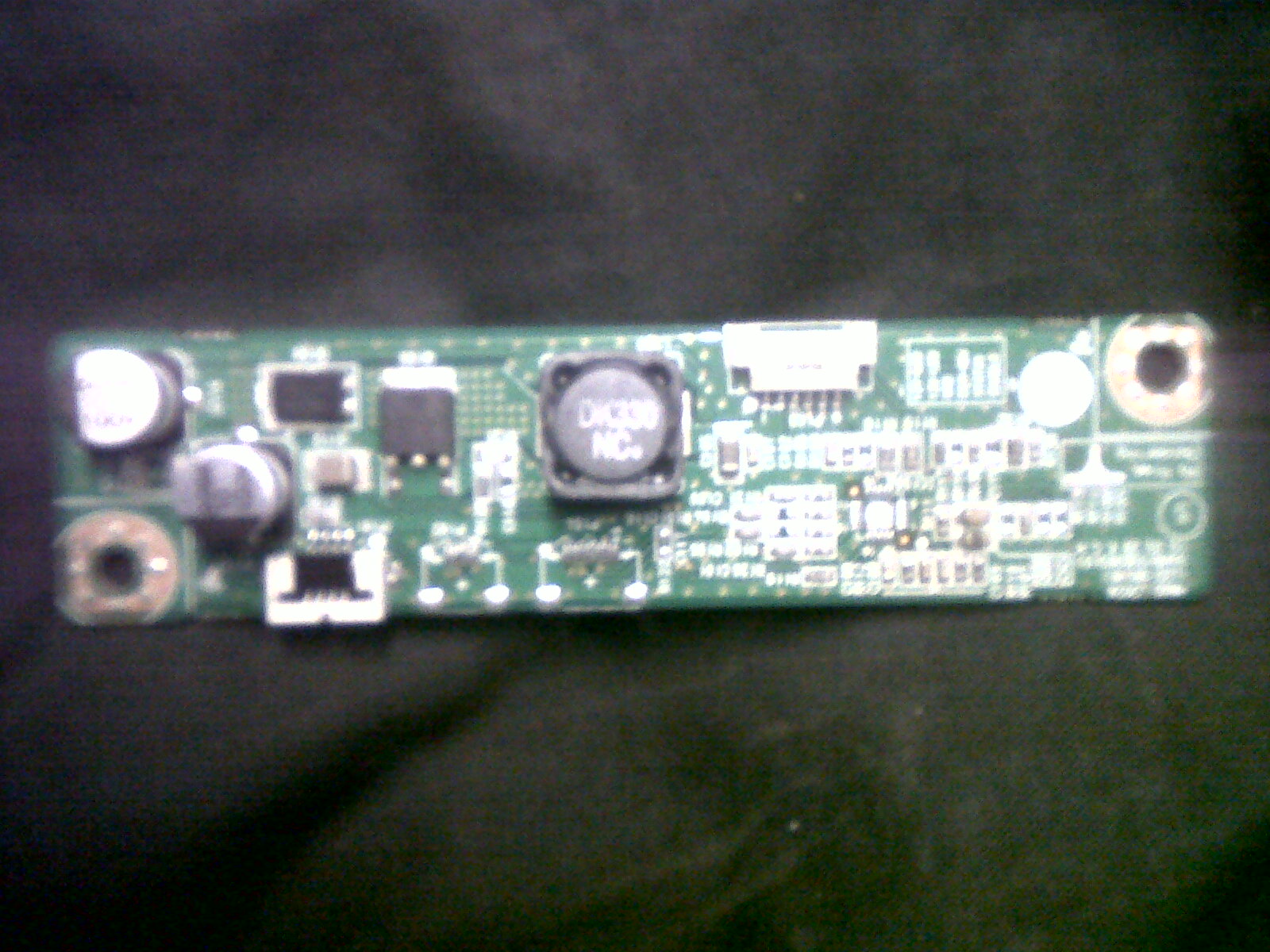

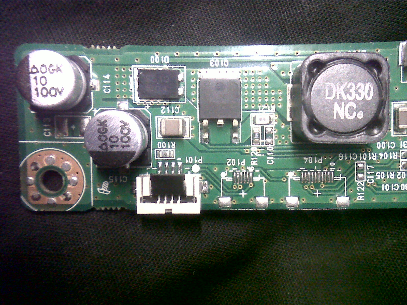

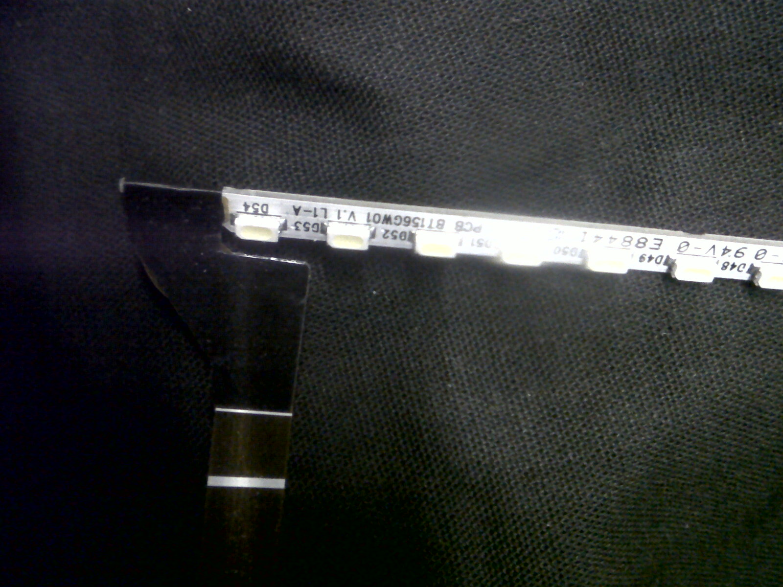

    soo.

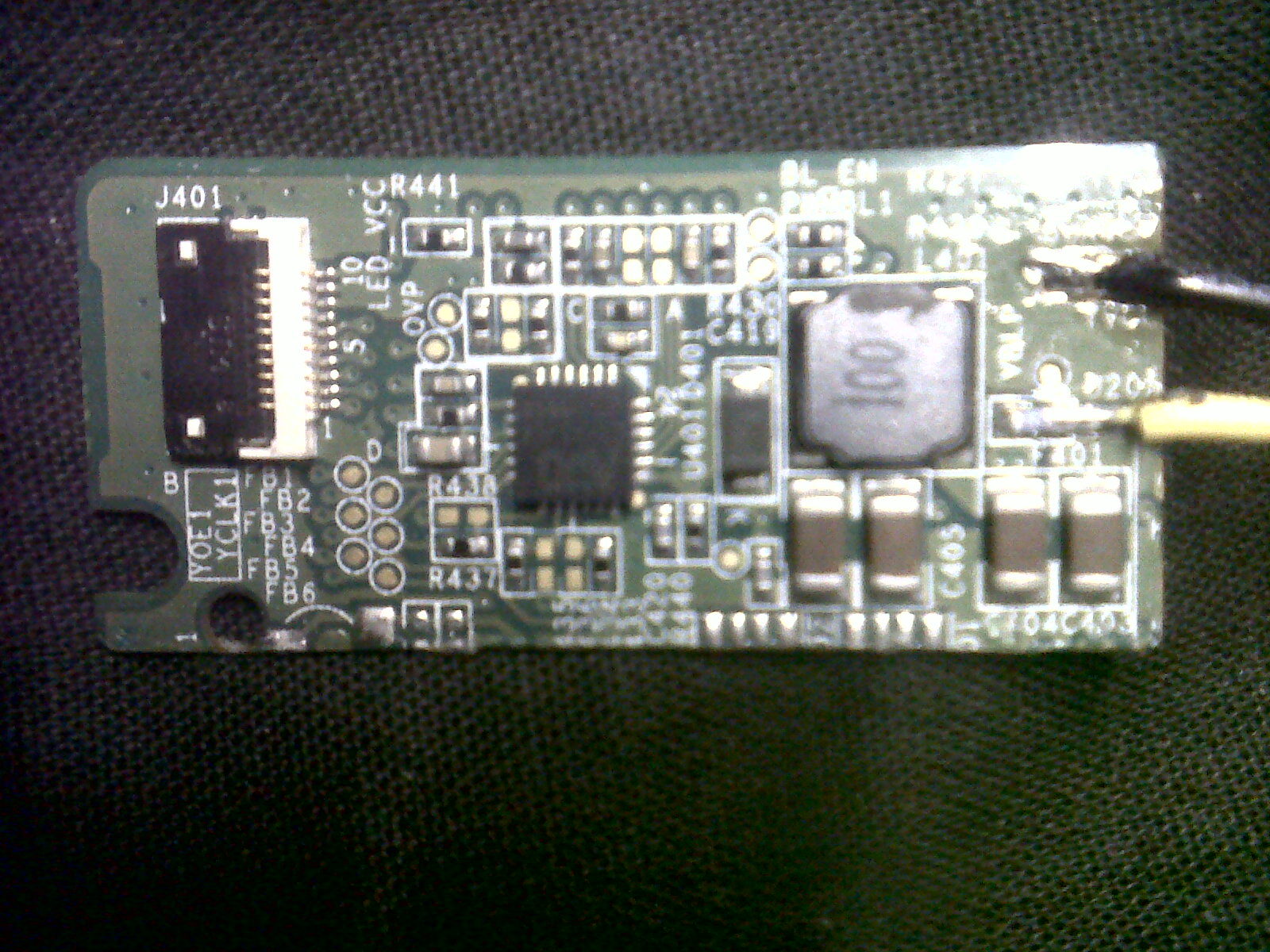

    some foto's
    an lg 4pin driver usnig 1 common & 2 sequenced chanels.
    the chip is missing on the board because it blew.

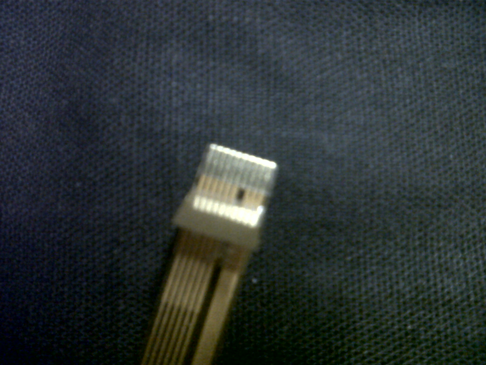

    and a 6 chanel 10pin driver that a cut from a broken laptop display to use as an upgrad on anothe machine.
    (yes - that trick works)
    and some strip foto's

        well i looked at the foto's,
        and it's very unusual - and a poor design.
        all the ones i'v seen - and i'm not talking laptops.
        use a single coil to step the voltage up and then use fets - usually in the controller, to drive the leds with pwm.
        the controller ic has the current-sense, the fets and the sequencer etc all internal.
        seeing that row of coils is just strange.
        i'd id the controller chip & get a datasheet.
        (and if you tell me there is no controller chip then id fit one or trash it)

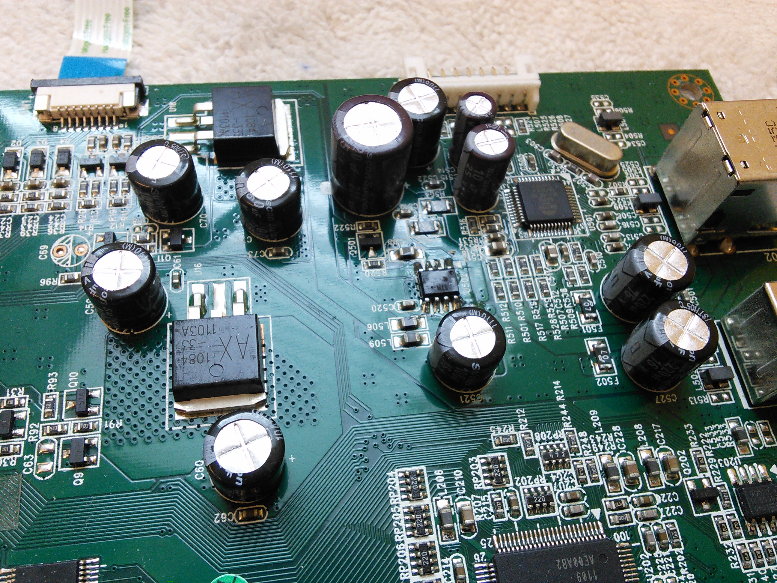

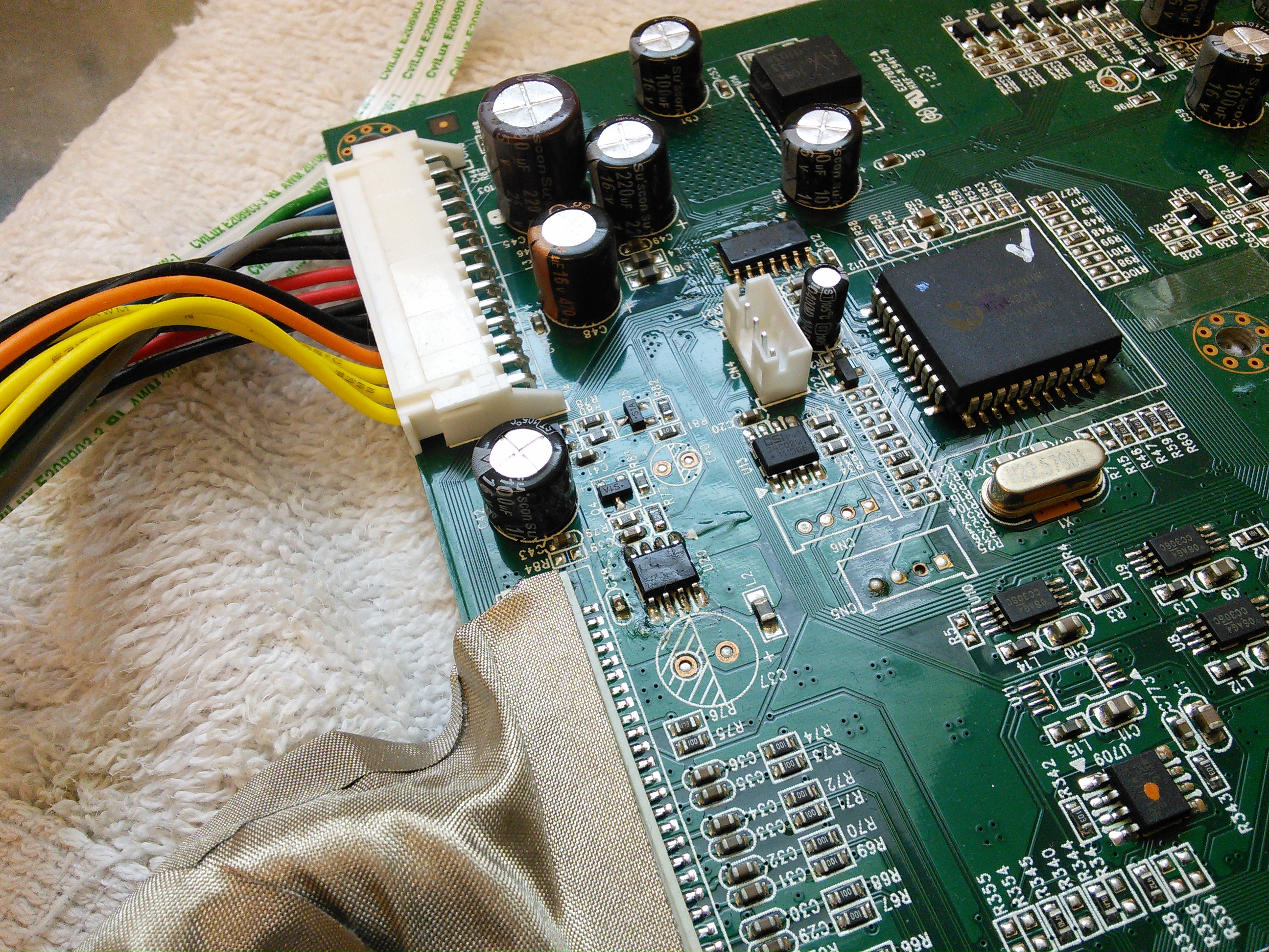

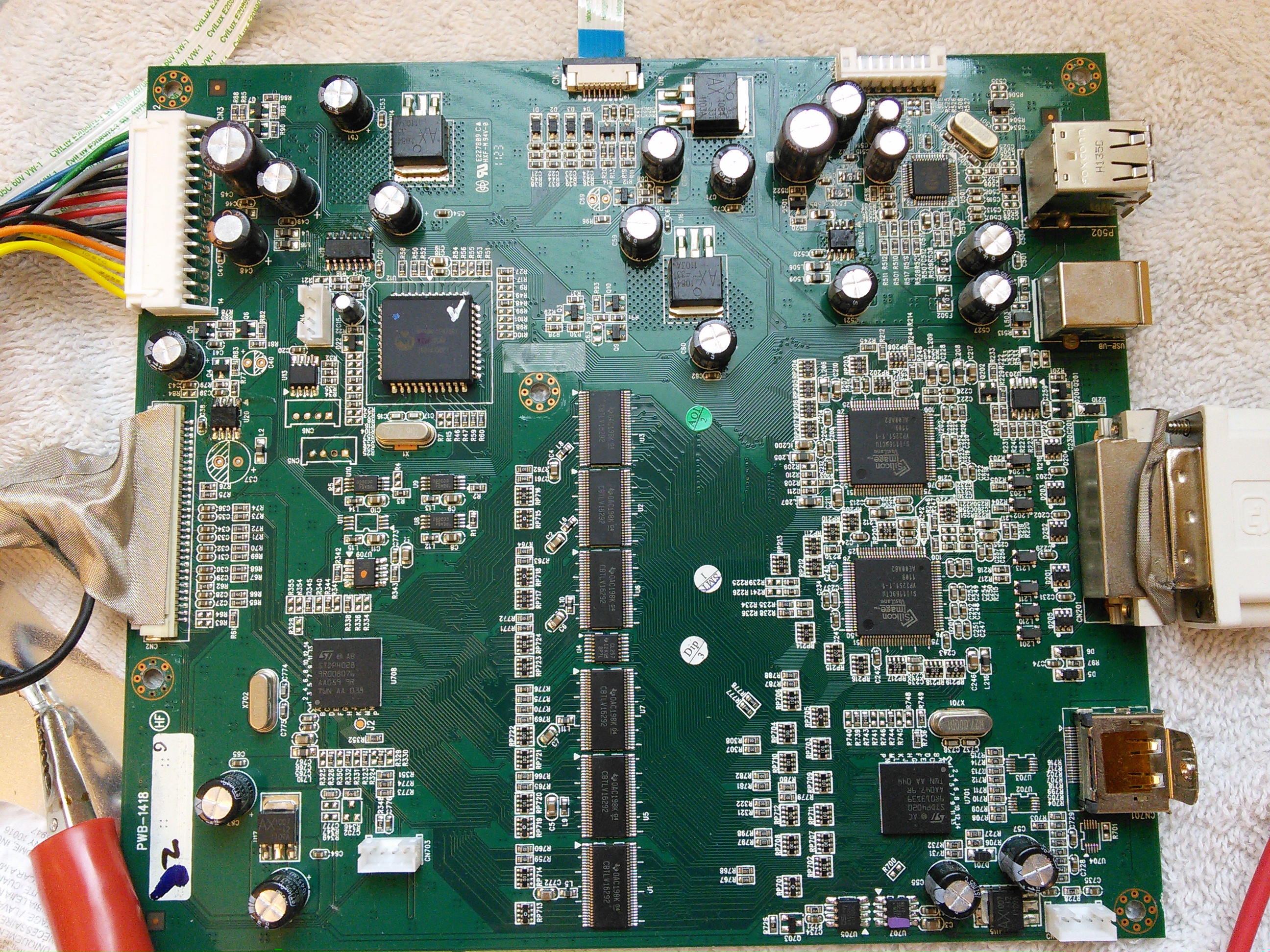

                                    The last pictures are of your main board.
                                    All that does is send power to turn on the power on on the led power side of the board.
                                    Your boards do not have an LED driver chip like the 24 pin surface mount one that is on the pictures of the laptop driver board that is shown in #21.
                                    I believe that yours is more like a ccfl inverter
                                    It looks like power from the main board goes to I810-I814 and I815 and those power up the T804 T805 and I assume T803 transformers (can't read that number) -- I can not tell if I810-I814 and I815 are in series or parallel or if they are all the same part number. I think that they are pretty standard transistors and that your issues are here or in the leds.
                                    with the boards powered up and with it connected to a computer, check to see if you have voltage at Vadj, On/Off and PS-on
                                    My guess is that: Vadj, On/Off will probably be around 3 volts ? Vadj may show voltage even with the boards powered off and may show a lot lower voltage if the brightness was previously set high or low.
                                    PS-on may be 5 volts ?? (It may also work in reverse and be grounding out 5volatge to power up)
                                    Did you check the bulbs for continuity using a power supply to confirm if it is indeed 3 strings.
                                    if it is 3 strings, the 18volt supply wont work because you will lose too much current through 20 leds.
                                    if it is 6 strings, it might let a trace of current through
                                    If you want to try it- just use the + from that power supply to feed the V06 etc pins. (Do not ground the board)
                                    hook your tester ground to the supplies (-) then use the testers (+) probe to see what pin the power comes back out of. Don't touch the probes with bare fingers or you will get false voltage readings.
                                    I usually take the led strip out to check them with a small supply. The last time I tried a set while the bulbs were in the unit was to hook some 12v batteries in series to get my voltage up.
                                    another way to maybe tell if it is 3 or 6 strings is to unplug the led strip and check the v0x pins while trying to power it on to see which pins are getting +
