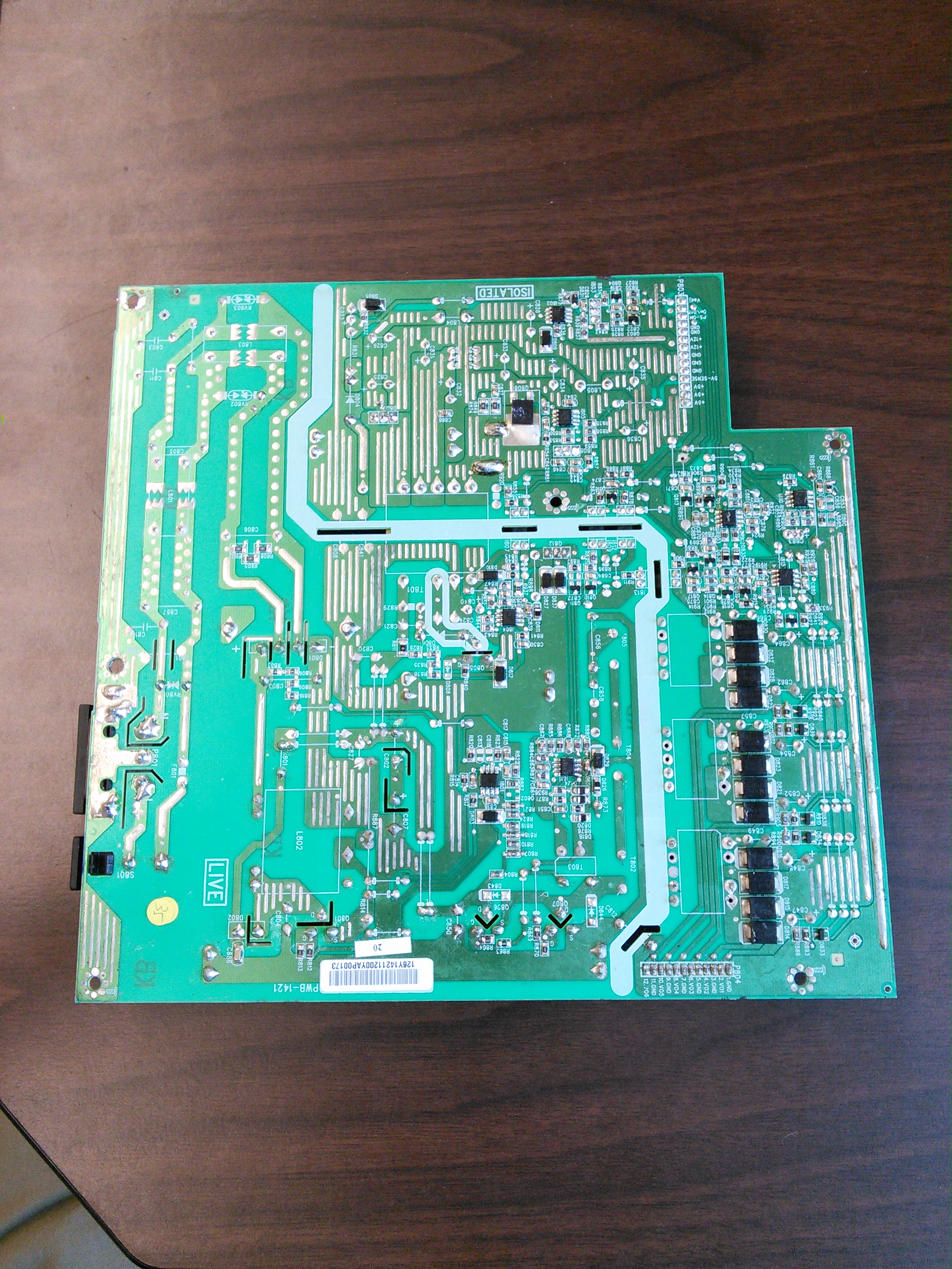

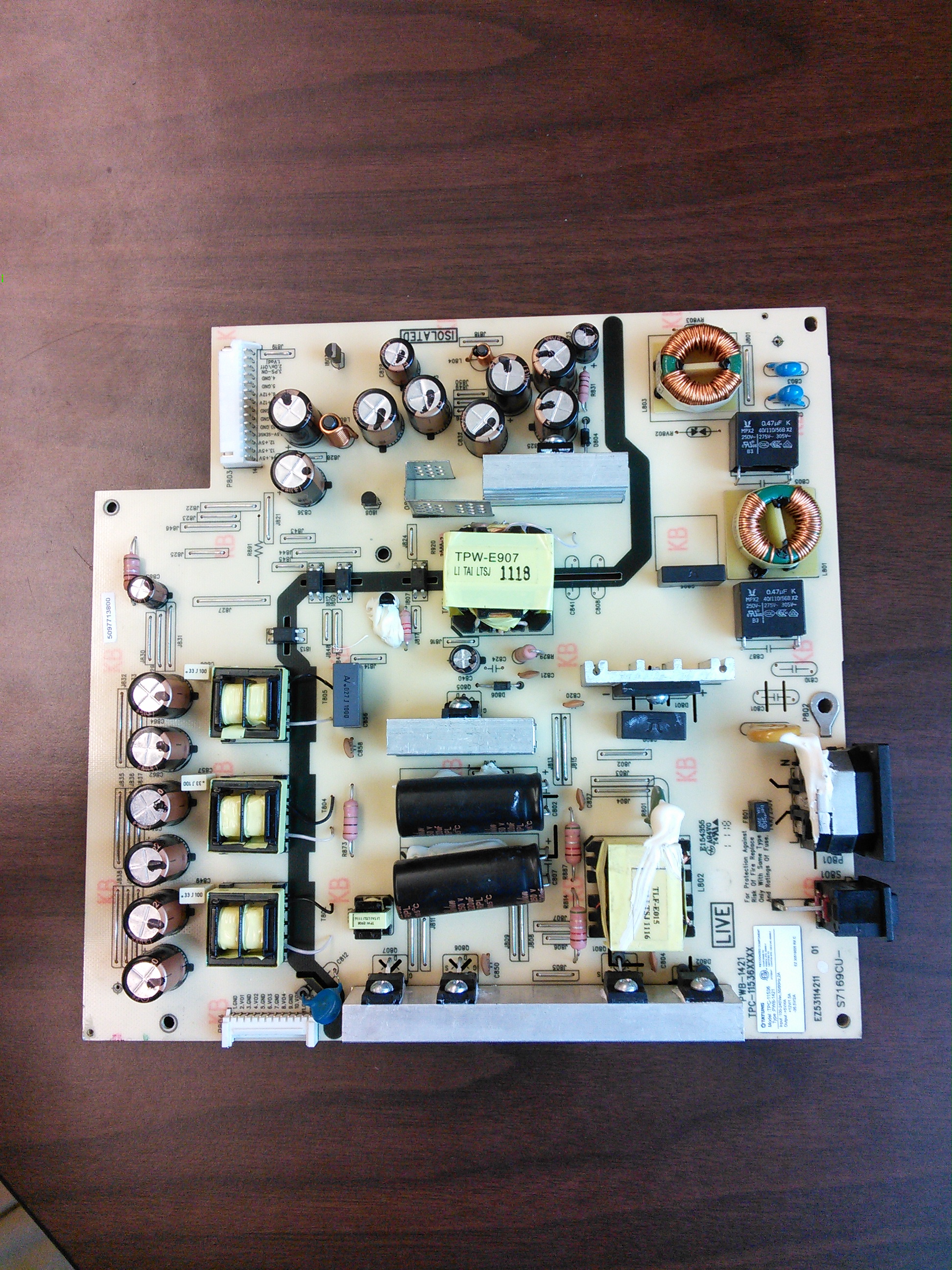

    First time poster here, hoping to get some insight into what is going wrong with this monitor.
    Monitor History - HP ZR2740W, given to me because it was faulting, I accepted it because of the retail value and possibility of resurrecting. I was told that it had been used for the past year and that the person I got it from was told that it was probably a back-light issue.
    The issue - The monitor has a repeatable fault where if the power supply (separate switch near power cord) is turned on and the monitor is being fed a display signal (through DVI, checked with another monitor, and it then powered on with the power button on the front... the LED indicator will light up blue for the power-on cycle time of about 2 seconds with no display showing, and will then flash on then immediately off without any display showing. The blue LED light will remain constant the entire time this is going on but will turn itself off after ~30 seconds.
    I have pulled out the power board and have inspected the board carefully (admittedly I am only capable of looking for obvious goo, bloating, etc.) and I see no sign of any bad capacitors, anything blown or soldered improperly. The only thing that I noticed was that there was some residue the seemed to be a spill of some kind of orangey/brown colored liquid that extended across the length of the board - I cleaned off with alcohol and have put the board back in and there was no change to the fault.
    I count 20 capacitors (lelon) on the board and can only note that some of the tops of the caps seem to be more deeply imprinted with the cross-hatch than others and have slightly more curvature within each segment than others do, IE: some look more flat than others, but none are obviously bulging.
    I am new to the whole scene and have not been able to find any threads of people repairing this particular model before, on this site or googling for other threads for a few hours
    I have attached images of the front and back of the board.
    Ideas?

      It has LEDs backlights, 6 strings total (6 filter caps on the left side of the board) from what I can see on the connector P804 (VO1 ~6).
      So if one of the LED sting has open circuit due to bad LED, the LED driver circuits will shut down, or if one of the wires is shorted to the metal chassis, it will also go into shutdown.
      So check and see if you have any DC voltages on those VO1~6, you may have to cycle the monitor on and off to look at each pin.

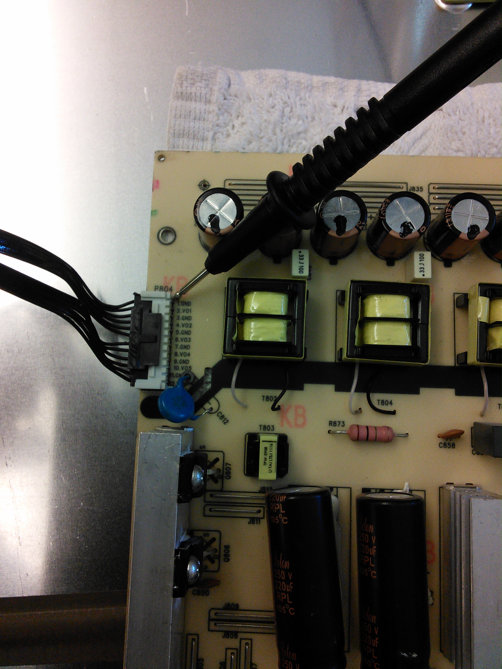

          Ok so here goes the testing results from budm's suggestion to test the DC voltages out from block P804 (pics of setup attached).
          Every cable for normal operation of the monitor is attached sans the USB hub from the controller board. The power is switched on and the monitor is powered on via the power button for each test. The monitor is being fed a live signal through the DVI port before the monitor is powered on.
          COM lead is stuck to 1.GRD for each test and live test lead is moved through the even numbered pins to check voltage output on each.
          I both leads before I power on the monitor and the results are the same for pin 2, 4, 6, 8, 10: voltage reading is falling during the power-on sequence, but once the monitor flashes on them immediately off (see original post) the voltage on 2,4,6,8,10 jumps to 30V then drops off quickly at first then slower over time (y=1/x).
          Pin 12 is the same situation only it jumps to 60V before dropping off.
          Hope this helps, what does this mean?

                Hi, from your first post i don't have really understood the led sequence, maybe i am so bad in english, but this i think is not so important.. i've never seen a power board like this, is it a 27 or 40 inch? In your school are all so big? ...
                Watching P804, VO1 is connected to Anode of D814 that is the negative output of a bridge rectifier and the + output of it seems connected to heart ground trough a low value resistor R861 (maybe less than 1ohm, i cannot understand the color code) so VO1 must be negative? Someone tell me if i'm wrong; and VO2 to which point is connected?

                    You have tested properly, i espected negative outputs but i dont understand well this circuit, there are many points unclear.. if there was a schematic maybe is better.. but i can't find it.

                                ok the results are as follows from testing what Davi.p suggested:
                                Testing Rectifier Diodes on back of power board.
                                Tested the 12 sequentially numbered in order from D814 to D830 and they all tested between 5.12k ohms and 5.34k ohms.
                                Testing P803, pins 1 and 11 with adjacent ground pins. Test conducted in the same manner (everything hooked up with life video feed coming to monitor, power switched on then button powered on, monitor flashes on/off about 2 seconds afterwards then screen remains dark)
                                Pin 1 showed 2.19V after switching on but the voltage drops to 1.42V after the power button is pressed and just before the flash occurs, this voltage remains steady afterwards for several seconds until i quit testing.
                                Pin 11 showed a steady 5.17V after the power switch is thrown, voltage remains constant through power button and flash on/off sequence.
