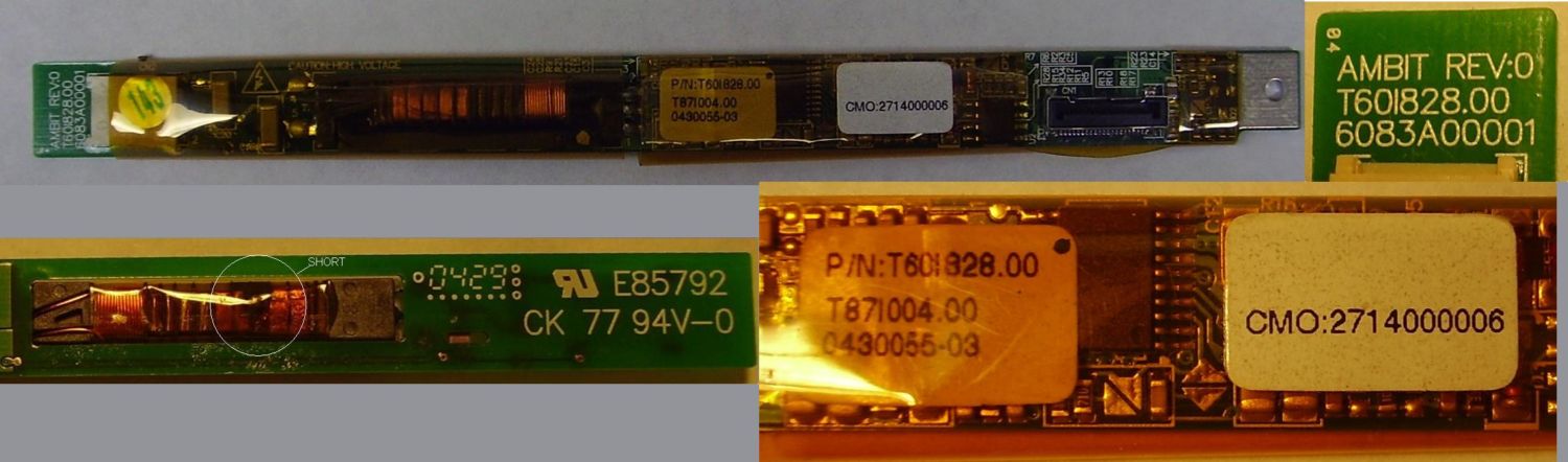

          I got a replacement ccfl for my Inspiron 1150 laptop from an eBay dealer. The color is not quite right. As Willawake said, the color is important, but I don't know what the color ranking method is. I don't recall seeing it listed at the ccfl sites I visited.
          Replacing the ccfl is the cheapest, so do that first. Save the old ccfl, if it doesn't fix the problem you may want to put it back in.

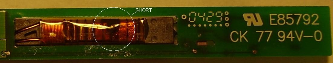

          My laptop inverter has a short in the transformer. Here's some pics, sorry for the poor quality as I used a camera from work. (That's why I posted about what's a good digital camera.)
