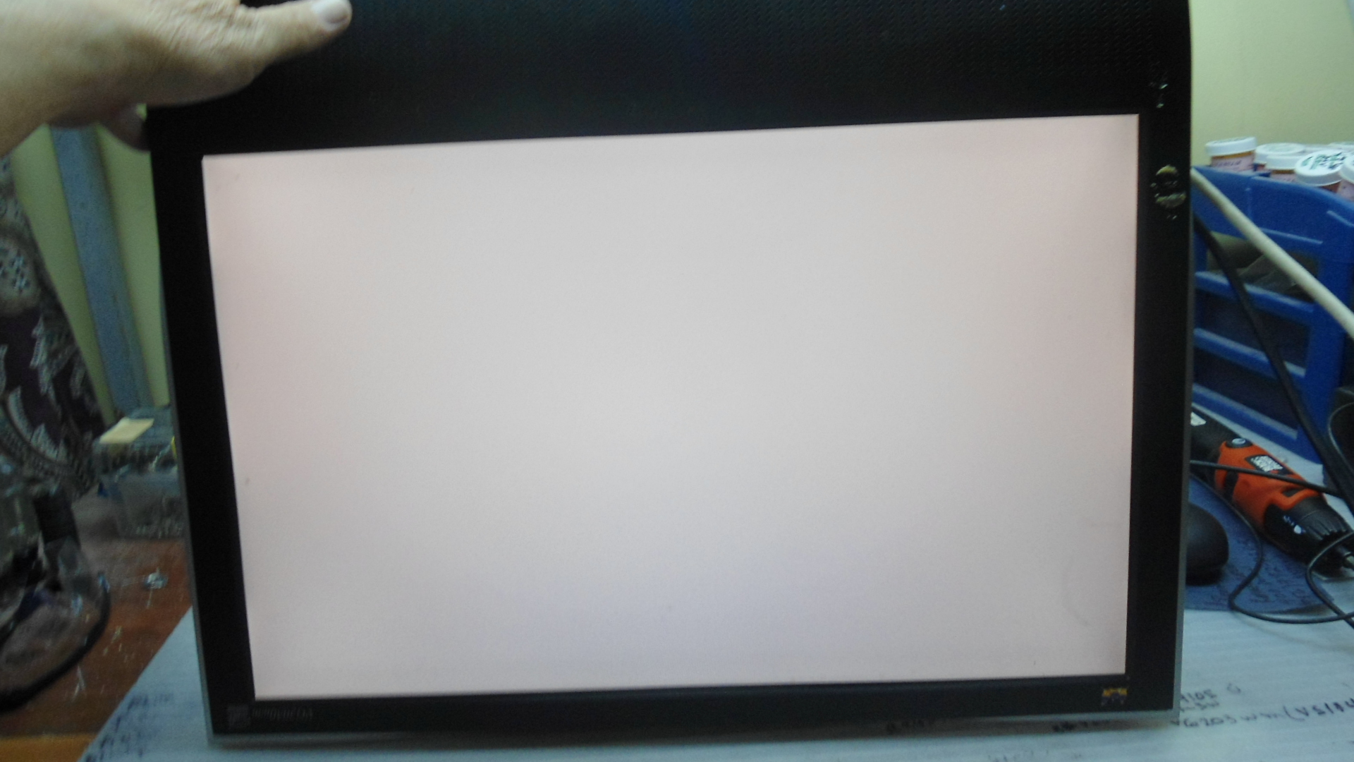

    while checking this viewsonic 2030 monitor,i noticed something that probably most of you experienced guys know.
    when i turned the monitor on ,i forgot to connect the ribbon cable that goes from the logic card to the screen assy,and i got a beautiful ,bright ,well defined backlight,even on a well lighted area.
    this makes me think that if you have a good power board and good lamps ,this "test" will show that.
    i had a known good signal from the cpu ,and when i disconnected the cpu ,the backlight went away which i think its normal.
    this is something i learned and wanted to share with everybody .
    its a monitor that only goes to 1024x768 resolution,any higher than that it turns off ,with a blue on light.
    thank you

    Yes, like this one: no b+ to the T-CON will give the same symptom.
    http://s807.photobucket.com/user/bud...ml?sort=3&o=25
    The LCD panel with high contrast will barely glow.
    It is also shown in my Basic LCD monitor troubleshooting:
    https://www.badcaps.net/forum/showthread.php?t=25810
    You are learning well, so keep reading and working at it and you will get better and better when you see the symptoms in the future.
