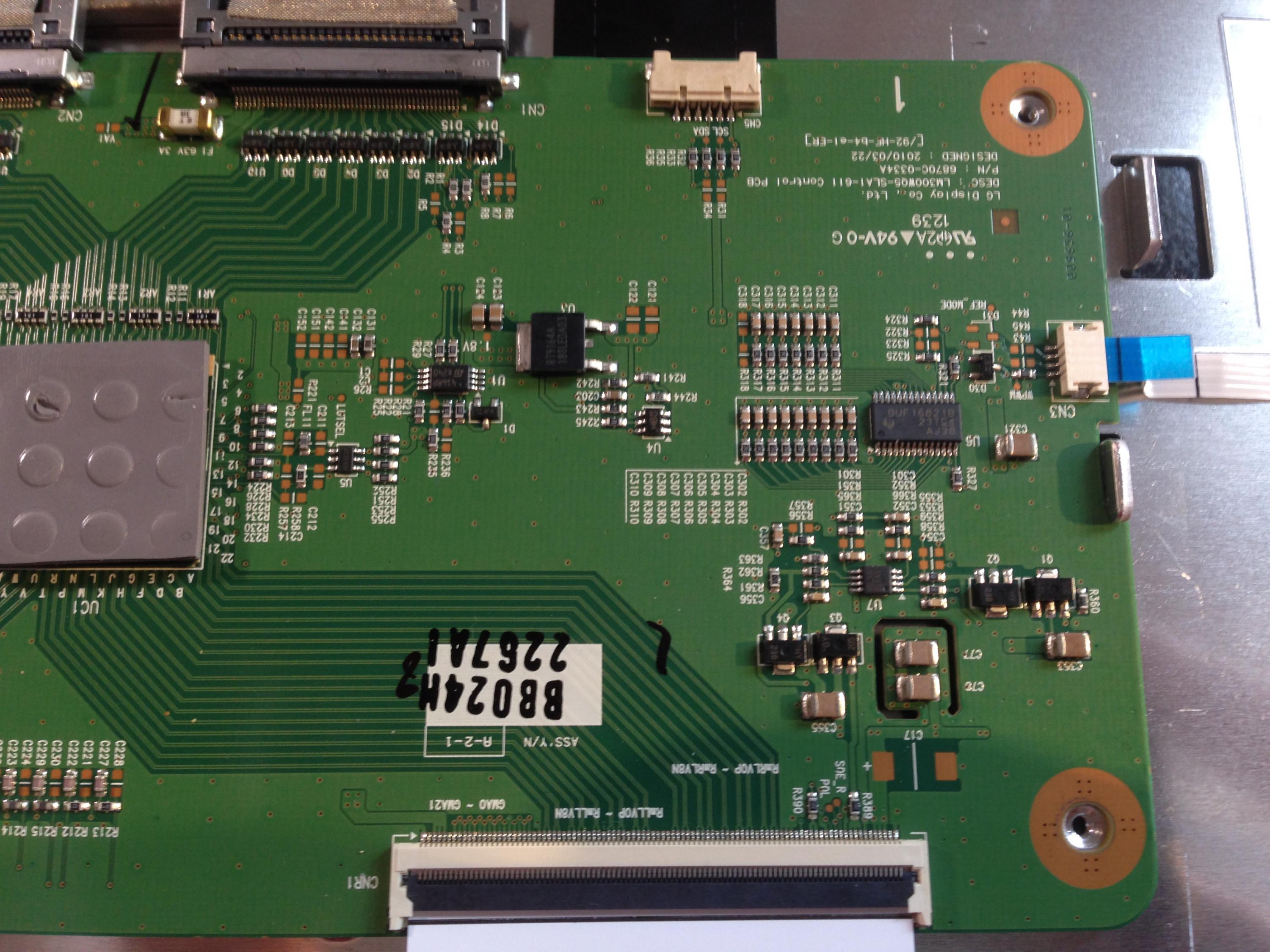

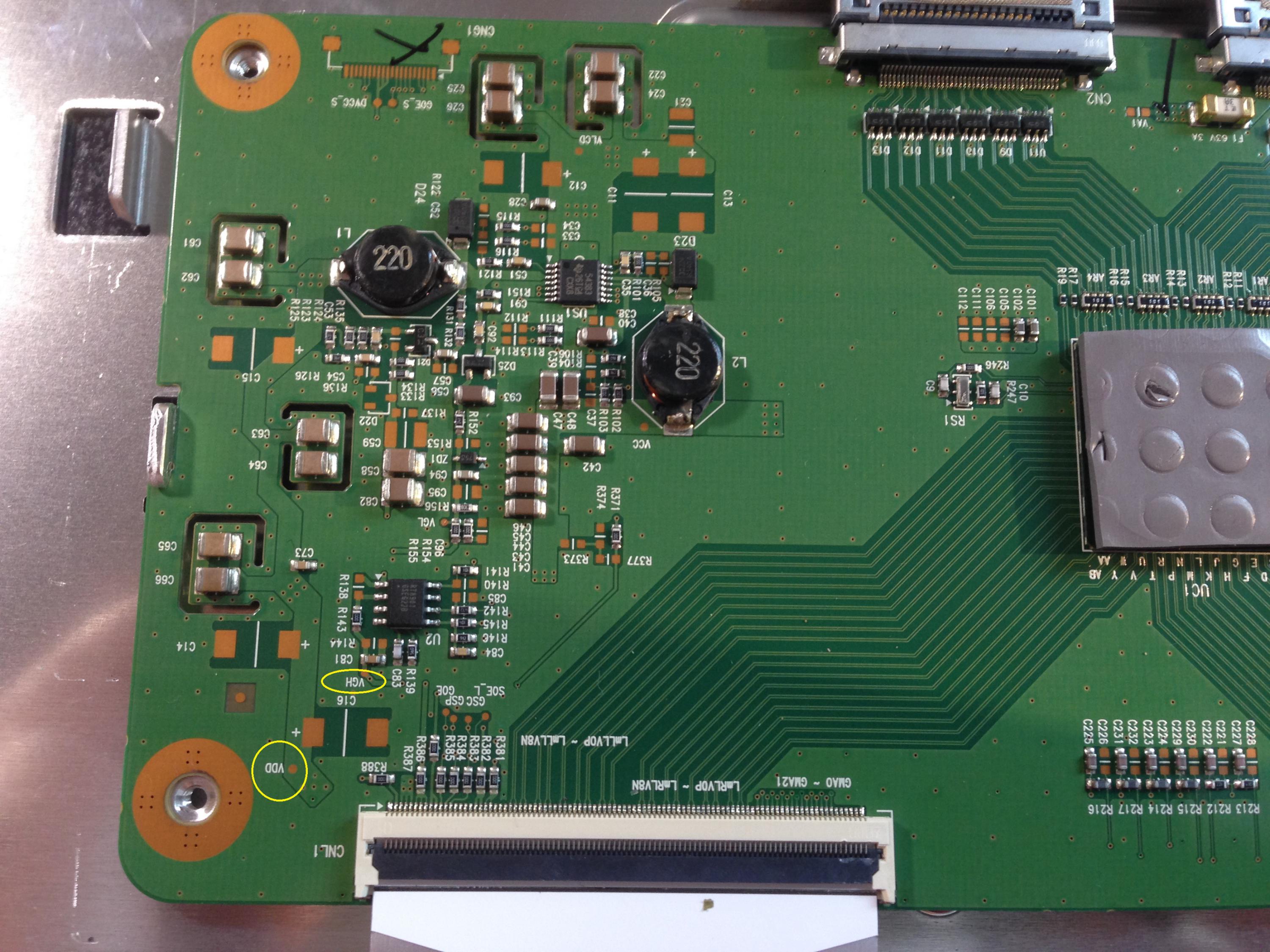

    Here are pictures of the T-CON. I think you can read all the labels. I've circled in yellow (first pic, lower left) where I measured VGH and VGL.
    Thanks again for all the help!

      I may be missing something here (often do) but I see you have marked VGH but VGL
      seems to be elsewhere (from VGH up and across U2)
        Right you are... A mistake of photo editing, not of measurement . I re-marked with the correct VGL. That is where I measured. If you zoom in, you can see the little mark made by my scope probe when I traced it. New pic attached.

          The point to test are VLCD, VDD, VCC, 1,8V, i don't have the right value but you can search the web for for example: "LM300WQ5 (VLCD OR VDD OR VCC OR 1,8V)" you can find other user that have posted their values and so compare..

            Thanks for the idea. VLCD was the only parameter I was able to find a spec for and it's in range. Here are the results:
            VLCD: Measured 17.83V, Spec 18.0 +/-1 (In Range)
            VDD: Measured 15.44 VDC
            VCC: Measured 3.32 VDC (this seems right)
            VGH: Measured 23.89
            VGL: Measured -7.45 (last time was -10.5)
