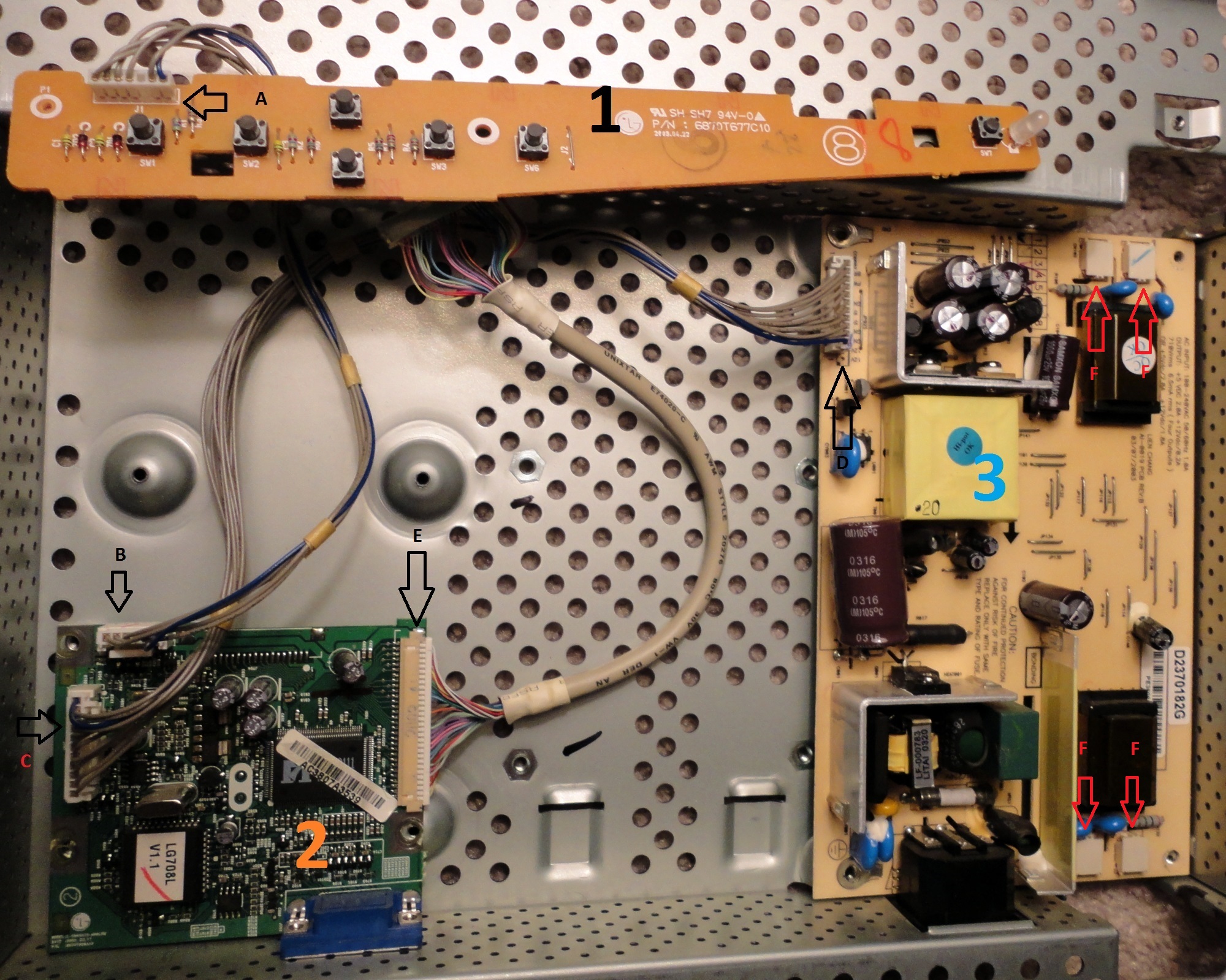

    I have actually been able to fix some monitors and TV's with the generous help of people on this forum. I have a problem with another monitor, but I am more interested in increasing my tiny base of understanding. Referring to the picture, is this how the process works to turn on the monitor?
    On/off switch on board 1 sends an 'on' signal thru connection A
    Logic (or main) board 2 receives the 'on' signal thru connection B
    Logic (or main) board 2 sends the 'on' signal to power board 3 thru connection C
    Power board 3 receives the 'on' signal thru connection D
    Power board then sends power thru connection D back to logic (or main) board 2
    Power board turns on power to backlights thru connections F
    Logic (or main) board then sends processed signal thru connection E to the LCD panel
    Is this somewhat correct? Feel free to laugh or to correct my meager understanding!
    Re: Gateway FPB1730--please help with an overview
    The power supply board is always running (putting out voltages the minute you apply the AC power to the board), the inverter board and the T-CON board are in off mode, the main board is always running. When you hit the power button, the main board micro controller sends out the BL_ON and the Dimming signals to turn on the inverter. The main micro controller also send the on signal to turn on the MOSFET on the main board to supply the B+ to the T-CON board, If there is not video signal from the PC, the micro controller will put the unit into standby mode after 3~5 seconds and will get out of standby mode when video signal is detected.

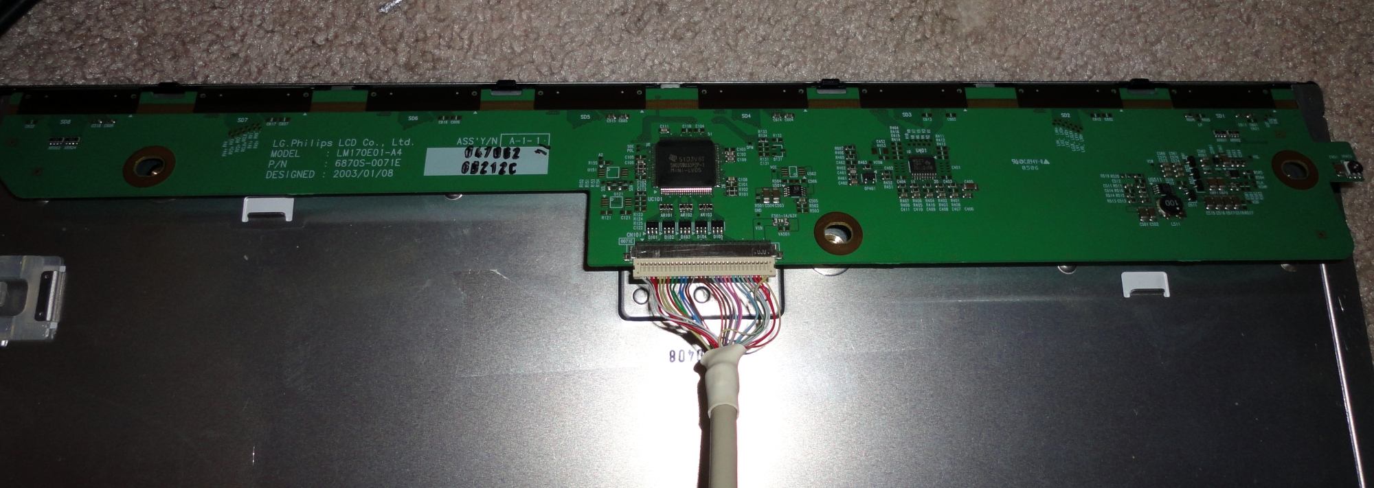

      Whew, Bud....that was a mouth full! I am adding a picture of the last connection which I am identifying (correctly or incorrectly) as the Tcon board. That is where the cable from connection E goes. In this situation, is the inverter board combined with the power board (#3)?
        That the integrated T-CON with the LCD Glass panel assembly.
        You have power supply/inverter combo board.
        https://www.badcaps.net/forum/showth...956#post305956
