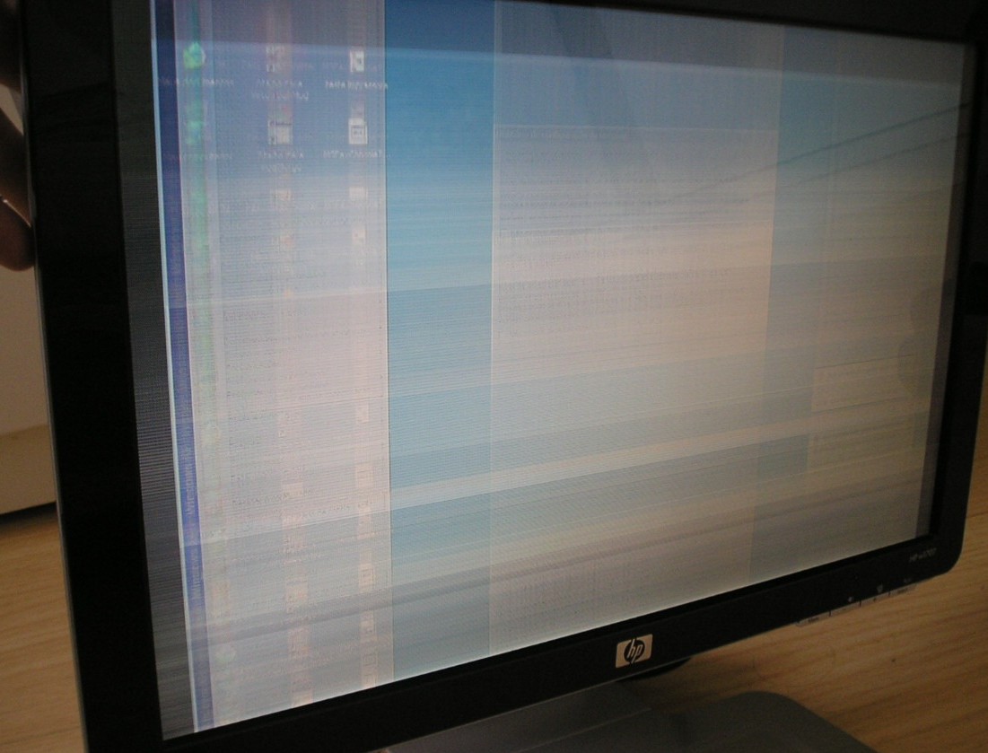

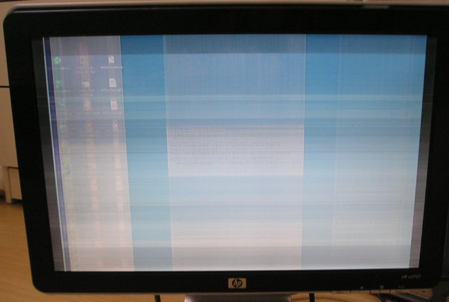

    I got this old LCD monitor HP model W1707 , with the following problem on the screen as you can see it on the uploaded pics . The problem is only with the screen image . There is no other problem , like shutdown or otherelse .

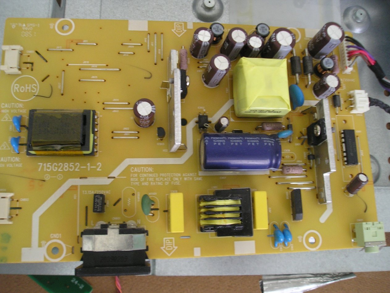

    1 - Checked the capacitors and aparently there's no problem with the capacitors on the power board and the logical display board .

    As you have cleaned the flat ribbon cable it looks like a panel fault.
    Check the output and cable from the pc .

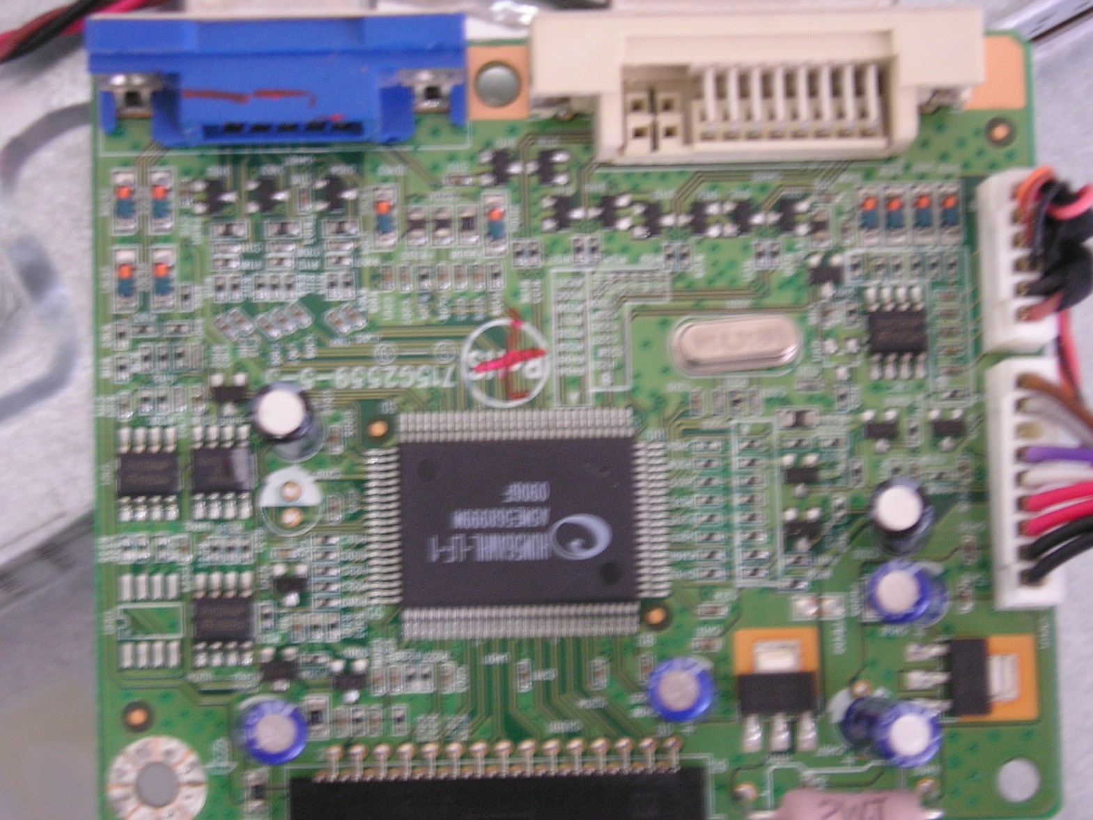

    post pictures of the main /logic board and the panel board on the screen if you can get to it.
      Re: HP W1707 with screen problem

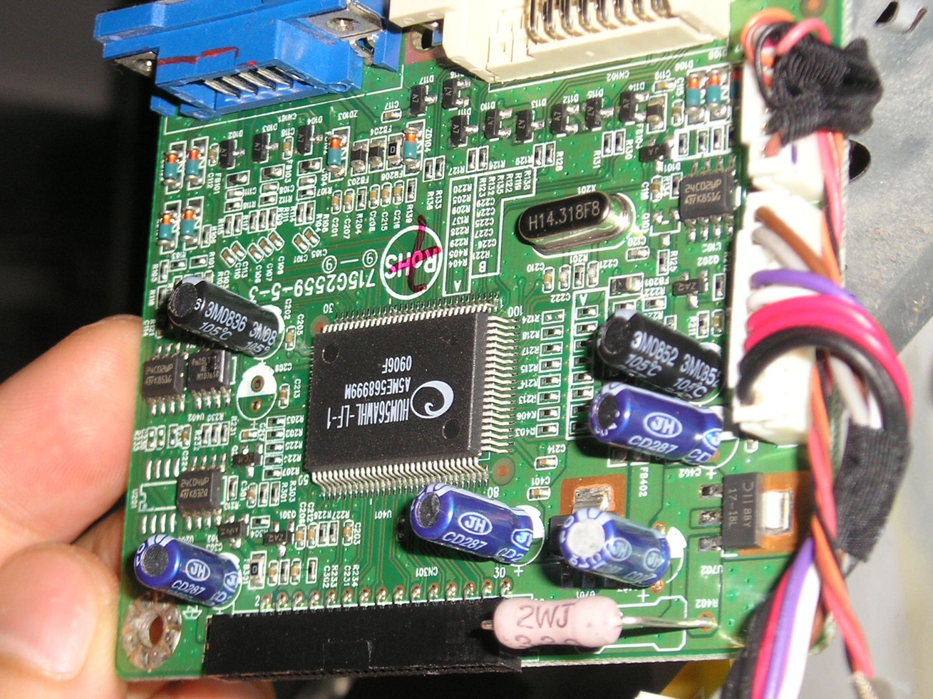

      I could only taked pics of the logical display board and the power board .
      I've tested this monitor in another PC and the problem was the same and tested with another vga cable .
        JH caps have a po0r reputation on here so yes you should change them.
        Best quality you can get.
        Next thing to test would be the voltages on the voltage regulators. I can see
        2 , well one on the right hand side with the backward c11 8By? and the other is behind one of the caps - I can just see its 3 "feet"

          I took another pic , but quality not good , but I think it will do for some .
          Thanks for the assistance . Im still need to wait the capacitors came to my house .
          I'll give news soon as possible .
          thanks !

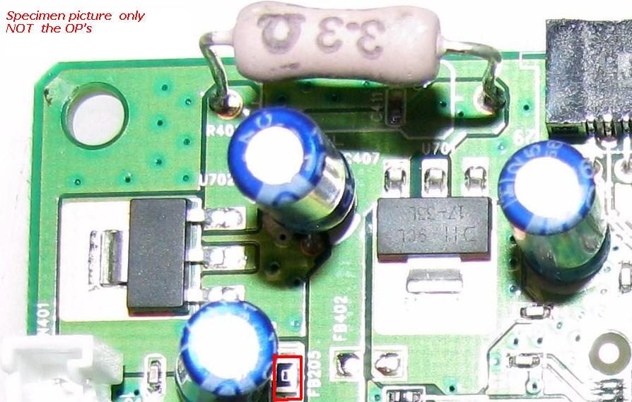

            Hi you are correct it is a poor picture.
            Here is a better one - perhaps while waiting for the caps you can test
            the voltage regulators (if you have not already removed the caps )
            Meter on vDC20 black probe on ground probe each pin with the red probe
            and post the results.
            Also No power to the board - meter on ohms 200 can you test the 0 rated
            resistor marked in red.
