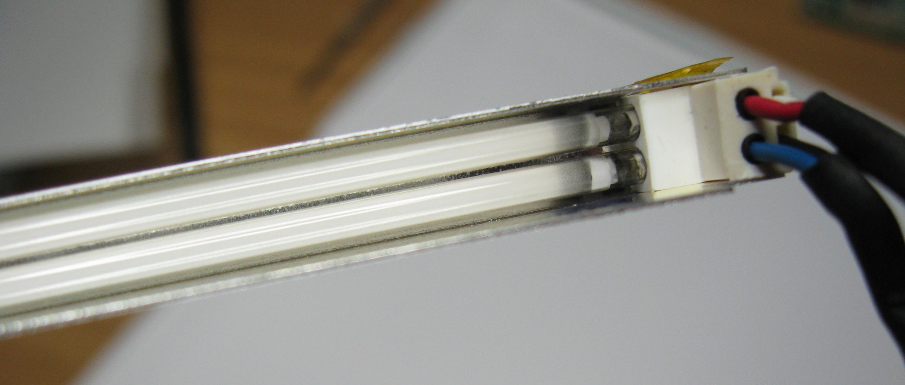

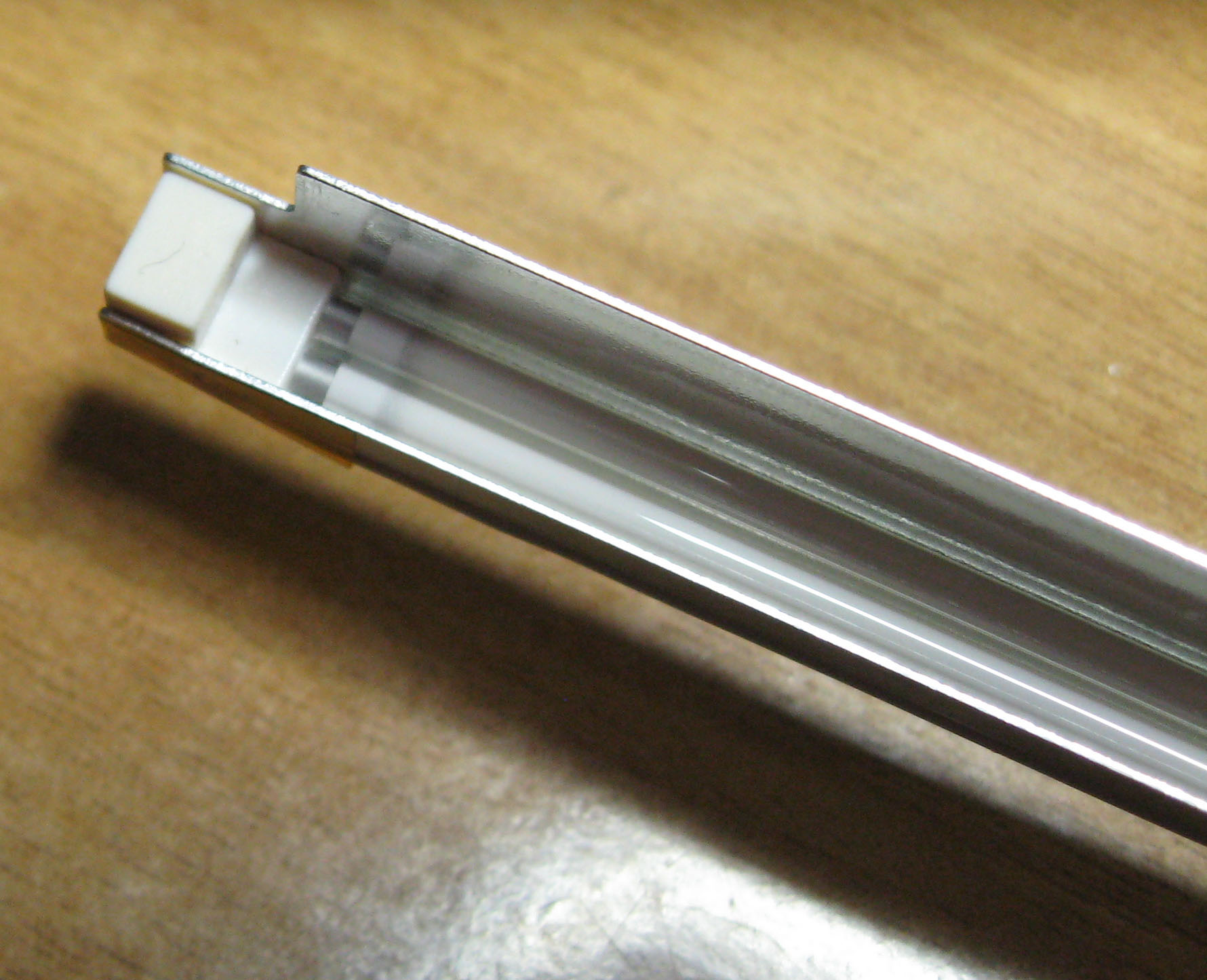

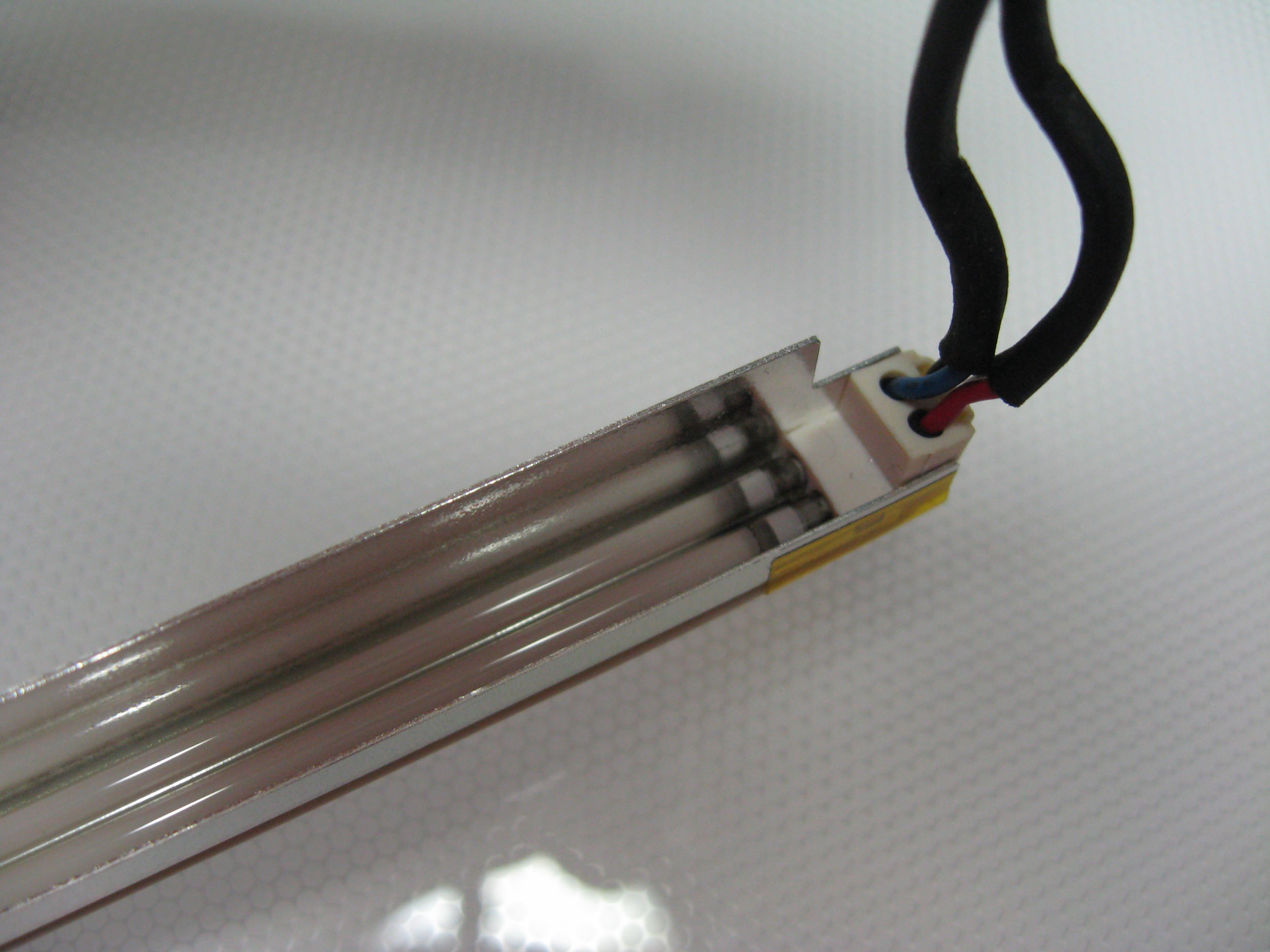

    I have these two HP L1908w monitor which went out after about two years of operation with same symptoms.
    When the monitor is "cold" and has been off for some time, it will work for 5-10 minutes. After that it does 2 seconds to black....
    I have seen a couple of threads in this forum with the same problem however i haven't come to a conclusion. I read about problematic connections to ccfls however the connections look good except that ccfls are a bit black at that side.

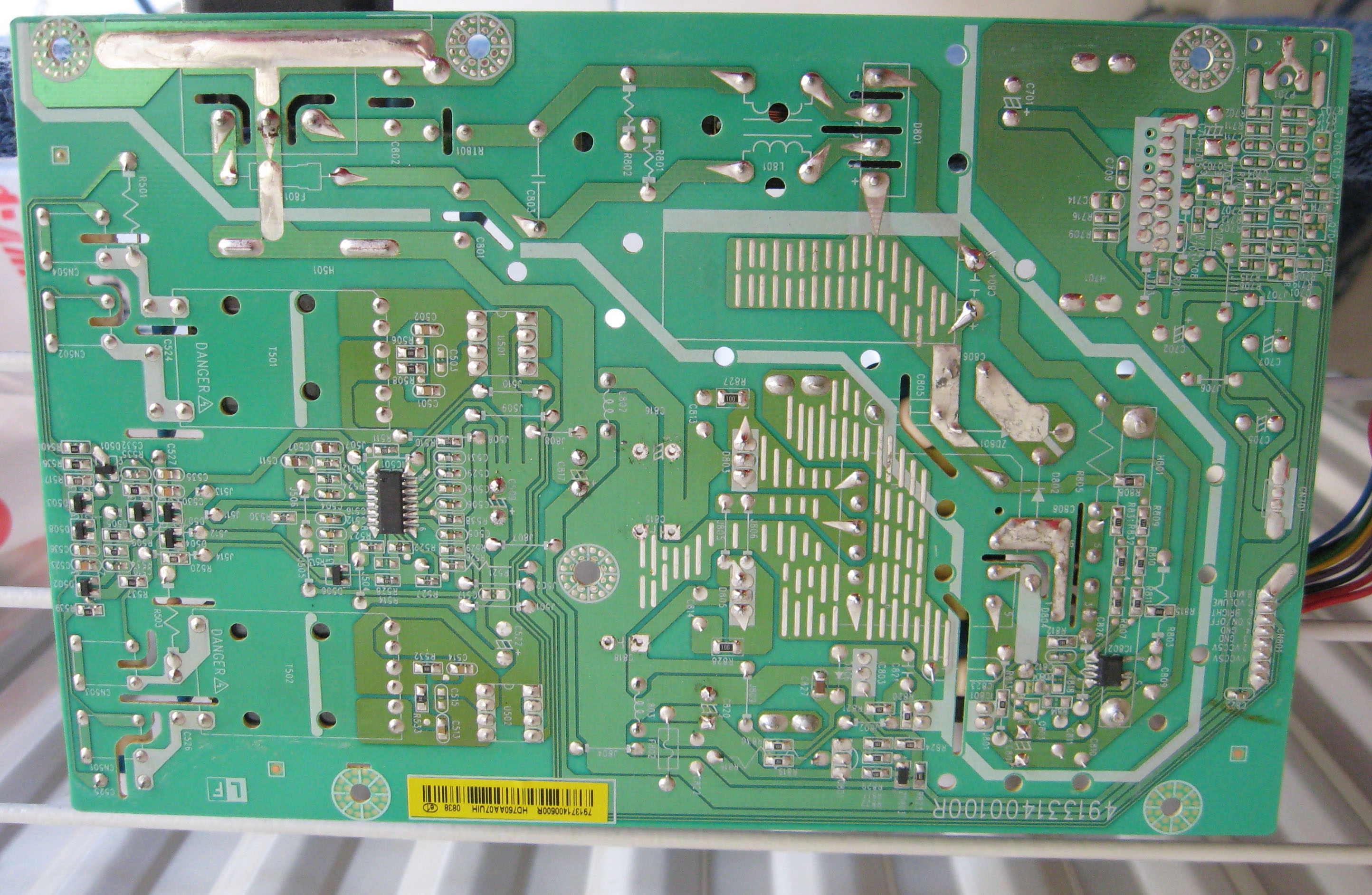

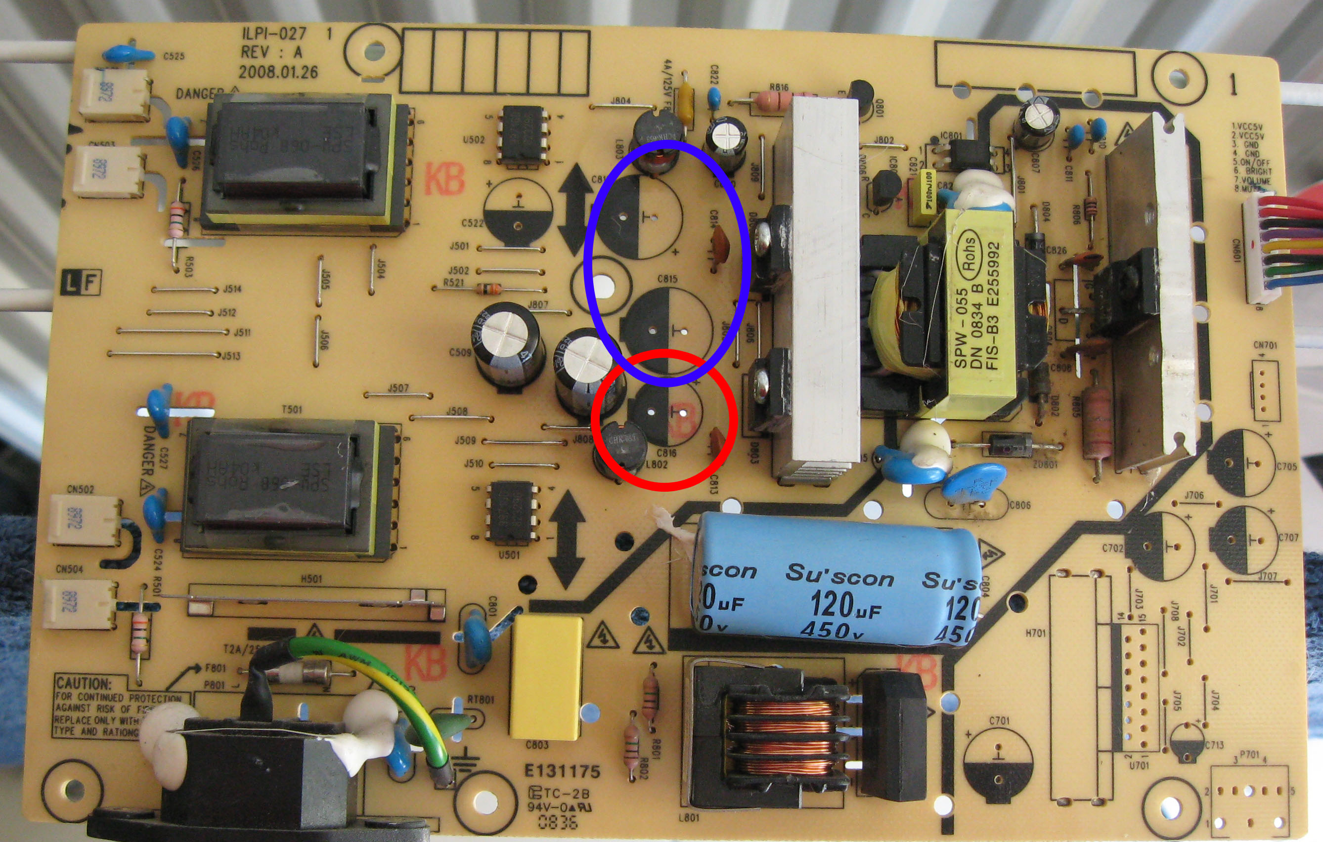

    On the other hand i have found two capacitors on the power board (they are 1000uf 25v SAMXON CH, blue circle) that measure 900uf and 890uf with good ESR. Do you think they can cause the problem?

      Try and get a good pair of bulbs and check the board for bad joints.
      Often decay on transformers and on the high voltage blue caps.
      The centre joint on the mains connector doesnt look great.
      Samxon caps are not good but if bulbs are shot nothing will help.
      Can you hear any arcing from them?

        Is there any way to find out the condition of the ccfls? i don't have any other bulbs or power supplies as this is my very first attempt to repair a monitor. Reading through this thread https://www.badcaps.net/forum/showthread.php?p=231718
        post 9, regarding same model monitors, i found that they say the top pair usually breaks. To me both pairs look the same with the same black spot on one side (see pictures).

        The board does seem to have a lot of joints with oxidation starting on them. I don't know if that is the problem but i will revive some spots a bit. Is it possible that both monitors have the same problem? Also do you think the reduced capacitance of the 1000uf might cause the problem?
        I don't understand what is "arcing" but i can definitely say that there is no sound coming from the monitors....

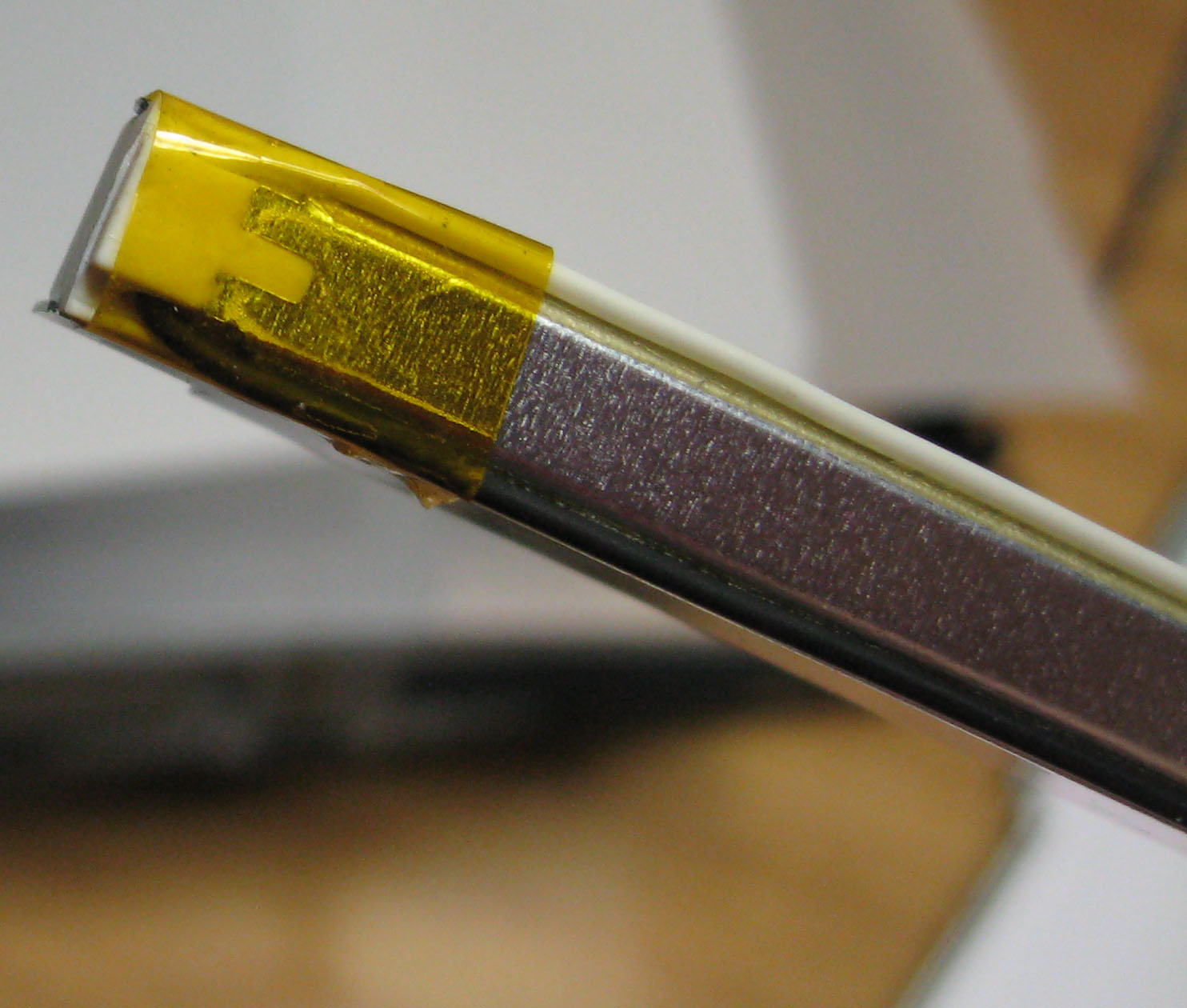

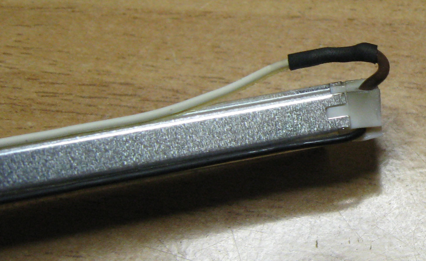

          You need to gently tug on the wire to see if it will come off (need to remove that KAPTON (yellow tape))
          Test lamp: Make two of them.
          https://www.badcaps.net/forum/showthread.php?t=19987
            Re: HP L1908w monitor - 2 second to black problem
            Thanks for the link! .. Can the supply board of the 14w cfl be used to light also the monitor's ccfls?
            I did remove the tape and checked the cables however they don't seem damaged at all and won't come off even with some force.

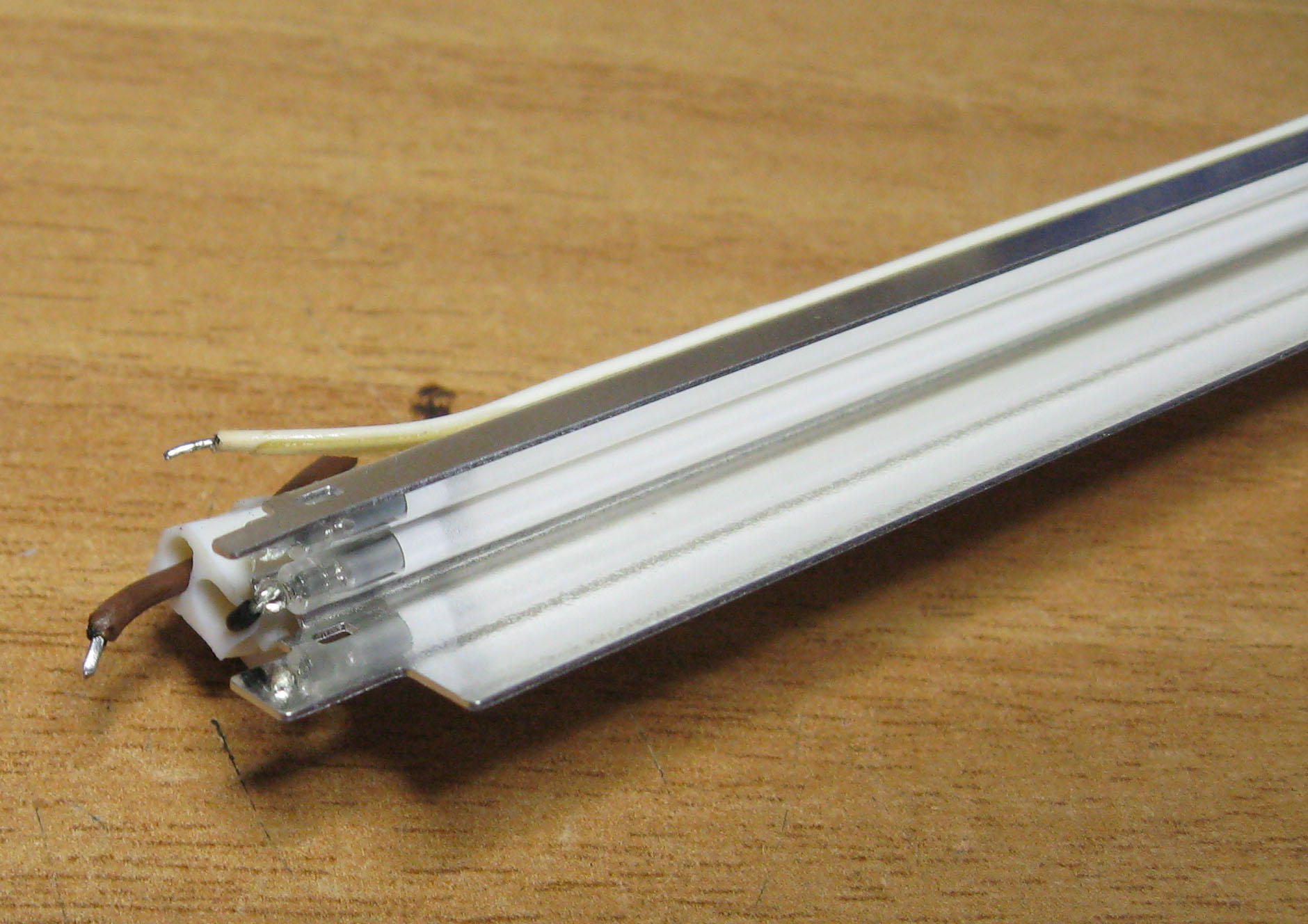

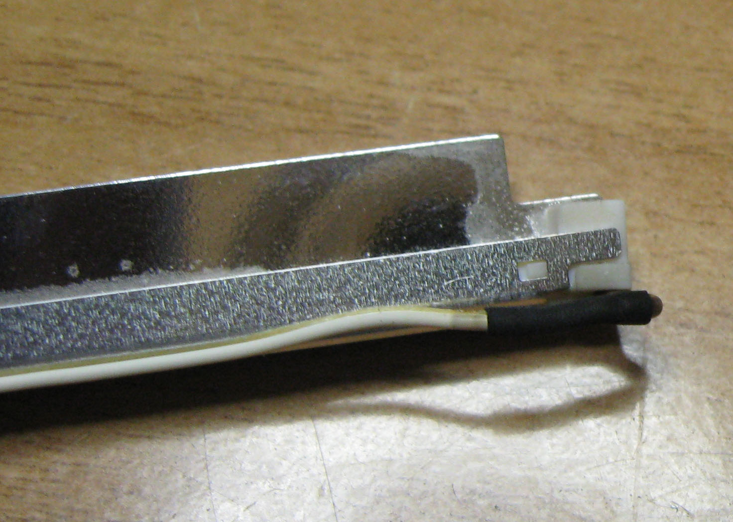

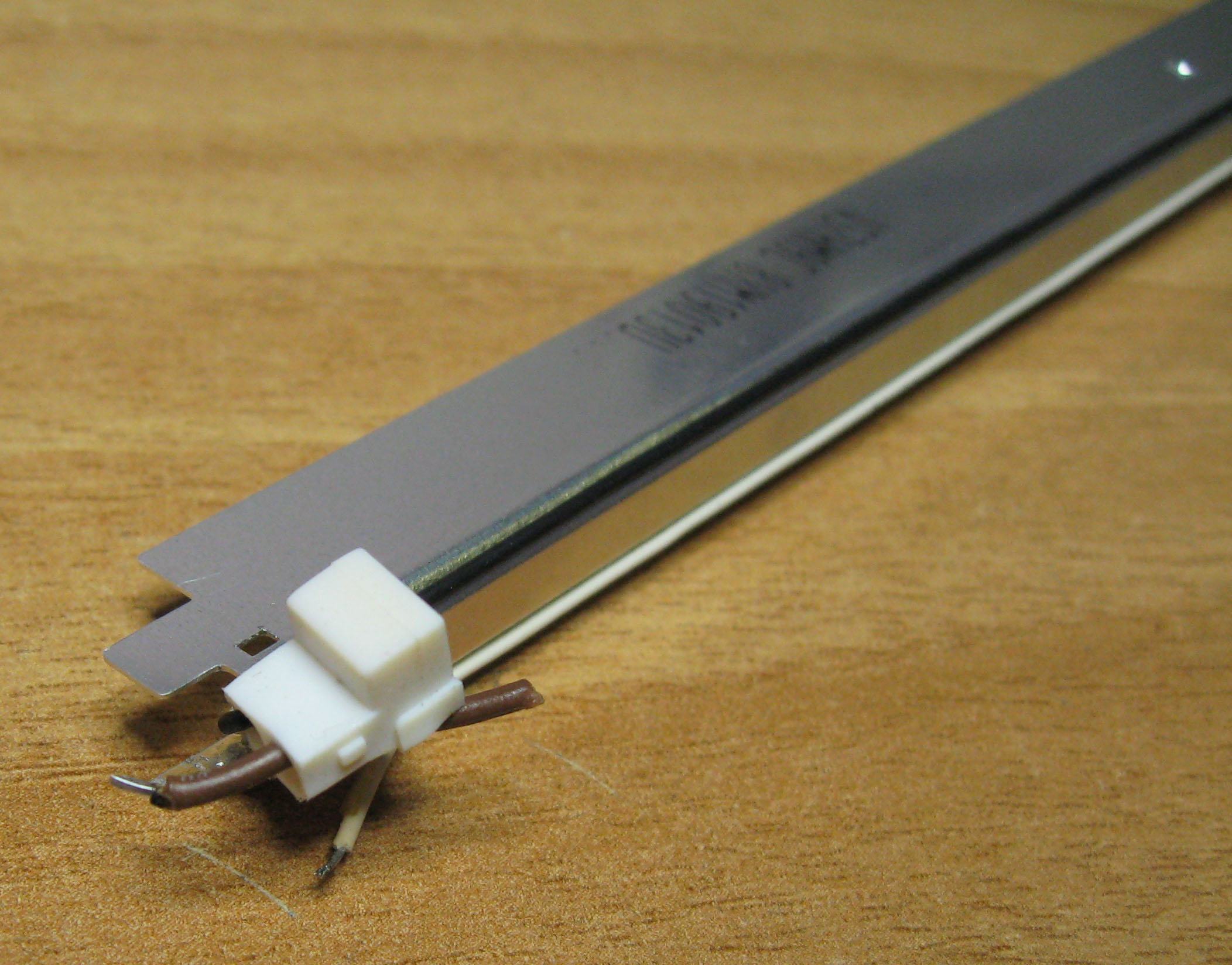

                      Ok, after some more inspection, i noticed that the small black cable did come off after applying a bit more pressure. So i cut the second one as well, and connected two small 10mm long wires in order to keep the silicon terminal. Soldered those with the originals and covered with heat shrink.
                      The monitor has been working for 2 hours now without any problems!

                        Good, just typical failure.

                          The second monitor had exactly the same thing. Top lamp, thin wire connection was loose!
                          It has been running for 3 hours now...
                          I tried to be as less invasive as possible. This time i did not rip off the second cable which had a good connection.
