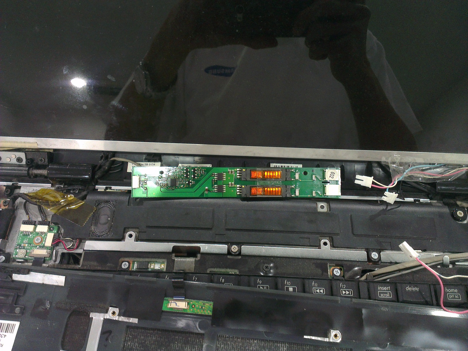

    I have this problem here, it's actually a laptop, HP DV9.
    The screen has 2 ccfl backlight, and one of the tube is causing shortage.
    This unit is using a dual output inverter, hence if I disconnect either 1 of the tube, it will auto shutoff. And the owner doesn't has the budget to replace the panel, and I don't want to take risk replacing the tube.
    I had identified the faulty tube. Inverter confirmed working fine, tested powering with a spare tube pulled from another LCD.
    If anyone here can guide me how can I modify the inverter so it won't shutdown even if I just connect 1 tube?

    You have to solder 1 resistor at the output with no lamp, tell us the model of the screen or its size.. i can't find hp dv9..
    i refer to an LG 15,4" lcd datasheet:
    Operating Voltage Unit
    min typ max
    VBL 670 690 810 VRMS
    (6.5mA) (6.0mA) (3.5mA)
    Operating Current
    IBL 6.5 6.0 3.5 mARMS
    Established Starting Voltage
    at 25℃ Vs 1200 VRMS
    at 0 ℃ 1560 VRMS
    so you need i think a 1200/0,006=200kohm to 240kohm res. about 7W

      Re: How to bypass 1 of the ccfl inverter output?
      Thanks, it's a AUO B170PW04 v.0
      You mean if base on your calculation, I need to solder a 240kohm at the output of the inverter.
        For your model is 1700/0,0065=260k
            Do not forget about the dielectric voltage break down of the resistor, typical break down voltage is around 500V, to get 260K (that can handle 1200V) at 10W (instead of 7W for head room) will be hard to find, you should use at least 4 resistors (3W each) in series to handle the high voltage, and to dissipate the power will be difficult since you do not have much room on the panel assembly.
              Damn.. i forgot the huge heat.. mumble.. can you tell me the part no. of the IC on inverter, so i can see the voltage level for the feedback, maybe we can find somewhere the right point to connect to FB pin..
