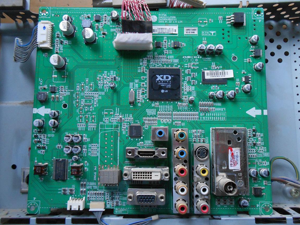

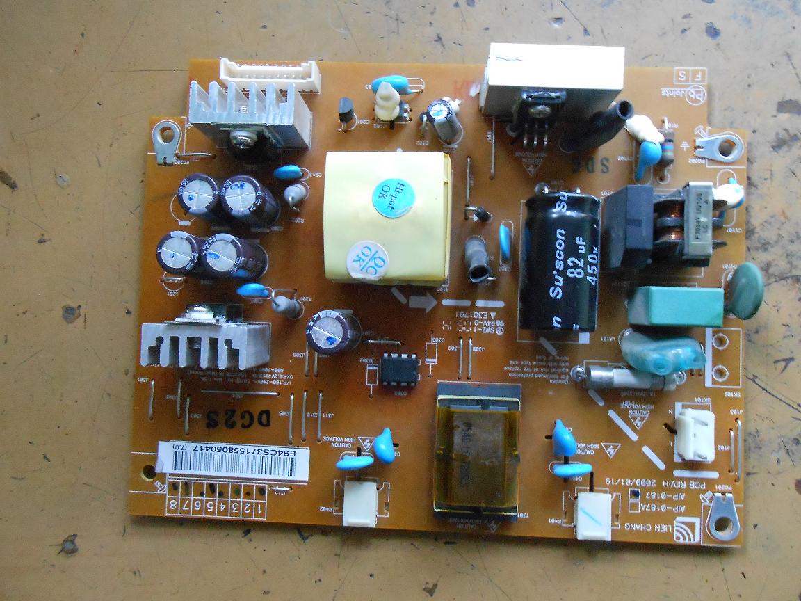

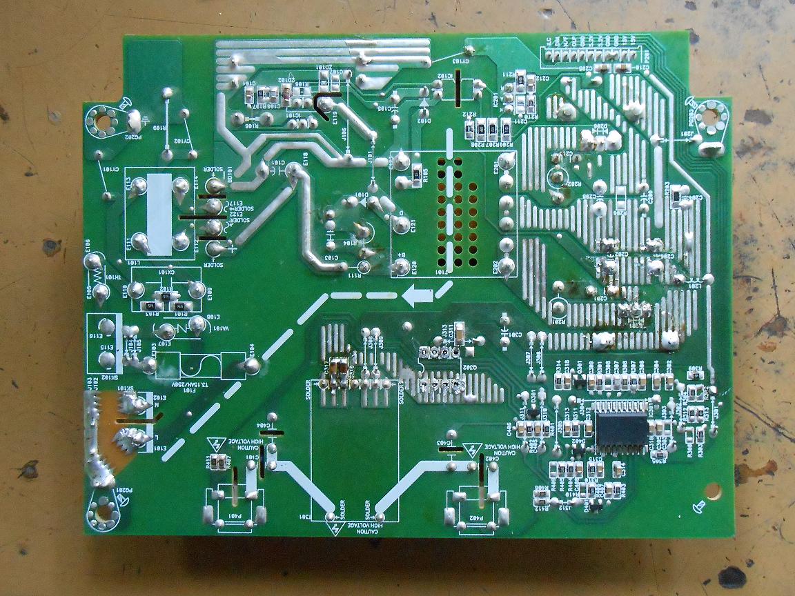

    LG FLATRON M197WA dead Q302 short & R302 missing.i need schematic. suggest replace Q302 for another number or seprate mosfet n channel & p channel mosfet no. i upload Q302 data .
    Thanks.

    Pictures are not big enough for troubleshooting - need to be as near to 2mb as you can get
    the pdf will not open.
    Are you sure R302 was ever on the board not that I can see where it is/was and as you have not stated what the mosfet part number was cant help with that either.

      Re: Lg flatron m197wa
      Hello Friend
      Q302 P2503NPG mosfet number. i alredy upload data sheet.
      R302 on 1st board near ic 301
        Pictures are too small cant see IC 301
        Data sheet will not download
        free ship to India
        http://www.ebay.com/itm/3PCS-IC-P250...0f6ac#shpCntId
        datasheet
        check out AOP605 or AOP610

          Hi, what do you need from us? Apart the schematic.. We can't see the tracks around R302 so we can't rebuilt its function, do you need also a good replacement type for Q302?
