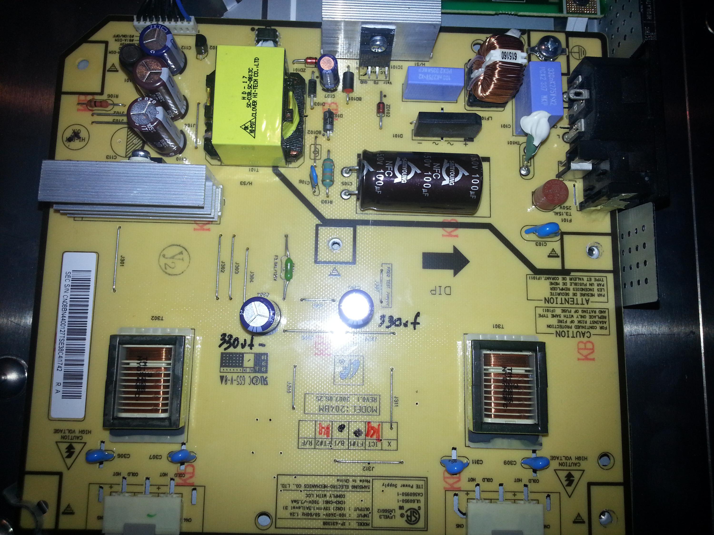

    I bought appropriate capacitors from Digi-Key. For PSU (on 1st unit) I had to replace 3x330uf, 2x820uF & 1x47uF. Hopefully the other 3 monitors are the same as I bought them all at once.
    After replacing caps monitor #1 still doesn't work. Some debugging: 13v present to main board, C105 has around 130V on it when on (with switch). Sometimes when I turn the unit on, the blue light will be on power briefly, but typically not (still a charged cap problem)?
    Could the problem be the main board? I could test this theory by swapping main board from a working monitor. Could I harm the main board? Is it better to see if I actually fixed the power supply by swapping that into a unit where the main board is working?
    Any other test points I should check?

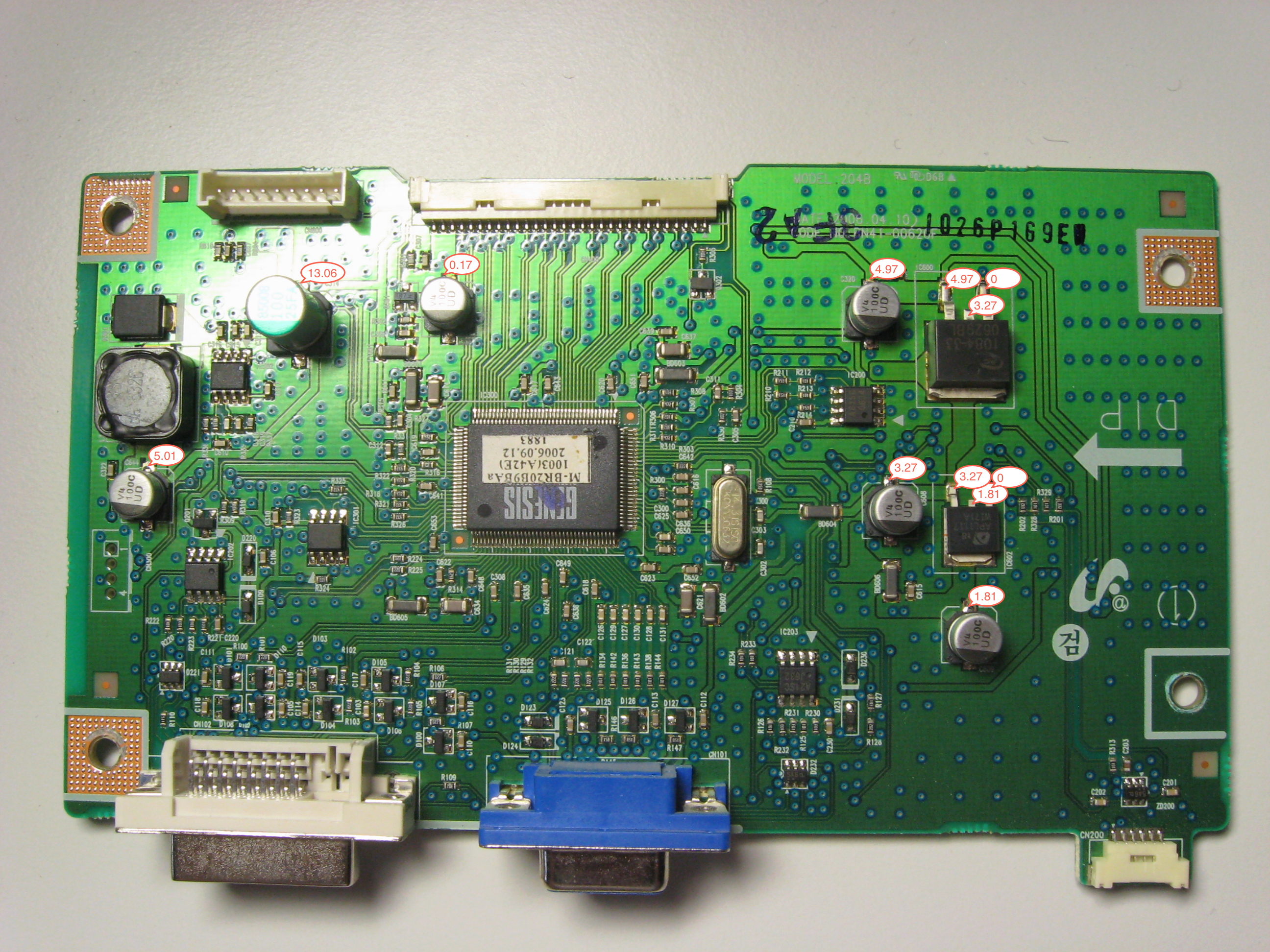

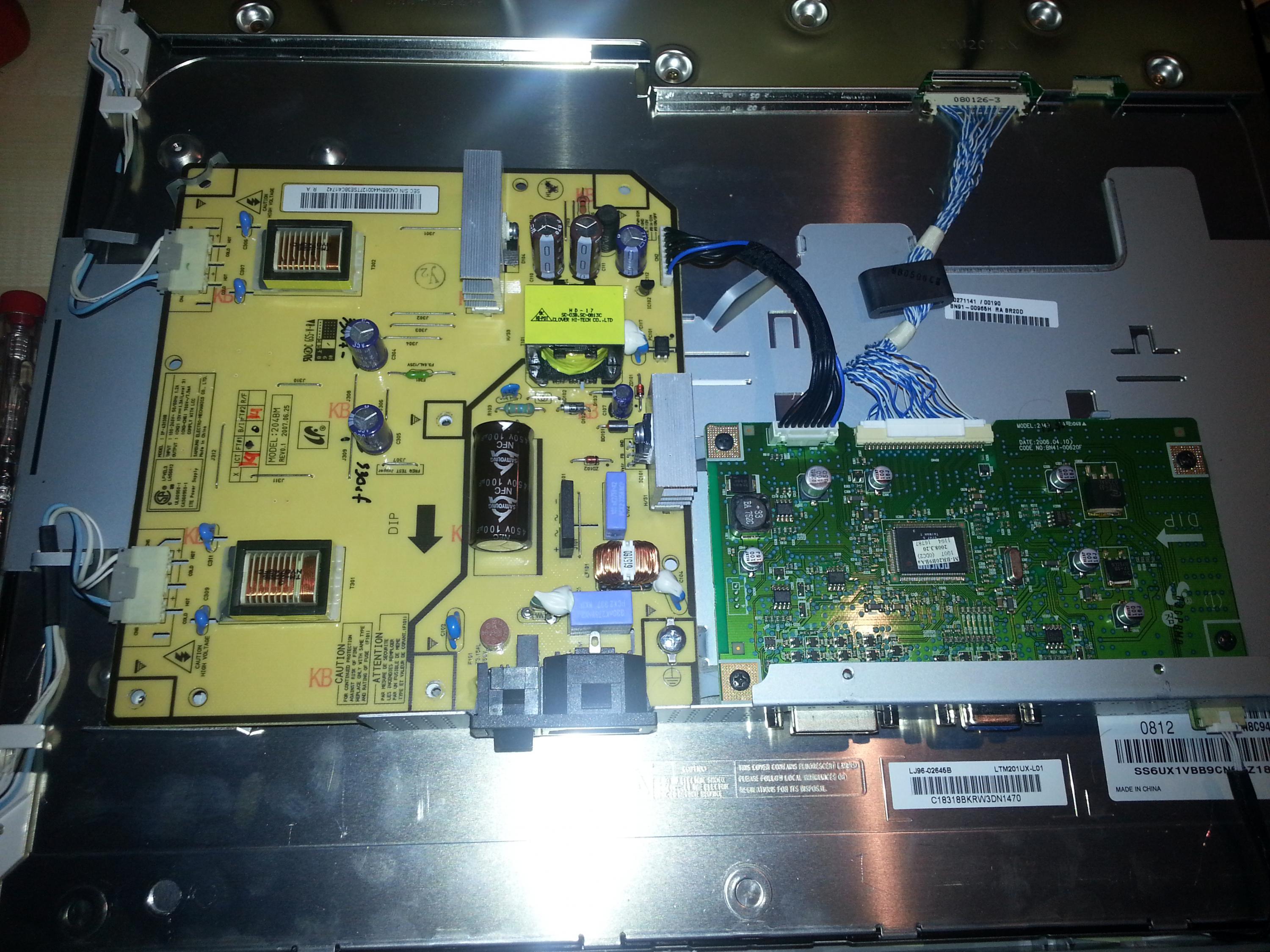

      I've attached 2 pics of the PS board and the main logic board. After a bit more debugging, still no luck. However, I did find and buy a replacement PS for only 23usd on eBay. Once it arrives that may be helpful. I still haven't disassembled my other 2 semi-working monitors because I'm using them.
        Re: Samsung SyncMaster 204b
        So I swapped in the new power supply, and there was NO improvement.
        Therefore the problem must be with the Logic/Driver. I ordered a new one from here:

          Apparently I'm stuck with the same problem as whotopia. I've got two 204B monitors. The first (A) failed years ago, but is working fine since replacement of the caps. Now the second (B) showed the known symptoms. I replaced the caps but the monitor won't power up.
          By exchanging power boards and logic boards between the two monitors, I've confirmed both power boards to work fine, but the logic board from B causes the following behaviour: When the mains switch is turned on, the power button LED on the front panel lights up once. Same behaviour with all other parts exchanged (power board, LCD panel, control panel).
          I'm more a software guy, so I'm at a loss as to what I should test next. Any hints will be much appreciated!

            Barthez as from the picture test the voltage on the electrolytic more to the left and the big pin on the 3 legs chip "1084-33"..
              Davi.p, thanks for your reply! I've measured as per your post and a few other points: http://s1.directupload.net/file/d/3464/pcgvs586_jpg.htm

                those vrs look ok
                It is useful for future help seekers if you upload the pictures to badcaps
                Failure of these boards is common and difficult to pinpoint.
                could be the genesis chip or any of the dozen small switching transistors.

                  The readings seems to be ok.. unfortunately ..
                  i only have a doubt on that cap marked with a 0,17v reading,
                  Barthez do you confirm the same as whotopia, therefore the mon. came dead gradually?
                  there's no much logic but can you test without power the transistor Q301 near the previous cap? After that try to put power and measure voltage on Q301 leg's down right, if is not it it's the down left, you must read i think 5v, i think it's a P mosfet.
                    selldoo, Davi.p, thanks! The monitor died a slow, flickering death. Since I knew the problem from its sibling, I wasn't too worried. Maybe I killed an IC with a static discharge while removing the power board?
                    The code on the transistor looks like "TR7 N". I found a datasheet for TR7, which seems to be matching what you wrote, Davi.p:
                    With the red probe on the top pin (drain?), I get 6,2 kΩ to bottom right (source?) and 51.6 kΩ to bottom left (gate?). With the black probe on the top pin, I get 17 kΩ to bottom right and 115 kΩ to bottom left. Powered on, I get 5 V on bottom right, 4.54 V on bottom left, and top 0.17 V.
