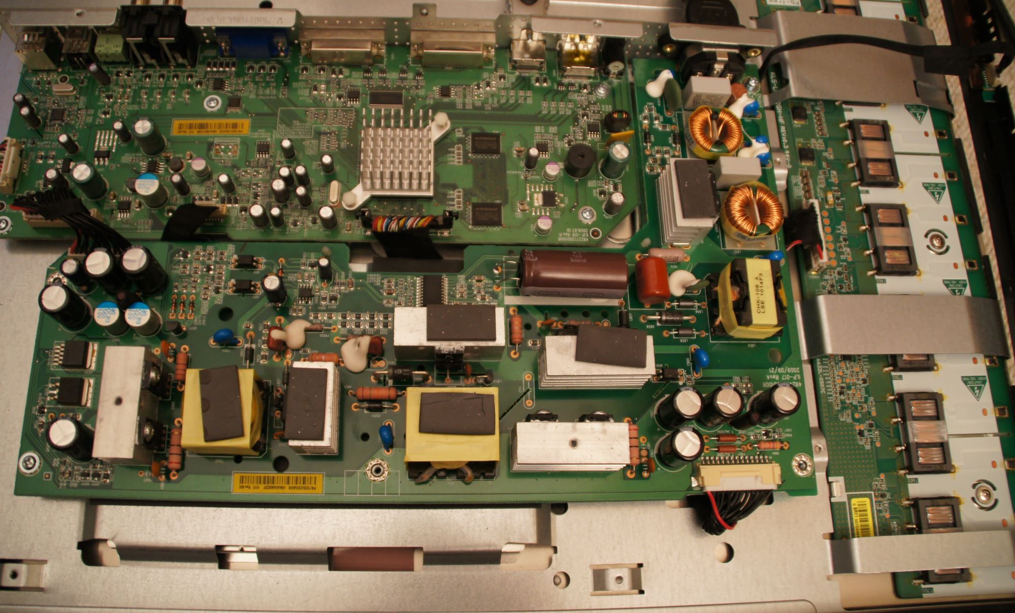

    My DELL U2410 is now more than 3 years old (no more warranty) and it started to make trouble. When I turn on the monitor, I can see the DELL Logo on the Display and it shortly shows a symbol in the top left corner indicating the used input. (I currently connect the HDMI, but it has the same issue on DVI). After that the monitor display is shut down immediately. When I try to open the OSD Menu, it does not show up. I decided to open the monitor and replace the capatiors on the power board, because I have read that this can often fix this kind of issue. Unfortunetely in my case it didn't fix the issue.
    Now my suspicion is, that the inverter board or the backlight itself may be the problem. Unfortunately I am not experienced enough to figure out the issue and was hoping that you could help me.

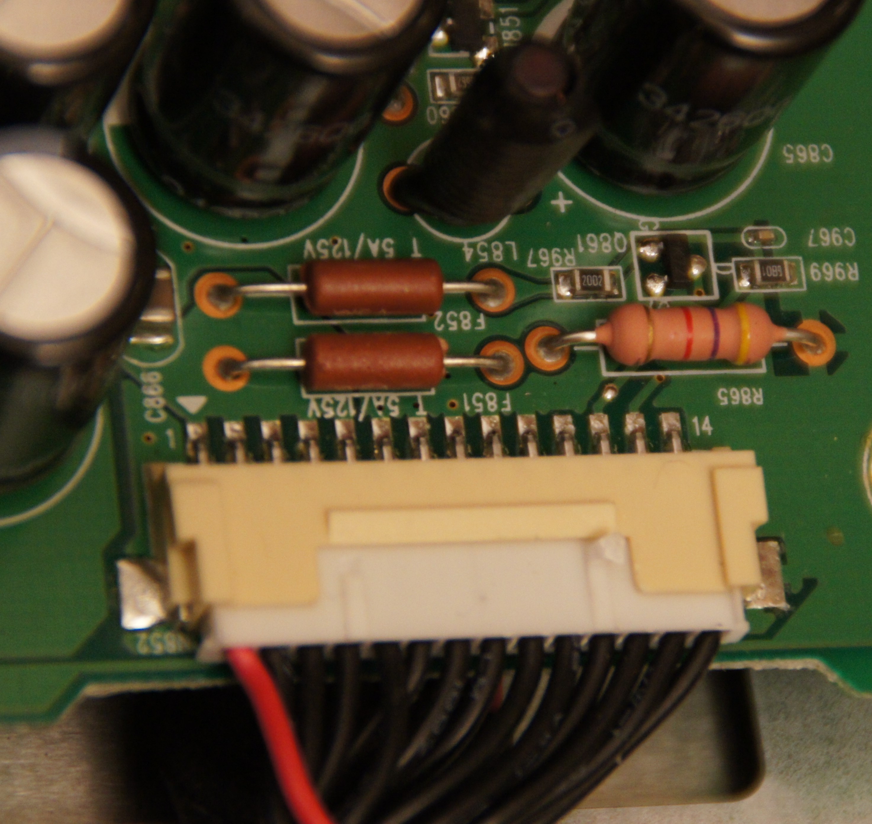

    I have attached pictures of the opened monitor and the 14 pin connector which connects the power supply board to the inverter board.
    I also measured the voltages on that connector:
    pin1-5: 23,8V (stable after 3s, no change during operation)
    pin6-10: 0V (I think this is GND)
    pin11: 0V (constantly, no change in voltage)
    pin12: 3,2V (stable after 3s) falls to 0V 20 seconds later
    pin13: 1,7V (stable after 3s) falls to 1.5V after 20 seconds
    pin14: 3.6V (stable after 3s) falls to 0V after 20s
    If I constantly touch the buttons for the OSD display, the voltages on pins 12,13 and 14 do not fall after 20s and remain on 3.2V, 1.7V and 3.6V.
    Not sure if this is correct, but I think the monitor is going into standby after 20s, if the touch panel is not touched. If I keep touching the panel it probably doesn't go to sleep and tries to display the OSD (just guessing).
    It would help me a lot if you could help me to figure out what I should check next and hear your opinion about what could be the issue.
    Thank You!

      Re: DELL U2410 problem
      Hi!
      Yes, I solved the issue. One of the backlight tubes had a bad connection to its socket. I cleaned the tube (it was very dirty) and after the cleaning it worked just fine!
      The issue is explained in some other thread about U2410:
      https://www.badcaps.net/forum/showth...8&goto=newpost
      A.

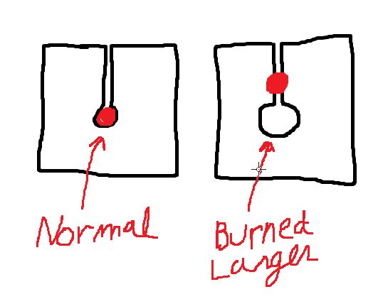

                    Today I had some time (Canada day here!) so I took some time to dismount the monitor again. Like you said Meinfreund, I manage to get the monitor turn on while dismounted and I saw on the same pole that I had previously cleaned that there was an electric arc forming in one of the graphite rubber (video enclosed in the attached zip file). I removed the two rubber and remarked that in the one forming the arc, the hole was much larger. Sorry, I took many pictures but forgot to take one of the rubber.
                    I've made a simple drawing. On the right you see a normal rubber. On the left, it's my broken rubber with the bigger hole (probably rendered bigger due to the electric arc over time. Like you will see on my drawing on the left, I ended up hanging the tube's pin midway between the crack and the hole. It now work like a charm! I don't know how many time this will do, but the image is perfect and I'm so happy as I was about to spend 300$ for another monitor (the U2413 is at 269$ CAD+tx until tomorrow!).
                    Thank you VERY much for your help!
                                I also had the same problem. I tried the tinfoil suggestion elsewhere, and it seemed to work, until I left the monitor on a while longer and then it was turning off again. So my guess is I still don't have good contact.
                                anyone know if it's possible to order these rubber ends? and if so, from where?!
                                    Worked like a charm. Saw the arc, Bend the pin a littlle bit and its runiing like new....thanks!
