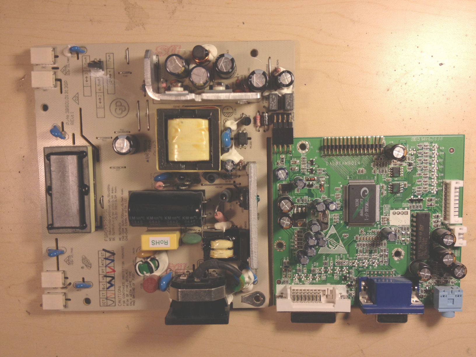

    Guys, I have a I-INC tw191d Monitor that someone gave to me because it had problems - dim display, won't come out of standby, etc - getting worse. I took it apart and found 5 leaking caps - 3 470uf 25V, and 2 1000uf 10V. I replaced those, and the monitor powers up, shows the test "No Signal" message. Looks good, so I reassembled and tested on a computer - no image from the computer. I tested with another cable - fails.
    So the monitor works as far as displaying the test "No Signal" message, but won't display any computer image.
    Could one of the caps I replaced caused this issue? I'm well versed in soldering, so I can't believe I damaged anything else on the board, but I suppose anything is possible - but nothing that looks obvious visually.
    One thing I should mention - the 470uf Caps are a little shorter than the original - 12mm instead of I think 14 or 15mm, but that shouldn't matter. Other than that, I have no idea what happend.
    Can anyone help?

        I tested the main power supply/inverter board for output. The pins that lead to the logic board (I think that's what it's called) are marked so I metered them.
        12V = 11.87V, +5V= 5.23V, and adj = 0V
        Not sure what the "adj" should be when it's not connected to the logic board or anything else, but I suspect it should be 0V when testing this board alone.
        My gut tells me it's somewhere on the logic board, since that's where the vga connectors are, and the power supply looks like it's supplying proper voltages. Although I should find a way to test the "adj" voltage I suppose.
        Can anyone give me a nudge in the right direction...? Does it look like a problem on the logic board?

              I only see 1 voltage regulator on the logic board (or mainboard). Tested as follows:
              Chip type is 1117
              pin 1 = 2.1V
              Pin 2 = 3.34V
              Pin 3 = 4.51V
              According to the spec sheet - this is a variable voltage regulator and states Pin 1 is adj, pin 2 is output, and pin 3 is input.
              Looks like Pin 3 is low - Shouldn't it be 5V? So does that mean theres another problem on the board feeding this regulator? According to your example in your tutorial - the 1117 chip adjusts the output by 1.25V, so pin 1 is 2.1V plus- 1.25 is 3.35V - appears to be within spec. So does the regulator test OK? 1supertech was most likely on the right track with a possiblity of a faulty cap?
                Re: I-INC TW191d - No Image from Computer after Capacitor Replacement
                Adj pi + 1.25v vref = output voltage, so 2.1v+1.25 = 3.35V, it is OK, but the 5V is low, you should check the caps for input and the output of this regulator. you can solder in the new cap in parallel with the old one just to see. What kind of meter do you have, does it have frequency counter function?

                          I checked voltages at various places on the board around that voltage regulator and found D21 is where it drops from 5V to 4.5V. One side is 5V, and the other side is 4.5V.
                          D21 is located right above the caps on the far left near the voltage regulator. D21, I assume it's some sort of Diode? Is this where the problem is?
                            That is correct voltage then, so it looks like the regulator input pin is fed through the diode which will make the output of the diode to be 0.6V less due to the Vf of the Diode.

                              Not sure what I should do next. I think I understood that the diode voltages are correct, which feeds the voltage regulator at 4.5V. This is correct then? So it's not the voltage regulator or the diode at this point.
                              Just to recap the problem: The monitor shows a display of menus etc OK, but will not show an image from the computer - it's just blank. Acts like a faulty cable, but I tried another cable. Any ideas?
                                Yes, that is correct, it is being fed by 4.5V due to the voltage drops of 0.6V on the Diode. I am not sure where to look next. It reminds me of the SAMSUNG monitor problem due to corrupt EEPROM.

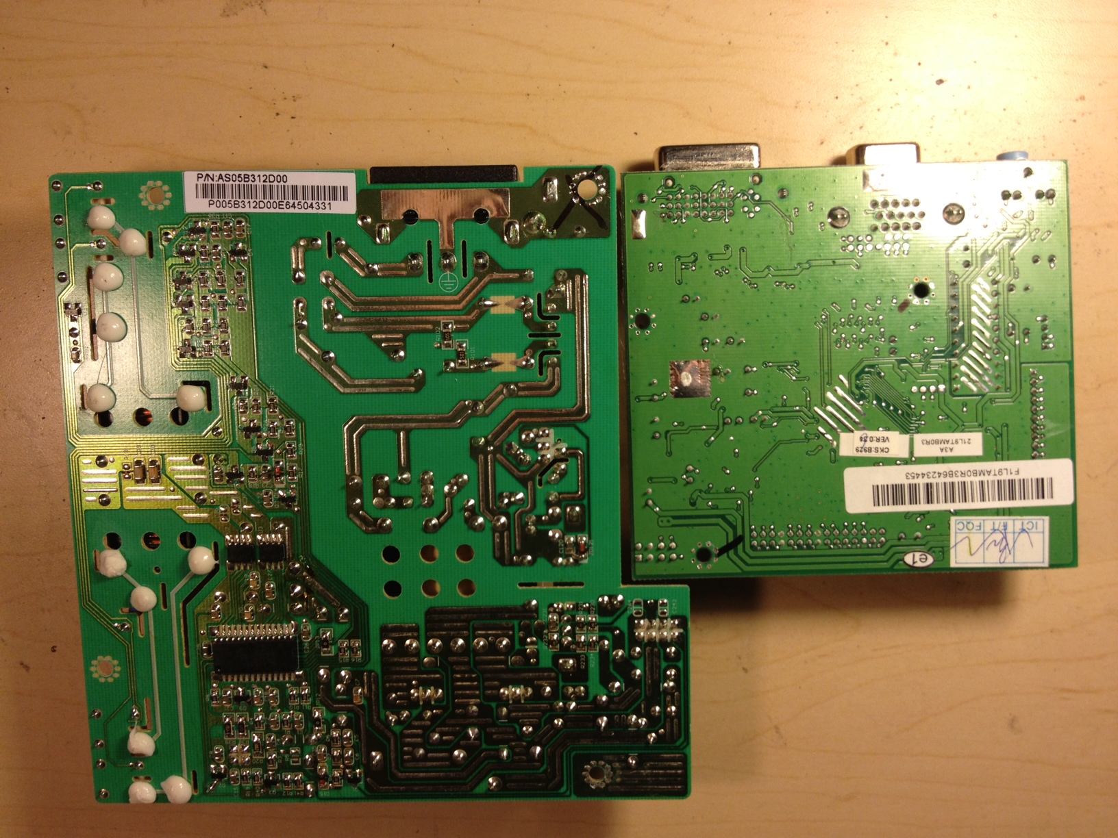

                                    Seems like you forgot to change one capacitor on the power supply (top right corner of second picture in 1st post). Looks like a CapXon. It may not be the issue, but it will fail if it's a CapXon, and no telling if that will affect the monitor or not.
                                    If you're ordering caps again, you might as well get caps for the video/logic board too. The ones in the bottom right corner are for the monitor speakers/amplifier, so they aren't important, but the other ones on the video board - particularly the bigger ones are and should be changed.
