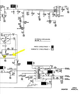

    Good day all,
    I have a question about some old monochrome Apple monitors.

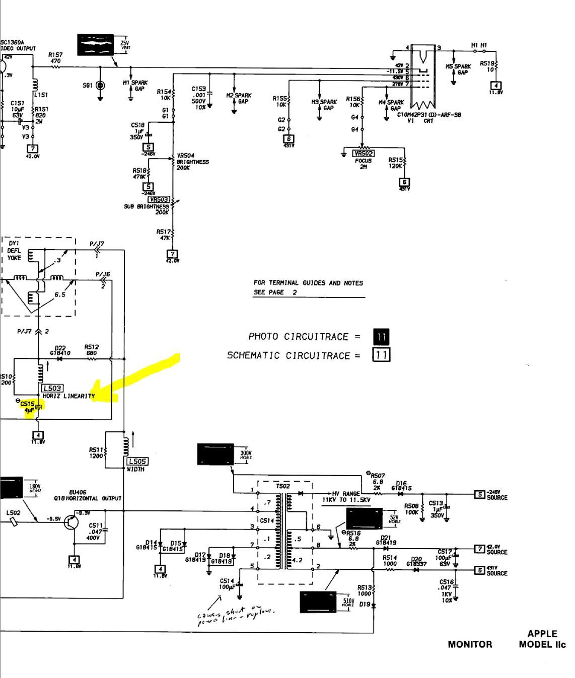

    Inside those monitors there is one bipolar capacitor. From the schematics I have it's part of the horizontal linearity circuit.
    A friend replaced a bipolar 4.7uF 25V capacitor with a Nichicon bipolar 4.7uF 25V. The cap popped after about one hour. The new capacitor was much smaller than the original one but that's not a surprise as the original one was from 1980. (I am not sure whether the original was was actually 4uF and was replaced with a 4.7uF?)
    The new capacitor: https://www.digikey.co.uk/en/product...4R7MDD/2539572
    The general consensus is now to use FILM capacitors - mostly because those Bipolar electrolytic are not easy to find anymore.
    My question is: why would a good quality BP cap pop in this scenario?
    Thank you!

    thats a high current circuit and modern bi-polar caps arent.
    use a film cap.
    it will be bigger so you may need to get creative, but all the widescreen tv's before CRT went out of fashion used film caps for this reason.

      How would current affect a capacitor? I am honestly asking, I do not know. I know that temp and voltage would affect a cap but what happens when current is involved? Where do I find that value in the datasheet? https://www.mouser.co.uk/datasheet/2...vp-3082211.pdf
        • 31068
        a capacitor has a maximum current it can hold or pass through, if you try to exceed that it will get hot real fast and the liquid will boil and burst the vent open.
        if your unlucky and it doesnt have a vent then the can is going into orbit and you get bits of brown paper everywhere!
          • 31068
          current is shown in that datasheet as "rated ripple"
          so 34mA is a joke
