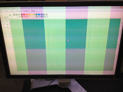

                Re: Wacom Cintiq 21UX Garbage Everything
                Originally posted by kc8adu
                yes bad ram or scaler.
                I agree. Whenever I got that blockiness and it was uniform it was the T-con (scaler board)
                I attached a picture of a Dell that worked with a new T-Con board. See if that looks similar.
