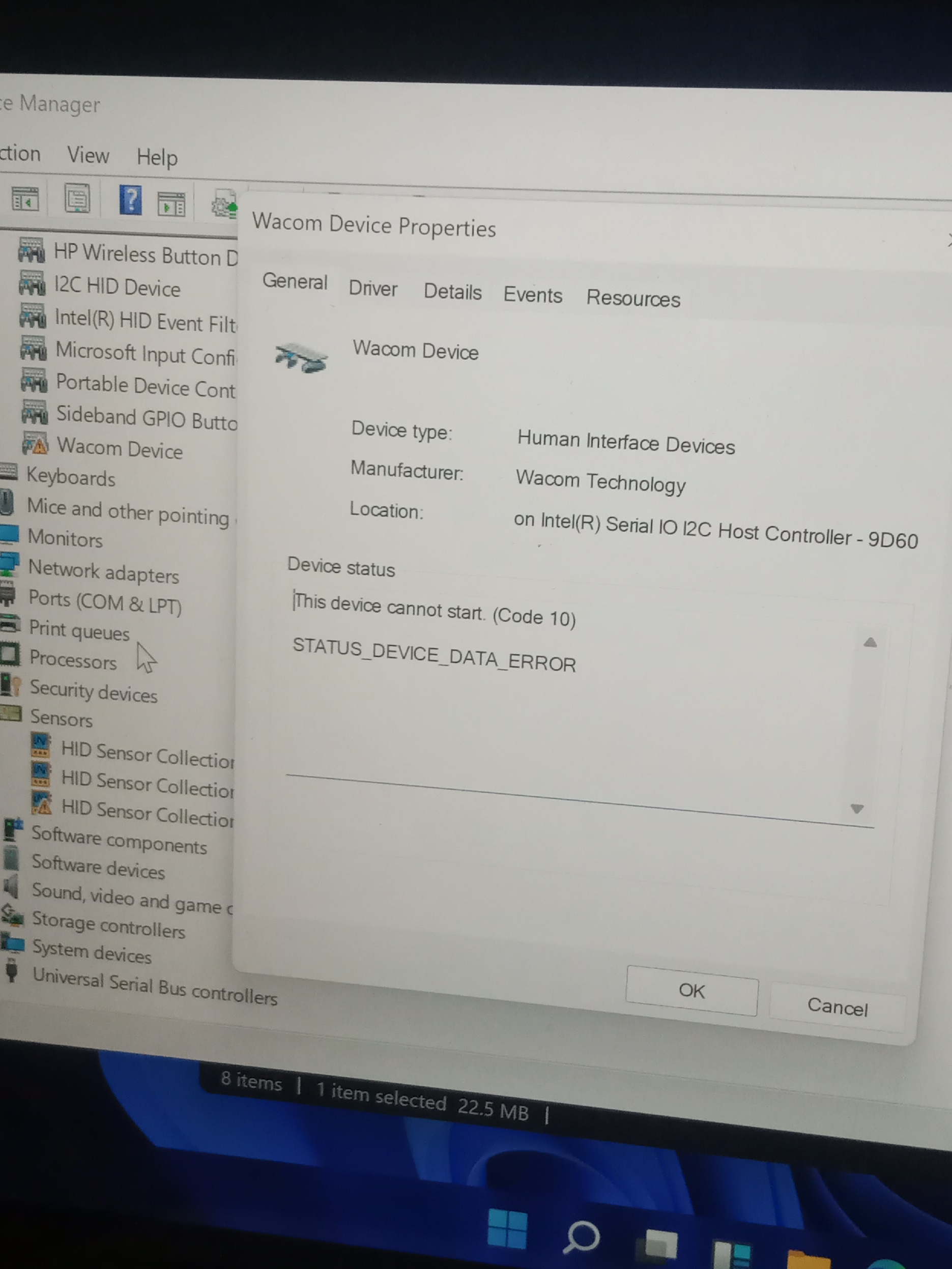

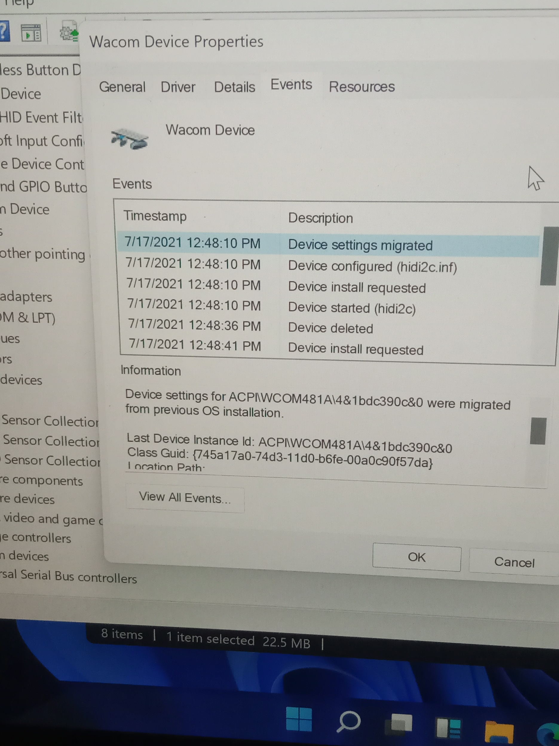

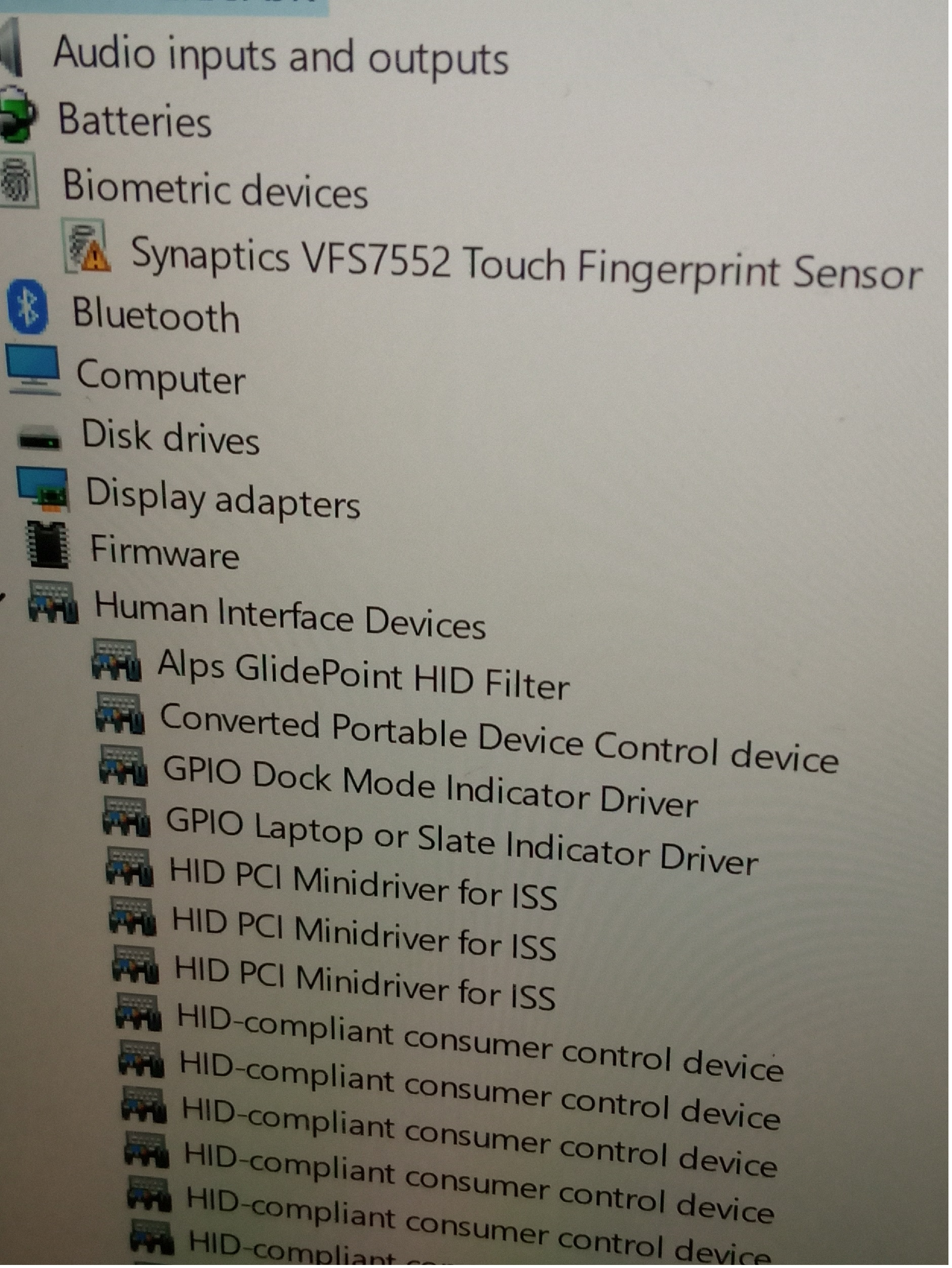

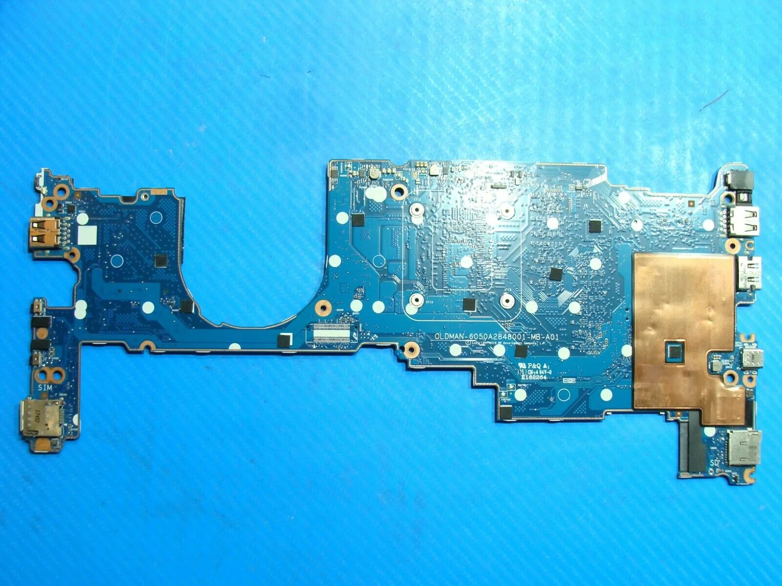

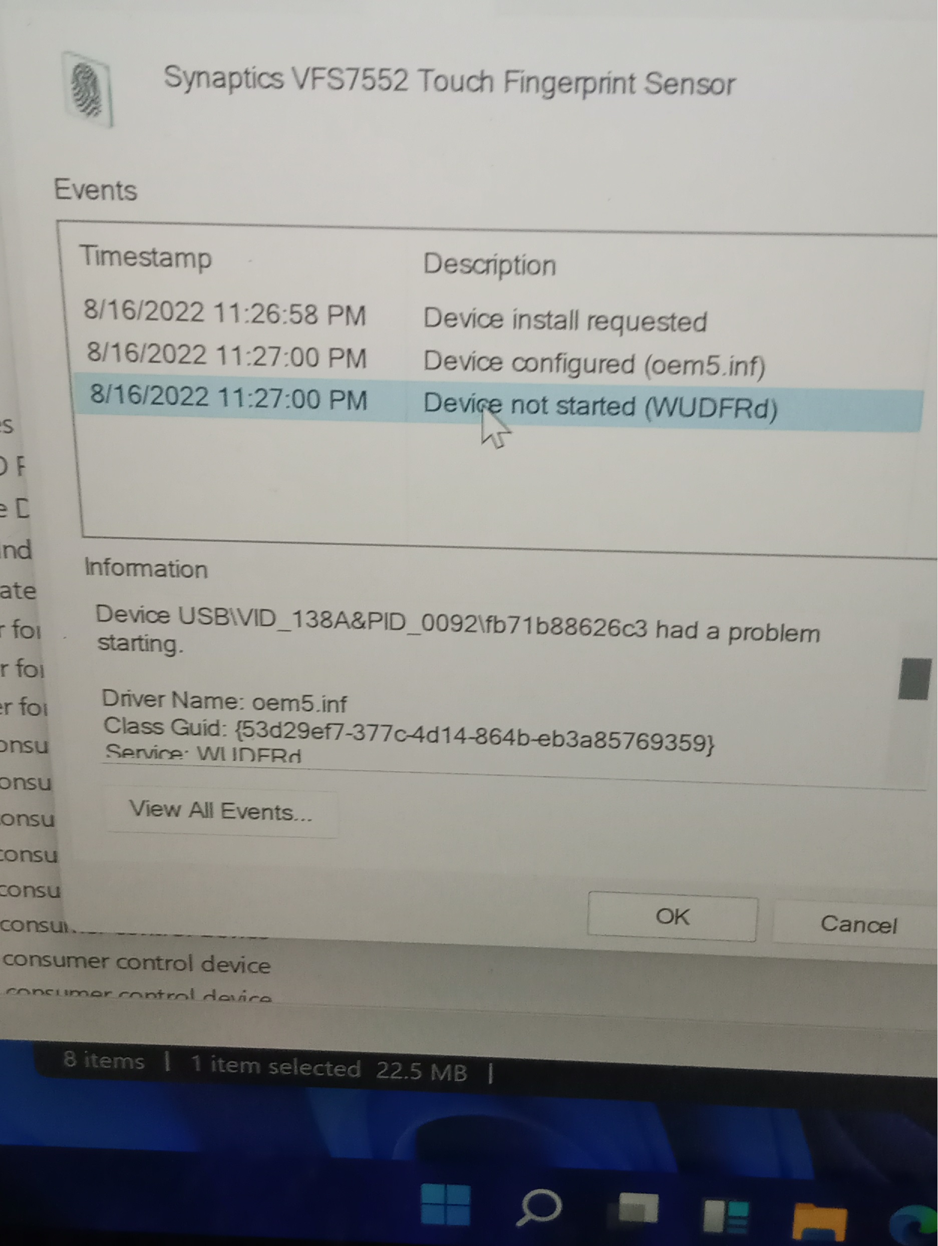

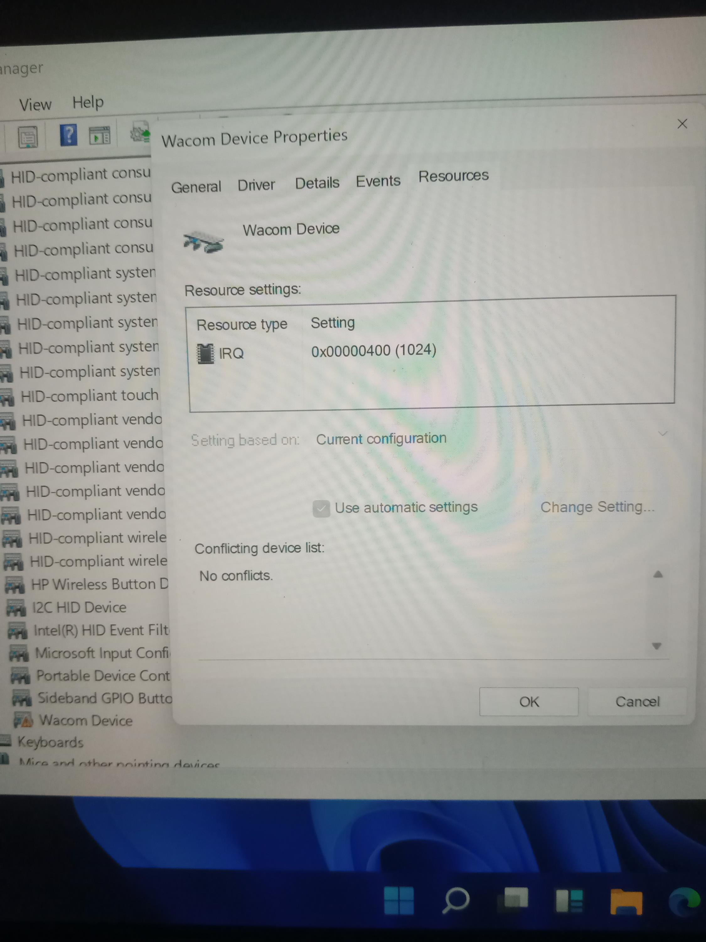

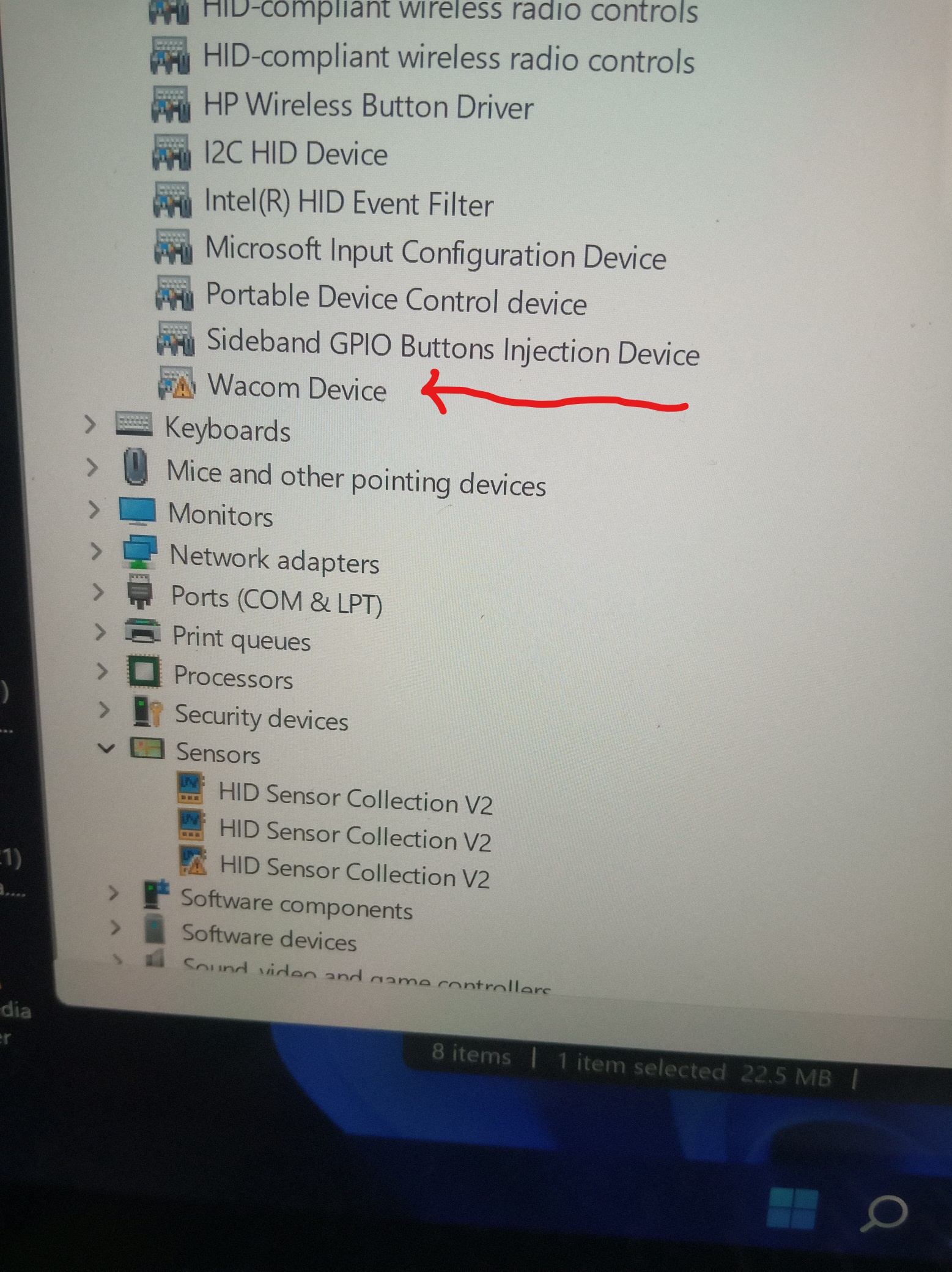

    Hi Everyone, I have this HP EliteBook X360 1030 g2 with the Wacom device not installing. Because of this, the Fingerprint, Touchscreen and webcam/Face ID devices are not working as well.
    If it is a hardware fault, which area on the motherboard should I focus on? There is no boardview or schematic so far.
    I have attached some pictures of the error it gives. I need help in solving this problem. Thanks

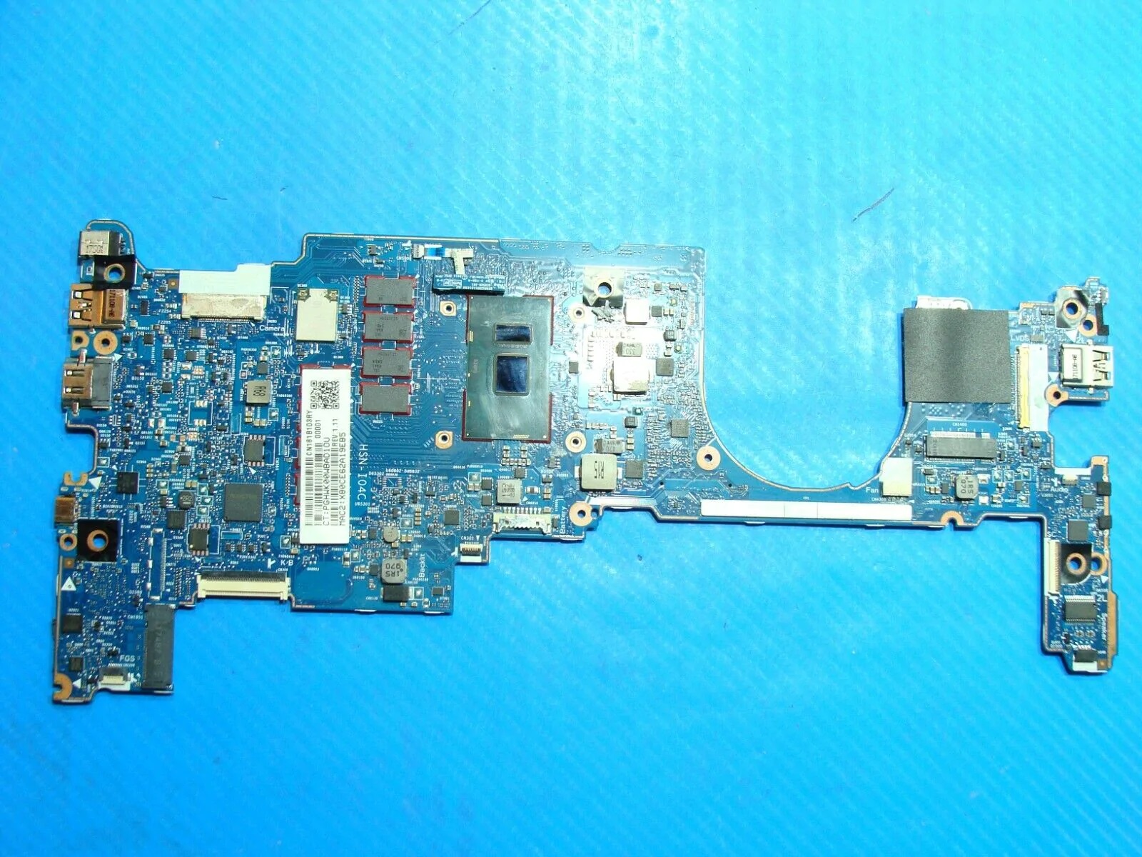

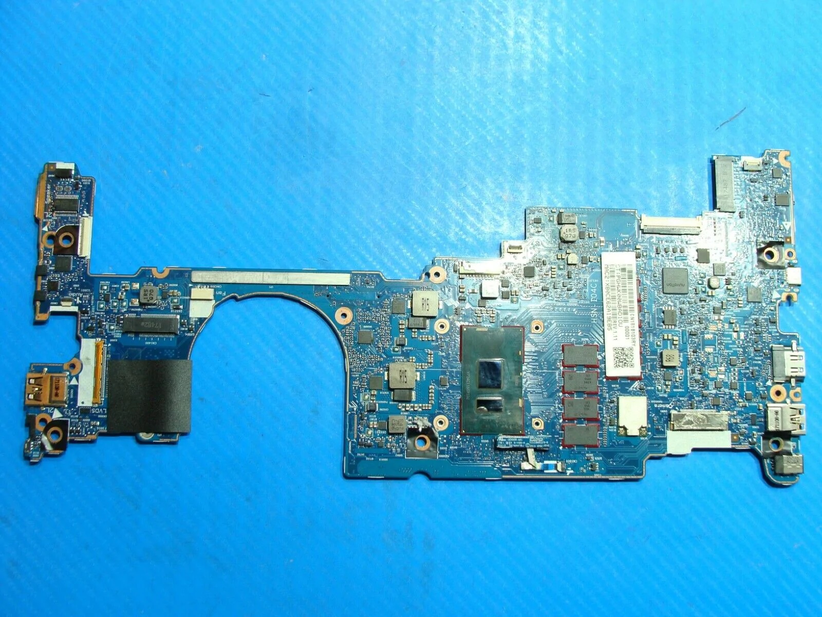

    Here are the motherboard pics as well. This is not the actual motherboard. It is only for reference sake

      These appear to be standard device driver installation faults.
      Go to the HP website and download the latest bios - that is the recommended first step.
      Then install the latest support chipset driver packages for this model and see if the issue is resolved.
      Found this driver which may be current:
      https://support.hp.com/us-en/document/c06146381

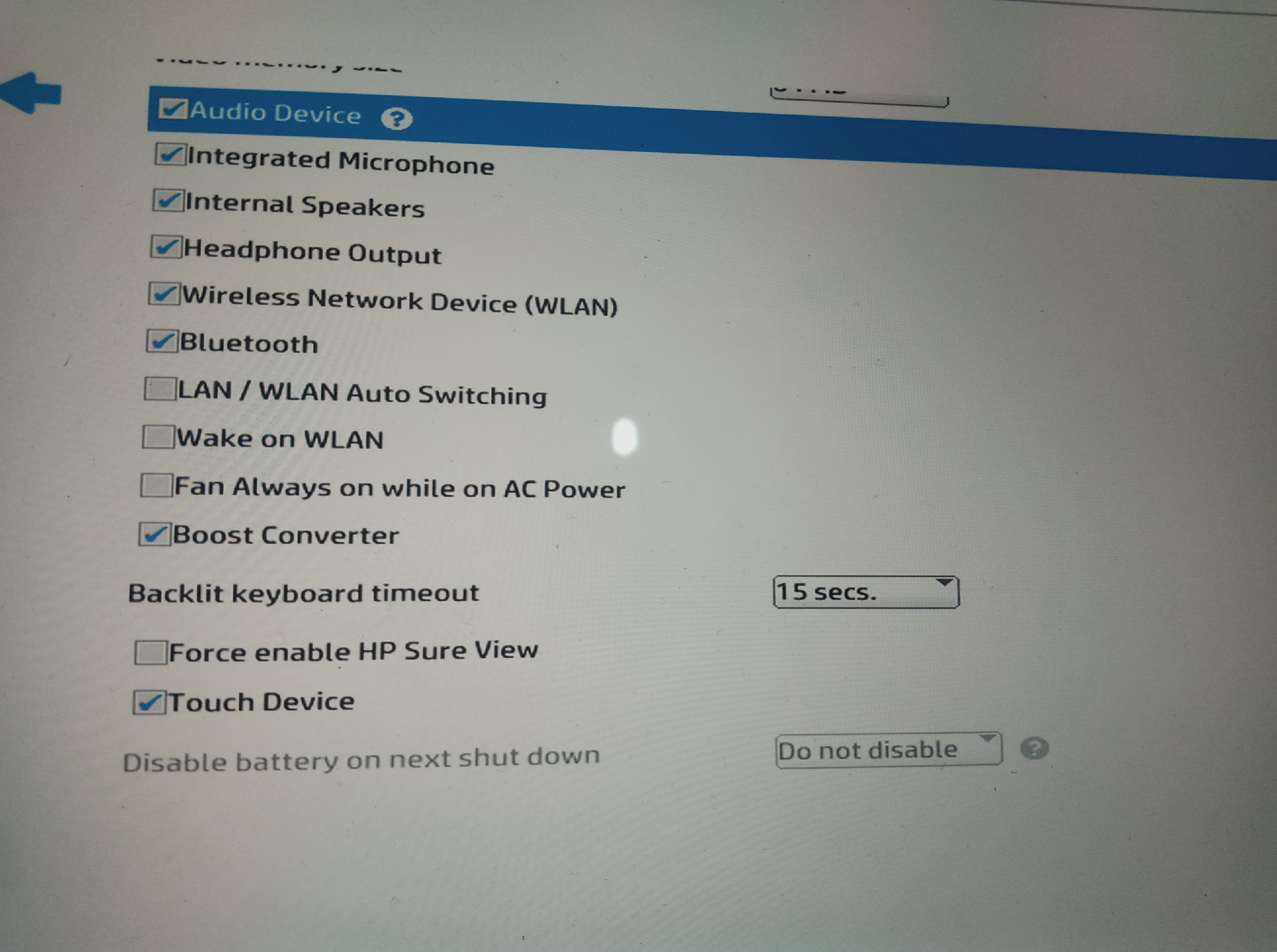

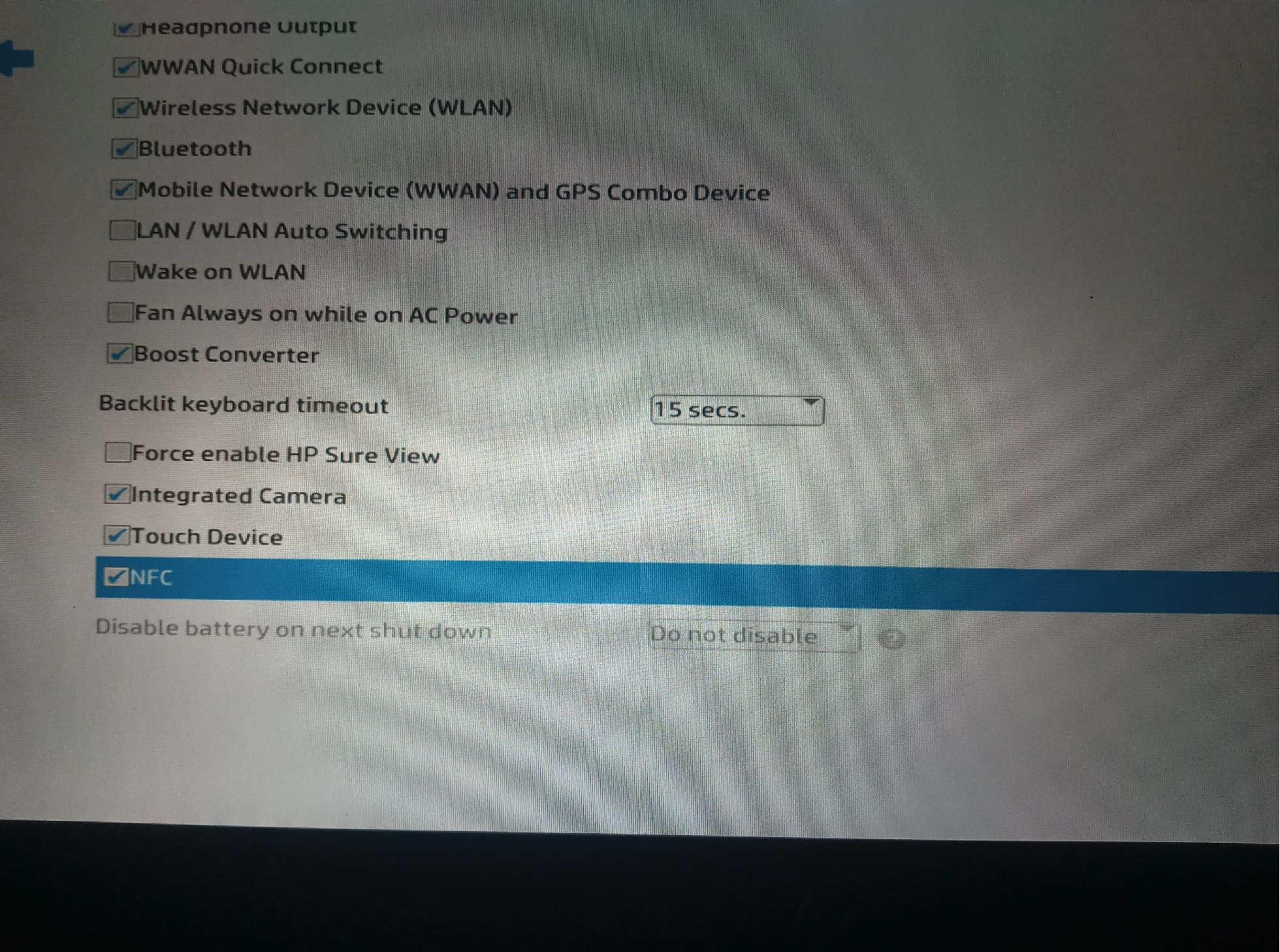

          However, the latest BIOS update has already been installed. Also, the touchscreen doesn't work in the BIOS setup. Integrated Camera (Webcam) not detected in BIOS as well.
          I've attached a picture comparison between my laptop's BIOS setup with a fully functional one

            I think it may be a hardware fault which is also why I need help in locating the Wacom device on the motherboard so I can examine it in case there's something wrong with it or around it.
