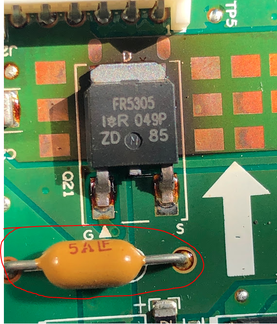

    hello I have a Cintiq 24 hd dtk 2400 manufactured aug 2011.
    it has no power. Tested with known good power bricks. The green light on the power brick dims when connected to the Cintiq. this is a WACOM display that takes pen input for illustration and the like.
    I dissembled it and located the power input board and noticed a heat damaged component. (see pic)
    https://photos.app.goo.gl/87cwnc1mc8Yd1zES9
    it is labeled
    FR5305
    I*R 049P
    ZD 85
    I did an ebay search for the power input board with no luck. So then I searched for the burnt component, the first row of numbers had multiple matches but not with the rest of the numbers.
    My rookie question is; can I replace the burnt component with one that just matches the top row of numbers? FR5305
    Thanks any help will be much apreaciated.

    Yes, if you are sure that the mosfet is burned out, then change it to FR5305, do not pay attention to other letters and numbers - this is a data code, and also check the fuse for 5a.

      Thanks for letting me know about the data codes, I've been wondering about matching ALL the numbers on other burt mosfets and the tip about the fuse.
      Also if do replace the mosfet, should I add a heatsink to the upper part? or maybe stand it up and add a heat sink top the metal back for more heat distribution? I think the back part distributes heat back to the power input board, but it doesn't seem to help cool it much. I have another one of these wacoms same model made in 2012 (one year later) and the power input board and big power board it attaches to were totally redesigned with MUCH bigger components.
