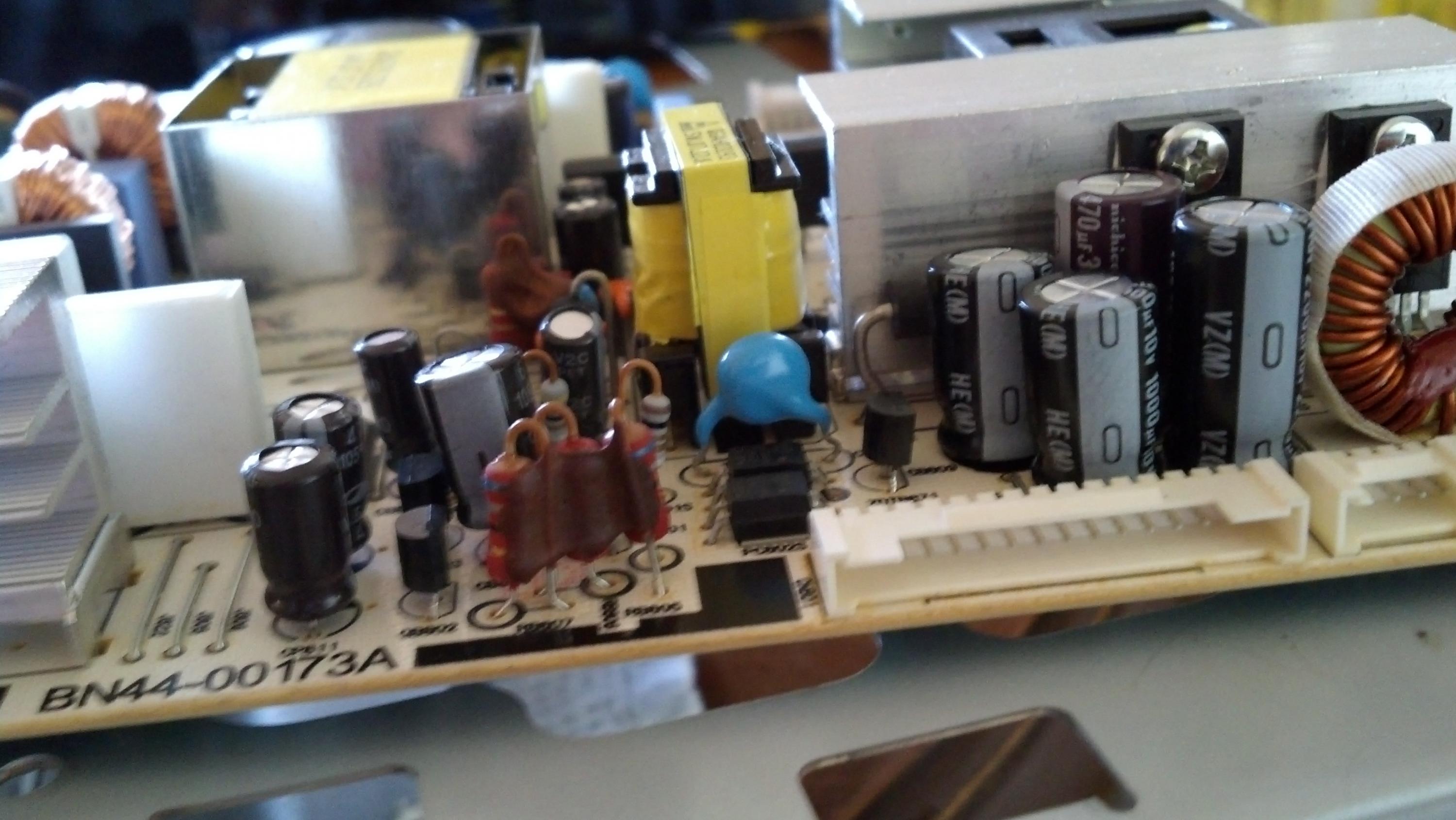

    My Samsung monitor died the other day, made a kind of cracking noise then shut off in the middle of a game. The power LED doesn't light up at all, and the screen doesn't come on at all either. Tried all the basic stuff, different cord outlets all that. I saw some youtube videos and replaced some of the capacitors that looked like they were bulging a little. Still nothing though, so thought i would come here and see if anyone had any ideas. I can post pictures just let me know what parts you need pictures of. Thanks a ton

          The crack sound means something went pop for sure. Look at the transistors on the heatsinks for signs of failure - cracks in the plastic, a white spot, or burn/soot marks. Also check resistors. Take a look at any ICs on the bottom of the board, and see if they are burnt/cracked. Hope this helps!

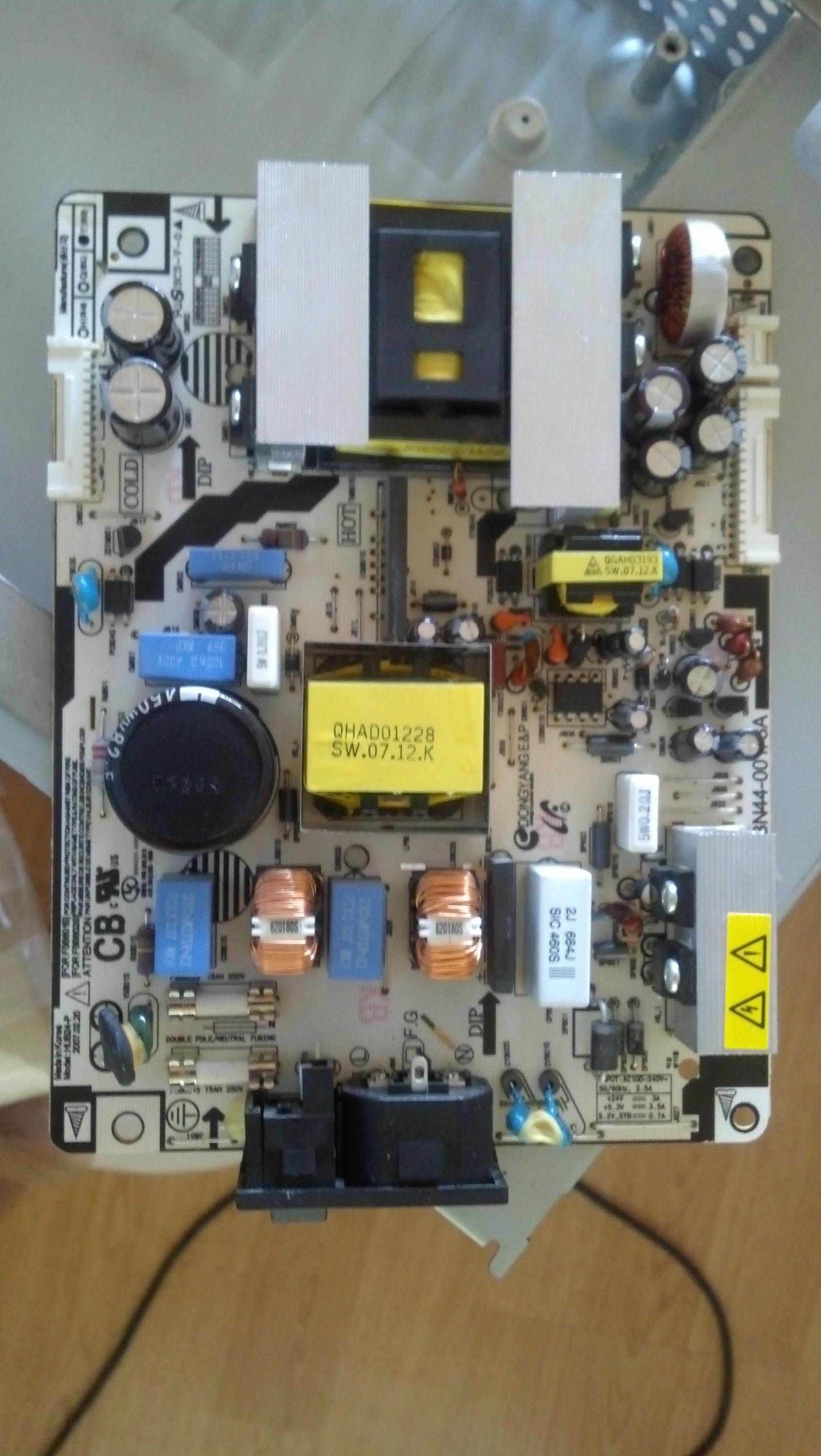

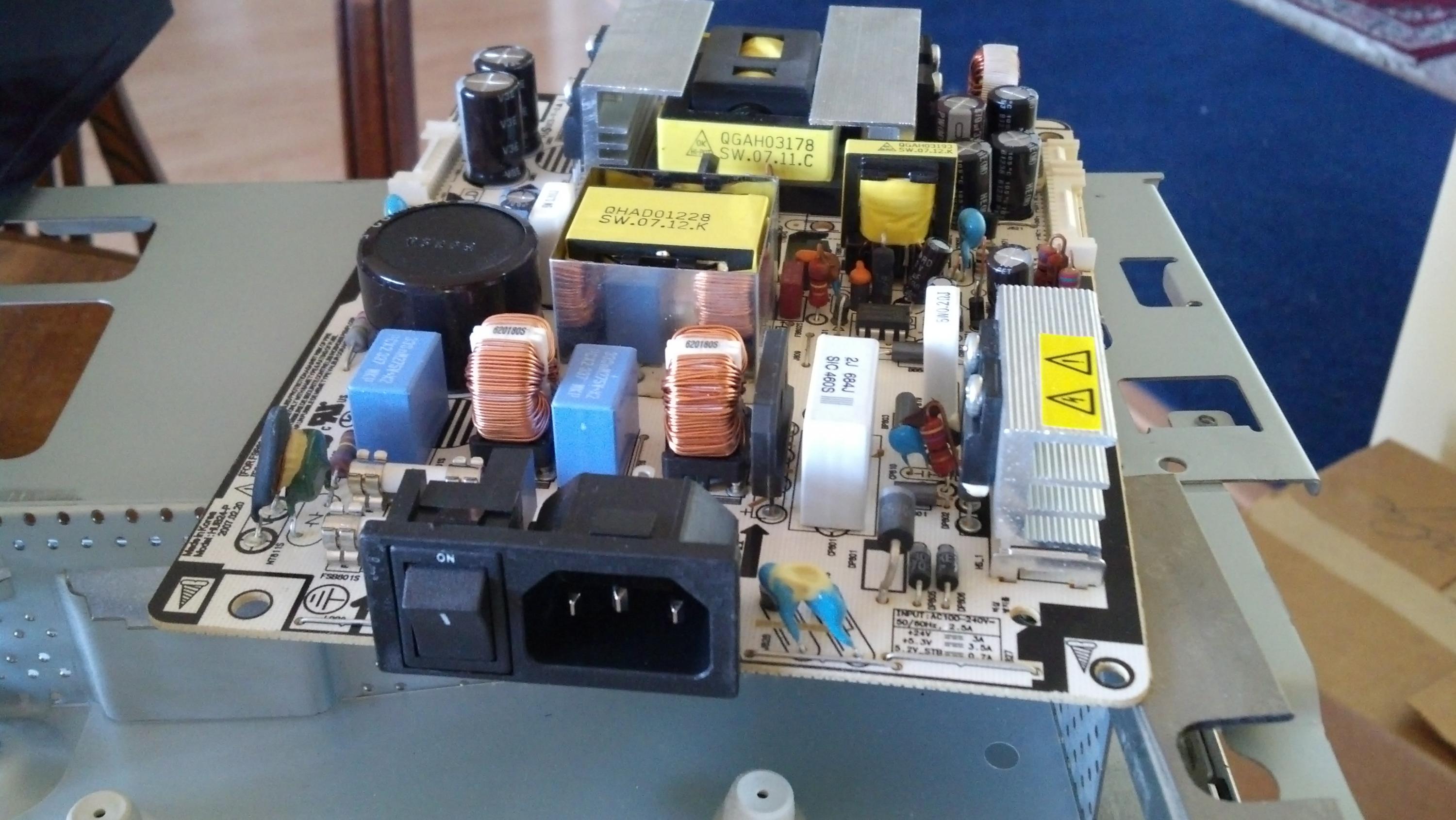

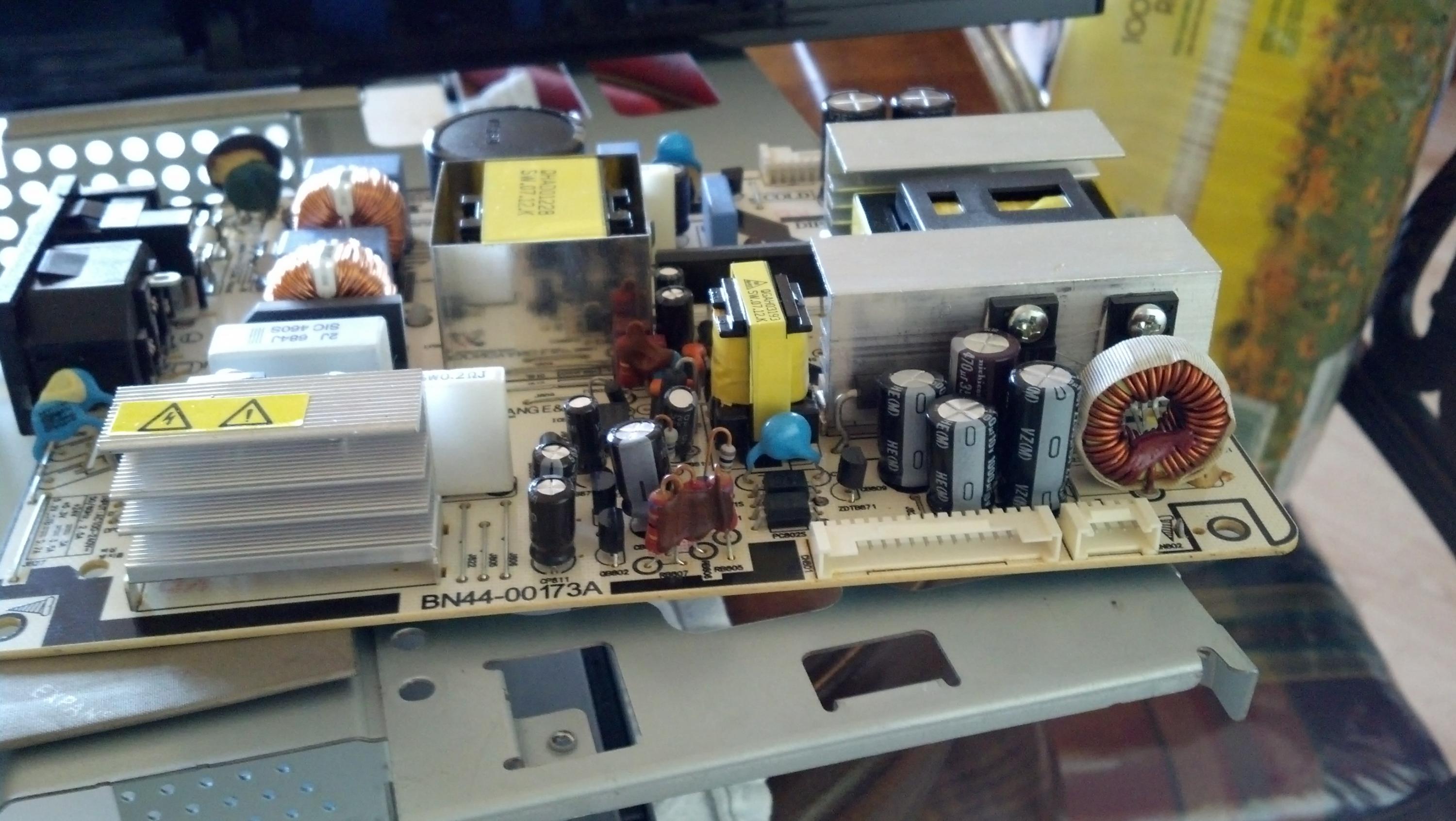

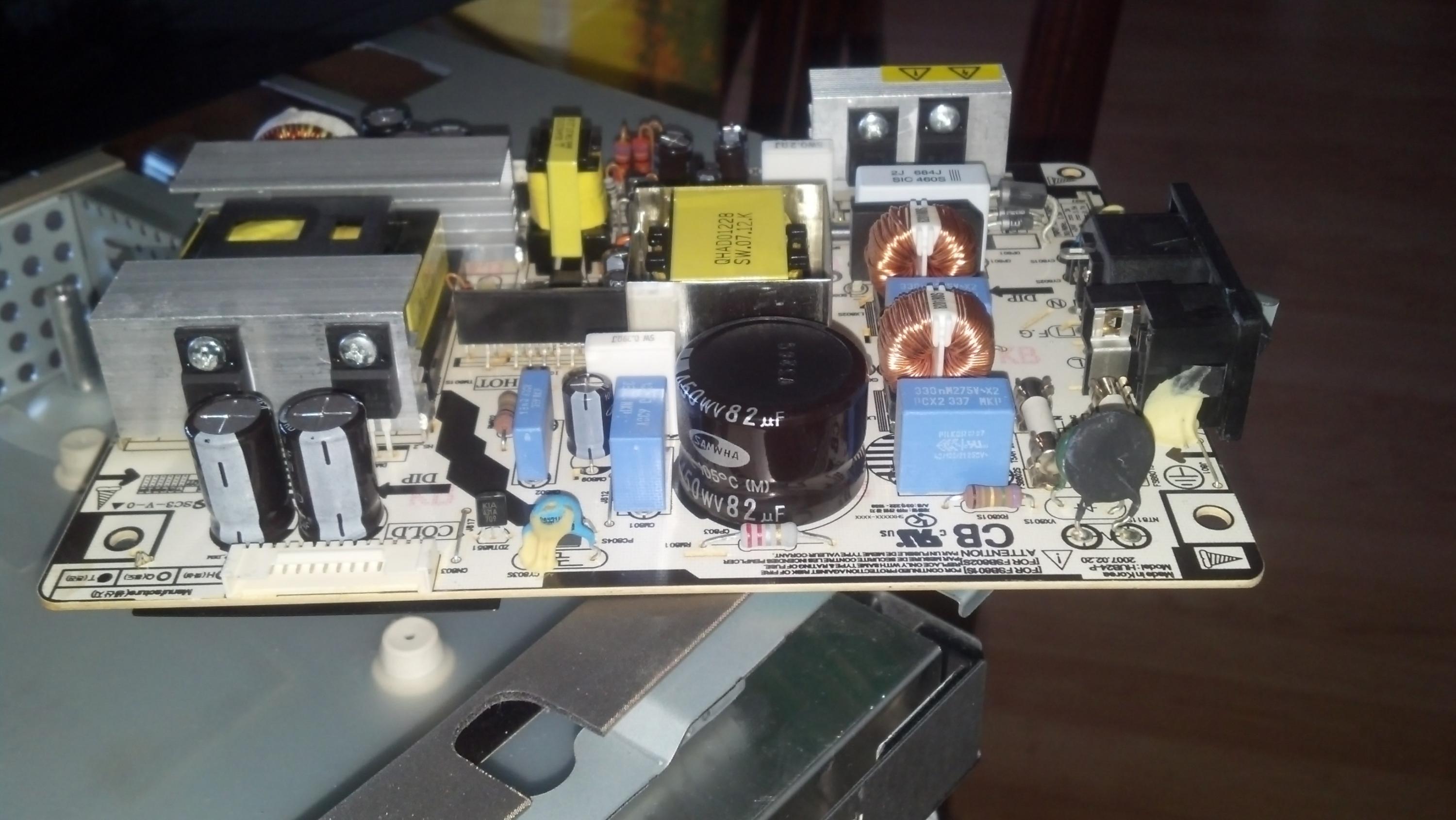

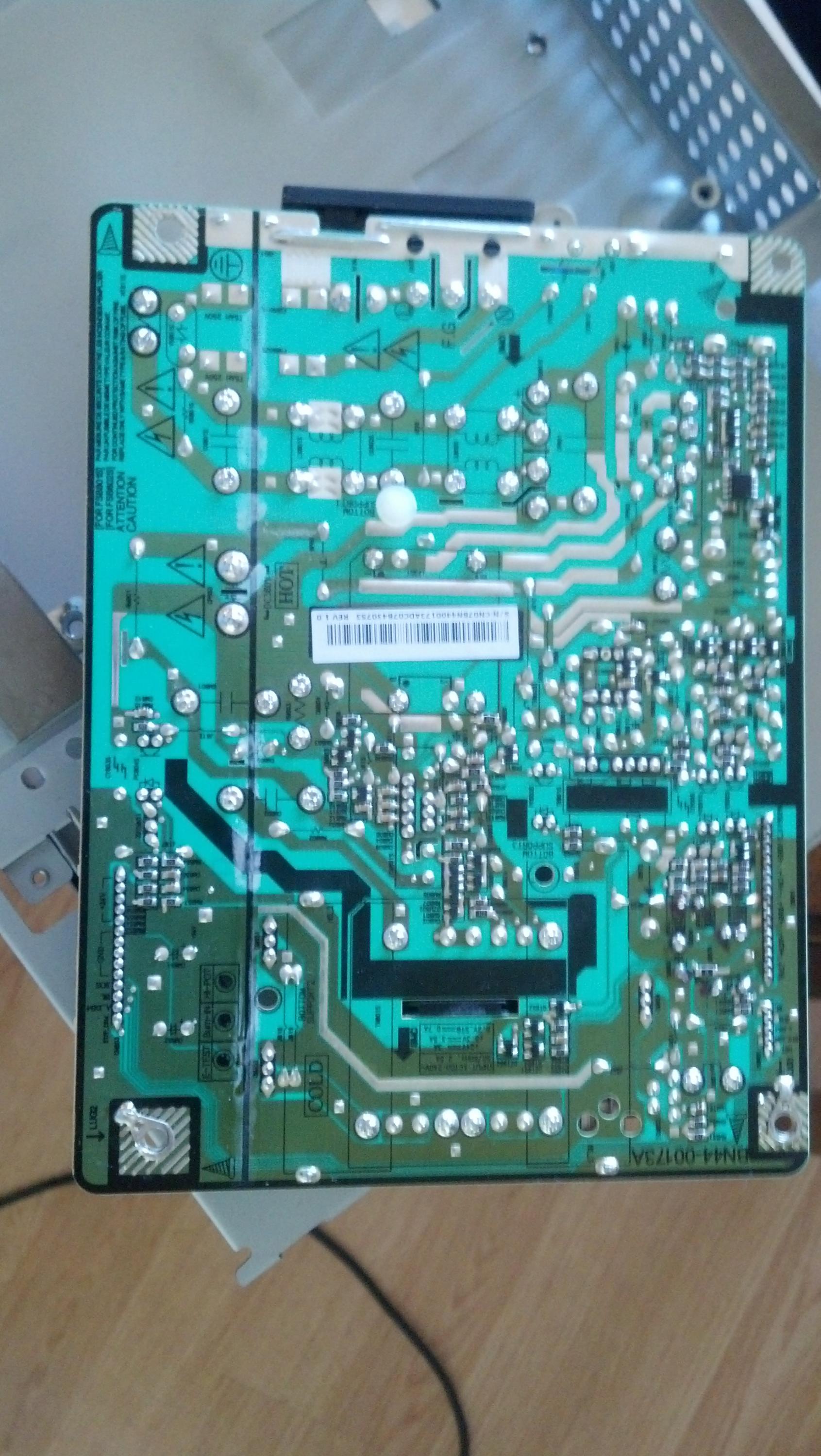

            i have visually inspected the boards really thoroughly but haven't been able to find anything unusual. I ordered all new resistors and some new fuses. I also attached some pictures.
              Re: Samsung syncmaster 245BW no power at all
              Make sure to remove those yellow/brownish color glues.

                Before you possibly waste new fuses, test the resistance across the big 450v filter capacitor.

                    Google using the board code, BN44-00173A. You will find lots of help. Typical failure is that one of the three 68 ohm resistors is burned. Usually replacing all three resistors and some capacitors will do. Check also the other similar type resistors, I remember once replacing also 100k or 150k resistor (don't remember) too. There is a nice video on youtube about how to fix (I have some comments there also).
