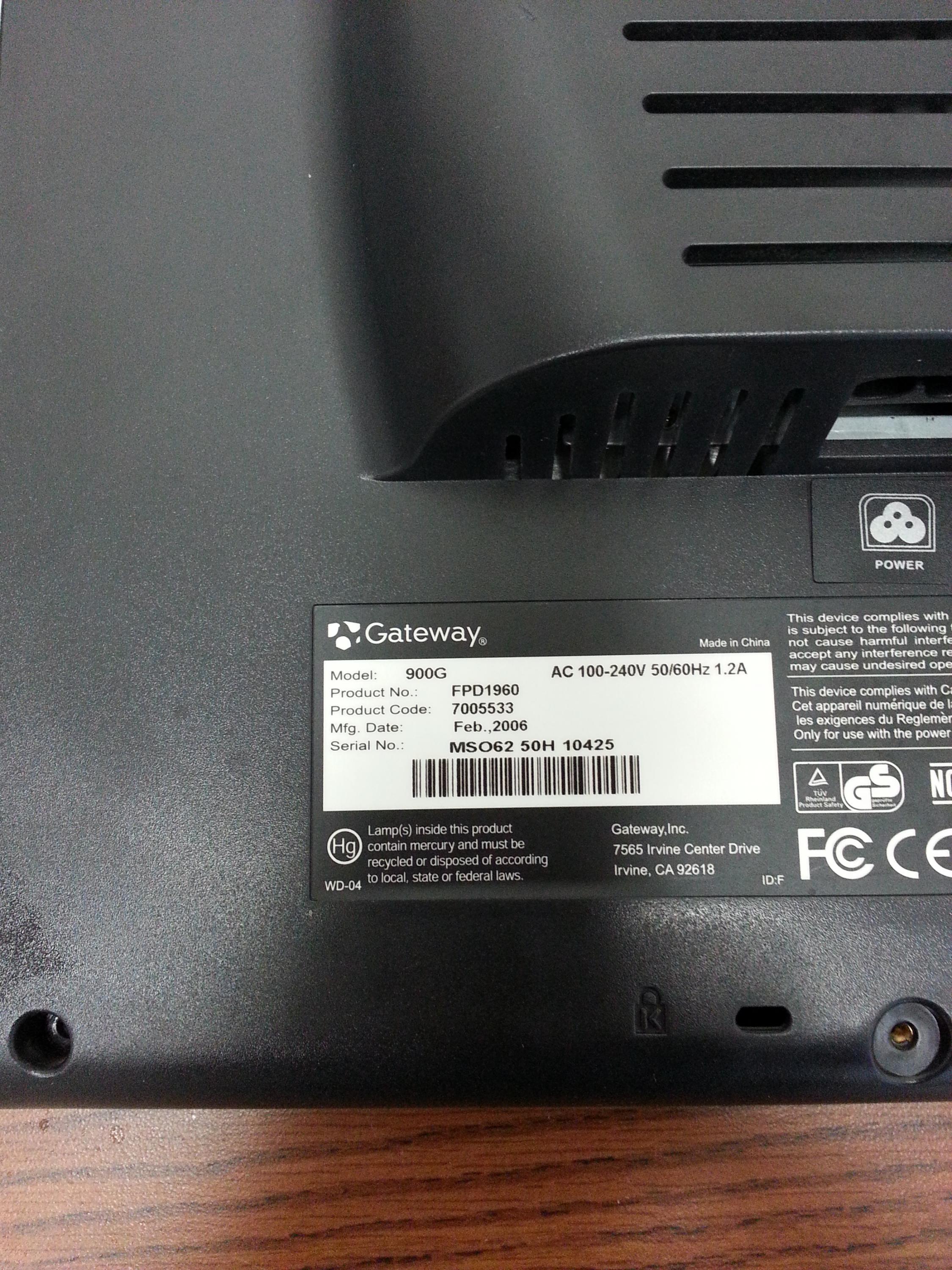

    help with Dell display unit model # 900G
    sorry it is a Gateway not a Dell. i was looking at my display when i wrote "dell"

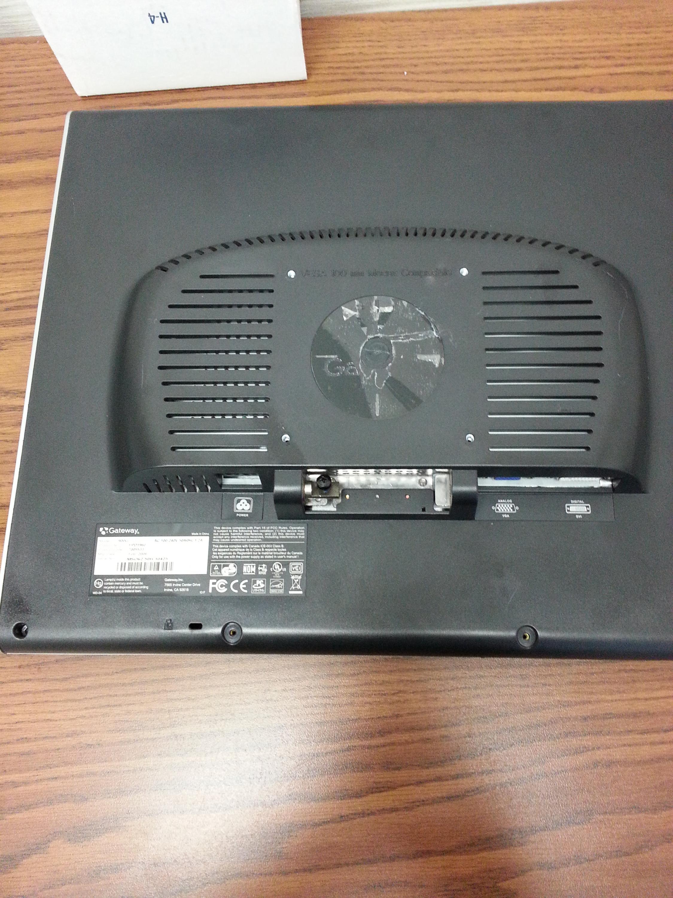

    first i need help removing the cover
    i removed the 4 screws that go to the wall mount area of the back cover
    i removed the 4 screws at the bottom
    then pryed part of the cover off which does separate partially at the bottom and top
    i do not want to try anymore force because it feels like it will crack

    Re: help with Dell display unit model # 900G
    If you have taken all the screws out, then it will come apart,so you will have to bite the bullet and continue to separate it.

      Check this video out it's not a gateway but mostly all monitor come apart the same way http://www.youtube.com/watch?v=CwKi42J2c8c
        Thanks for the help
        But I got it apart I broke a few tabs but it should go back together fine

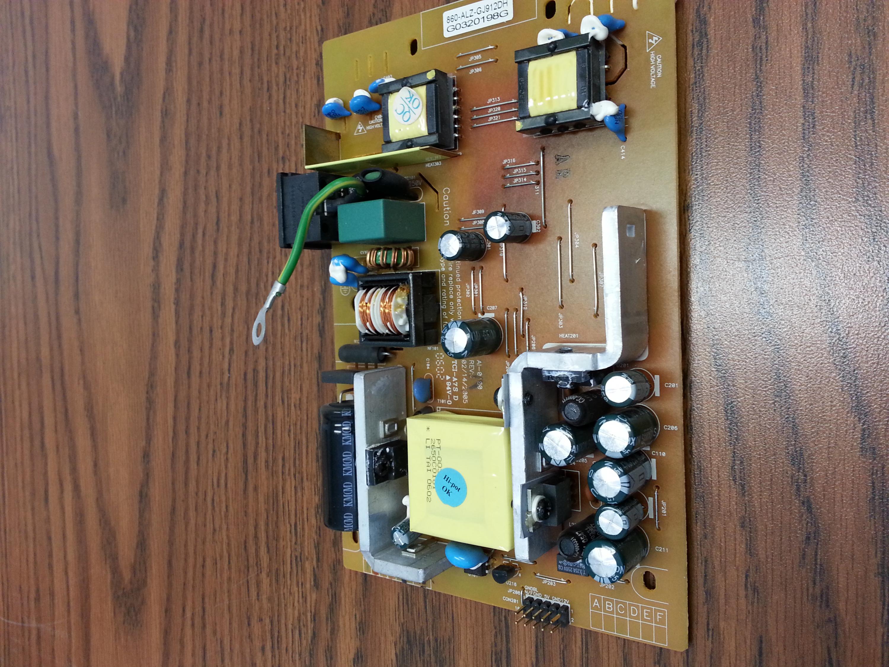

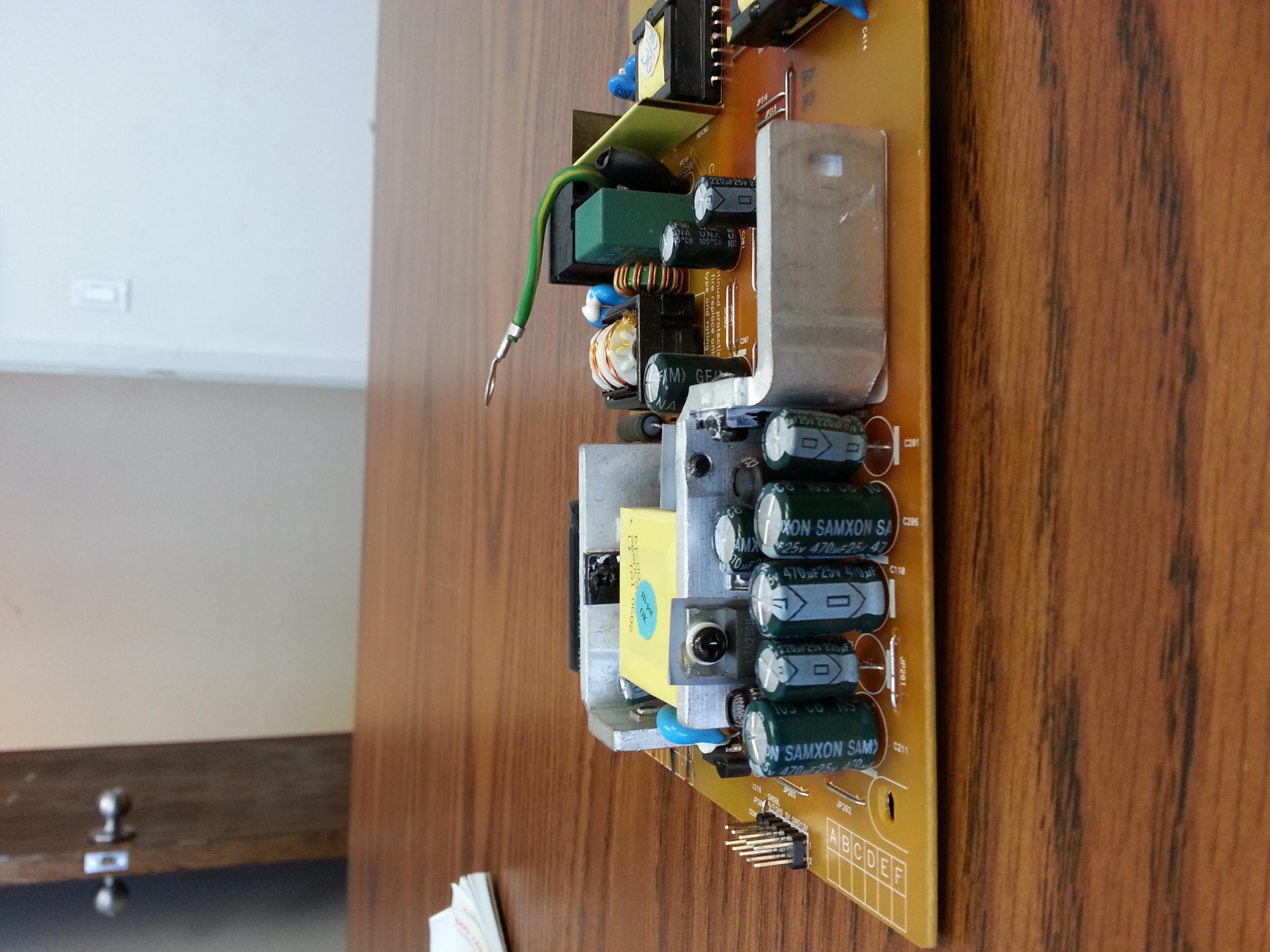

            Just as I suspected
            There are about 6 bulging caps on the board
            But I will change all of them
            Do they sell a kit for this monitor?
            I need the following caps
            5 pcs of 470uf 25v caps
            4pcs of 220uf 25v caps
            1pc of 47uf 25v cap
            Where is the best place to buy these
            Thanks for the help
                Digikey, PANASONIC FM/FR/FC series.

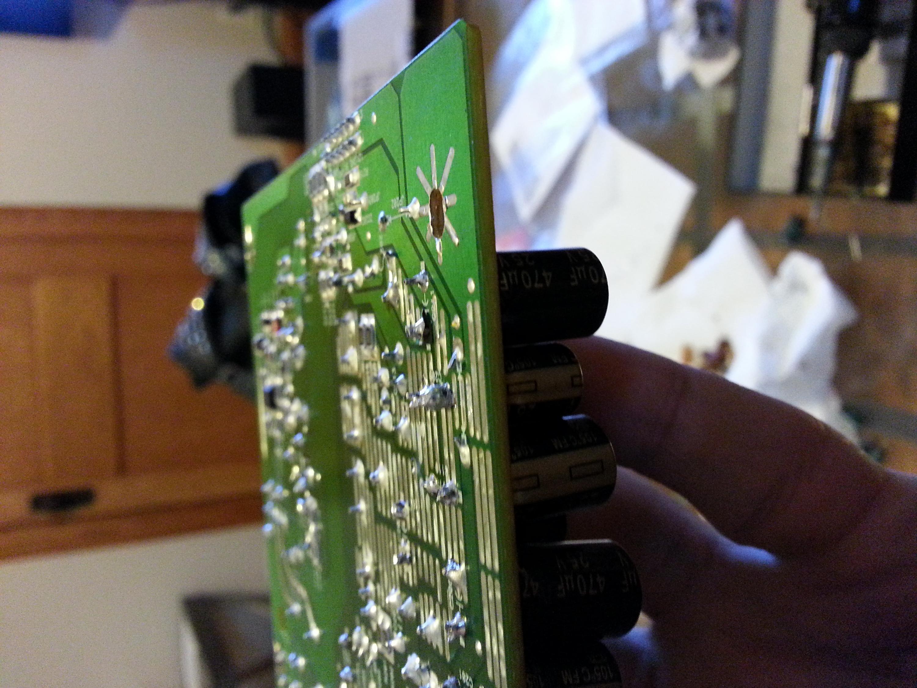

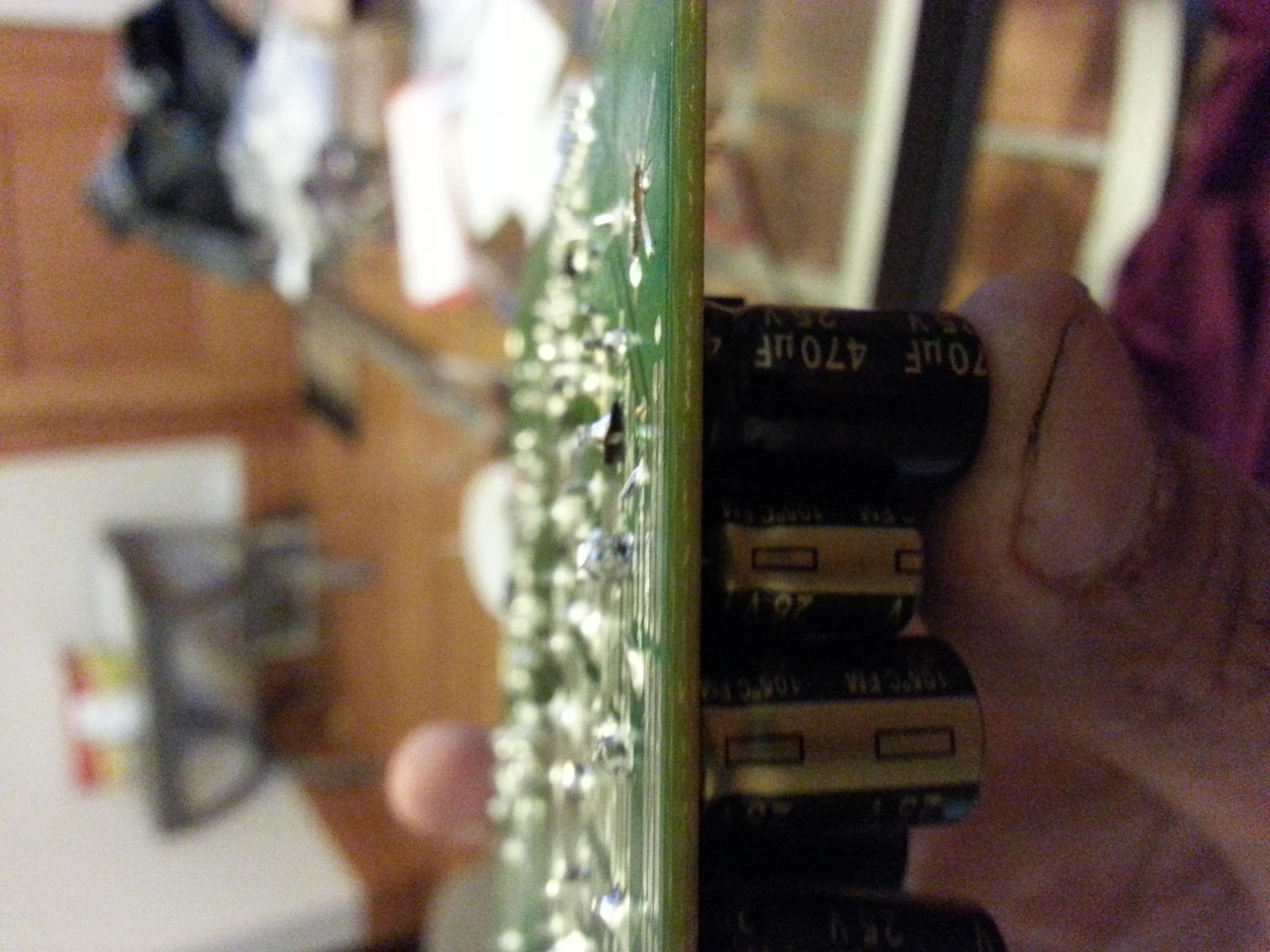

                      • jose6326
                        • May 2013
                        • 707
                        Well now I can say I fixed my first computer monitor
                        I replaced all of the caps but I kind of almost damaged the circuit board
                        When I replaced one of the caps after the solder cooled down I pressed on top of the cap and some of the green material lifted from the board
                        Luckily when I connected everything it still worked
                        I guess time will tell on how long it will last
                          Bad soldering (uneven clumping on each solder pad) there. The copper trace lifting off the board is probably from overheating (ie. placing the soldering iron too long). Looking at those areas being quite "clean"... Did you use any solder paste or flux?
                            You should use at least 40Watts soldering Iron, I use 60 Watts Weller.
                              No I did not use any flux or paste
                                No wonder! Already guessed from the look of the board...
                                Using solder paste and/or flux can lower the melting times allowing the solder to be sucked/removed quickly as well as giving "smoother" solder joints (as solder will melt quickly and easily in the presence of solder paste and/or solder flux)...
