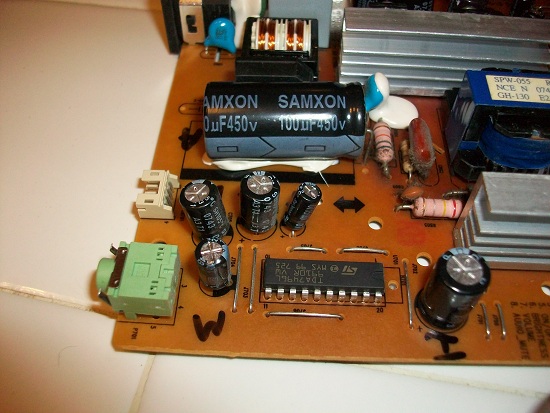

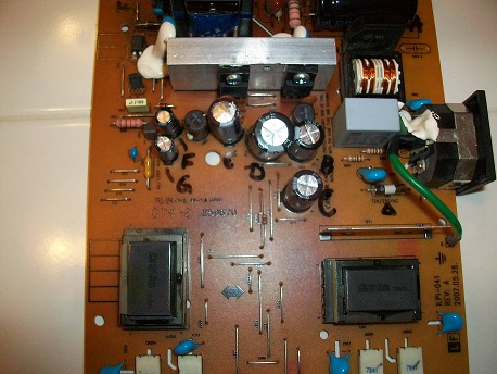

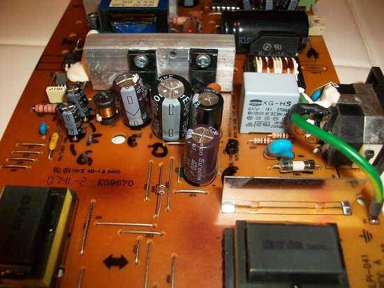

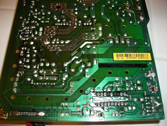

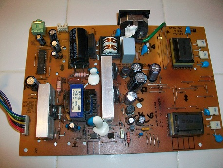

    My brother brought me this LCD and asked me to fix it. Based on the info I can find its bad Caps most likely. I broke it down and one cap is definitely swollen ( labeled E) in pic and must be replaced. Checked the fuse with Ohm meter and tested good.
    The Caps are listed as such:
    a) Samxon 100uF 450V
    b) LeLon 470uF 25v
    c) SuScon 470uF 25v
    d) TEapo 1000uF 25v
    e) suScon 1000 uF 10v
    f) SuScon 47uF 25v
    G) Suscon 47uF 25v
    H) SuScon 47uF 25v
    I) Teapo 470uf 25v
    j) Suscon 10uf 25v
    k) Teapo 470uF 16v
    L) Teapo 470uF 16v
    M) SuScon 220uF 16V
    Just need to know what to replace with (brand and possible improvement) and where to get them. Was not sure what you needed to see on board so included a small score of em.
    Thnx in advance

    Hello Niko, welcome to badcaps. That was a very good first post. Especicially with those pictures and the description.
    You can get those capacitors at digikey. You want to measure the height, diameter, and lead spacing. This page here will get you started. http://www.digikey.com/product-searc...1?k=capacitors
    For that "E" cap. Capacitance = 1000. Votage rating = 10v. Mounting type = through hole. Package/case = Radial, Can. Each time you check "apply filters" it narrows it down more and more. Most people out here recommend the Panasonic FM type if its available.
    Make sure you get 105C rated.
    You mentioned he had a power problem. That may or may not be related to the lcd problem. A surge will often take out the main fuse. There's another fuse to check also. The yellow/orange one behind the "G" cap.
    This board looks similar to the Viewsonic boards that I have repaired many times that only needs that one bloated cap changed to be fixed.
    If you want, we could go through complete diagnostics. Including power on voltage checks. I'd probably just replace that 1000uF 10v and see if it doesn't fire up and give you a couple more years of LCD beautiness

                  I hope you checked that yellow/orange fuse next to the "G" cap. It's common for that fuse to burn out with a bad cap in the area.

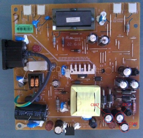

                      Not trying to grave-dig here, however I'm trying to get some info. I have been trying to recap my HW191D, but my circuit board doesn't match the images here. It looks like this board is an integrated board containing both power supply and display output components where mine just has a separate power supply and display output board that connect to each other.
                      Anyway, I had already put three replacement caps on when I realized that I should have waited until I had gotten more sleep and had more to eat because I noticed I had replaced a 470uf 10v cap with a 1000uf 10v cap (can't power up the unit yet, still disassembled, so nothing exploding). The problem is, I don't know which of three capacitor positions the 470uf 10v cap was in, C847, C848, or C853, and I can't seem to find a service manual.
                        Re: Hanns G HW191D blinking power light no display
                        post a good clear straight on picture of your board using manage attachments
                        also what is the board part number
                          I have to be honest, I don't know where the part number on the board is, but I've attached a picture of the board with the relevant caps highlighted and labeled.
                            Replace all the caps, and check the solder joints. While you're at it, check those output diodes. They usually hold up okay but might as well check them
                              Pentium 4 - dont think you have picked up on the problem? he has new caps just doesnt know where they go
                                That's sort of it. I thought I already had three replacement caps on hand, but I had, as a result of fatigue and low blood sugar, misidentified the one 470uf 10v cap that was blown (there's another that's seemingly good order, not bulging or yellowing on top) as a third 1000uf 10v cap and now I don't know which of the three highlighted cap positions was the original cap.
                                Thank God in heaven that one of the two 470uf 10v caps and the 100uf 10v cap still appear to be entirely good. It's just the two 1000uf caps, the FIVE 470uf 25v caps, and the one 470uf 10v cap that was by the two 1000uf caps that have fried. Maybe I ought to replace the two that appear still good, but right now I'm primarily concerned with only spending as much as I have to in order to put the monitor back in working order.

                                    Did you not take any pictures or note what went where before you removed any?
                                    Did you buy a repair kit - perhaps email the seller and ask where they go?
                                    I have been looking for on line pictures but csnt find a good clear one.
                                    Are they different physcal size sixe.
                                    Can you post pictures of both sides of the old caps to help id them on pics without being able to read what it actually says.
                                      I was tired and had low blood sugar so I didn't think of it because I thought I had correctly identified the three caps I removed and I wasn't thinking clearly at the time.
                                      No I didn't buy a repair kit, I was trying to use a few 1000uf 10v caps I had on hand to do part of the job.
                                      No, the physical size of all three blown caps was exactly the same.
                                      I'm not sure what good that last will do since they're all Elite brand and look pretty much the same.

                                        Well If your not sure you should do as we ask !!!
                                        I have just spent an hour looking at different sets that use this board and eventually came up with this.
                                        http://www.ebay.co.uk/itm/VP-775-TJ7...-/201045419286
                                        If you enlarge the picture I believe you can see which are the 2 1000uf caps
