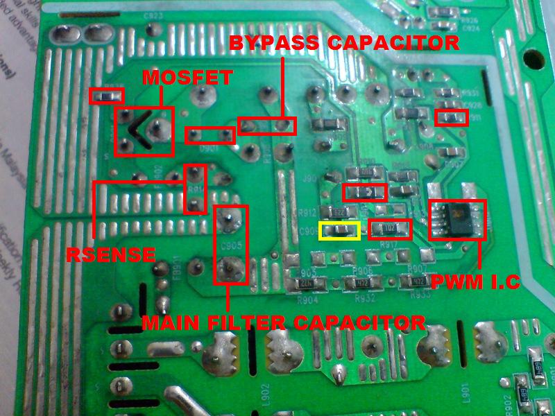

    Hi, much time ago i've already written about this but no solution, it is many years that i own this with the problem and it is driving me crazy, i don't want to give up even if i'm very near to do it, for now i have shot the incredible amount of 5 expensive power mosfet and 2 pwm ic's.
    The problem is that i've found it with mosfet shorted, 1 smd resistor from gat pin of ic to gate pin of mosfet exploded, with the help of this forum and with the remaining of the writing on it i've found the value in 5,1 ohm, 1 smd ceramic cap damaged due to explosion of near resistor, maybe 1 pwm ic (i'm unable to test it), 1 2W resistor with value of 0,39 ohm from the source of mosfet to hot ground, 1 2w resistor of of low value about 0,22 ohm if i remember, in the path from + leg of main cap to 1 pin of the transformer, later i've destroyed 2 or 3 mosfet after replacement of optocoupler, mosfet, 0,39ohm 2w resistor, pwm ic and smd resistor without noticing that the duble big diode on the secondary was going short apparently only under the full load, in fact if i power only the combo board (psu+inverter+main/video bd) with a light load like a pc 12v fan (it has 1 only output at 12v) the board went ok, but when i've connected the panel it goes short on the primary!
    the ceramic cap that was damaged, with the help of a newsgroup i have substituted with a 100nf thruhole plastic type since them have told me is a noise reductor maybe, is in parallel with the electrolitic cap that is on the vcc line of the pwm ic. I don't have found schematic for this monitor. I've always replaced AP2761I (650v 10A 1 ohm Rds threshold 4v vgs+-30v ton 16ns) with STP10NK60Z (N channel 600V 10A 0,7ohm Rds Vgs threshold 4,5v Vgs +-30v Ton 20ns).

            Can we see the pictures of your board? Does the board has BenQ name on it?

              Budm: sorry i have no good camera, this is the exact type of board:

                Fixed many of those Dells with catastrophic failures before (ie. MOSFETs, diodes, resistors, capacitors, etc). Always trace the "path of destruction" and replace those components in the "path of destruction". Especially have to beware of SMD components which fails easily whenever such catastrophic failures occur. Very often the diode and resistors failed, sometimes the capacitor may measure fine but breakdown already at above certain voltage. Hint, in this type of failures recommend replacing the primary side main filter/smoothing capacitor! Yes, that big one (rated at 400V to 450V).
                If you're having trouble finding 0.39 Ohm resistors, simply get 2 pieces of either 0.75 Ohms or 0.78 Ohms and use them parallel (should equate roughly 0.375 Ohms to 0.39 Ohms). Get resistors with at least 5% tolerance (lower the better). If the original resistor was 2W, then can use 2x 1W in parallel. If can't find same wattage, then get higher wattage ones. Basic electronics 101...

                        From my experience, most of the time when catastrophic failure occurs (something like 8 out of 10), the main filter/smoothing capacitor is always damaged/faulty. See attachment. That's one of the monitors I've repaired. The ones marked are all faulty, which includes the main filter capacitor. And yes, that PWM I.C blew quite spectacularly (can see the hole exposing the innards)..
                        Originally posted by Davi.p
                        as i've told i have used 3x 1/4w 1,2ohms that gives .4 ohms in par. I will test all "never changed" components with real voltage if i can..
                        1/4W resistors?! Also what was the tolerance on them? Stacking more than 2 resistors will increase the tolerance by quite a bit (which is a bad thing thus may not even measure 0.4 Ohms, perhaps more).
                        For example (always take worst case scenarios as safety precaution): If all 3 resistors are +5% off tolerance (each 1.26 Ohms), then in parallel it comes up to 0.42 Ohms which is +7.7% more than 0.39 Ohms! Those are way off the usual 5%. Imagine if those resistors are of 10% tolerance (will come up to +12.8% more for worst case scenario)...
                        The best is to use 2x 0.78 Ohms, of at least 1W each and at least 5% tolerance. Worst case would be 0.4095 Ohm which is exactly +5%, still within the tolerance range. Example, look for this part "RS01AR7800HE12" from Vishay...
                        Should use at least 2x 1W. Always use higher wattage resistors for Rsense (that low Ohmic resistor) because it can get very hot. If can get wirewound type then that would be better than carbon film types.
