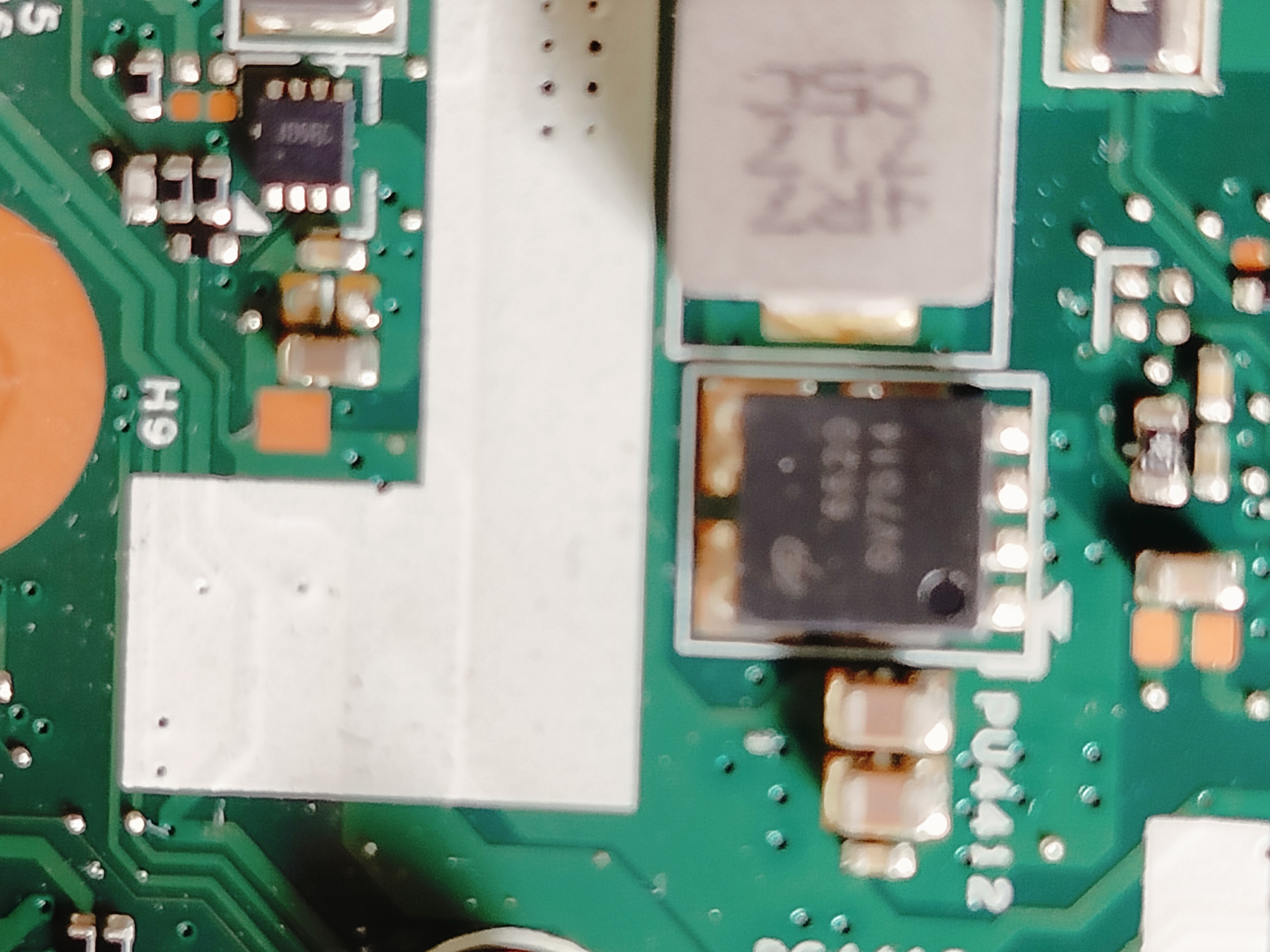

help this mosfet what other mosfet can i replace this 6520 dell inspiron 14 model
  • gambitxp
    • Aug 2020
    • 16
    • philippines
    help what mosfet can i replace this charging mosfet 6520 the brand of laptop is dell inspiron 14 3000
  • R_J
    • Jun 2012
    • 9607
    The actual number is an Alpha & Omega AON6520 Digikey says Rohm RQ3E120BNTB is a direct replacement, I'm sure there are others
