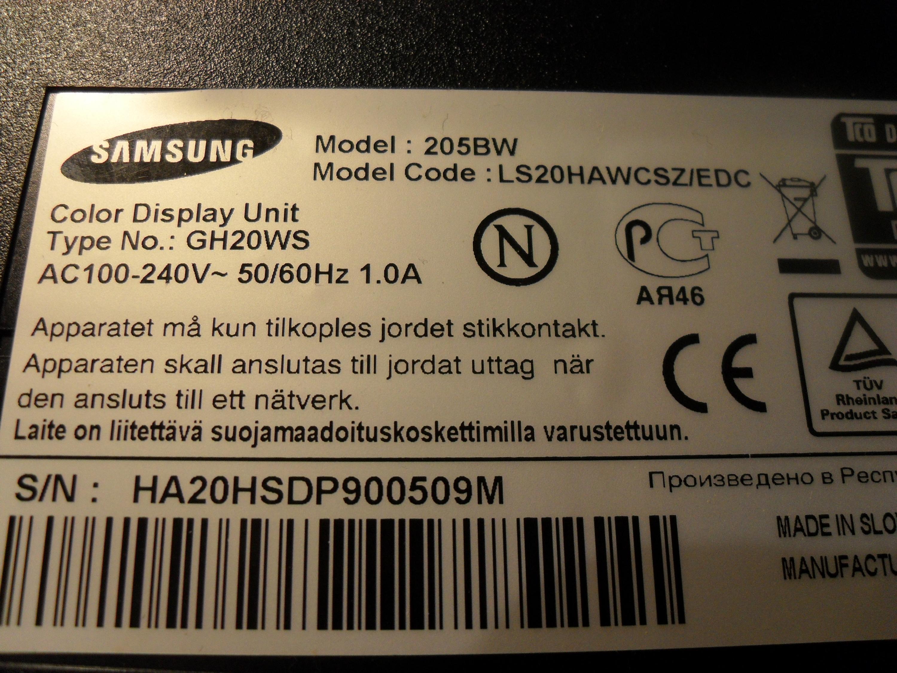

        Re: Troubleshooting Syncmaster BW205
        There are lots of threads regarding this board you need to search 205BW
        not BW205.
        Pictures always help us to help you
        Welcome to the forum-
        We can help a lot more if you please post good clear pictures of the whole chassis, and then pictures of each board, front and back (in the same orientation) and close up of connectors, (max resolution 2000x2000 and 2MB) using the manage attachments button, which is found by clicking "go advanced" under quick reply.

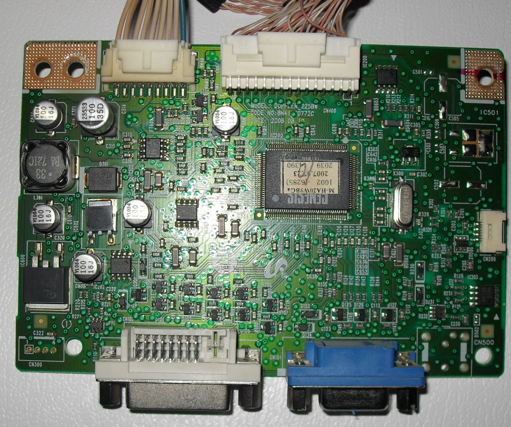

          Re: Troubleshooting Syncmaste 205BW

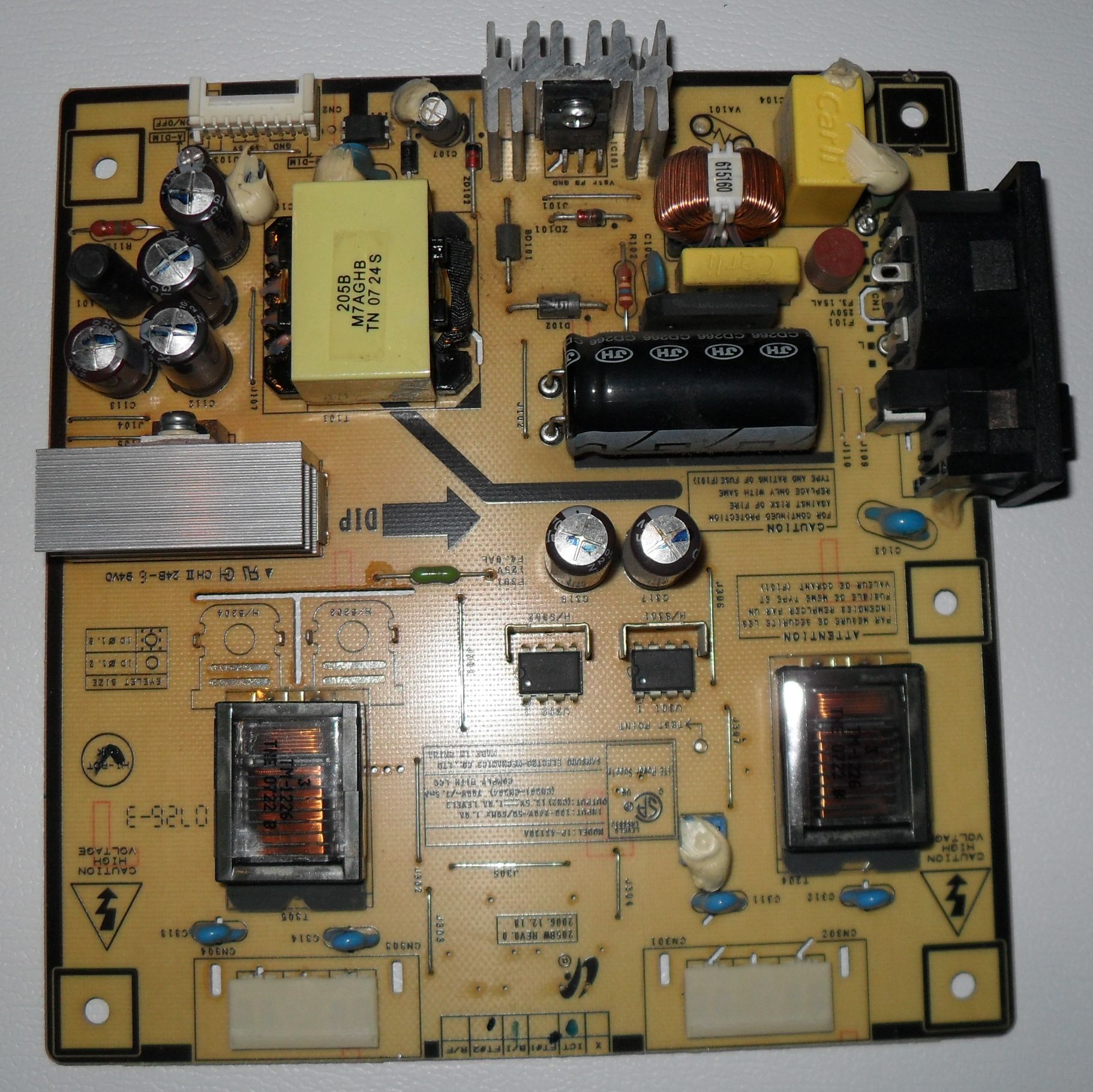

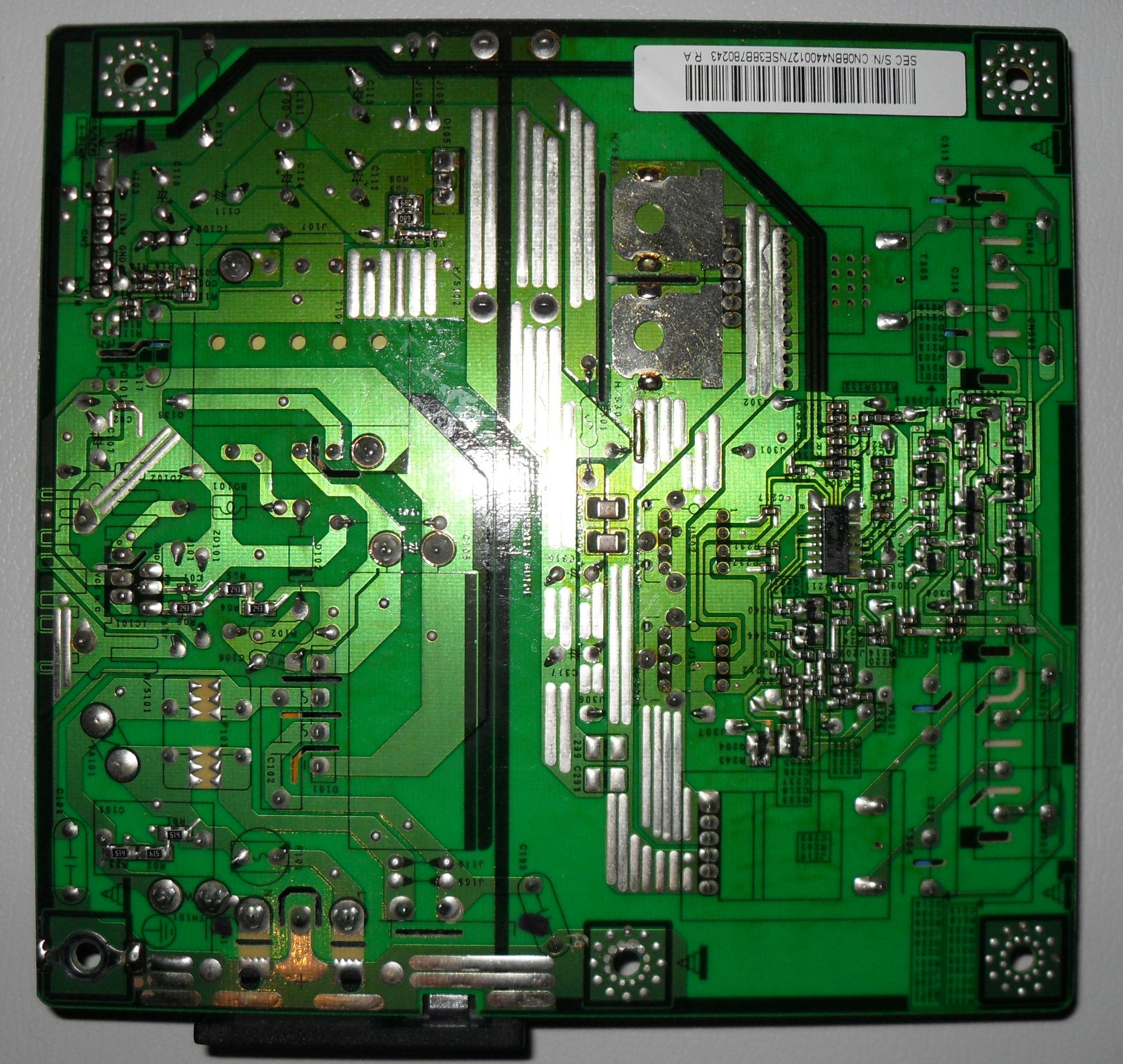

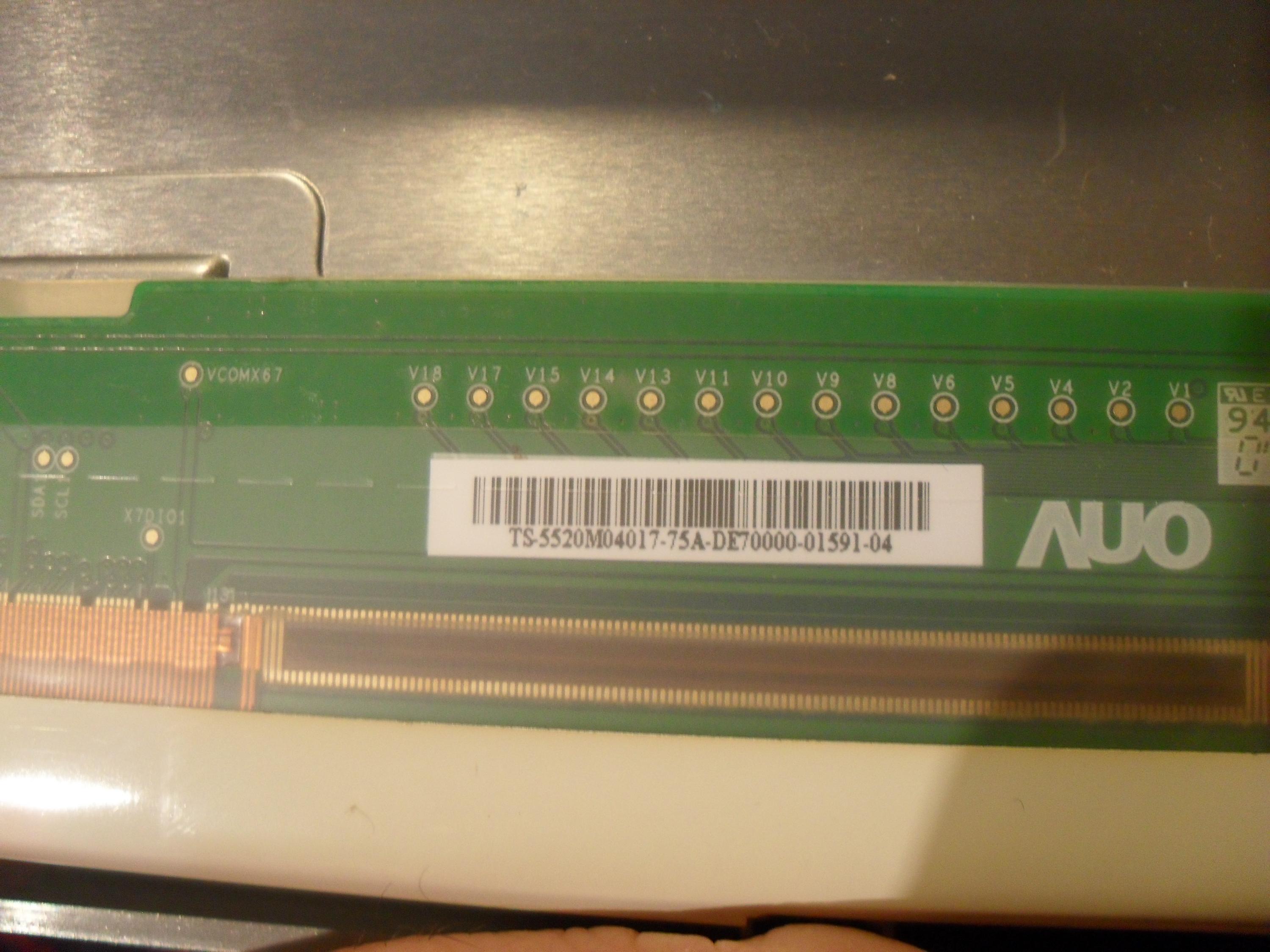

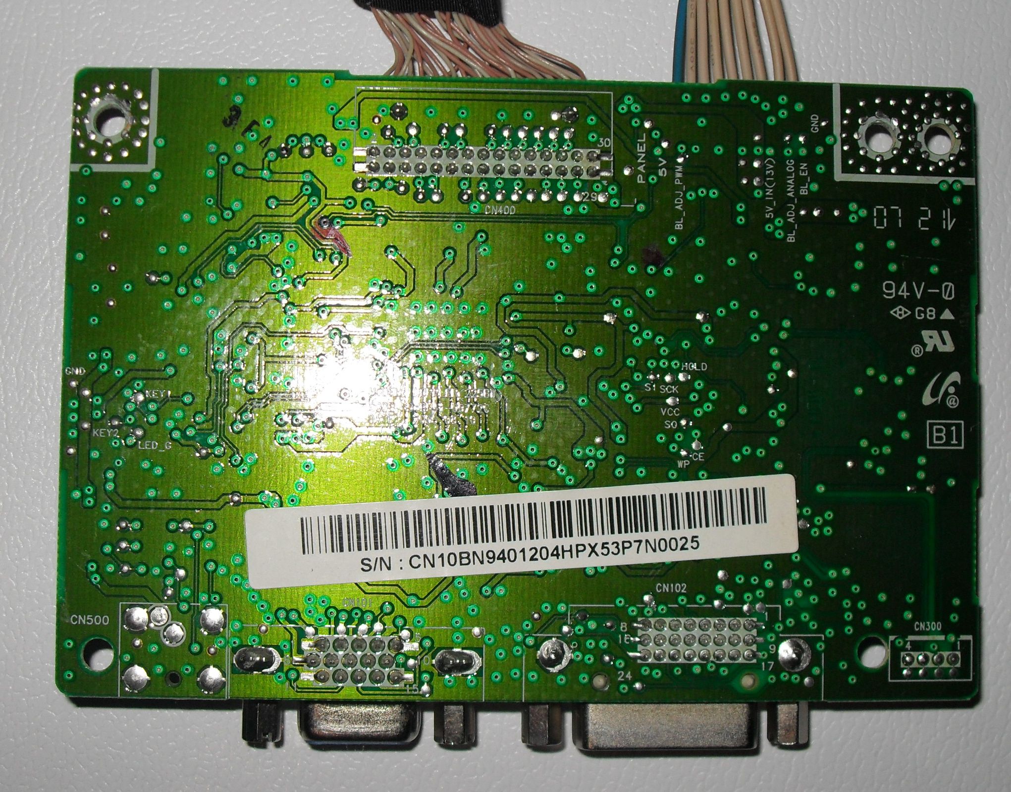

          Herewith some images of the boards and pcb.
            Thanks lcdman. I found that service manual one already.
              Hello Again frevab,

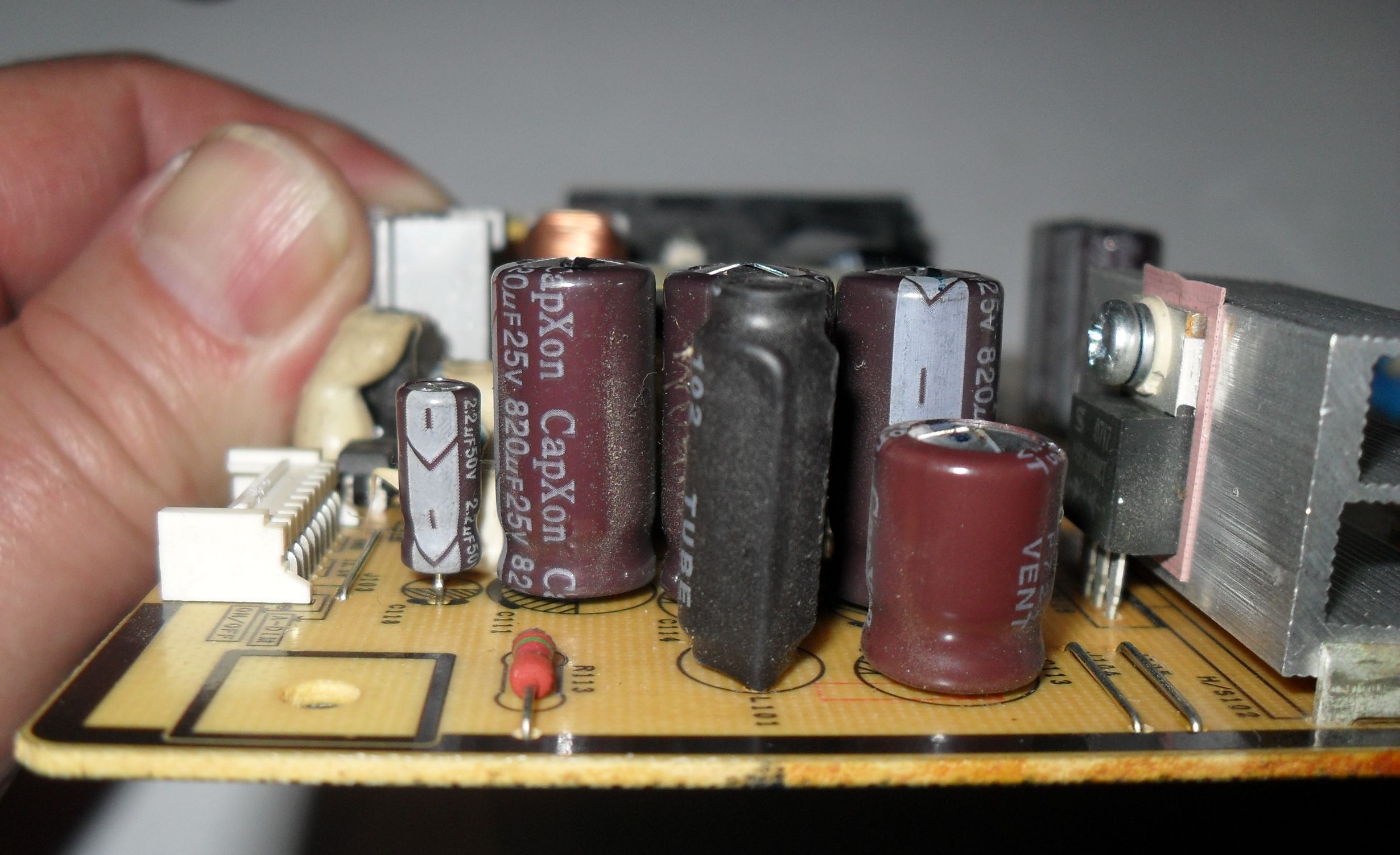

              I think its a cap issue first off. Possibly even those two 8 pin ICs have gone bad in front of the lone two caps on that board. Check the dimensions for the caps on your board. Diameter in mm X Height in mm. Height being the most important issue. If too tall you won't get the monitor to close back up. Then go to Digi-key,Mouser,Farnell but not Ebay for Panasonic FC,FM,FR series aluminium electrolytic capacitors. There are alot of known fakes on Ebay! There should be some on either of those three sites that come very close in size to what you have.
                Result bad caps the type of malfunction of the screen like I described in my Original post? It started off with a red(ish) image once in a while. Or not so bright colour as normal. Often when I switched on the PC the screen went inn standby after a few seconds. When I left it like that and turned it back on after 10-15mins it was often perfect no problem at all but sometime I had to repeat that or accept a dull screen. The next day it could be fine though. If it was not working it made some more noise than normal.

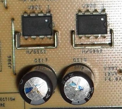

                  I am not technical enough to identify the ICs. Are these the one on the attached image close up U301 and U302? Are they easy to get? What does IC stand for?
                  These are the caps I have found on the board:
                  5x 20mm Ø10mm 820uF 25v C317-318-111-112-114 (brown cap)
                  1x 12mm Ø10mm 330uF 25v C113 (brown cap)
                  1x 10mm Ø5mm 2.2uF 50v C118 (brown cap)
                  1x 12mm Ø5mm 47u/50v C107 (black cap)
                  Following earlier posts I have already found
                  Al Electrolytic Cap 105C 25V 330uF (5261519 Panasonic EEUFM1E331 RoHS-status - Conform) and
                  Capacitor Al FR 820uF 25V 10x20 (7083743 Panasonic EEUFR1E821 RoHS-status - Conform)
                    Hello frevab,
                    Yes those two items in your picture are ICs. I'm sorry I didn't explain what IC stands for. It stands for integrated circuit. I don't know if they (IC)s are easy to get. Take the info from the top of the ICs and check Digi-key,Mouser,Farnel,etc to see if they carry them. Also you can search for the ICs on Ebay. I don't think these are as easy to make fakes of like capacitors. But then again I don't everything either. Try the capacitor replacing first, that might be all that is at fault. I took the time to search Digi-key to reference the size dimensions from your last post. You can get them from Digi-key or where ever you like or get the best rate for shipping on.
                      Those two devices are Dual MOSFETs for driving those two inverter transfromers. Try to get the numbers as printed on the top of the devices.
                      So far I see 6 bad caps with domed tops. You should replace those caps at least.

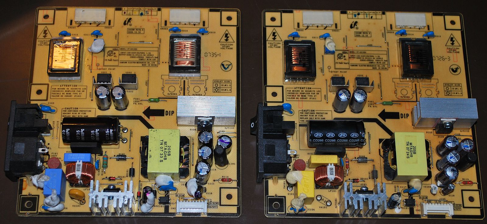

                        Hi guys. Has been a while.
                        I have been looking for the caps but had to buy them in 5's and 10's so while googleing I came across a new board. In the end it was not much more expensive and would save me a lot of hassle trying to soldier the caps as I have no experience in soldering.

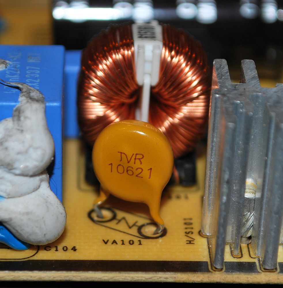

                        Had to wait a while to receive the new board and it looks fine except for one item which is on the new board but not on the old board: on VA101 there is a TVR 10621. What is this for and what difference does it make being there compared to the old board that didn't have one?
                        I enclose an image with LEFT the new board and RIGHT the old (original) board. VA101 is on the left bottom corner.
                        I have connected to new board and connected the CCFL tube. With the old board I did not have any display but now it starts ok (perhaps less bright than before) but dies after a second or so. Why could this be? One of the tubes not ok? I got new tubes and resembled them into the screen as I was afraid to test them just like that outside of the screen bodywork. Can you just light them up connect to the board (careful of course because of the high voltage)?
                          That VA101 is the Varistor (MOV) for surge protection, it is connected between line and Neutral, the board will work without it but then you will not have surge protection.
                          When you power up the board, do you have the main board connected to the running PC? Otherwise it will go into standby mode if it does not detect video signal from the computer.
