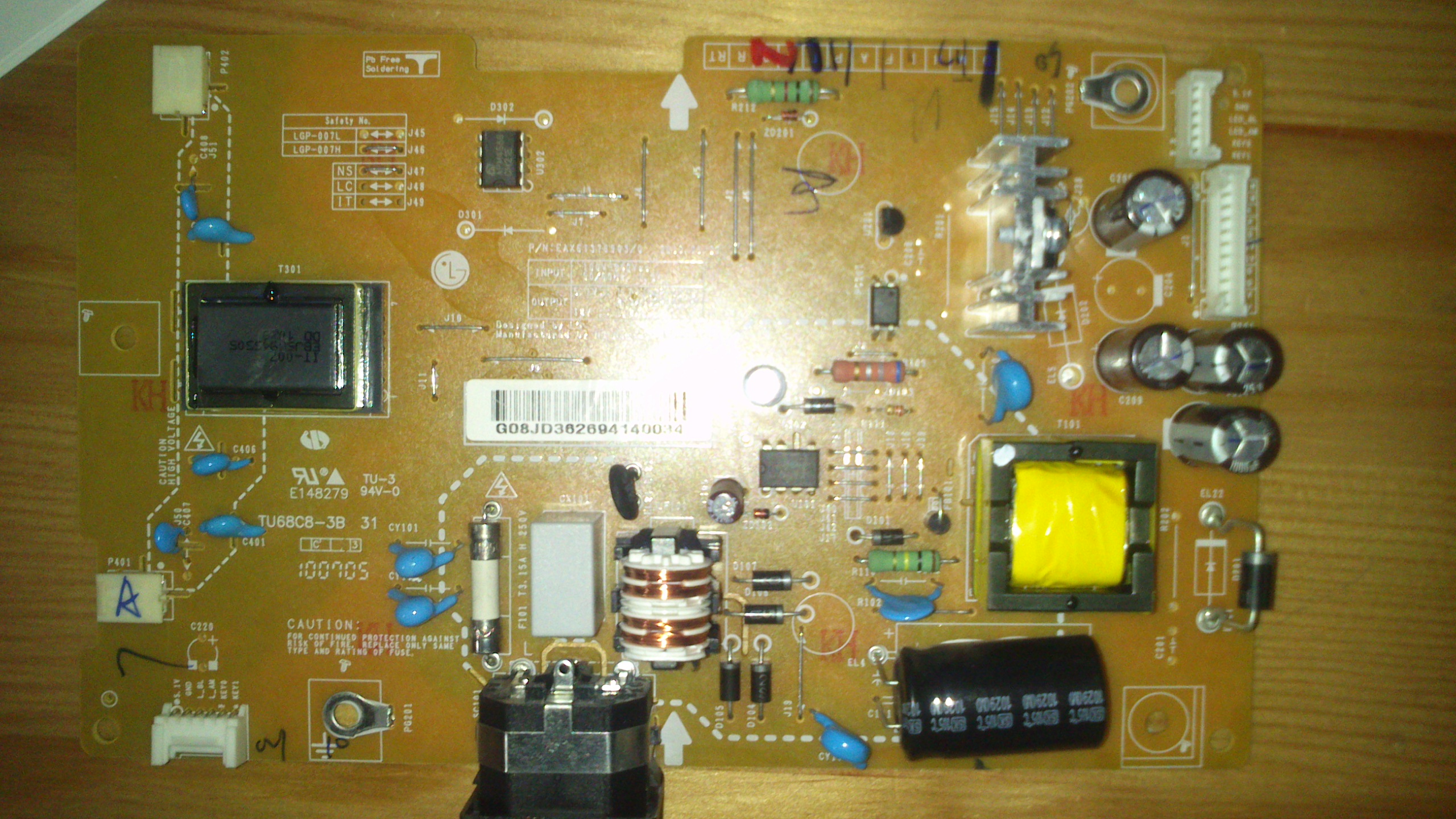

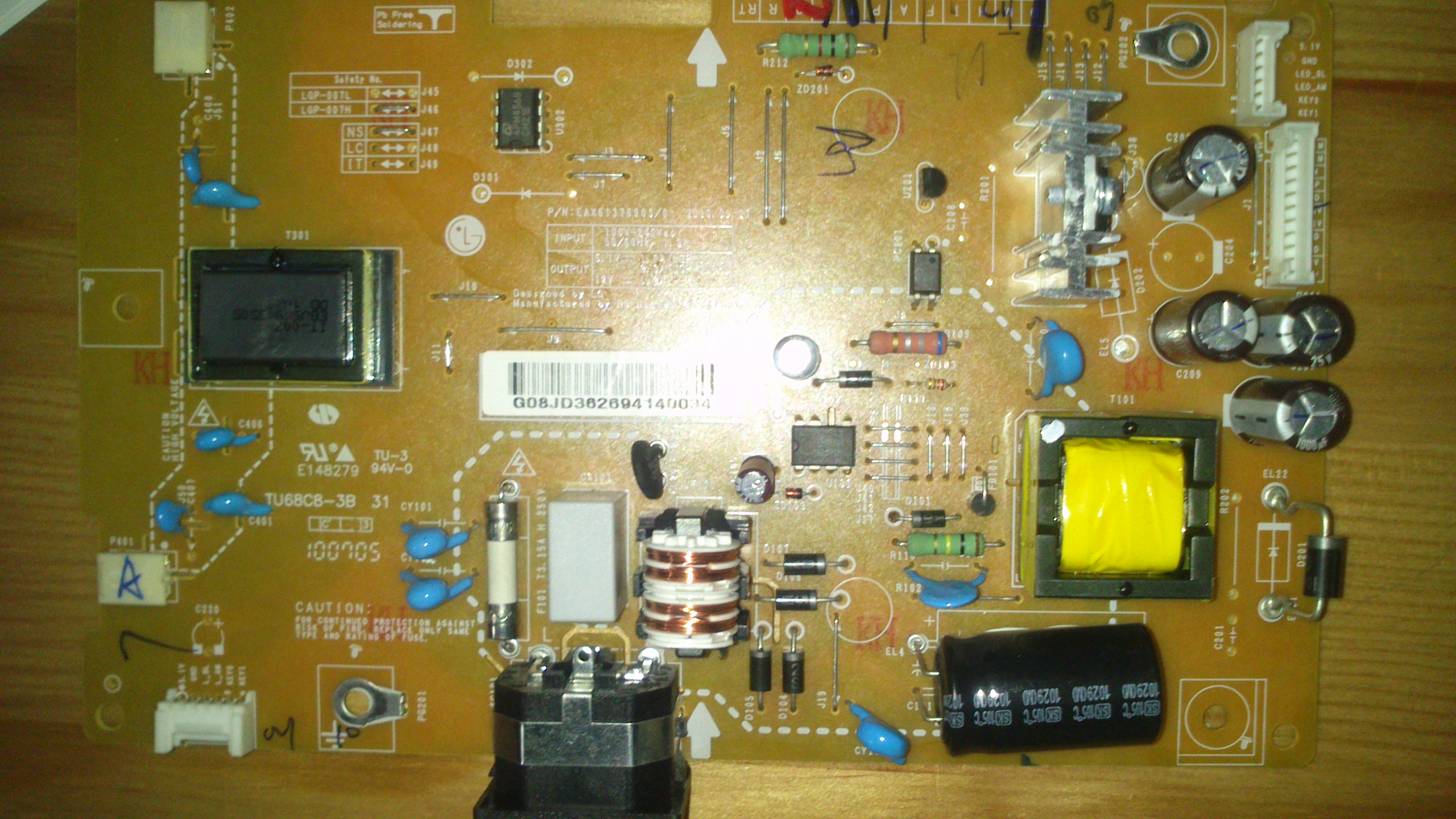

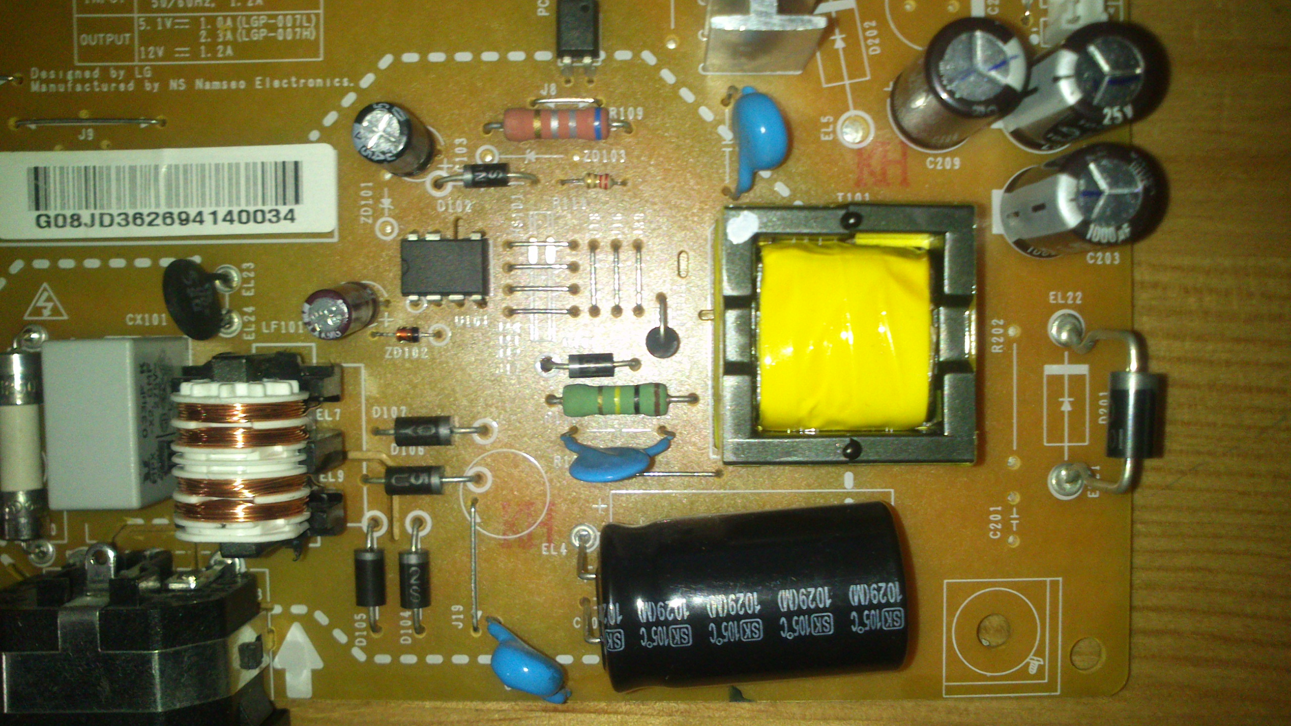

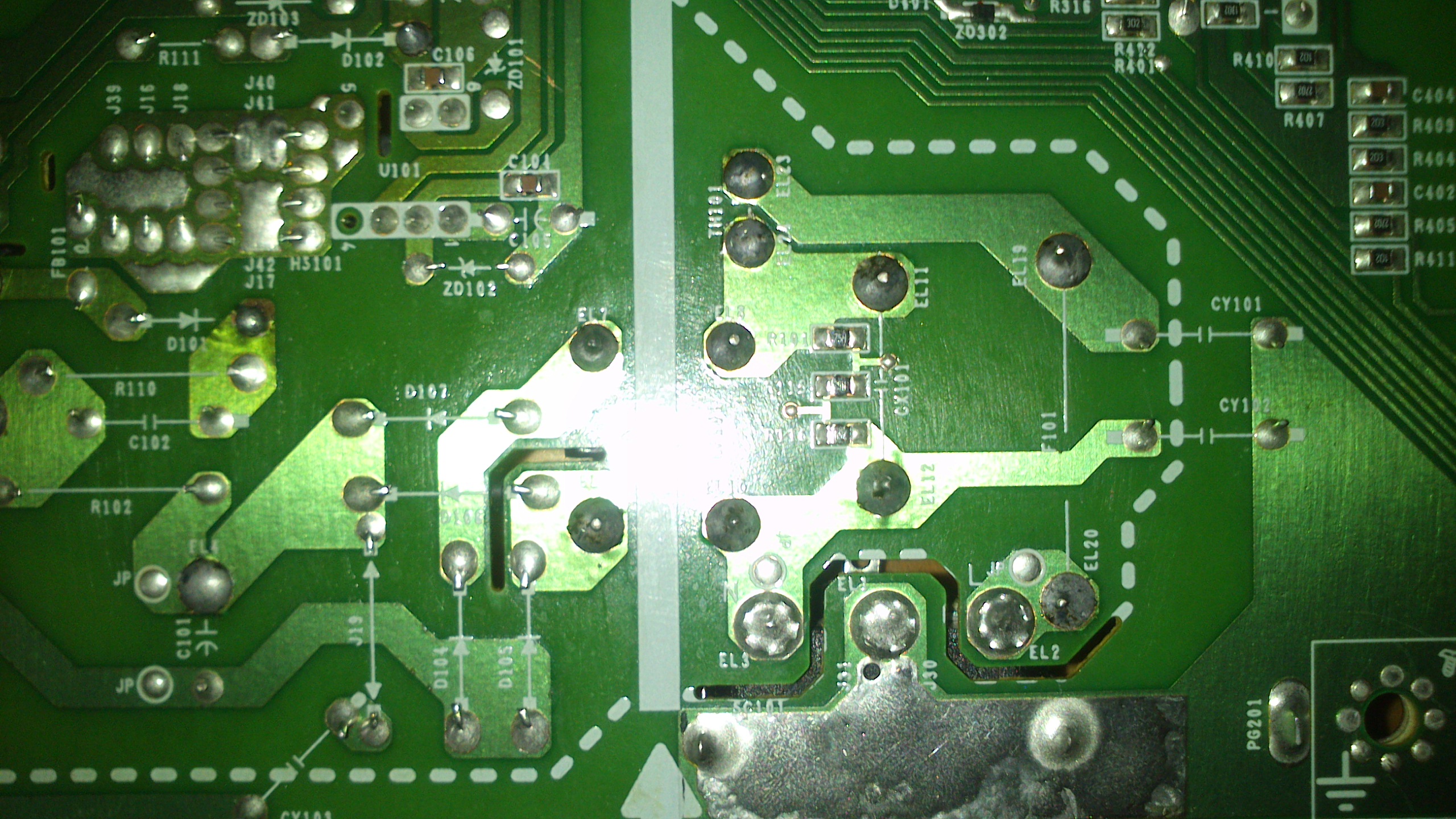

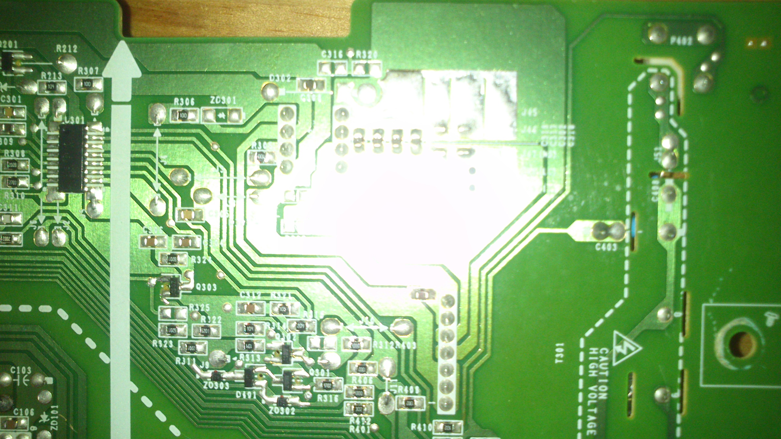

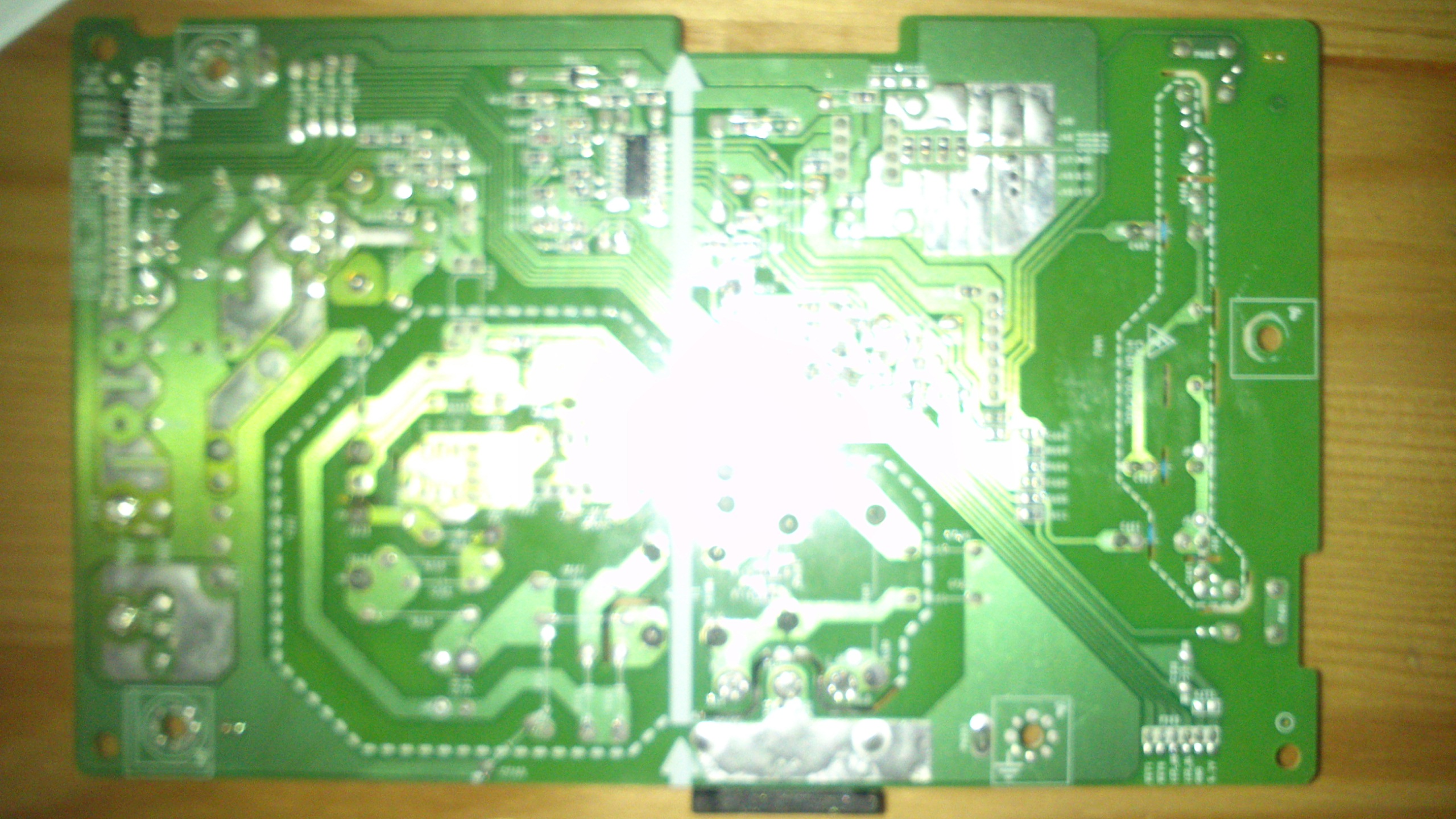

                Re: LG Flatron
                i could only post the photos today, hope there will be of any use, if you need anything more just ask.
                the photos are very low quality but is the best i can manage, only have camera on phone. so sry.
                Think if i replace all capacitors i will solve the problem? what about those ceramic caps i cant get them where i live. do i need to replace them too?
                best regards
                Andre Macedo
                  Re: LG Flatron
                  OK - Pics have too much flash - need good light but not flash.
                  I have not seen this board before either .

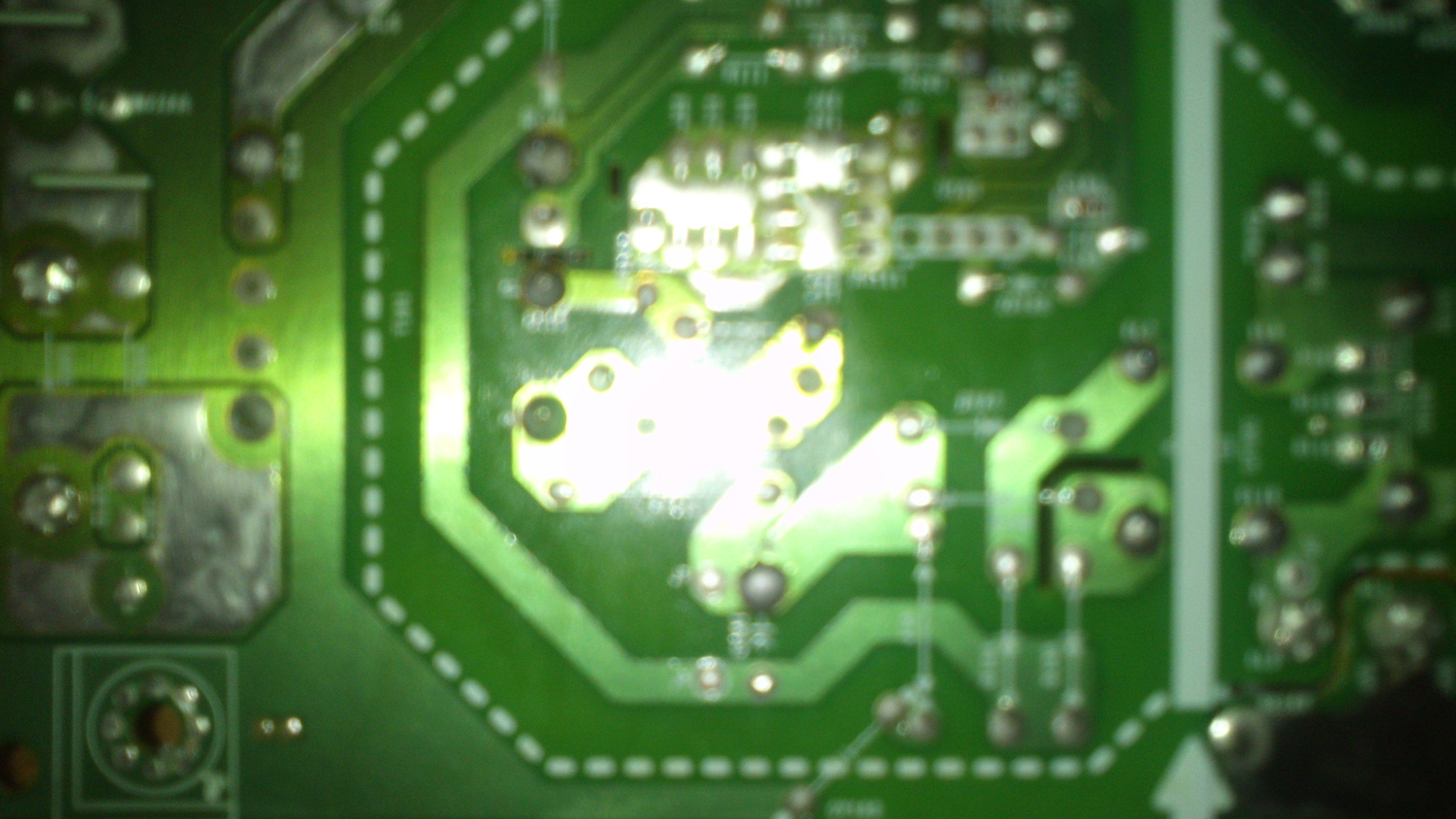

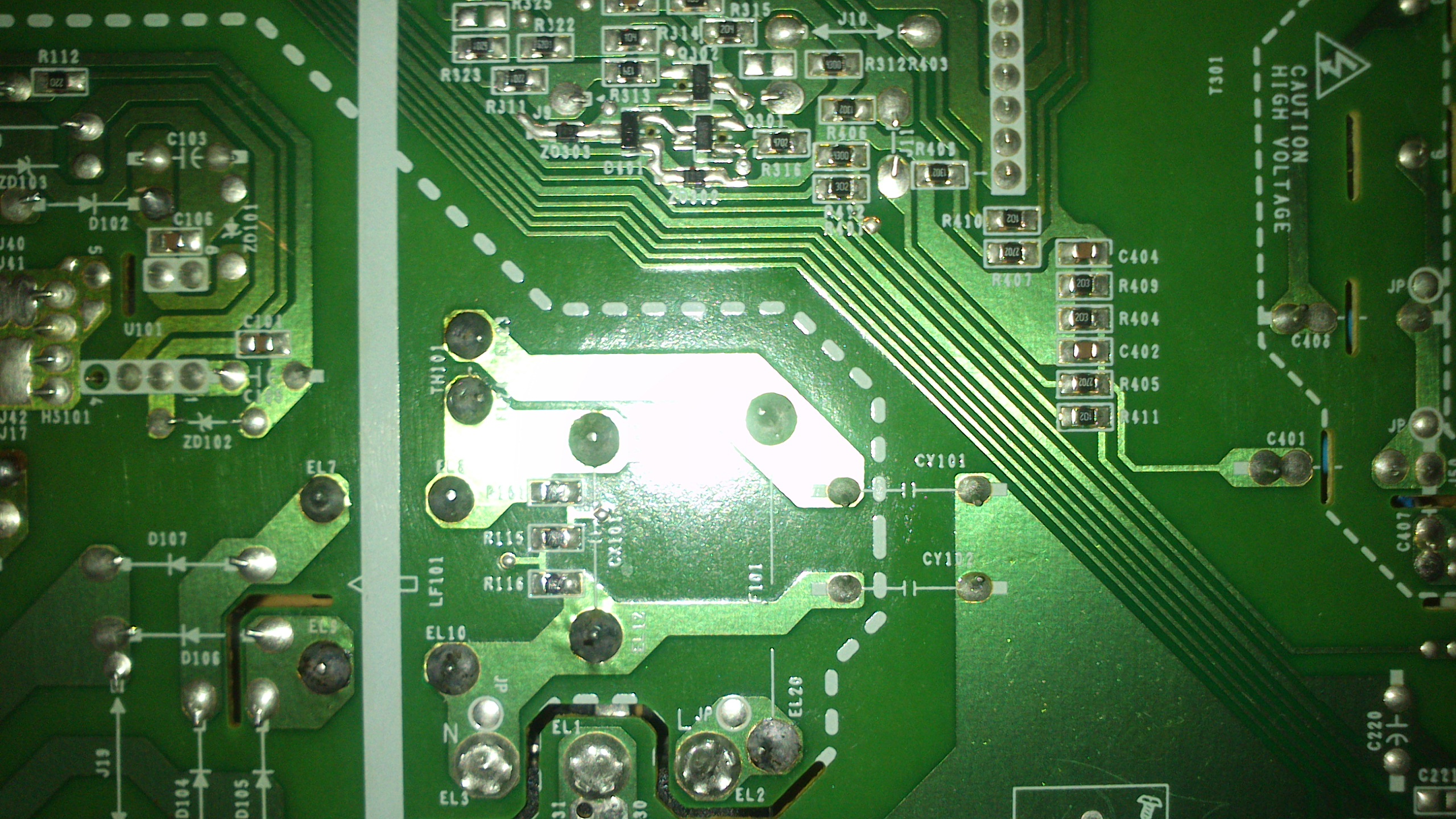

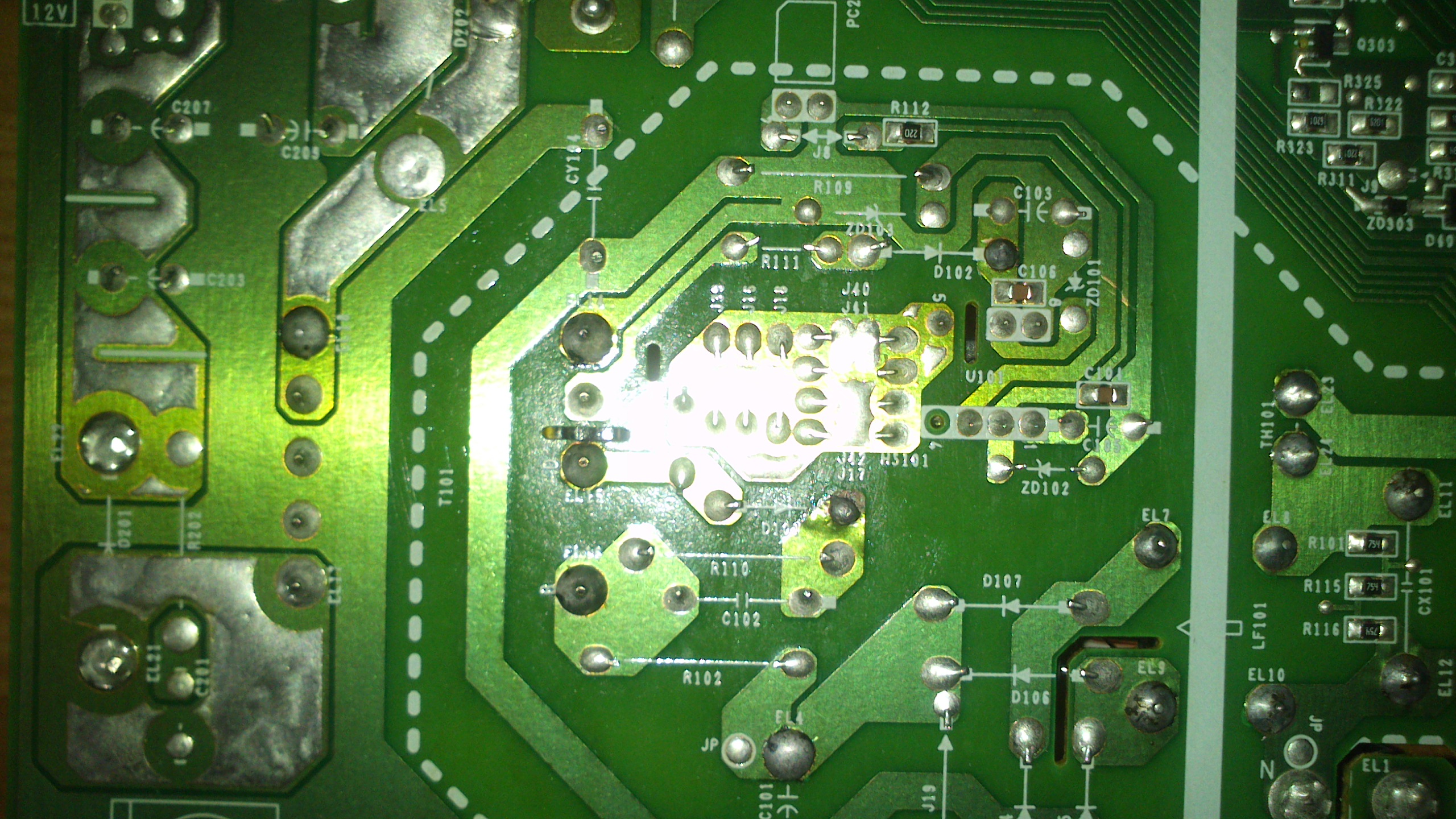

                    Re: LG Flatron
                    Here are more pics without flash as you said, il try replace all the capacitors, from you experience you dnt think its the transformer right, im talking about the square where the ccfls conect, the photo nº 99.

                      Re: LG Flatron
                      I am just a hobbyist so I dont bother testing caps - if I am fixing something I usually just replace all except Big ones. You can find some tests on line or possibly even on here, but I dont think they prove much.
                      I thought about the Inverter transformer and even got a picture ready but unless we can find data for it we dont know if the test is good or bad.
                      Usually there are two transformers to compare.
                      Anyway you can still test the secondary - Power to board off set you meter on ohms 2000 and measure S1 to S2 in the pic ( Do NOT try to measure the voltage on these pins)
                      Do you have any spare bulbs - old monitor or laptop. if not can you make a test bulb?
                      https://www.badcaps.net/forum/showth...ght=test+lamps
                      Pictures are a lot better - thanks
                      Are you doing the voltage tests? - before you replace caps
                      then any improvement can be seen
